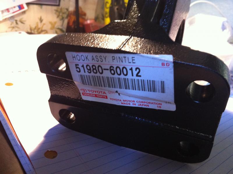

Folks I did a little bit of research on that specific pintle and this is what I find:
got one for sale
so after a year of searching, I just bought a nice brand new one from Japan 4x4 , thinking it would fit on my 2003 (with the cross member bumper hitch ) turns out the bolt pattern for the 100 series is 2 mm further apart, than the standard 9mm between holes..so this lovely $230 (with shipping) pintle hitch will fit someone's 80, 40, 70, etc..
Taking offers ..starting at $100 plus shipping... includes the cool hook bolts and regular bolts and washersView attachment 721051
