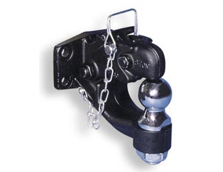

I prefer the looks of the pintles with the built in ball FWIW. This one is offered by Holland:
I like those too, but it lacks the ability to swap the ball out for different size requirements. I wonder if the other would look better if the ball was painted black:idea:
