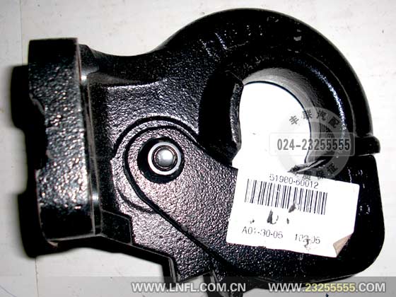

So when you take off the small cover this is what it looks like:
img_0308-jpg.217178
Then you get the tow attachement and it looks like this:
Unless I completely spent the money needlessly and I can just put this guy directly in there and secure it with a hitch pin?

I have the identical in-bumper hitch that you have and so far I have gone through the following hitch D-ring's and none of them fit with the Toyota tow attachment. The loops hit the shackle before it inserts far enough to slide the hitch pin in. Still searching for one that will fit.

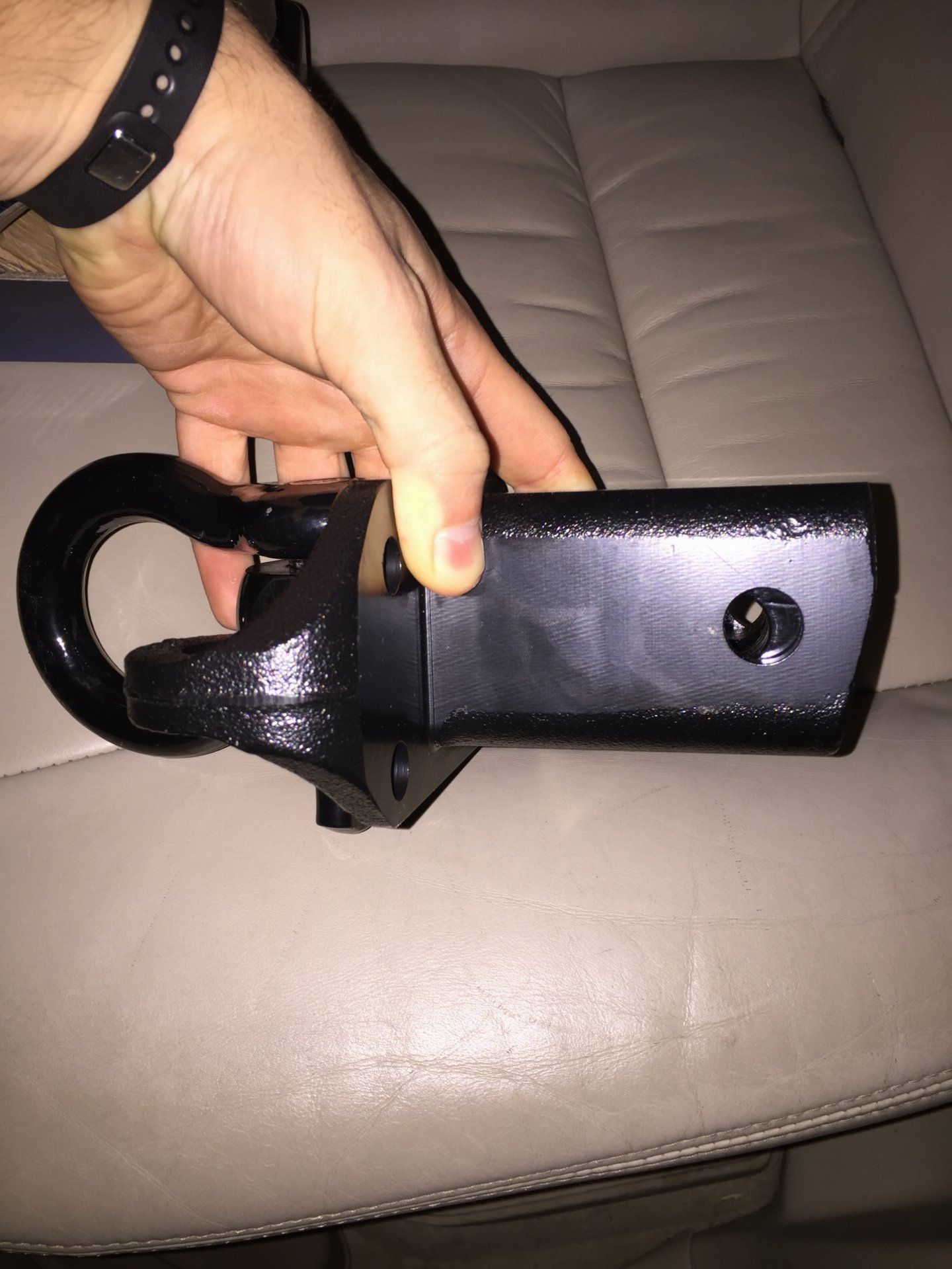

yeah this guy here, that I bought,
receiver-hitch-jpg.343388
Has the hitch pin hole. Without it, the bumper has an empty hole.
Can't you just mount it so that the d ring is vertical? Since it has 4 holes?
That was my logic in buying that one thinking I could insert it vertically but the holes still don't line up. It doesn't go in far enough. See below...
The one from amazon that has 4 holes has this set of dimensions: 10.5 x 4.8 x 2.6 inches. So essentially something longer than 10.5 inches. From your picture it seems that about 11 inches is just right?
Sounds about right.
