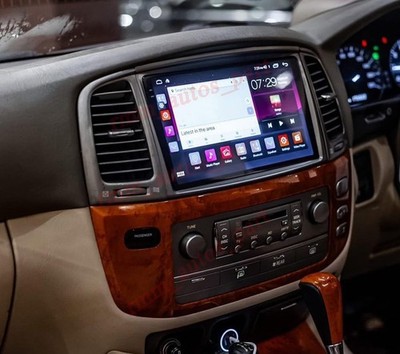

Progress Update
Core hardware direction is now locked and we’re transitioning into schematic and PCB.
v1 uses a dual rotary setup for TEMP and FAN (with push-off on fan), supported by dedicated physical buttons for AUTO, A/C, RECIRC, MODE, and FRONT DEFROST. MODE cycles through vent positions with indicator feedback.
Feedback is kept simple and OEM-focused: a small center display for temperature only, mode indicators (Face / Bi-level / Floor / Defrost), a fan level LED bar, and active-state indication on key functions.
System behavior is designed to mirror factory AUTO climate operation, with proper integration into OEM dash illumination for dimming.
edit: this is AI generated but using our specific parameters on what a finished product would look like.
I dig it!

Looks good to me!
One request…can you make the temp selectable between Centigrade and Fahrenheit?
Looks good to me!
Being Canadian living in the U.S., I’m already juggling Celsius and freedom units daily.
But V1 is locked, no additional changes at this time.

This is the way! Mark me down for a version 1 if possible!
One question, and sorry if I’ve missed the answer, but how would an aftermarket head unit fit? Being as there are no adapters for these.
