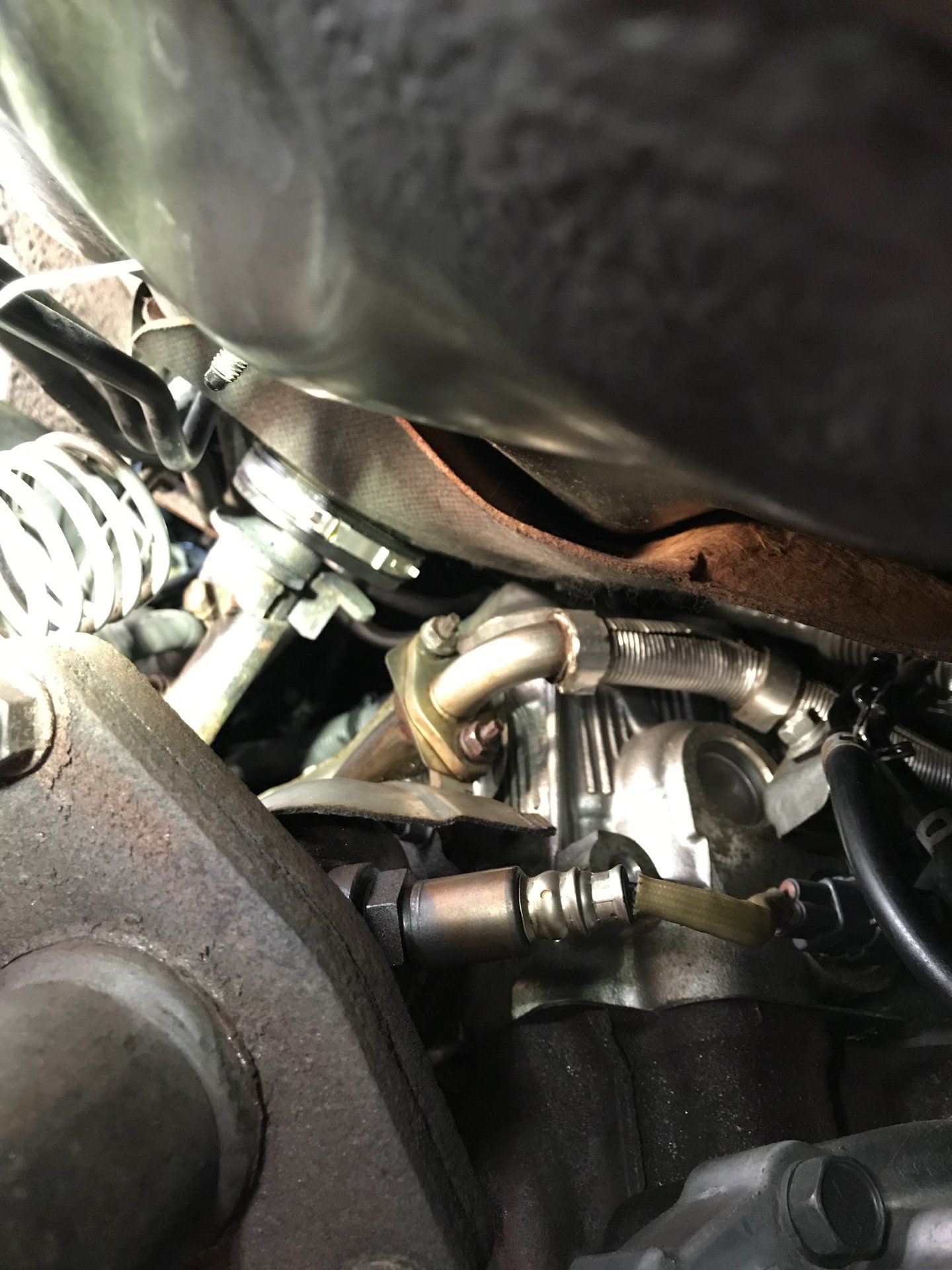

So I installed the v36h kit.
Plug in play is a cinch.
The block off plates, like most things in life you do the first time, were a pain in the neck.
I came at them from both fender wheelwell and underneath after removing the plastic skid plate. Used lots of pb blaster and other penetrating oils. This rig lived in Connecticut/Massachusetts it’s while life and even though my rig looks pretty good underneath rust wise all considering, the nuts Were rusted good where the block plates inserted. Pic is driver side after plastic skid plate removed, nuts are backed out and about to gap and insert block plate.
So far so good. I will update again.
