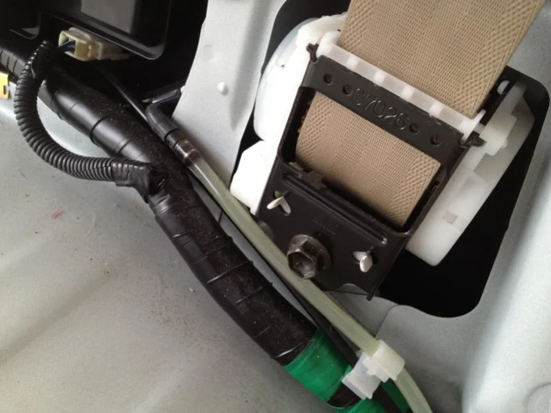

Here was the offending seat belt squeaker:

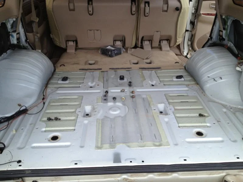

Taking out the carpet and third seat hardware to dynamat and install some type of truck bed liner and tailgate mat.

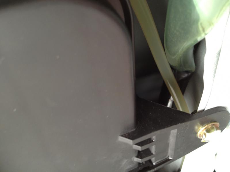

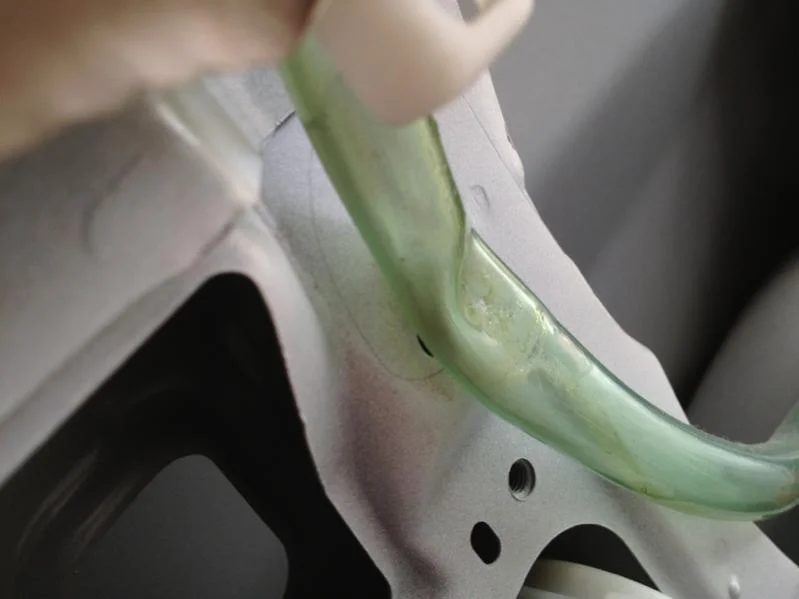

Found a tube that was pinched off, any idea what this is for?
Mine had a residue in it, seems like a drain for something. I didn't see one in the driver side. Drain for the rear AC ducting?
Here is my driver side, also pinched but further down and behind.

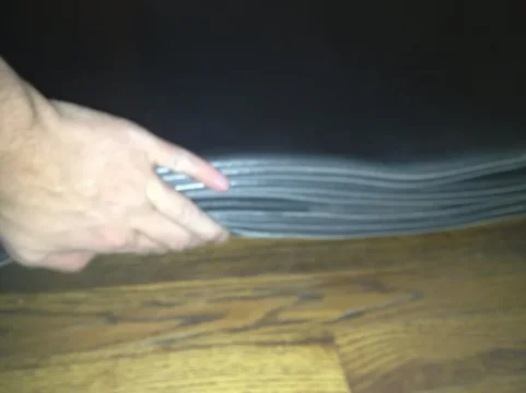

Ordered up a bunch of Second skin Deamplifier Pro and Luxury Liner yesterday and today picked up a 4x8 sheet of black 1/4" thick ABS plastic to create a new floor deck and rear hatch plate for my rig this weekend.
Sent from my iPad using IH8MUD
Wow, second skin got my deamplifier pro and luxury line to me today. And with a nice little discount to boot!
Going to install this shortly and see how it helps the exhaust noise that I'm dealing with.
That tubing comes from the rear sunroof drains.
I think I have enough Luxury Liner for two rigs!

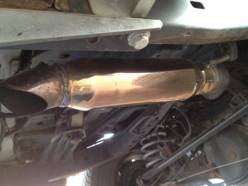

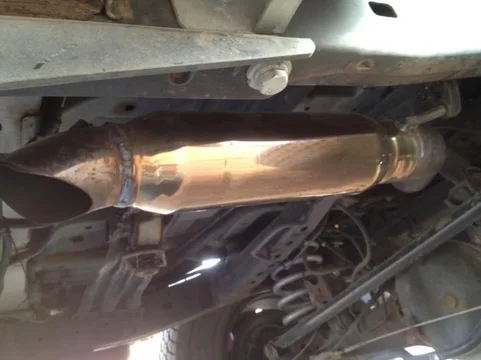

Here is the muffler les found for me installed. Significantly quiets down the rig, also chokes horsepower a little but feels like lower end torque is improved.
After reading the following thread for an 80's series I wanted to do the same for mine.
The muffler I used was 3" in and 3" out, I found it on google.

Thanx for the PIC!
How much did it cost to install?

What aftermarket set up do you have? And is it obnoxiously loud or do you want it closer to stock?

Local shop welded it up for $40
Yes no asphalt smell for me!
I am supercharged. I have Doug Thorley headers. And EMS mid pipes with two resonators in each. No cats. EMS catback the rest of he way out with the Moroso spiral muffler at the tailpipe.

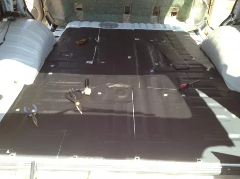

Second skin Deamplifier Pro going in:

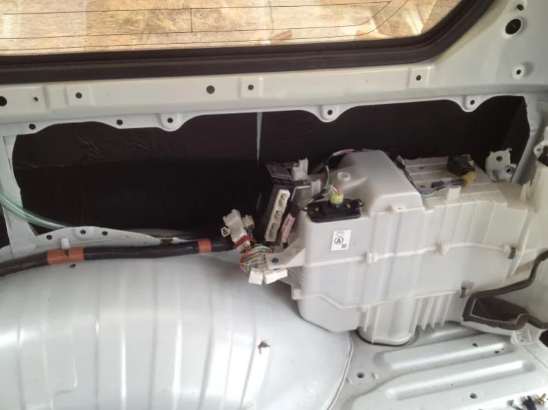

Removing that Ac box to get dampened behind it was a b!tch. Broke two black plastic body panel plugs and finally discovered a bolt under the rig next to the muffler was holding it down. I broke that bolt off as well. Then said screw it, just moved the unit out of the way enough to get some dampen set back behind it.

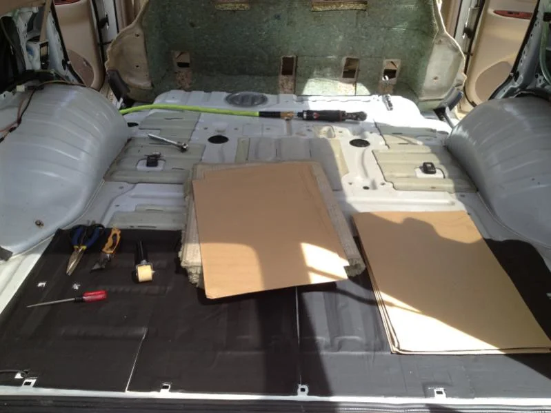

Starting to put the second skin down. I cut out holes for all the screw holes for the old seats and mounting points in case I want to use those for the bedrug and ABS sheet I bought.
Getting closer!
