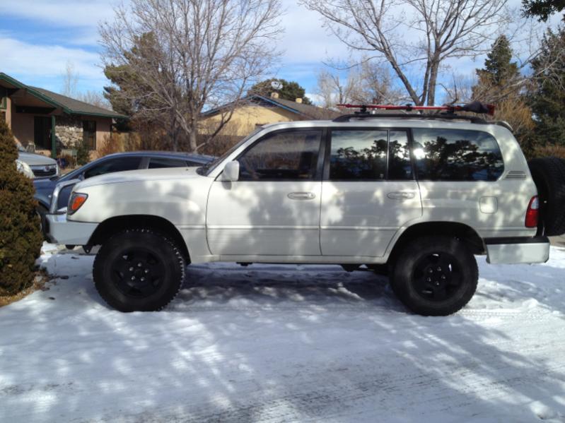

Slee lift installed.
Behold:
Rides a little stiff but I have about 1300 miles to put on it over the holidays that might settle it a little. Still have the metal tech rear upper and lower links that need to be installed later and the suspension phase of this build should be done. Then just need lockers and skid plates.

Got the metal tech rear links installed and the ems cutback installed. My ome muffler was toast. I think my cats are toast too but I don't have the mid pipes yet to install them. The sound of the cat back is pretty cool but I'm sure I'll end up dynamatting the rear of the vehicle to quite it down some.
Found a stock LX to park next to this morning and shot a comparison photo.
