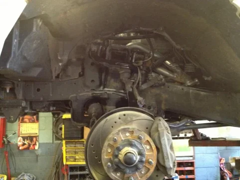

My AHC has just been trouble. I should have taken it out before buying the new globes.

Next up: Going to have a local mechanic take a shot at taking out the AHC. Wish me/them luck!

One bit of advice - the wiring harness for the AHC is a real pain to remove and could eat up alot of time. I pulled it out of my 100 but many people leave it. If I were to do it again I'd probably leave it in place.
Be glad you're not doing it yourself.
Not sure what the final tally will be, way more than what ACC and other pros charge but the AHC system is out now and am just waiting on a new pan hard.
Some pictures from the AHC removal.
Should get my truck back today.
