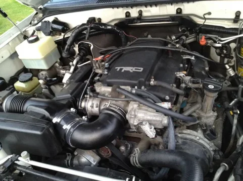

Supercharger installation started today thanks to Ryan Bascom of On the Road Again Mobile Mechanic.
I was waiting for the DT Headers but they are on backorder and I'm done waiting. So on goes the SC.
Ryan has a bunch of pictures on his facebook page of the process:
https://www.facebook.com/media/set/?set=a.464838486878199.113898.236783946350322&type=3
Here's a couple teasers, for the rest go to his page linked above.
Supercharger installed, nice little jolt on the accelerator now.

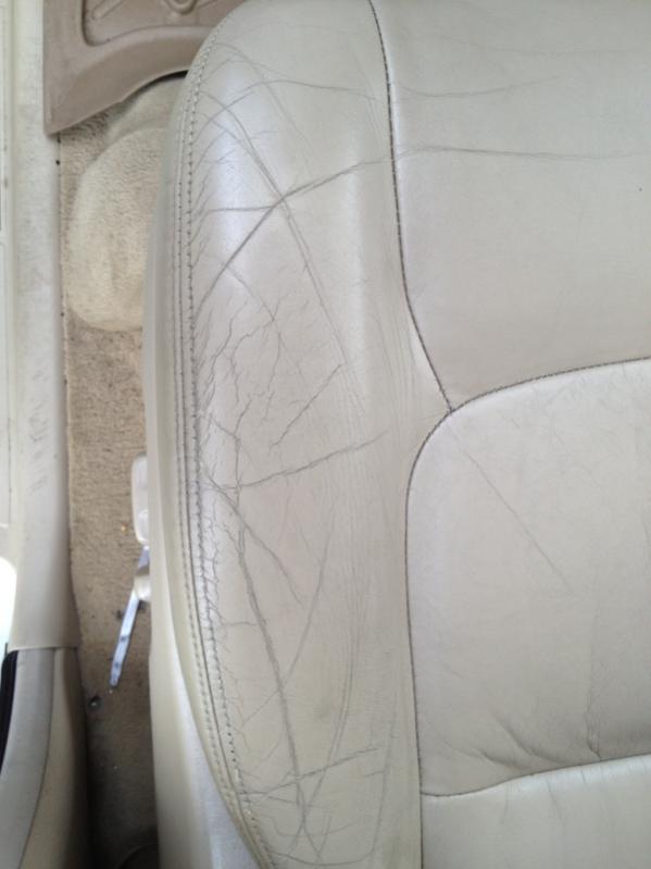

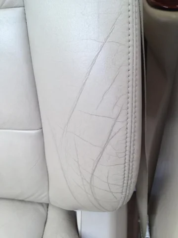

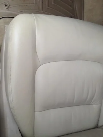

I did get my seats repaired. MUCH cheaper then replacing.
Seat bottom before
after
Seat back before
after
Looks brand new again. Thinking about some covers during the summer to reduce the heat.
I used a local repair shop. He used a compilation of conditioners and some type of leather fill for the cracks then dyed the leather back to the factory color.
It almost looks new. That's great. Do you mind telling what that cost you? I would be interested in doing the same thing. Mine are just a little worse than yours were in the before pictures.
