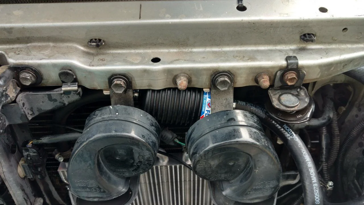

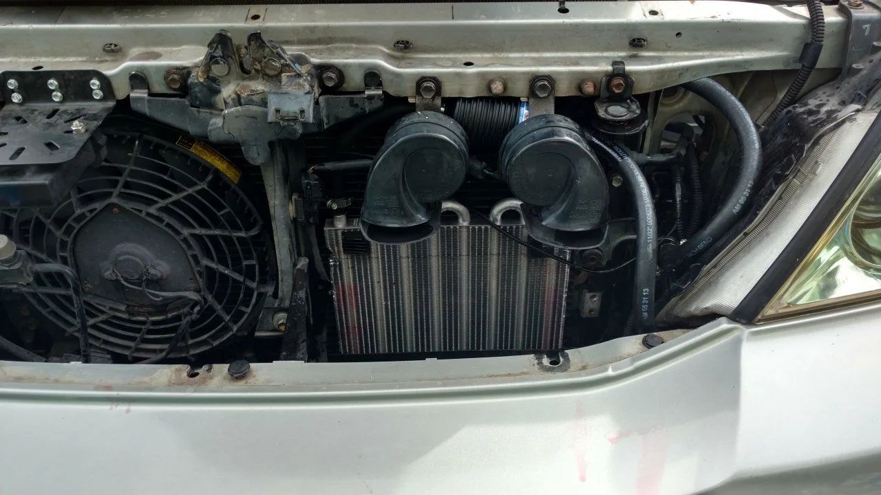

So today I made use of a day off and installed a trans cooler and inline filter. I'm glad I got the big one, as there really isn't room one with a fan... This one drops all the way down to the bottom of the AC condenser, so it's nice and big. The box says "full size motorhomes and 5th wheels over 10,000lbs..." OK yeah sure, but it should be good for me with a little off road trailer and bigger tires. And the occasional towing of the 4runner (5800lbs by itself). I'm probably add another filter on the return line at a later date when I have more enthusiasm lol. But for now it's nice to have it back and feel good knowing the trans is protected.
View attachment 1237140 View attachment 1237142
I have a B&M 70268 supercooler I need to install. It’s just been laying around. I had one on my 3rd gen 4Runner and it worked well.do you have a website and/or part number for the cooler? have you been able to check the temps after driving a while.

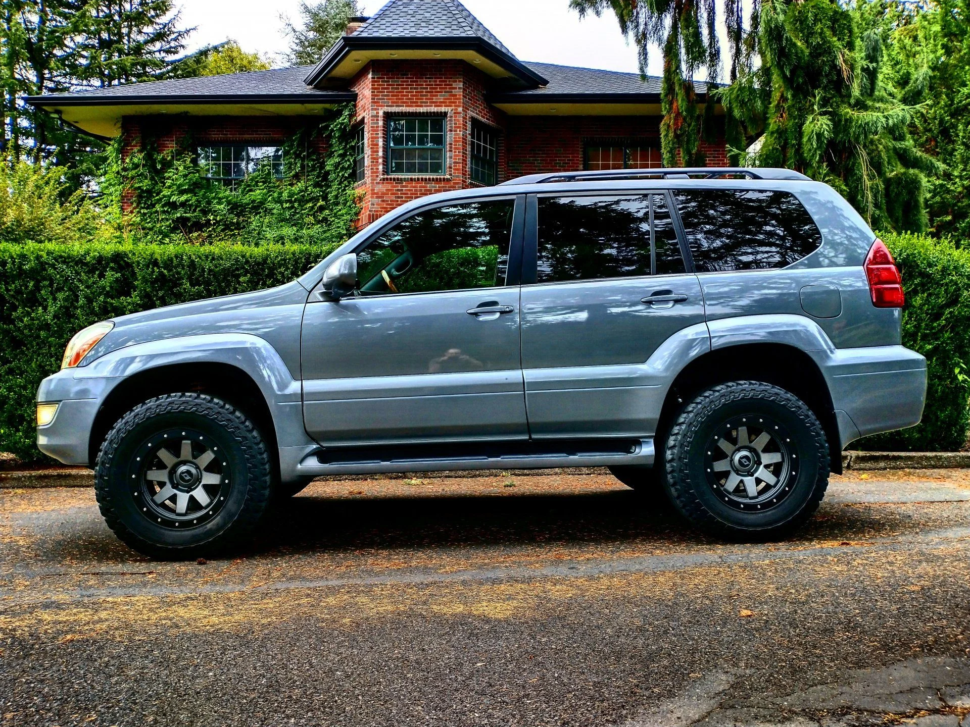

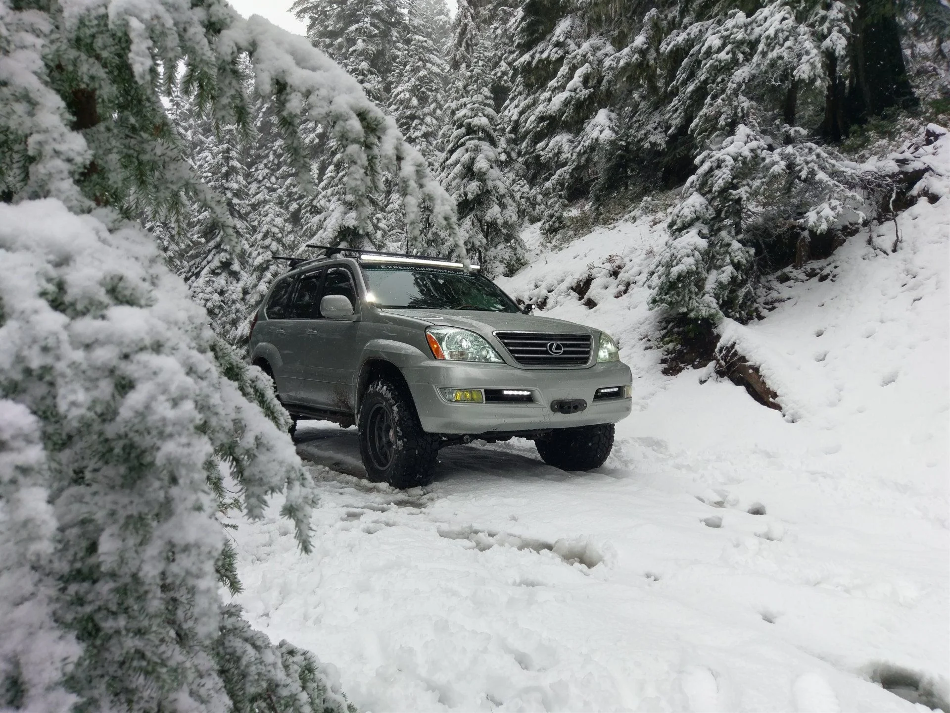

what wheels are theseanother one of my pictures that survived... 2017-06-19_01-37-51 by Isaac Yocum, on Flickr
Yeup I am working on tracking down a manifold to mate the two. I'll post details once I have it all figured outWait...did you just say you’re putting an M112 on this thing? I’d love to know more details. I’d love to have an M112 for either of our GX’s.
SCS stealth 6swhat wheels are these
SCS stealth 6s
