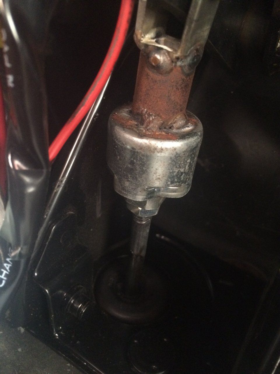

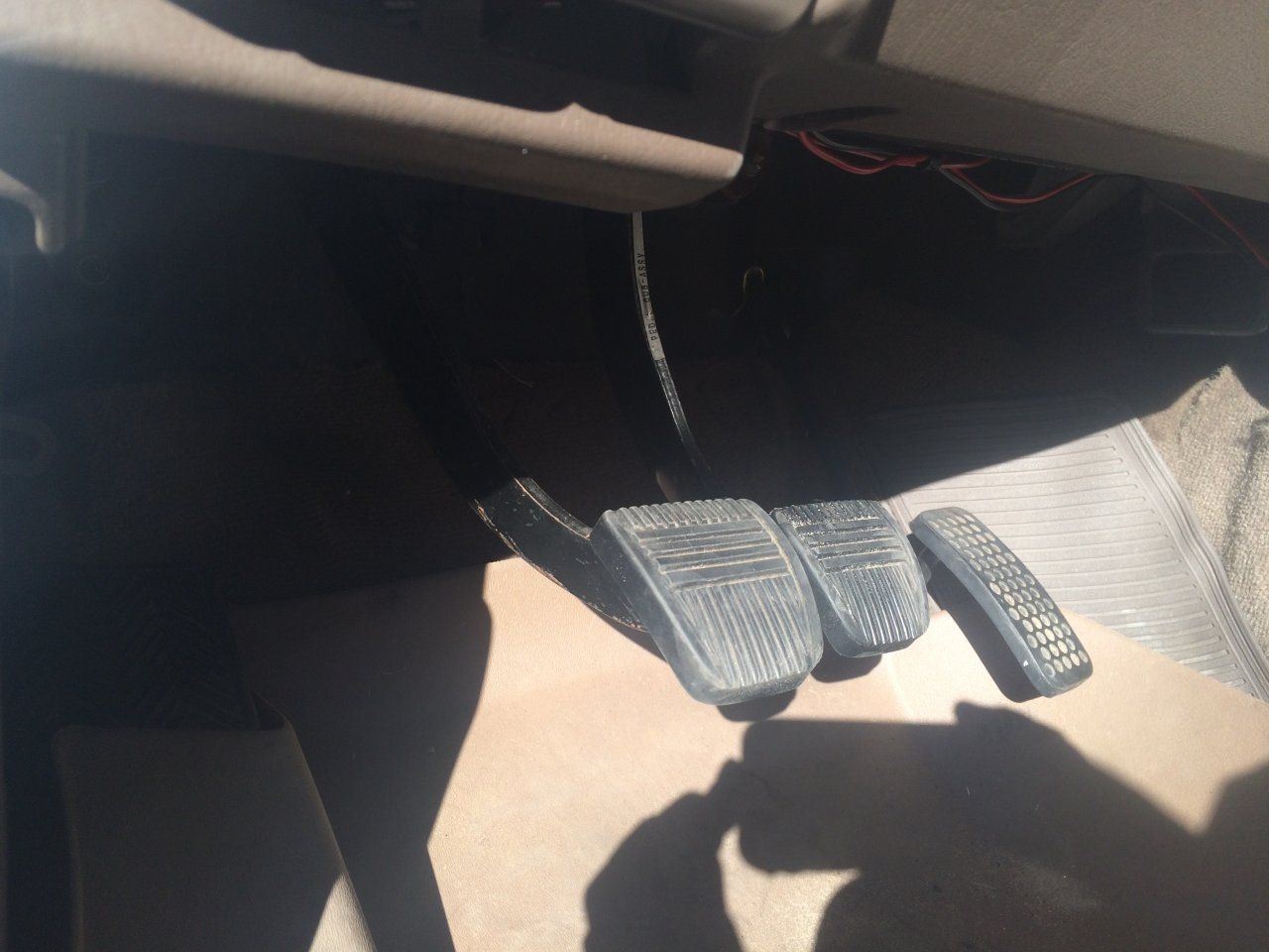

Will do. I do know my pedal was adjusted the best it could be but still sticks out a bit. Not on same plane as brake pedal.Thanks Cimarron.
Would you also be able to grab a snap of where your push rod attaches to your clutch pedal?

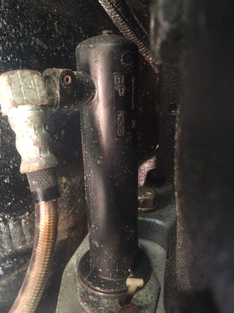

Unless I am not understanding some very basic fluid dynamic principals, the bore and stroke of a cylinder are fixed values, not variable and cannot be adjusted. The comment about lengthening the stroke, I assume can only refer to increasing the amount of the available stroke that actually gets used.
If for some reason the 80 pedals and master don't actually use all of the 80 masters available stroke, then I could see lowering the mounting point on the pedal slightly would result is more stoke being used. I'd be interested to see if your push rod is attached to th OEM hole on the clutch pedal, or if an additional hole has been drilled below it.
