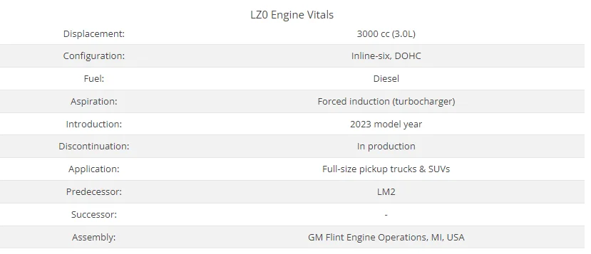

First, I should say that I don't know anything about diesels-- but I have been wondering when someone was going to put a 3.0L Duramax into an 80 series. Straight six, crazy power, crazy gas mileage. Seems like that would be a win win win.
I know they have some sort of oil pump belt that needs to be changed every couple hundred thousand miles, and people don't like that. And who knows what kind of computer they require. But everything else sounds like it would be awesome. The original version was called an LM2, but the new ones are called LZO. I am not sure what the difference is.
View attachment 3425774View attachment 3425775View attachment 3425776.
