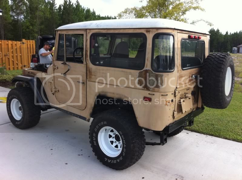

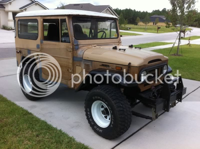

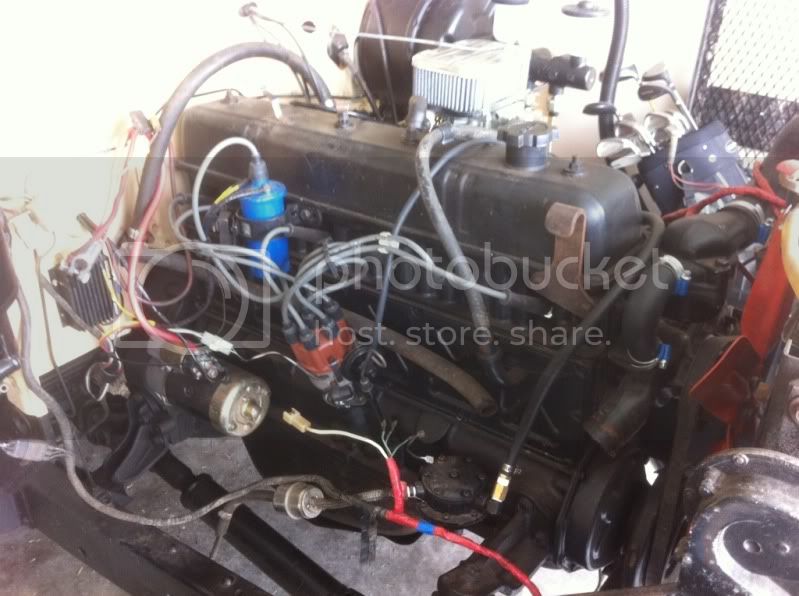

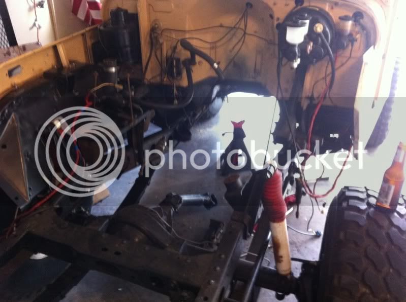

After I put most of the front end back together I decided I probably ought to take some photos
http://i80.photobucket.com/albums/j161/nickswan/62824a65.jpg
http://i80.photobucket.com/albums/j161/nickswan/a81fac89.jpg
http://i80.photobucket.com/albums/j161/nickswan/3ea03988.jpg
http://i80.photobucket.com/albums/j161/nickswan/9d863940.jpg
http://i80.photobucket.com/albums/j161/nickswan/acfd1a46.jpg

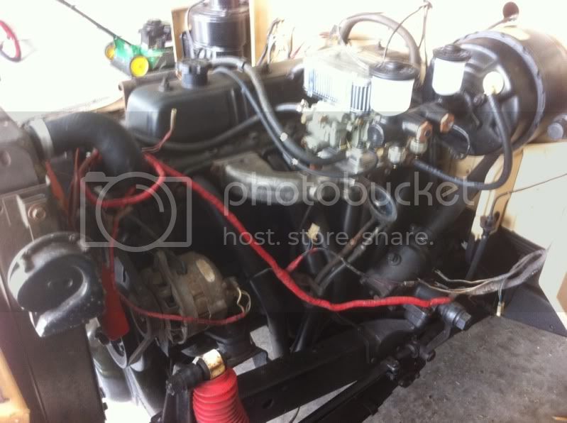

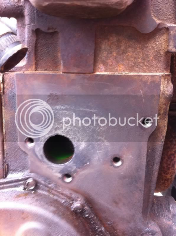

I ran out and bought all new fluids for everything and a new battery, got all the fluids drained and topped off, put some fresh gas in and turned the key. Click… “hmm, thats strange.” Click… nothing.
I grabbed a 12” extension put it on the crank nut and tried to turn it by hand. It started to bend but wouldn’t budge. I grabbed my trusty 3’ pry bar, put it on and gave it all I had, nothing.
I pulled the plugs and stuck a bore scope down into the cylinders but couldn’t see much other than a little rust on cylinder one. WTF. Quick call to the PO, no answer.
While im pulling plug wires to inspect them I pull up on the dizzy lightly and the whole distributer pulls up like it was never seated or torqued down…
http://i80.photobucket.com/albums/j161/nickswan/99fe20aa.jpg
http://i80.photobucket.com/albums/j161/nickswan/f0d3e9be.jpg
Judging from the freshly painted block and new accessories I theorized that he spent some serious cash having the motor rebuilt and never fully seated the dizzy to engage the oil pump, and ran it till it welded itself together. Then found some sucker (ME) to sell it to with a great sob story.

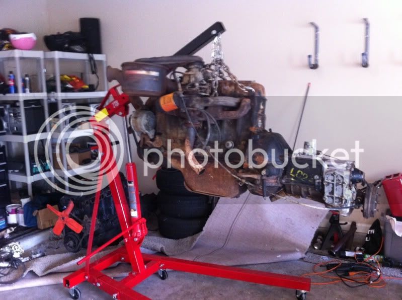

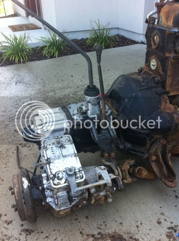

I posted my woes on MUD and found a great deal on a complete F.5 drivetrain out of a 73’ the next weekend it was sitting in my driveway. (Thanks Roma!)
http://i80.photobucket.com/albums/j161/nickswan/00fc9da6.jpg
it also came with about a hundred pounds of georgia clay
http://i80.photobucket.com/albums/j161/nickswan/594fed28.jpg

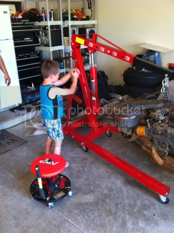

now i wasn't about to make the same mistake so i made sure this one started and ran before i even lifted it in. (Dont try this at home without securing the motor first)
50c73c96.mp4 video by nickswan - Photobucket
once that was verified it was time for the swap.
http://i80.photobucket.com/albums/j161/nickswan/6f4cf6d8.jpg
http://i80.photobucket.com/albums/j161/nickswan/dd616a3d.jpg
i got my best helper out to help me. (yeah no shoes...)
http://i80.photobucket.com/albums/j161/nickswan/97e5baff.jpg
oh look there is a 800lb black boat anchor in the background.

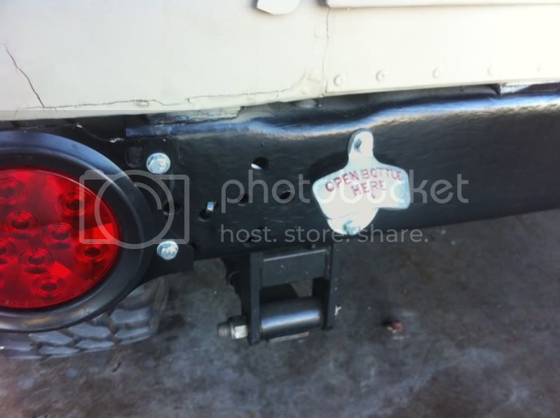

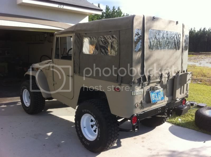

oh yeah, brake lights. i went with the LED setup but i think im going to switch to the oem style
http://i80.photobucket.com/albums/j161/nickswan/d2096fd0.jpg

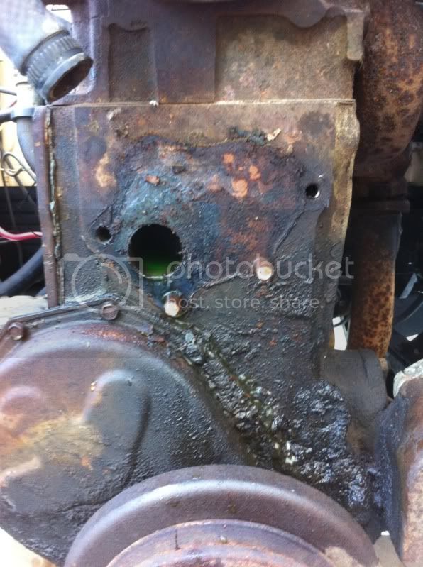

I noticed the water pump was leaking so i figured what the hell i've got another one sitting on this boat anchor of a motor. (how not to remove bolts)
http://i80.photobucket.com/albums/j161/nickswan/1cf45f36.jpg

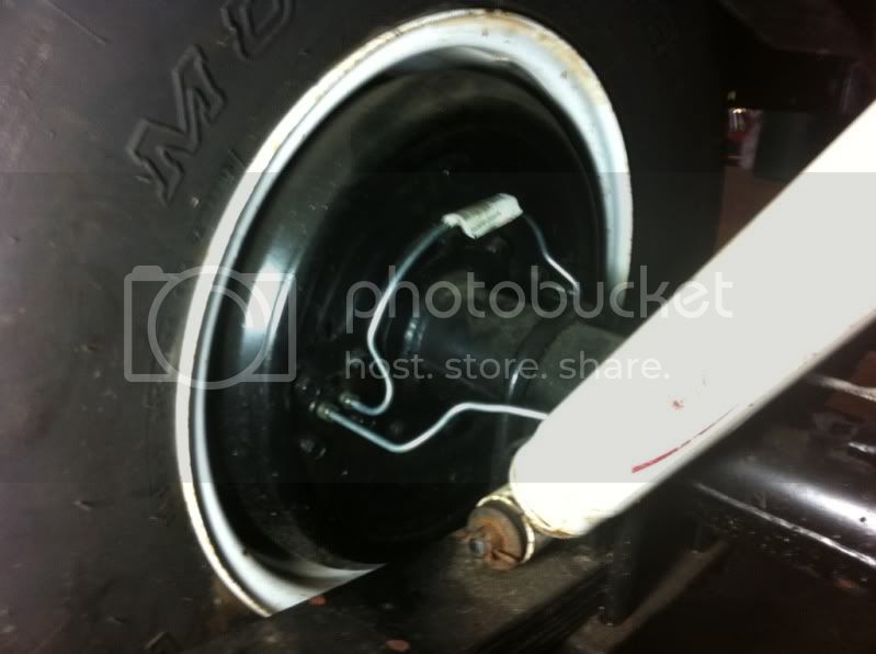

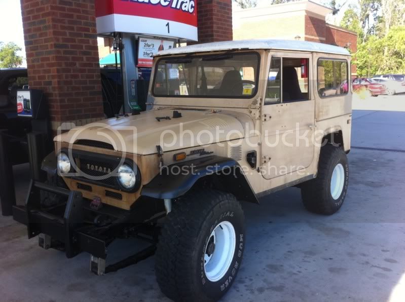

All new brake lines in and bled, time for a test drive

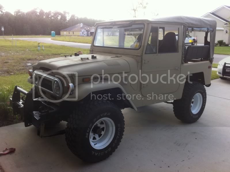

Her maiden voyage

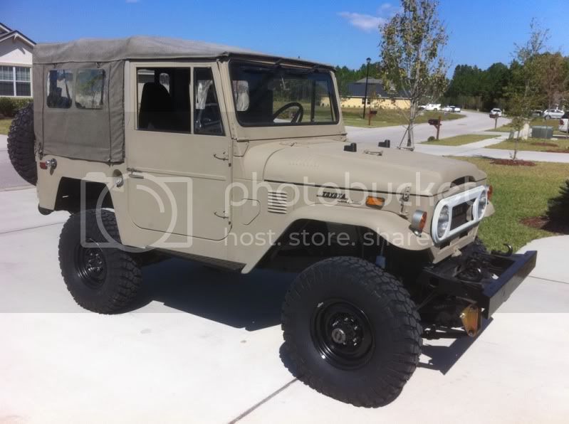

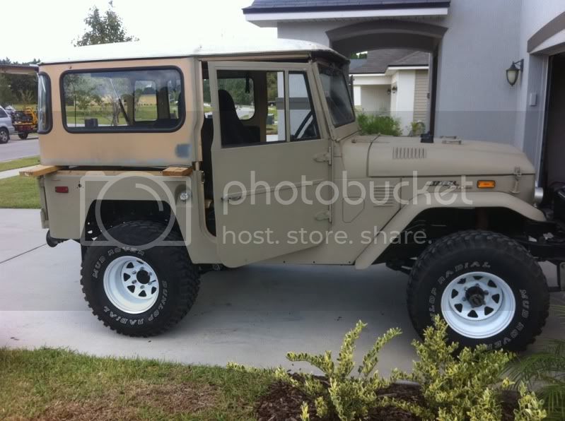

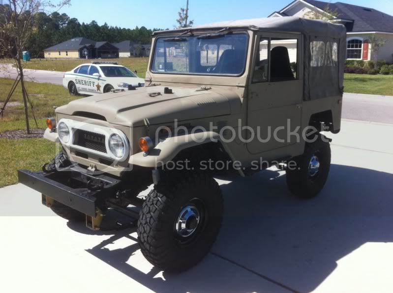

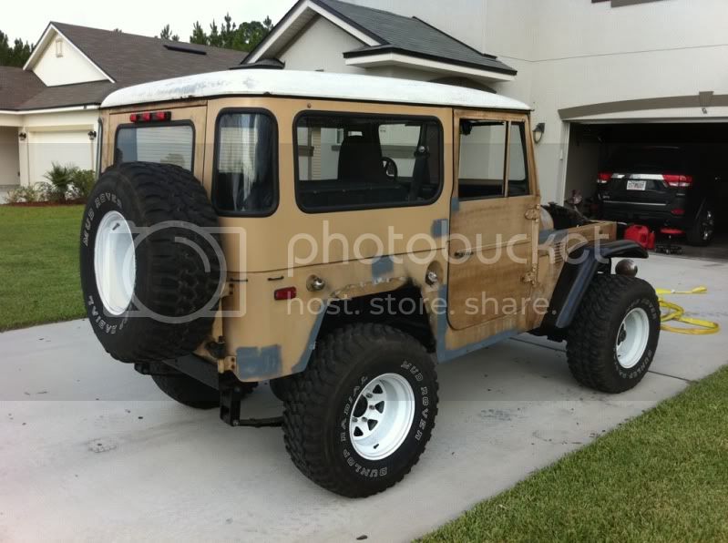

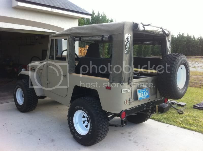

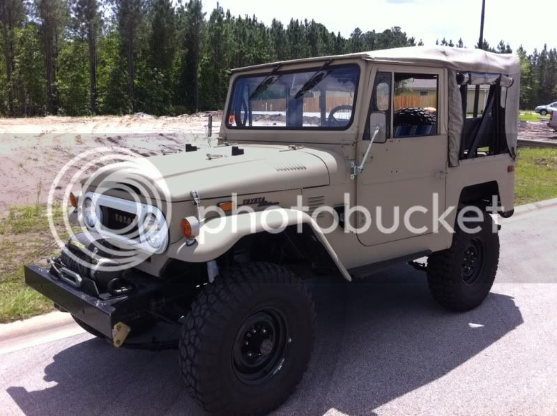

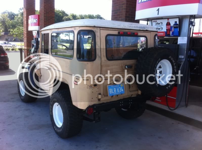

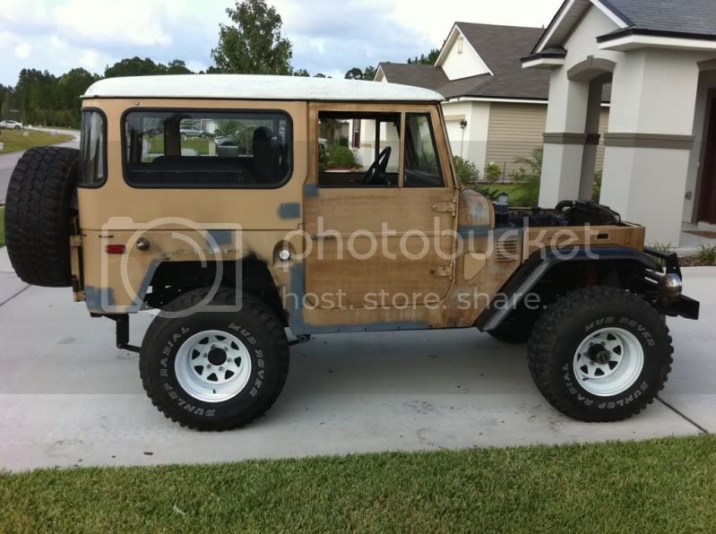

First drive observations: 40 year old drum brakes are going to need some adjusting. turning under-inflated 33x12.5 tires with manual steering will build muscle. It is way too hot in Florida for a hardtop. my patina paint job has got to go.
I picked up a couple cans of Flat khaki, and one can of white for the bezel.

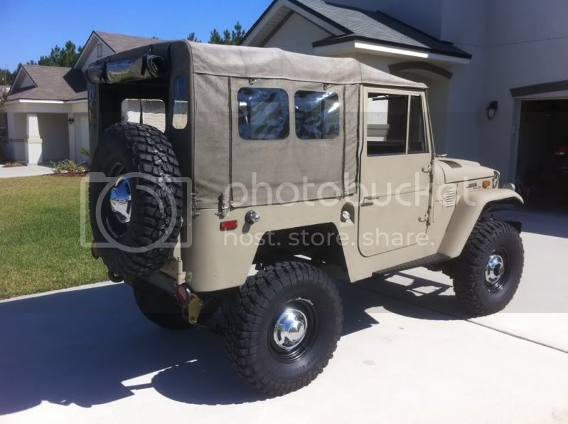

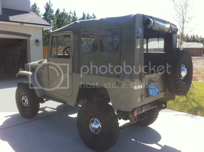

Then a fellow Mud member sold me a very nice lightly used Ehsan top.
Then came the single most important mod to date

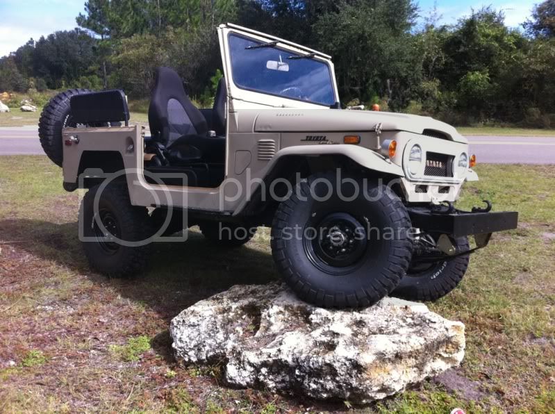

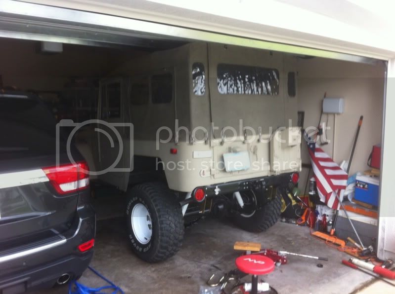

next on the list was a lift and some new tires/wheels. note to self- measure first, lift second. ever seen a 76" 40 in a 72" garage?

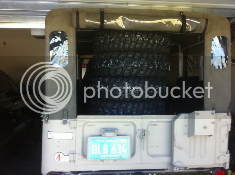

Turns out you can stack five 33x10.5 KM2 in the back

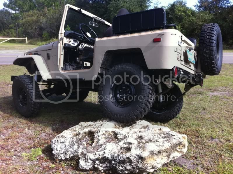

i went with the Rough Country 4" lift with anti-inversion shackles (I later went to a stock length anti inversion shackle and a 1" spacer drop in the rear) and stock steelies with 33x10.5x15 BFG KM2 MT tires. what a difference the 10.5" tires made, i have no desire to put power steering on currently.
No hub caps? i think it looks a lot meaner

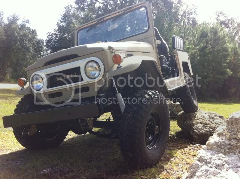

had to take it out and try out my new suspension
The front flexes really well, the back... not so much.

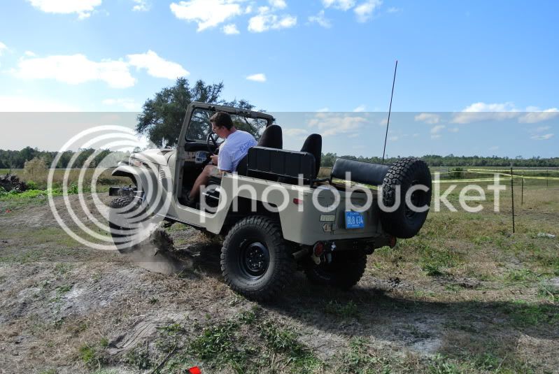

Time for its first Wheeling Event!

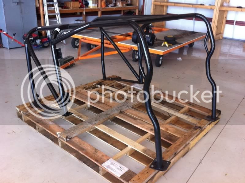

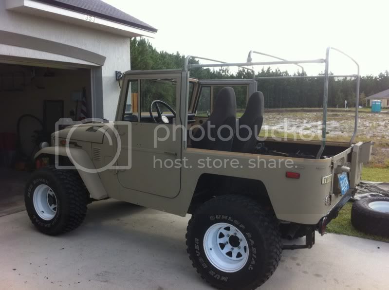

the wife wouldn't let the kids ride with me without a cage, so...
http://i80.photobucket.com/albums/j161/nickswan/1da6b013.jpg
http://i80.photobucket.com/albums/j161/nickswan/e2e8d60c.jpg

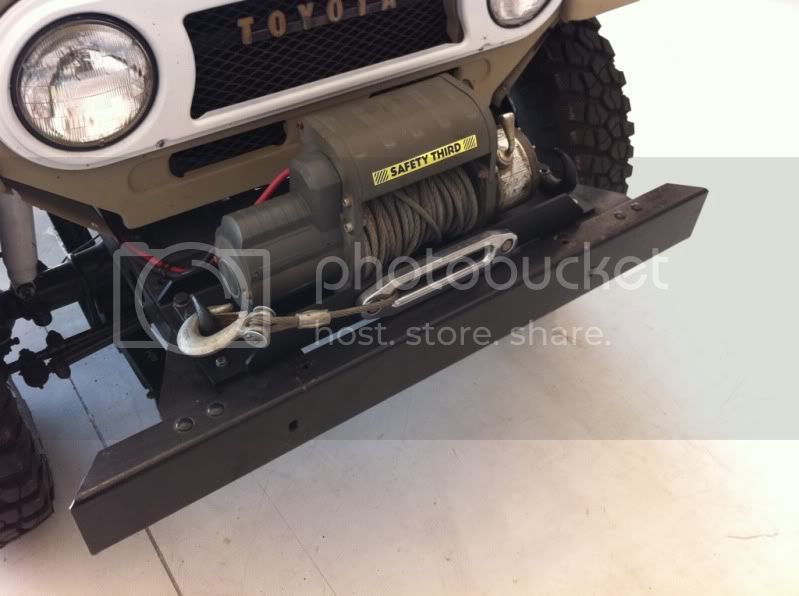

My winch has paid for itself a hundred times over and i couldn't afford an 8274 just yet.

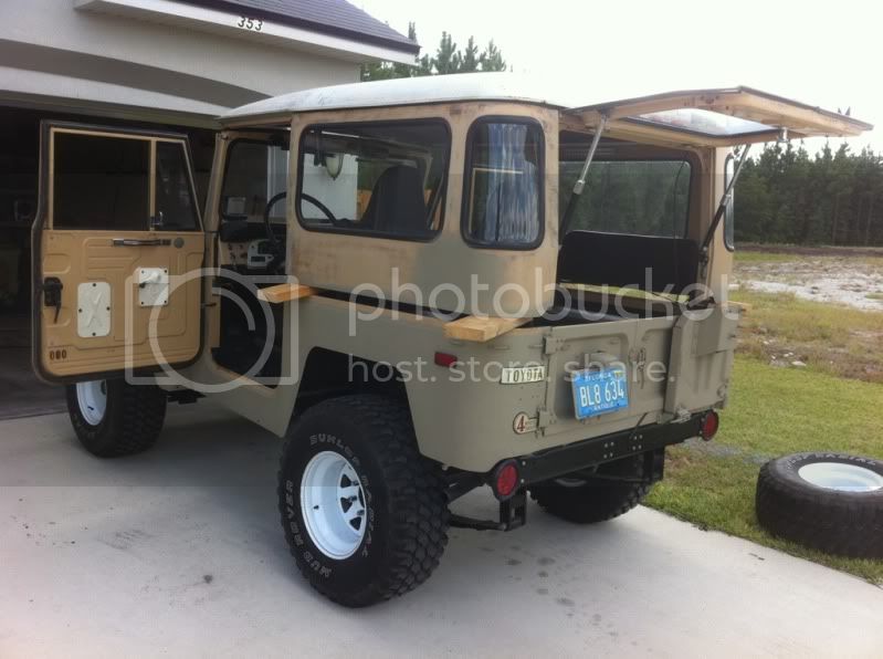

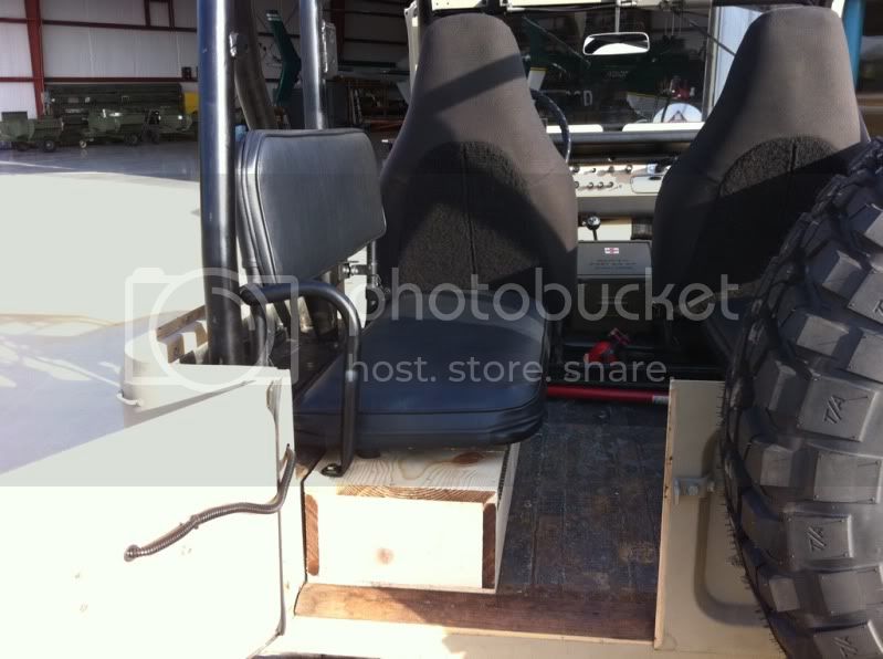

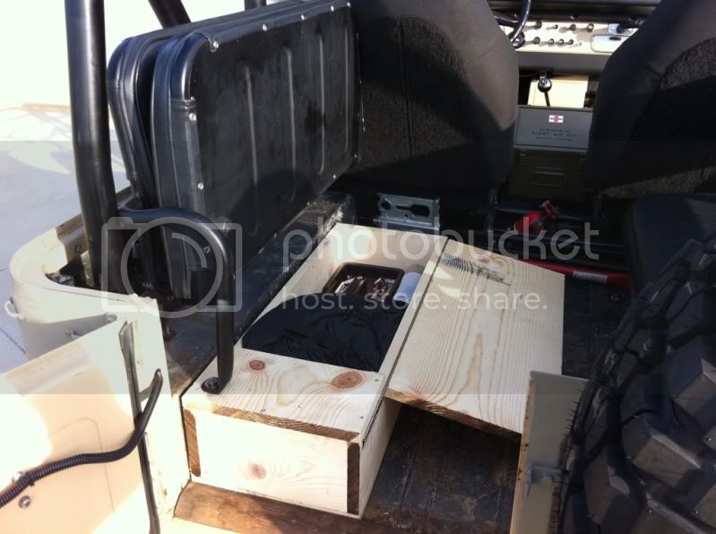

my next problem was how to get the jump seats in with the cage. i built these storage boxes and anchored them in.
http://i80.photobucket.com/albums/j161/nickswan/a152f1c7.jpg
http://i80.photobucket.com/albums/j161/nickswan/310180bb.jpg

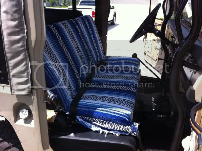

whoever put those seats in must have been vertically challenged because at 6' i have to duck down to see traffic lights. thanks to MUD again i acquired some seats out of a 70' that will need to be recovered. but until then nothing a Mexican blanket cant fix.

Cage looks great! Was it bought? Built? Brand? Price?

Lightly used metaltech family cage, I also have the front and rear frame tie-ins that I need to weld up as well as the hip bars. MT has their pricing up on their website depending on what you want. It's the best available in my opinion.
