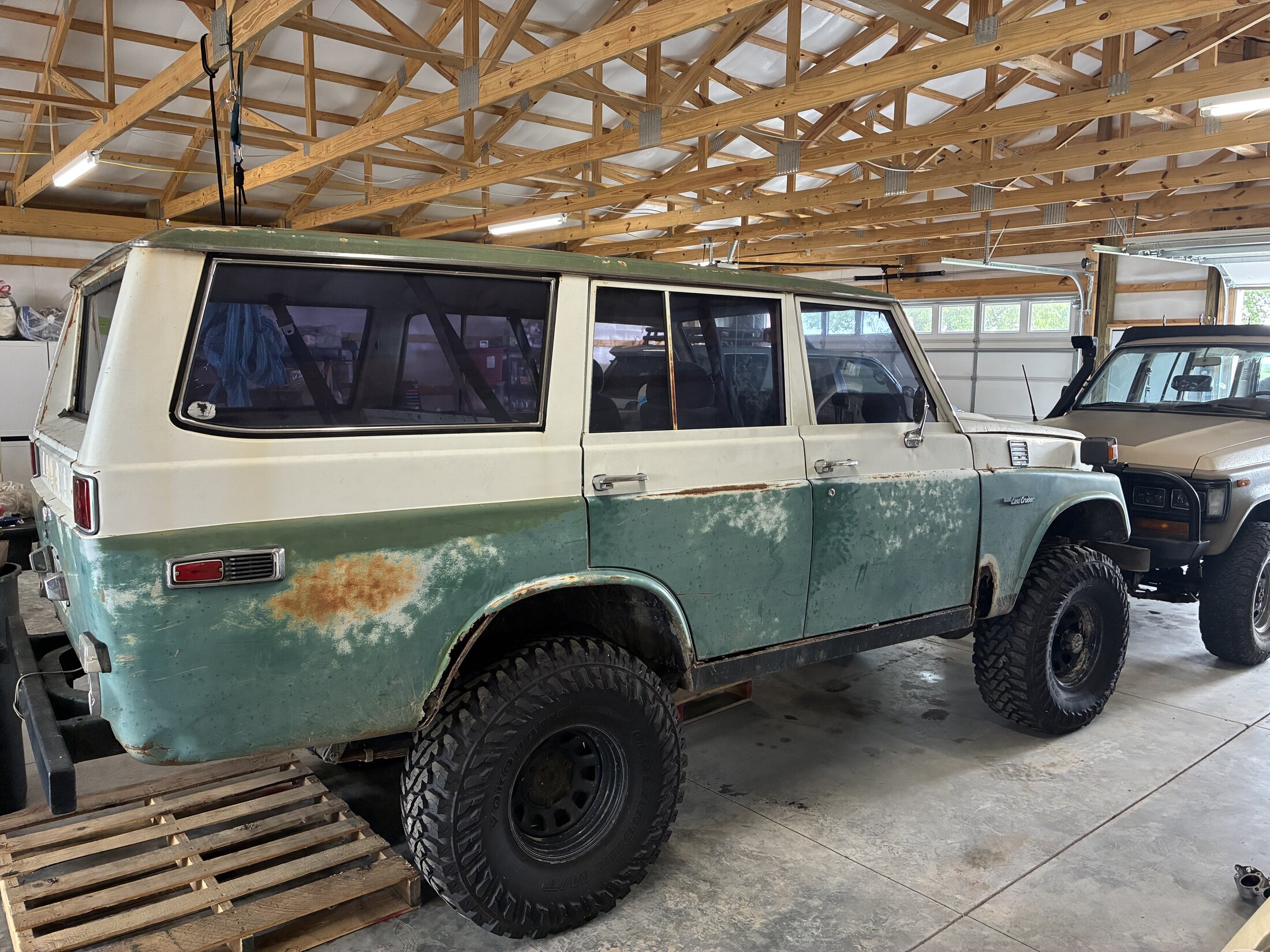

Laying things out today and organizing my thoughts on the Zeke restoration.
Lots of other goodies that @120mm threw in with Zeke too. I’m going to get the old feller looking good.
Zeke… as he sits (and runs and drives):
