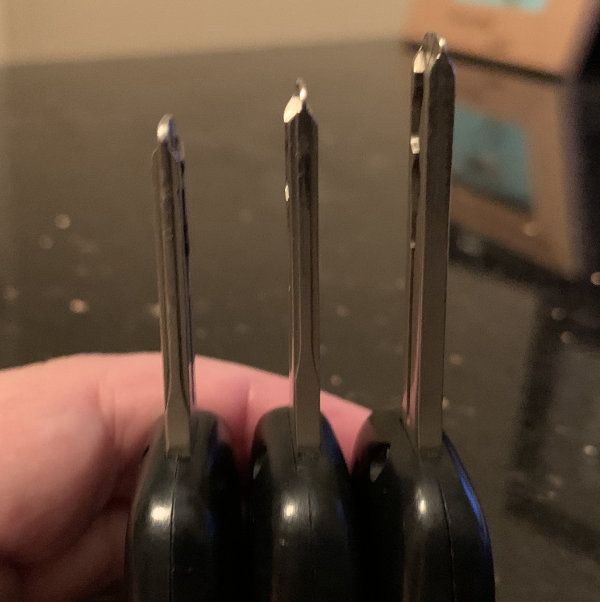

So, I have read that this works with short/long and U/I/T shaped keys.
I think all mine are I or T based on the threads, but I appear to have a short, medium and a long one. I didn't know there was such a thing.
Before I cannibalize one, is there anything else I should know here?
EDIT: Longest one was a T, and the kit works perfectly. A long handled razor blade makes cannibalizing easy breezy.

I would check to make sure whatever one you want to break open has a metal thread in the screw blade. If you take out the screw in the back you should see metal threads the same color as the key (brass). If you see only black plastic, that's a u style. Leave that one alone and try another. The u styles are the worst to use as a donor. It works, but it's not ideal. Having a threaded hole in the key (like I and t styles) helps a ton with stability of that blade in the YotaMD kit. If through some unlucky string of coincidence you have all u styles you should buy a fresh blank from my store. I sell them at cost as a courtesy.
Aside from that, should be all good. Key length is not an issue.

Got it, thanks and will do. They are all metal threaded, I was just a little thrown off by the 3 lengths.
