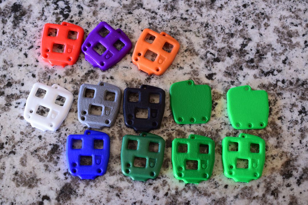

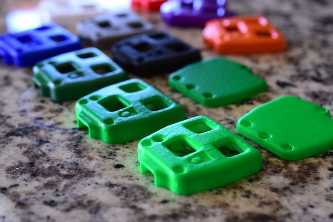

@geanes Check it out. How's the color?! I'm calling it Radioactive Green. The far right is the best iteration. The leftmost green is my latest green as dyed by the printer. The middle one was my first attempt with the custom paint. I laid down too much paint and it got too dark. Rightmost is the winner. light, even coats yielding a full, smooth color, yet retaining the brightness of the white underneath to really make it pop.

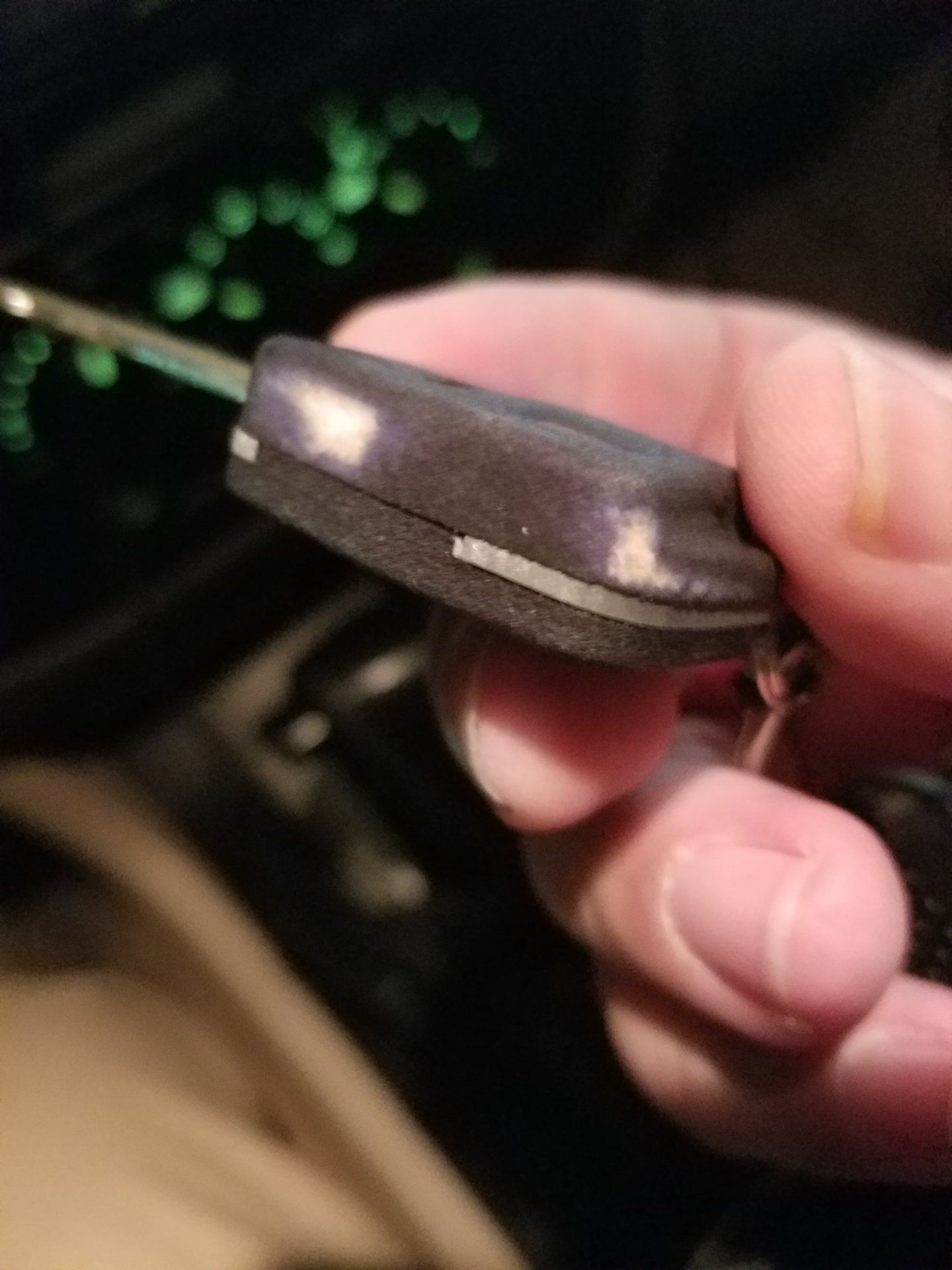

I got mine Tuesday and am loving the fact that I don't have to break superglue apart to change the batteries any more. One question though it looks like the paint (?) is coming off is that possible?

With the exception of the green in my last post, they are all dyed so there's no paint to come off. Maybe it's the clear? Post a pic or PM me. Let's see what you're talking about.
Here you go...

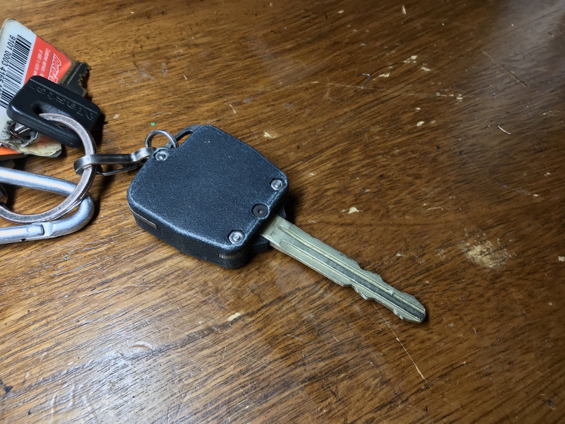

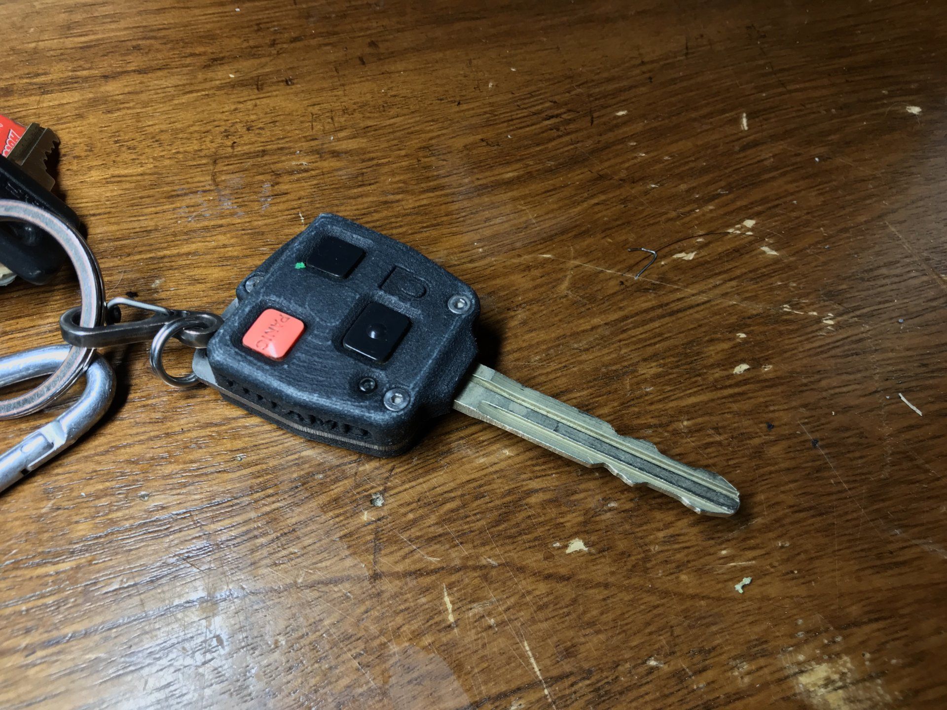

What has everyone done to secure the screws? Did anyone use a dab of loctite? I LOVE my key, but recently noticed it had gotten loose and when I went to tighten it up realized it was very loose. I am happy to just know that I need to tighten it up every couple months or so, but just seeing if anyone else had done something to secure the screws more permanently.

@suprarx7nut ... You're the MAN! That far right one looks dead-on! Radioactive Green! When will it be available?

I like your darker green, closer match to the truck. Would that be available since it's as delivered by printer?

The darker green is the standard offering right now. It does vary in shade a little bit, but is always darker than the two special ones I posted in post 402. If you're only interested in the darker green, let me know beforehand and I'll hold one aside for you that's specifically darker.

I've thought about this as well. I've been using the same tester key for about 6 months and haven't had any screws loosen, but I'm sure it's bound to happen for some folks at some point. Some of the lowest strength loctite is probably a good idea, but I wouldn't go any stronger. You don't want it to be permanent!

Had to re-tighten as well. I feel the screws could be like 1 mm longer. They don't go all the way through the nuts, and I'm afraid of tightening too much with only one thread (one revolution) contact, but they do keep up fine as they are.

Yeah, I know exactly what you're talking about. Screw length and nut pocket depth were a never-ending back and forth during the design phase. That one attribute was responsible for more than 4 different revisions of the part. The core issue is that the remotes are varying height. Some people have little screw engagement (but should always still be enough to hold) while others will be right on the edge of having too much screw poke through the nut. Current state seems to be the best compromise, but I'll consider dropping the nut height 5 thou (0.13 mm) or so to ensure everyone's got good engagement. Any more than that and those with the thinner remotes will have screws snagging on clothing as they come out the backside.
The nut is 1.6mm tall with a pitch of .4mm. Best case scenario there are 4 threads of engagement. Realistically, the screw has a tiny lead in, as does the nut which only leaves 2-3 threads of real engagement. Toss in some remote thickness variation and it's a game of fractions of a millimeter.
Of course, if anyone finds the engagement problematic, let me know. I'm happy to get it solved with replacement hardware or even a special plastic set if you've got an oddball remote that's really not playing nice.
