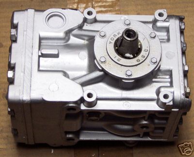

What mechanism allows for the adjustment of belt tension?
The bolt holes for the compressor are slotted for up and down movement which gives you tension.

I was looking around and saw some with serpentine pulleys. Do you think a pulley from the Supercharger set up would work with this?
Anyone with a SC willing to measure the diameter of that for me?
Sorry, I wish I had a supercharger. I have a line on making a 3 groove 1 piece billet pulley to replace the stock 2 groove. I will report back. Now I got to finish the system.
lx450landcruiser said:
some one could ask alia hes done this mod awhile ago, in fact his bracket looked very similar. i want to say hes running the super charger pully but dont quote me on that
It is indeed similar and I'm not running a supercharger pulley. The cost of one of those pulleys is more than my whole setup :eek: I also cut the middle out of a pulley and welded it in front of the current pulley. Mine was a LR water pump fulley :D
Even though my holes are slotted, I am going to install a real tensioning system by using a tensioner pulley from a Nissan something or other (can't remember what car I pulled it out of!). The biggest problem I have is installing a new belt w/o any tensioning device; makes for a challenging belt install over the two pulleys!

Won't going with the supercharger pully mean you have to buy in to all of the supercharger fan troubles?
Just curious.. what's the impact to engine load & mpg? And is it always compressing air, or do you switch it on? Sorry, I don't know squat about OBA, but your bracket looks sweet so of course I now want one. :cheers:
You turn the system on with a switch when you need it. No effects on load or mpg. The power for the compressor goes through a pressure switch so when your air pressure reaches a pre-set psi, it cuts off. Hope this helps to explain.
