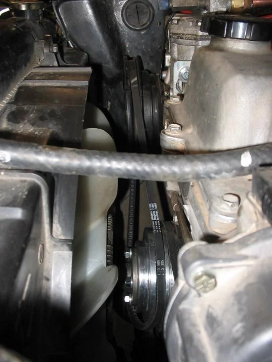

Did some testing today with belt sizes. Got the perfect fit. Belt runs straight and true! Cranked it up and pumped up to 125 psi in no time. It helps to turn on your A/C for the higher idle. Looking forward to many installs and write-ups!

Help - where do you get that pulley?

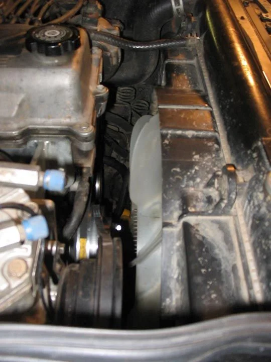

Got mine installed today, finally. But my pulley is sticking out way too far to work with the bracket.. in fact I've got three pulleys and they're all the same. In your pic above your pulley actually has two locations.. I need the "inside" track and I've only got "outside."
Tried it anyway, pressure got up to about 45psi then the belt popped off the water pump pulley. I've got like 2 days until I need to drive the 80 again, where can I get one of those fancy pulleys? Or any other ideas for how to move the whole compressor "back" about an inch? :confused:
stealing one of your pics from above to make the issue obvious... .

Go scrounge around junkyards till you find one. I pulled a york off a late 70s diesel mercedes with the exact same pulley and a working clutch... it took forever to find but the compressor seems to be in great condition.
I think I'd try to find a two "track" pulley before modifying the bracket. Try NAPA. They had a bunch of YORK parts in their catalogue. Or as NaterGator said: try a junkyard.
