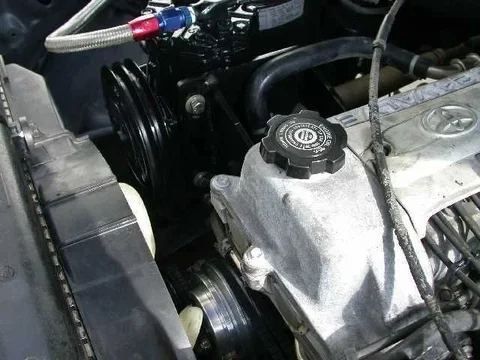

F'n outstanding!!! Any suggestions on the intake of the York for those who don't have the pair valve and that nipple on the air can.
I would just route a hose to the fenderwell and put a small K&N filter on it. I just did mine this way because it was there. Also you could drill a hole in the air cleaner and weld on a fitting.
Rick,
You can drill a small hole in the bottom of the air filter can and extract air out of there for the York. I did this and it also made the sucking sound of the York completely gone.
Here's a picture: http://pg.photos.yahoo.com/ph/alia176/detail?.dir=927e&.dnm=c34b.jpg
Ali

Thanks Ali, I like where you placed your tank. I was going to aks for ideas once I got the hardware in. Great looking install.
Rick,
All this talk of heat under the hood has me wondering if I'm actually reducing the air flow to the radiator by the air tank placement. You guys are messing with my mind too much as of late :flipoff2:
Ali
alia176 said:
Rick,
I would say yes! It looks like it is directly blocking the vents in the ARB.
