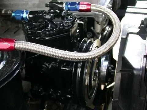

Just a little update. Bracket parts are back from the laser. Next is welding them in the jig and coating them. The pulleys are being machined now. Getting closer.

Ok, brackets are welded. Now its time for a little clean-up and off to the powdercoat shop. The pulleys are being machined now. Should be finished by Thursday.

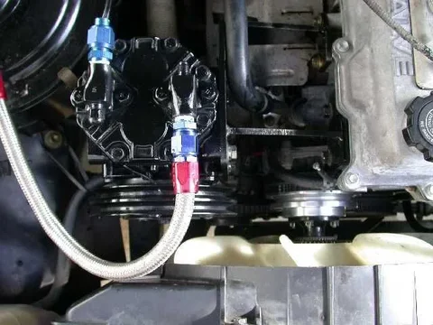

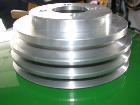

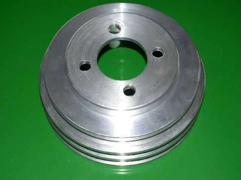

Bling Bling has arrived! Billet aluminum pulleys! I went ahead and painted my stuff, but all the rest will be powdecoated. Lined up perfect. All thats left is sizing the belt. Sorry for the dirty engine. I promise to clean it one day.
