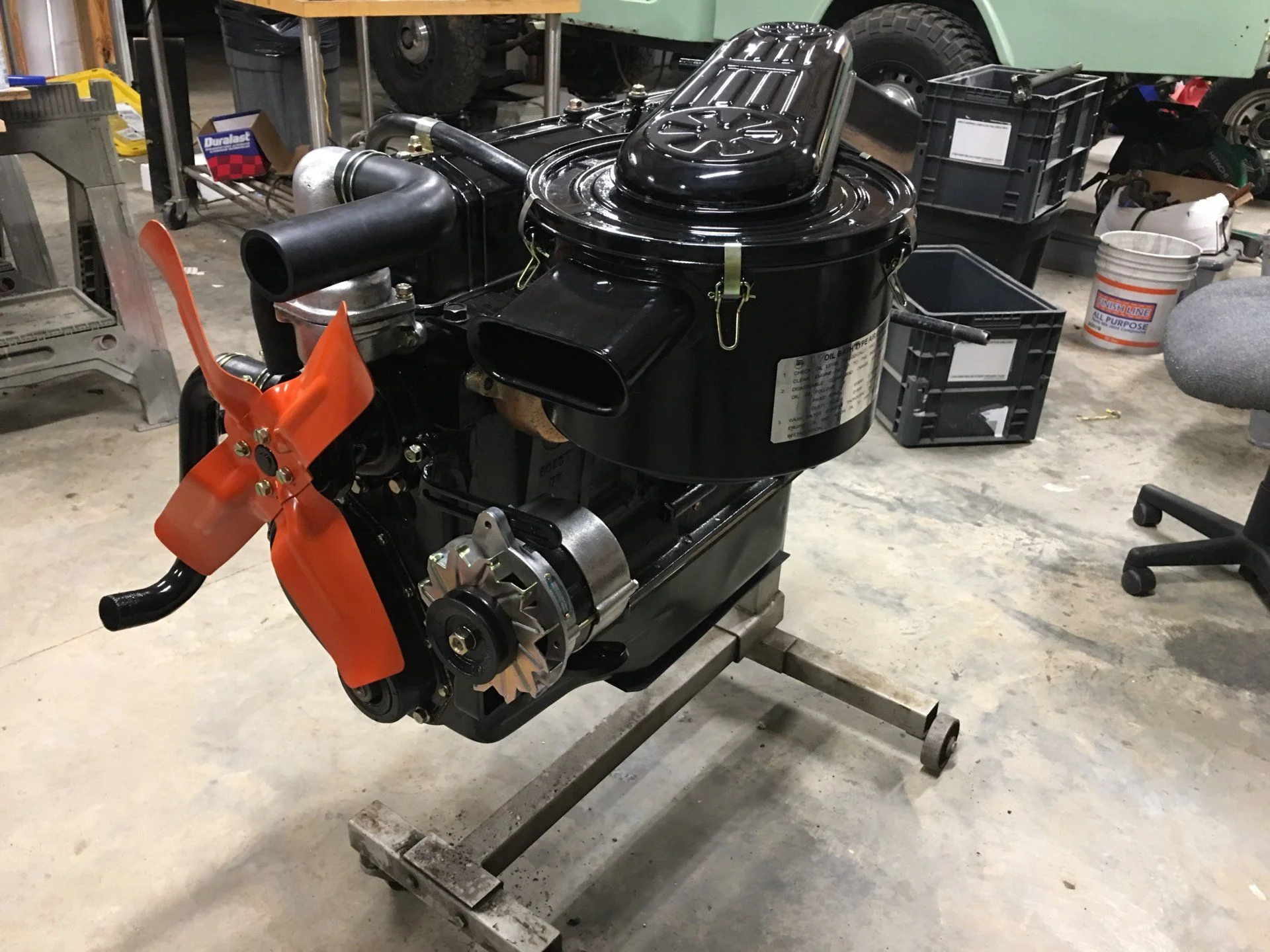

This is the part of the build I really enjoy... reassembling nice clean parts is instant gratification at its best :D

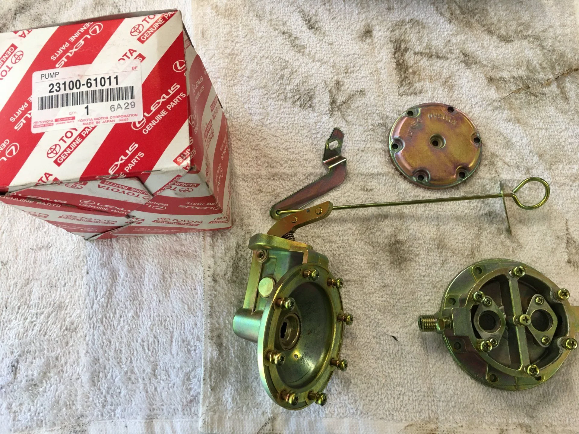

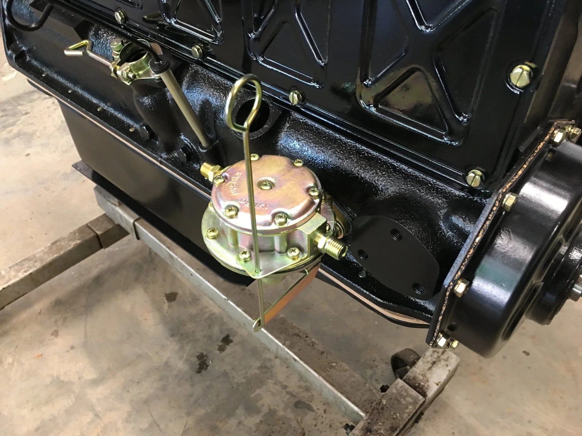

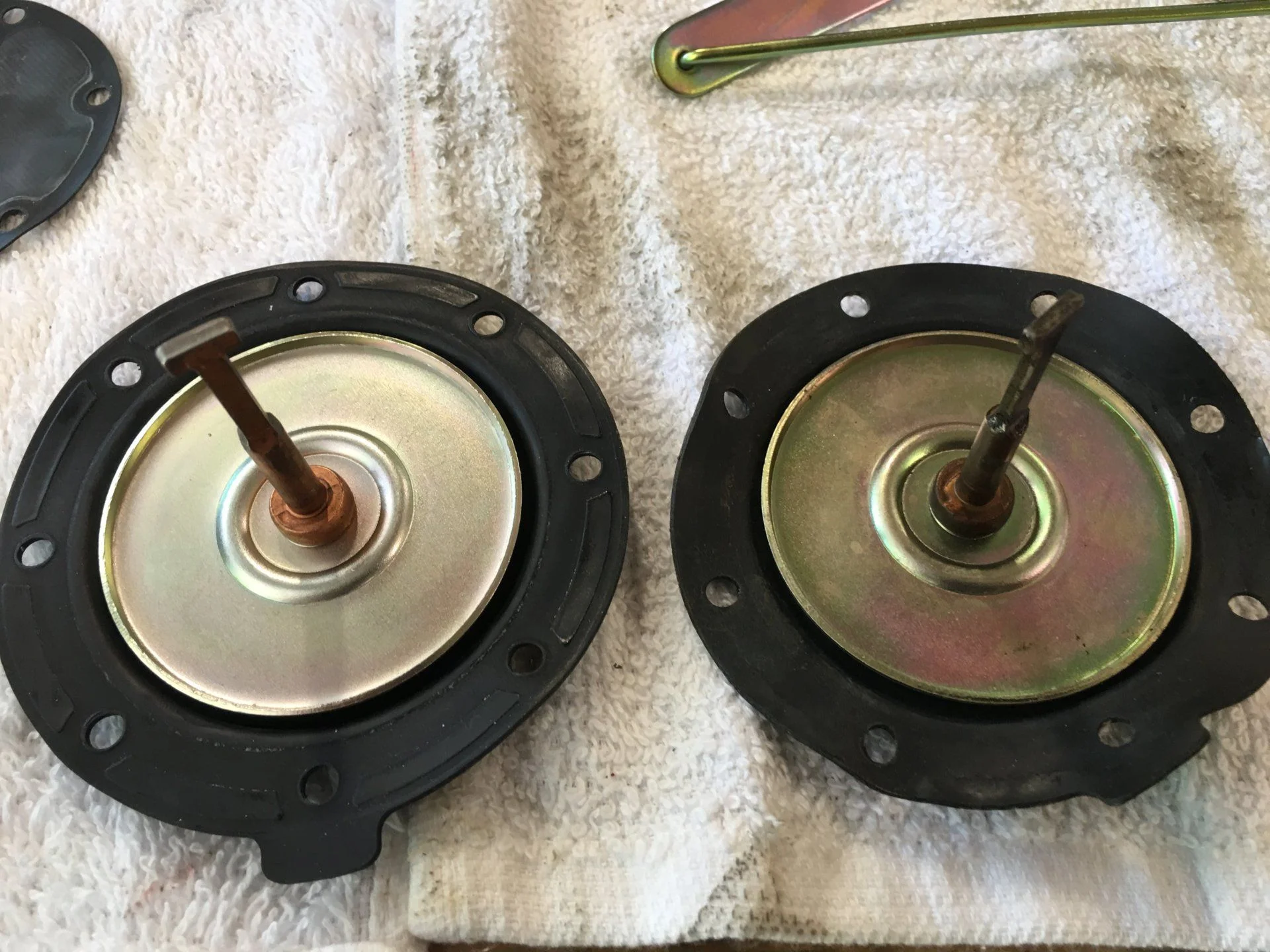

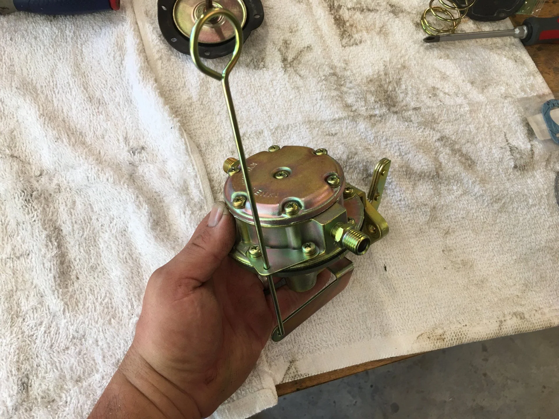

Had the the original hand primed fuel pump plated but the internals were tired so I sourced a new late model 40 OEM pump from Racer65 to scavenge the intervals from.

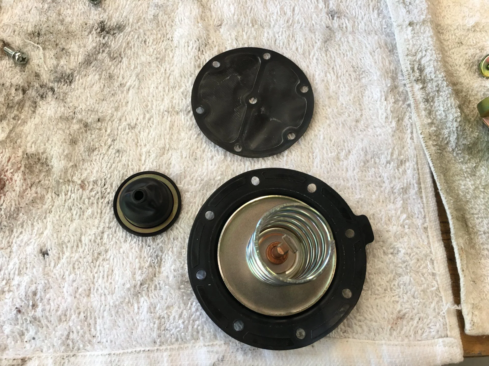

New innards, though the old weren’t torn they were pretty dry and not nearly as soft and plyable as the new.
New left, old right
Ahhh... just the way it left the Kyosan plant in ‘65

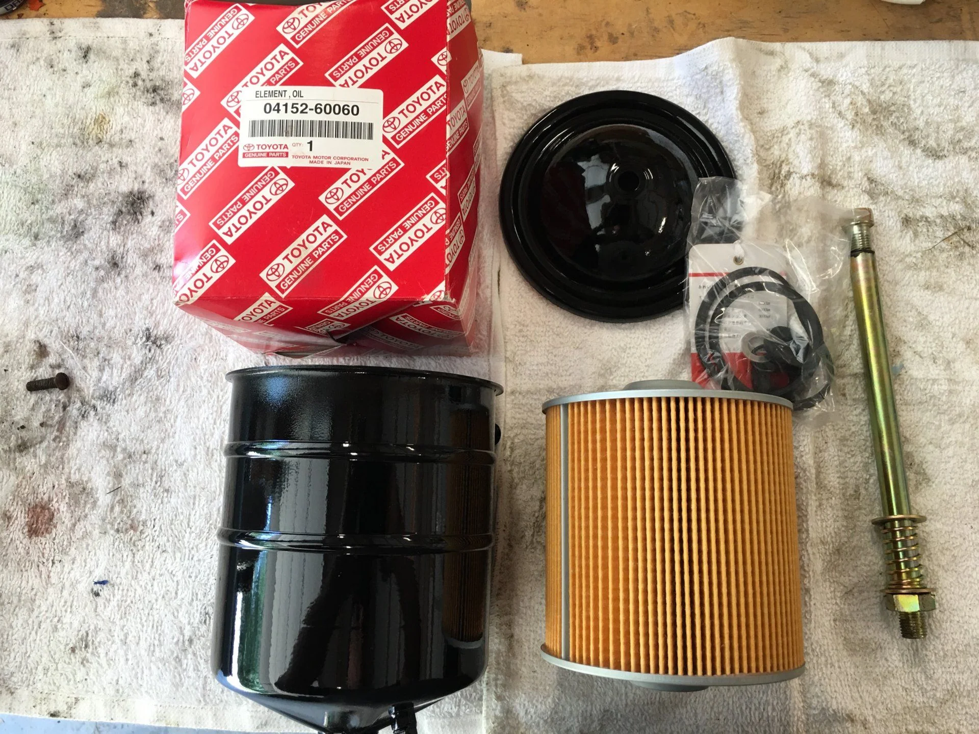

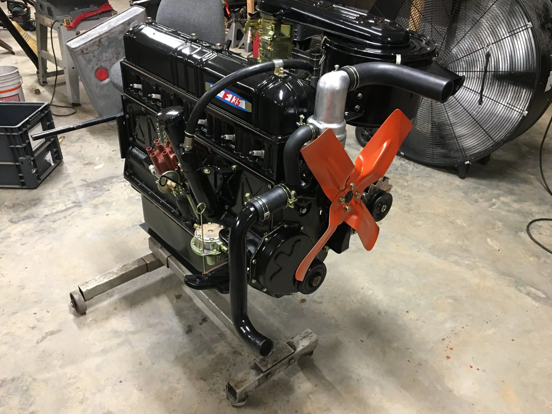

Oil filter housing all cleaned up, new repo decal and NOS braided oil lines.

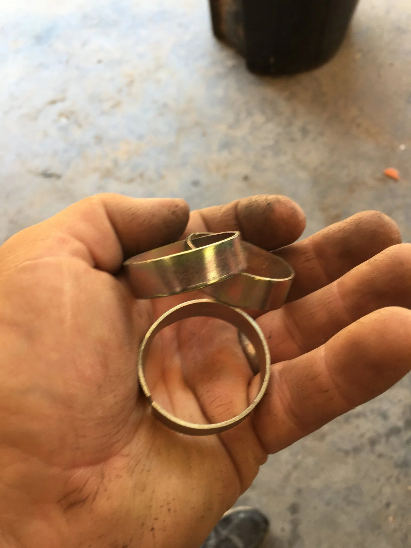

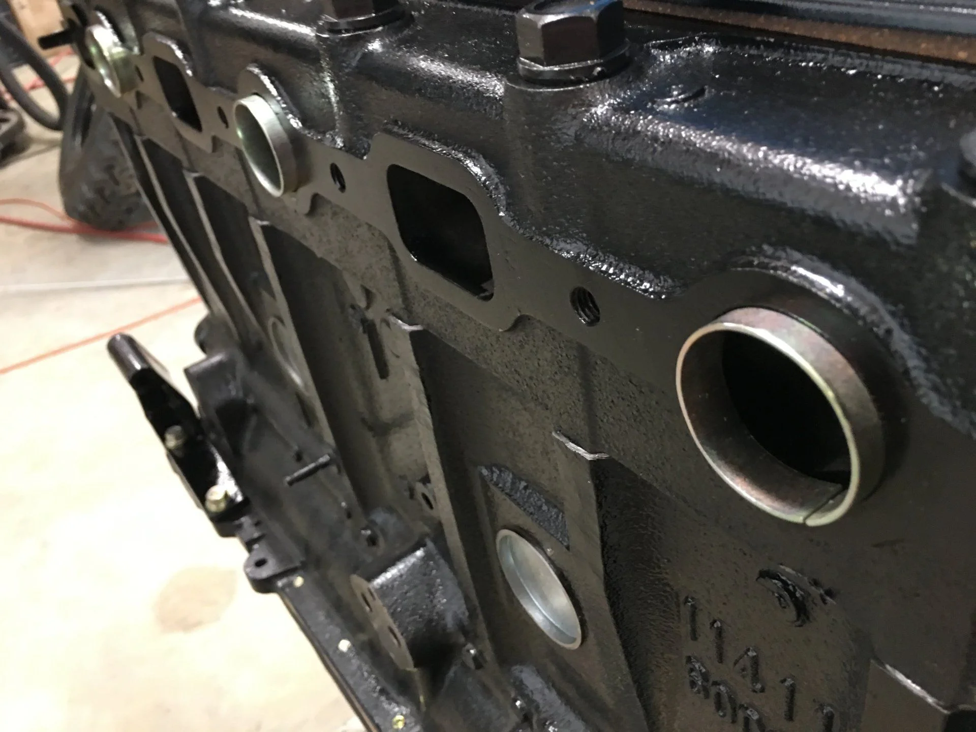

Intake manifold collars

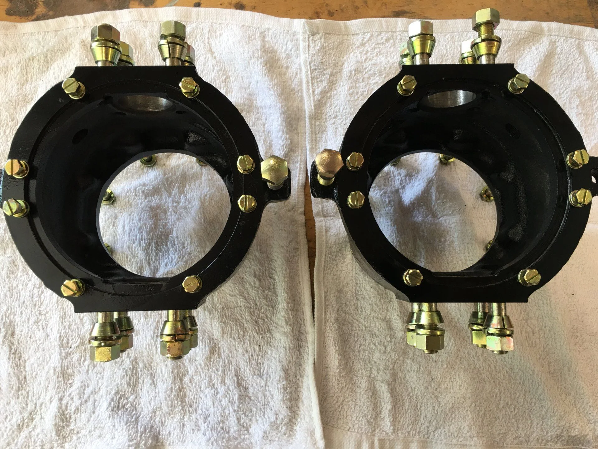

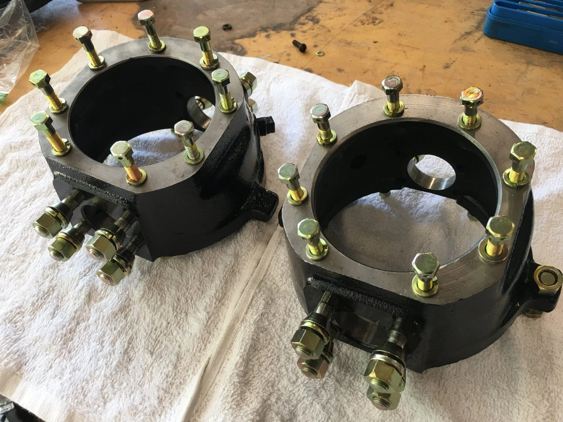

These knuckles are almost too purdy to put back on might just keep them to hang as ornaments of my Christmas tree, the wife would love that :grinpimp:

135 Horse Power.... can’t wait to put those ponies to the ground.

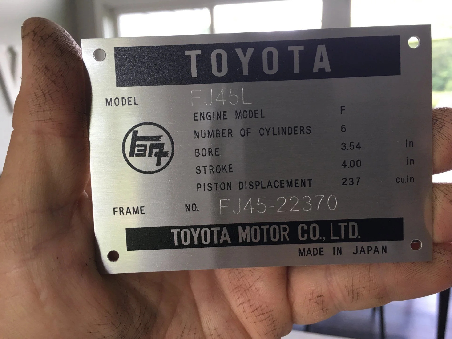

Got this icing on the cake bit today in the mail today... big thanks to @RAGINGMATT

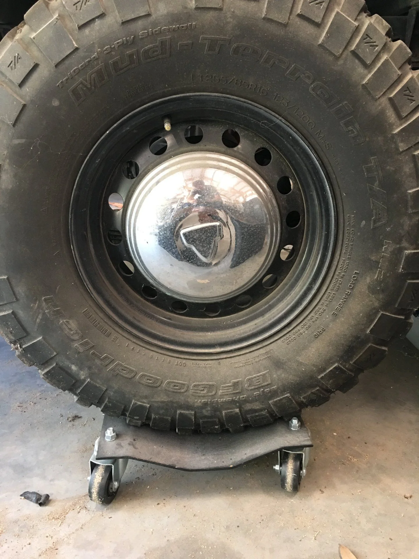

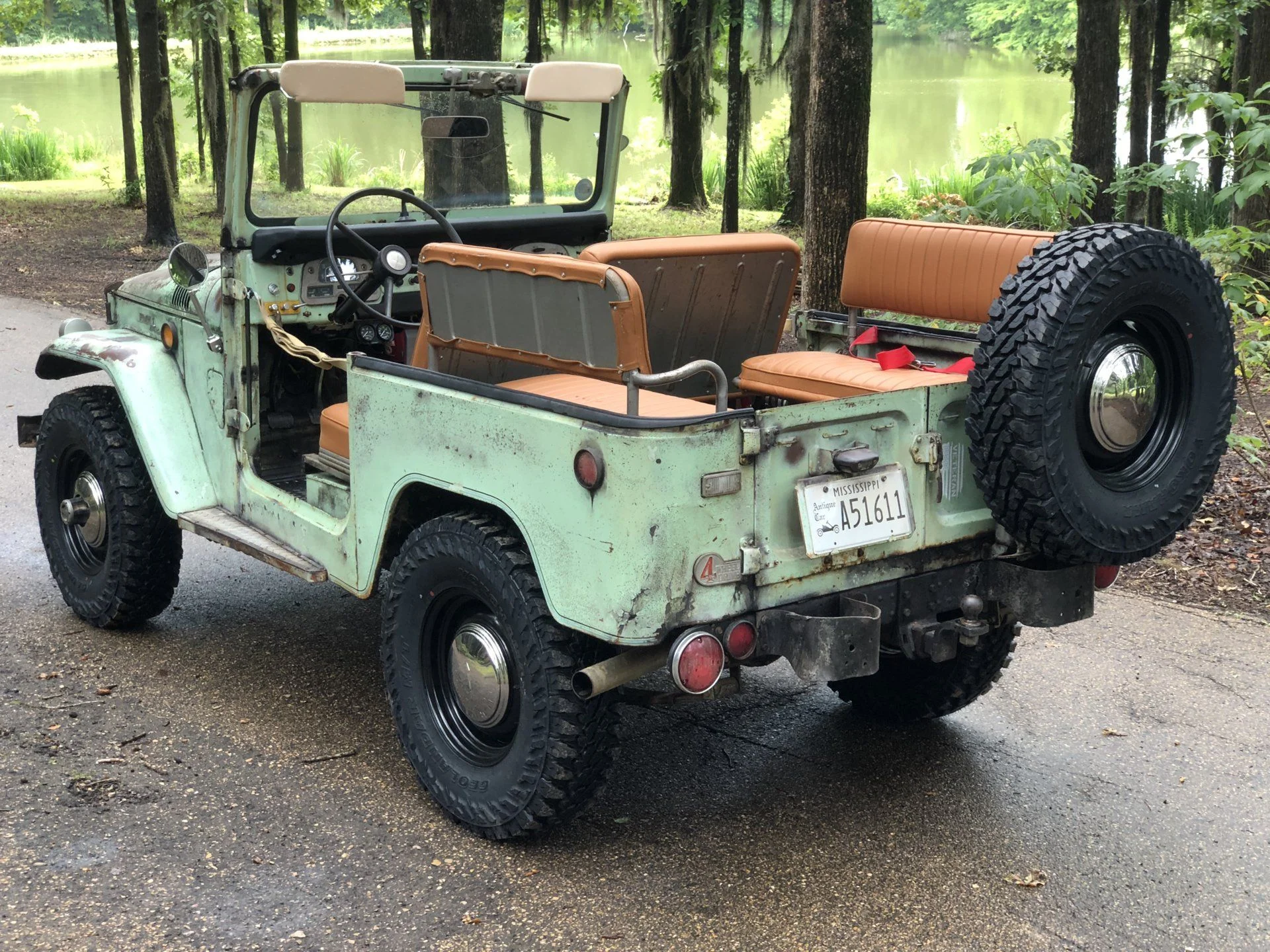

Are those 16" FJCruiser steelies with hubcaps in the background? Sorry to sidetrack.. I love the attention to detail!
Good eye. They are indeed well actually early 2000 tundra take offs. I weld tabs on off a 40 rim to hold the hubcaps on. I really wanted to run 255/85/16s and stock acorn hubcaps to keep an original vibe going.
City Racer has the answer.
I just did it on my 40
235/85/16 Yokohama MT
