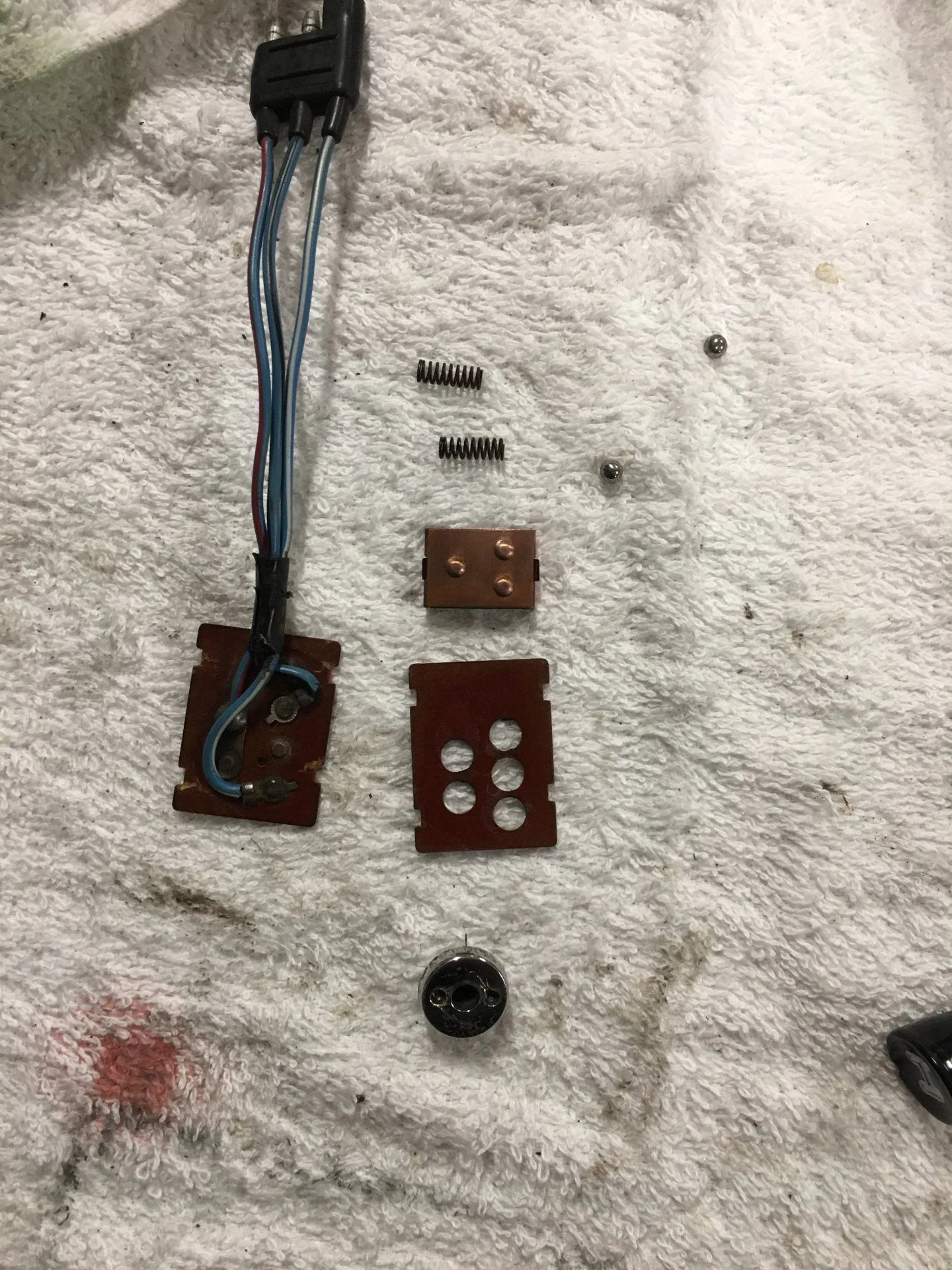

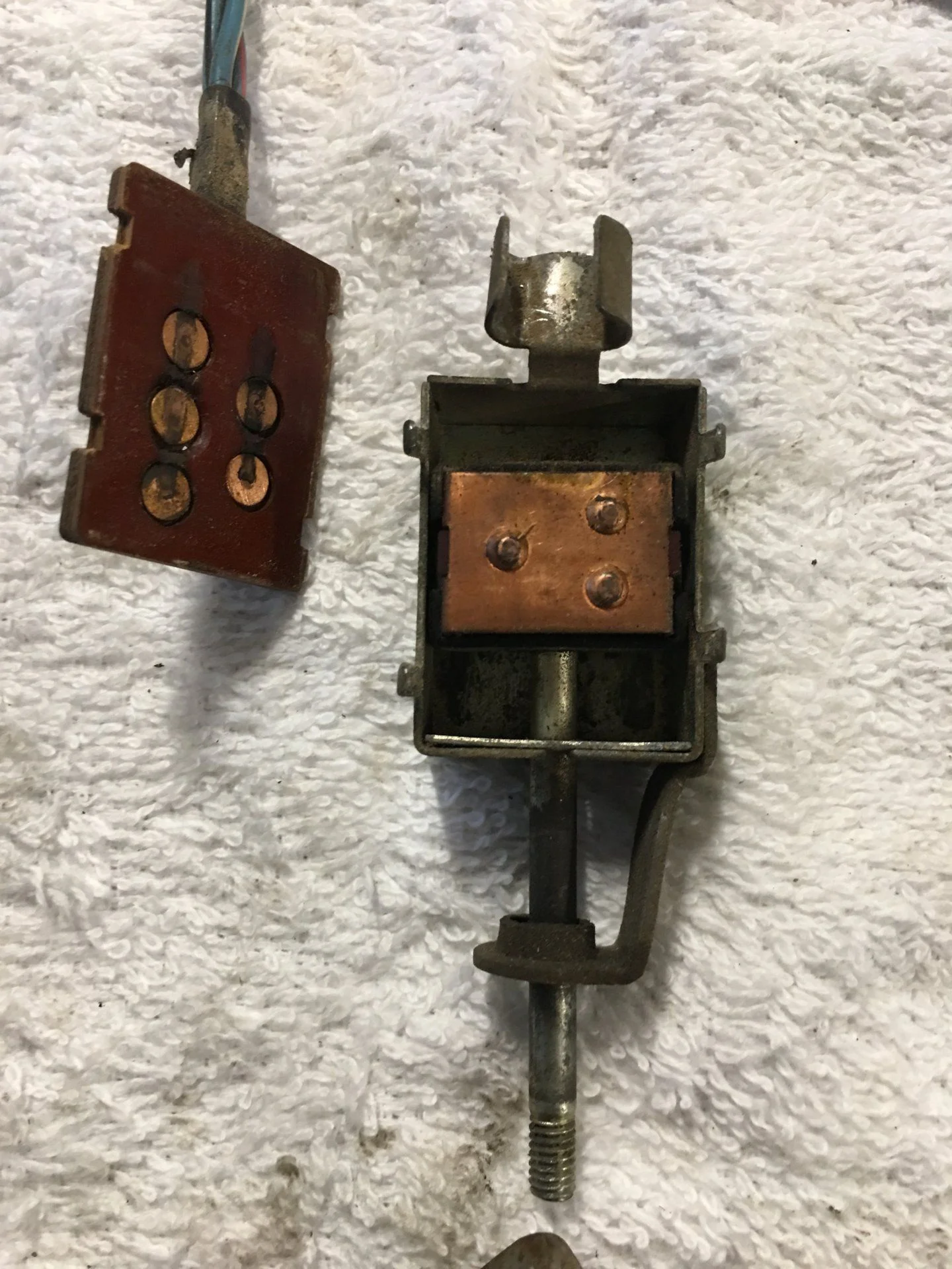

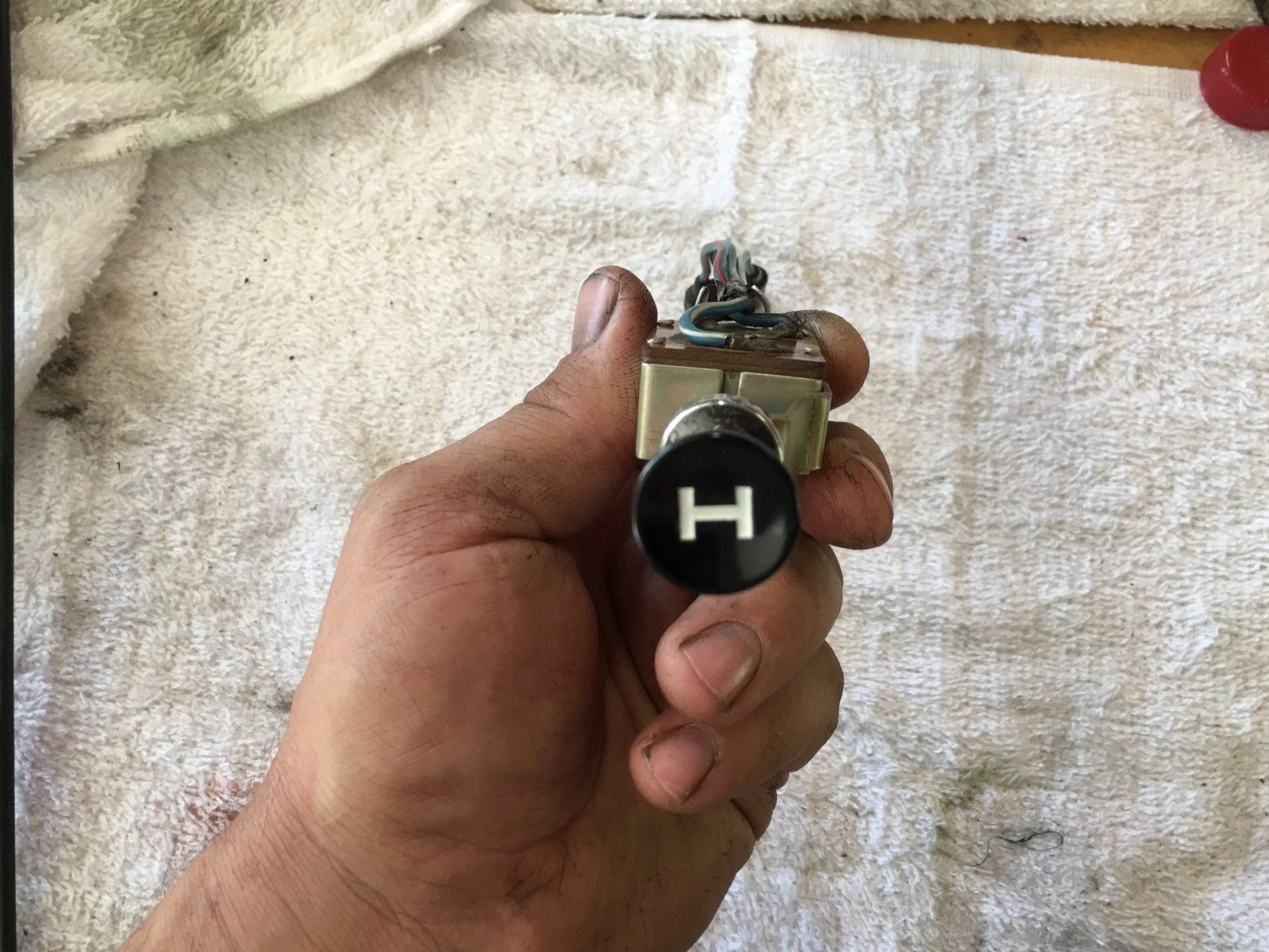

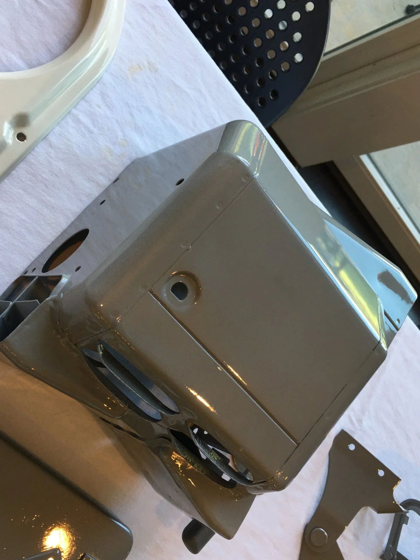

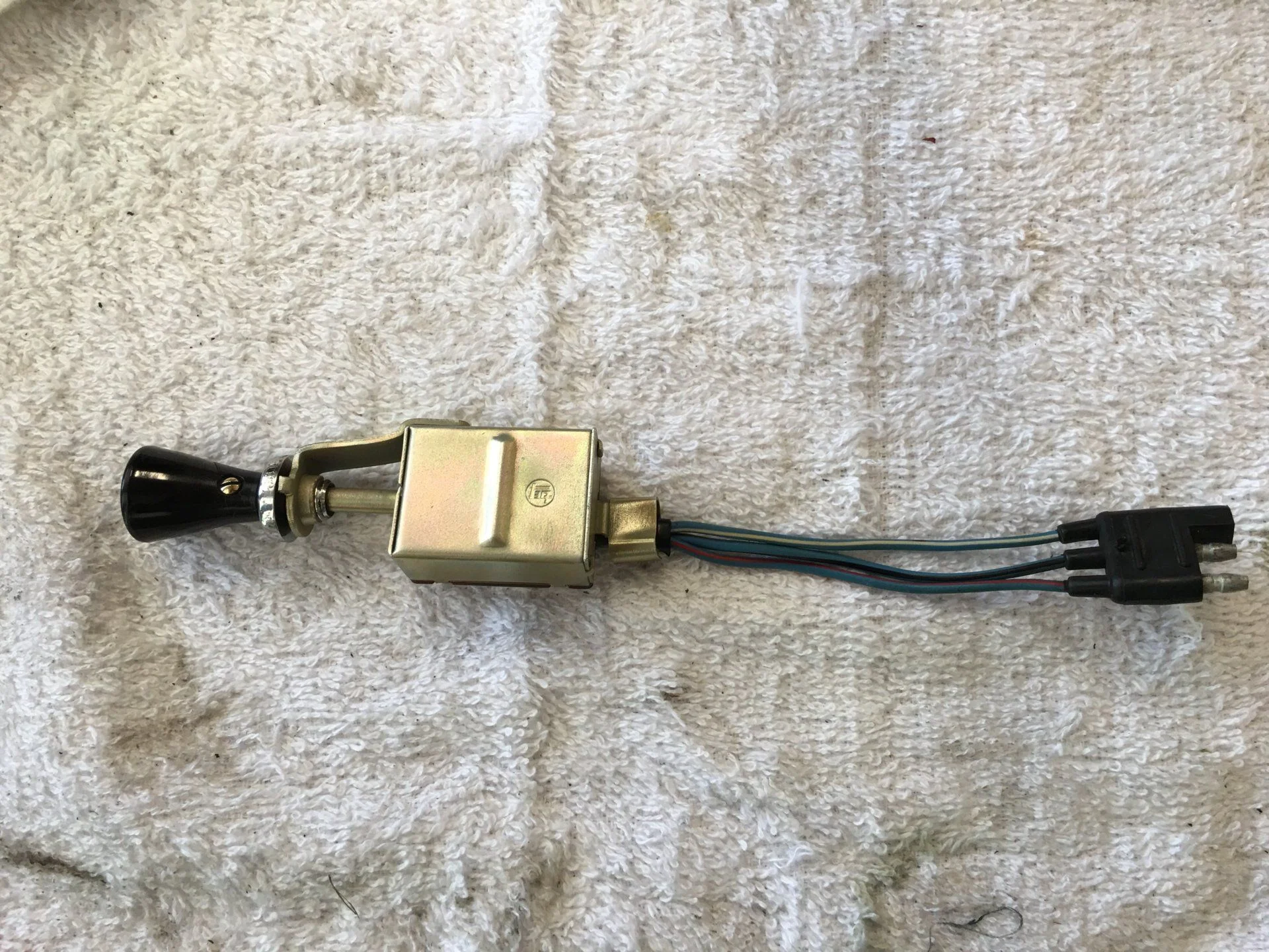

Tonight I’m working on restoring the fresh air pull and heater motor switch.
Ah good as new....

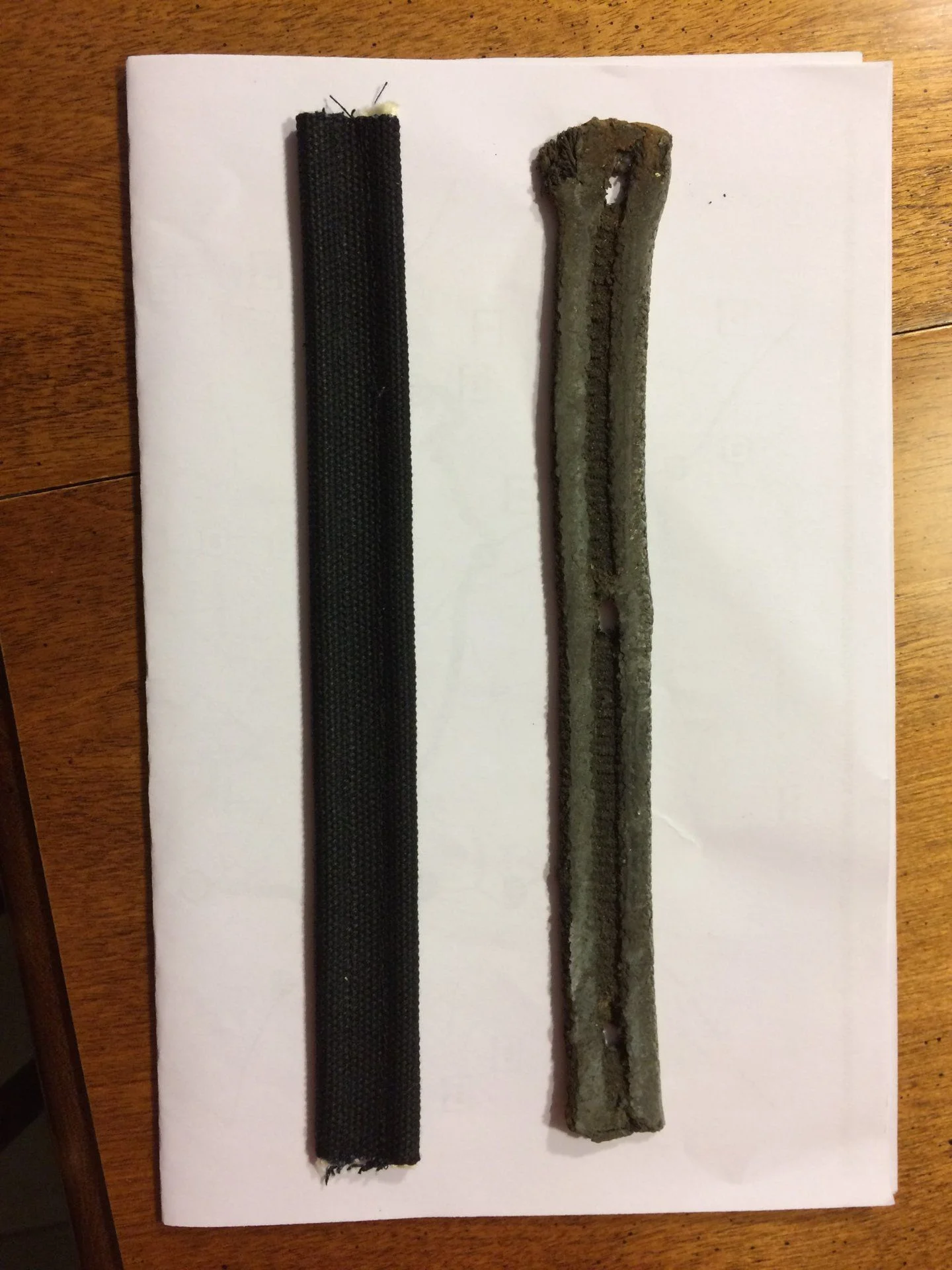

If you guys thought I was going over board on the canvas bed mounts well I decided to nerd out a little more and have my mother in-law who is handy with a sewing machine re relate the original black canvas hood shins and apron shims :D
These are her initial prototypes, we’ve since switched to a more robust cord to provide more restance to compression by the hood.

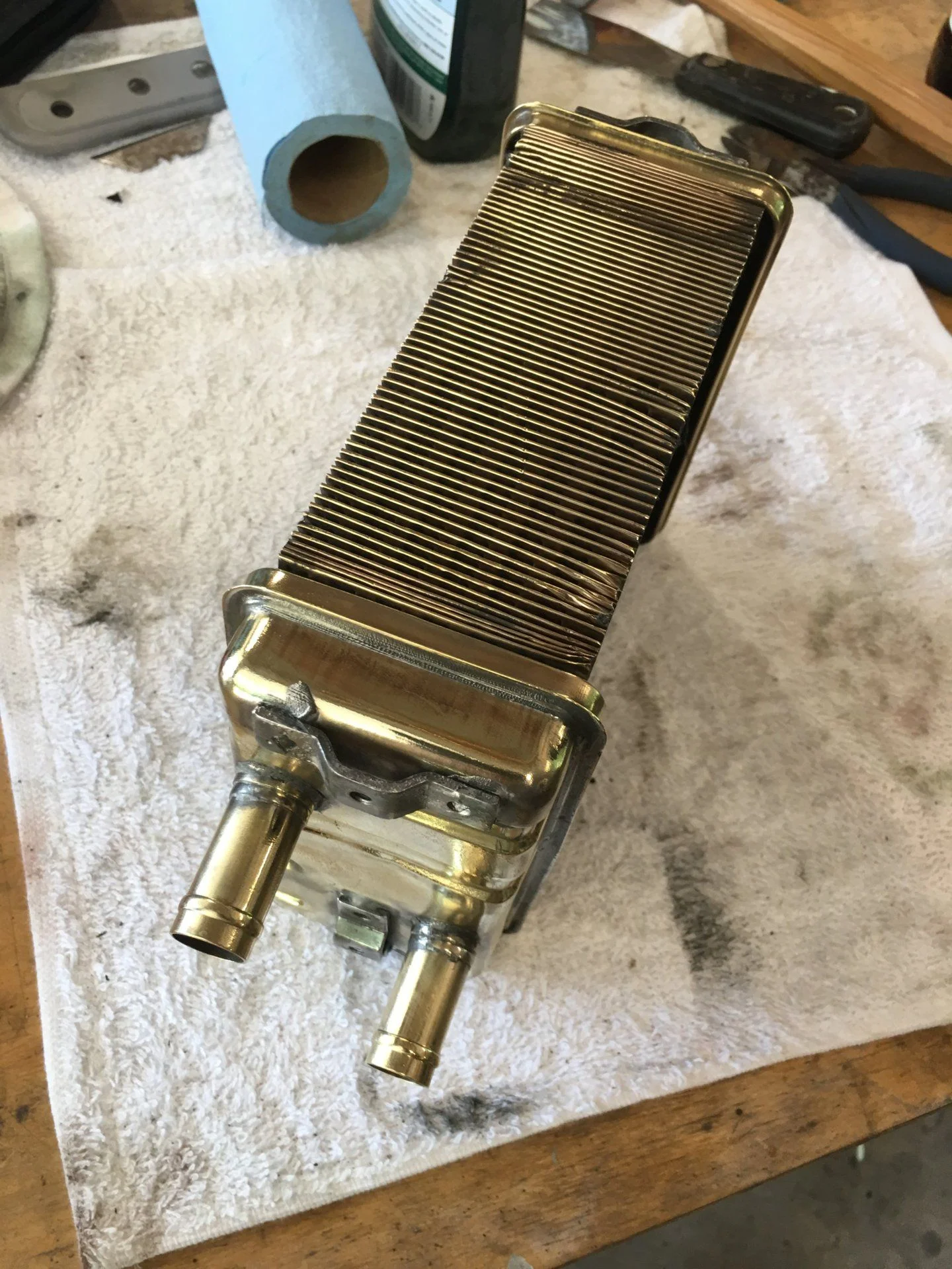

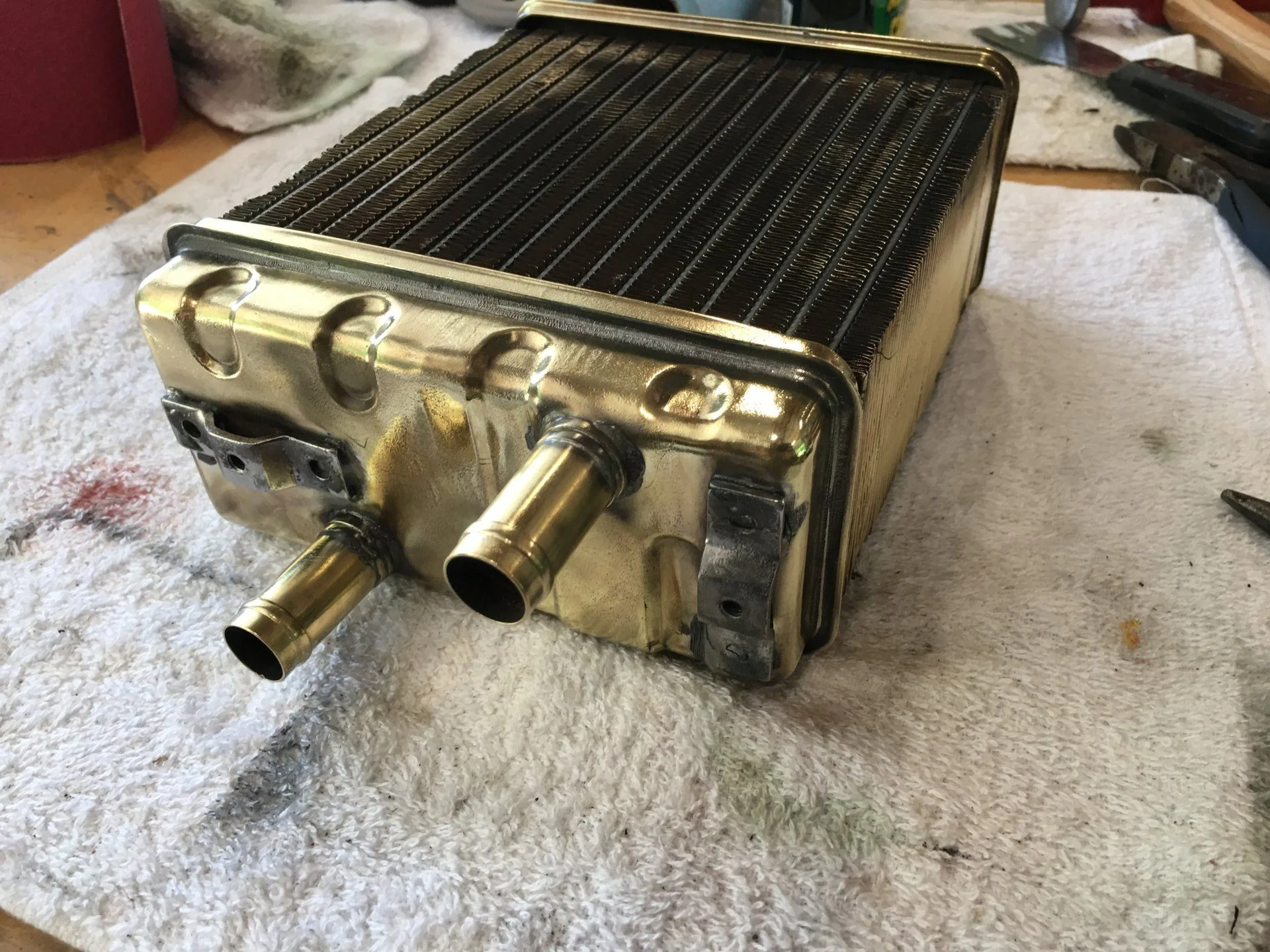

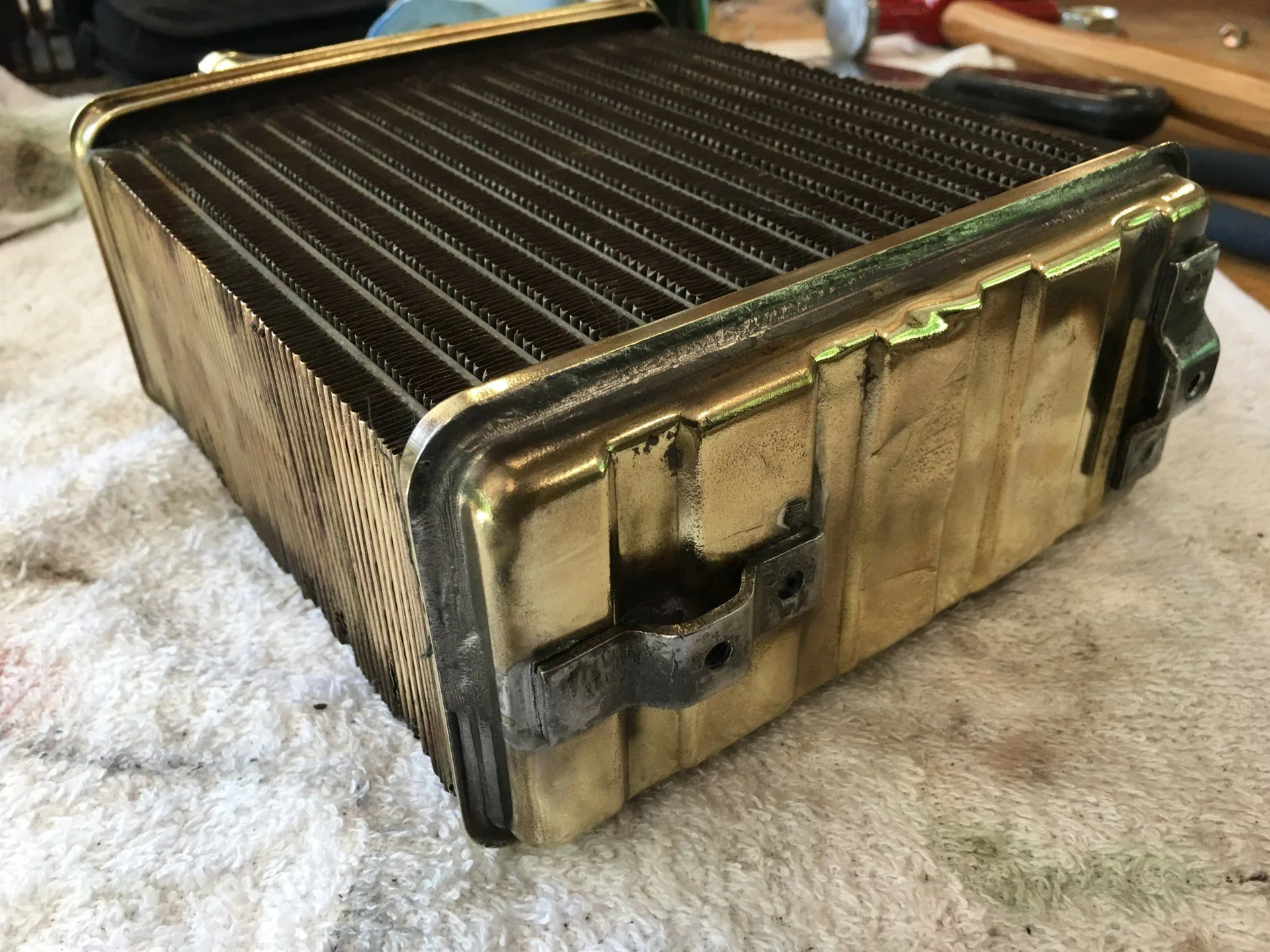

I’m headed deep down the rabbit hole..... prettiest heater core ever??
You’re killing us JP
I didn’t plate the heater core, though the thought did cross my mind ;), the core is brass I just simply cleaned and polished it.
As for plating the rest of the stuff I’m just following Mr. T’s lead on what to plate and what not too. I did plate a few things like latches and hinges that would have simply been painted at the factory, but I wanted to provide an additional layer of corrosion resistance. I’ve had bad results with rust leaching out of hinges after exposure to the elements in the past.

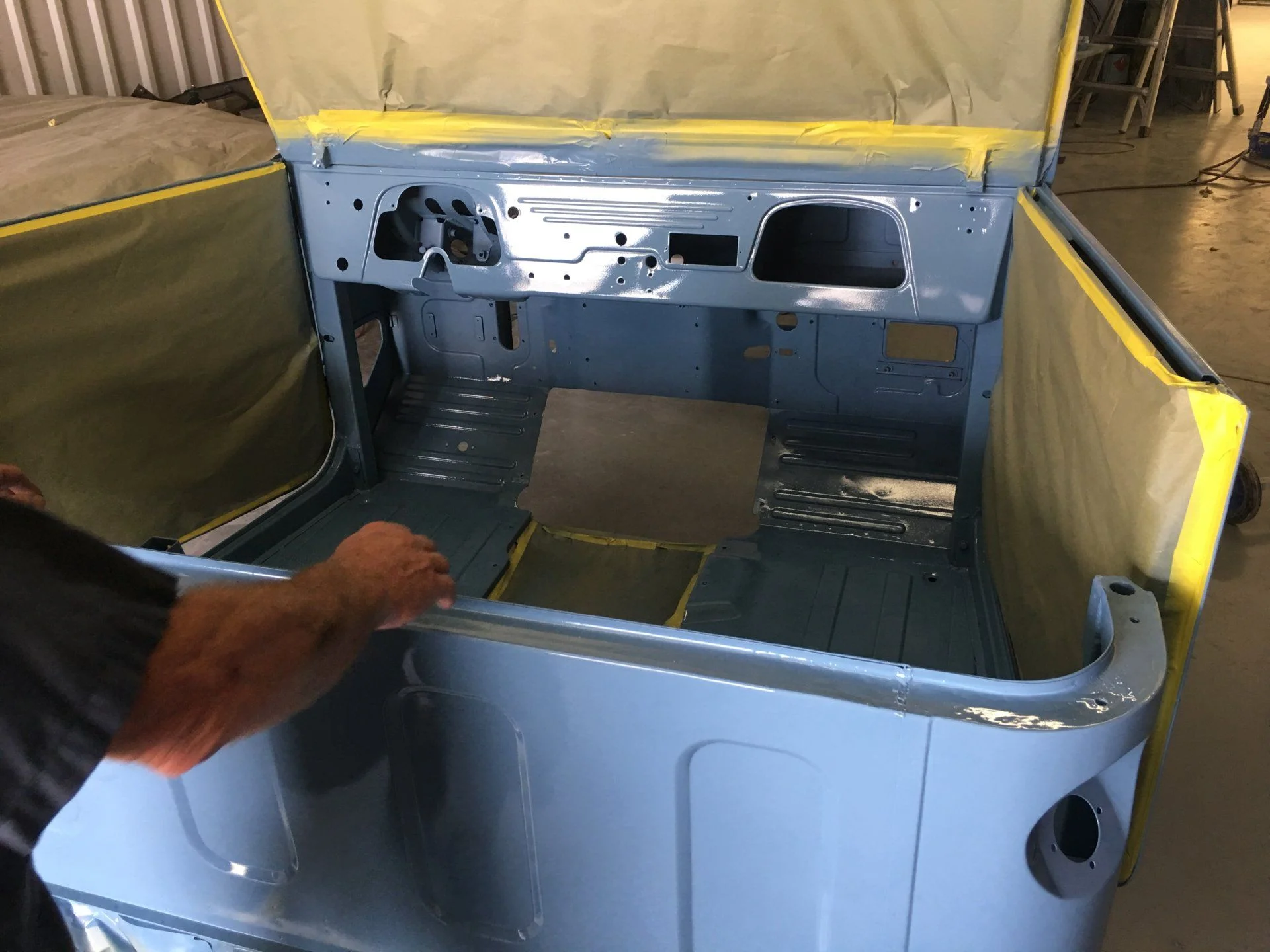

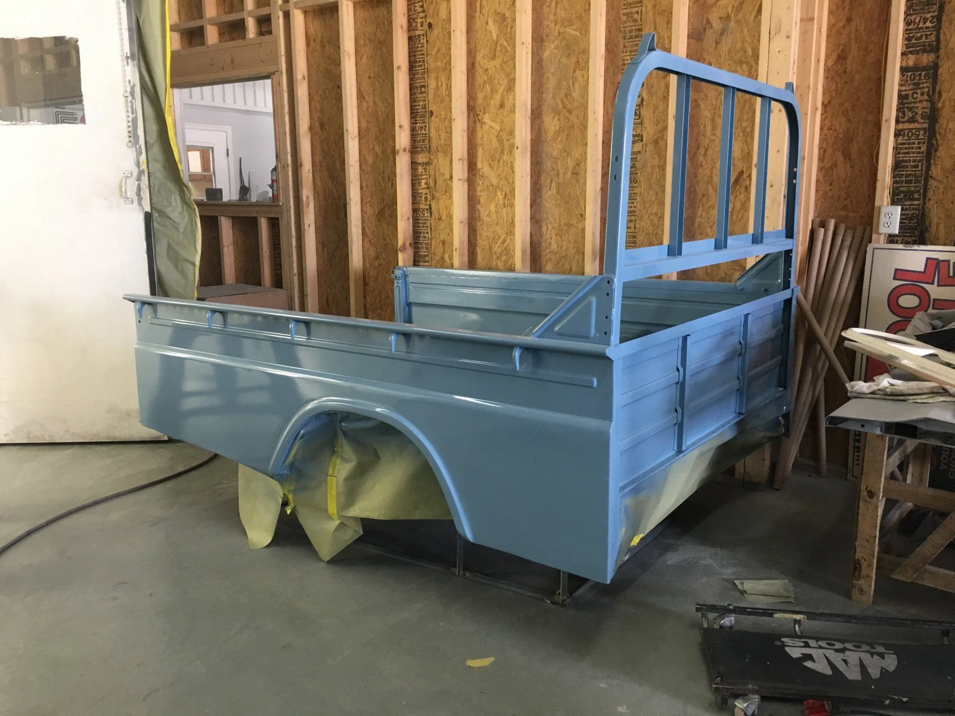

I’ve been wanting an enclosed car hauler for a while and transporting a freshly painted body seemed like a good enough excuse to pull the trigger. So I picked up this over the weekend....
Stopped by the body shop... almost done!

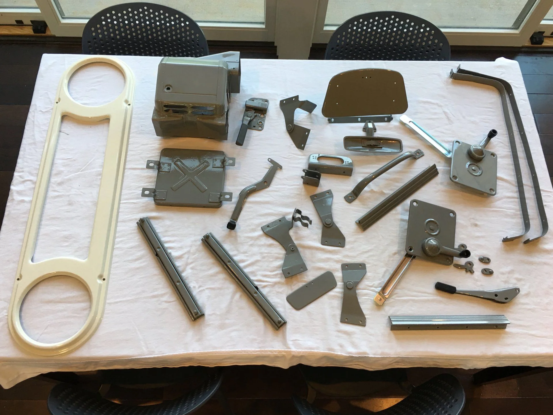

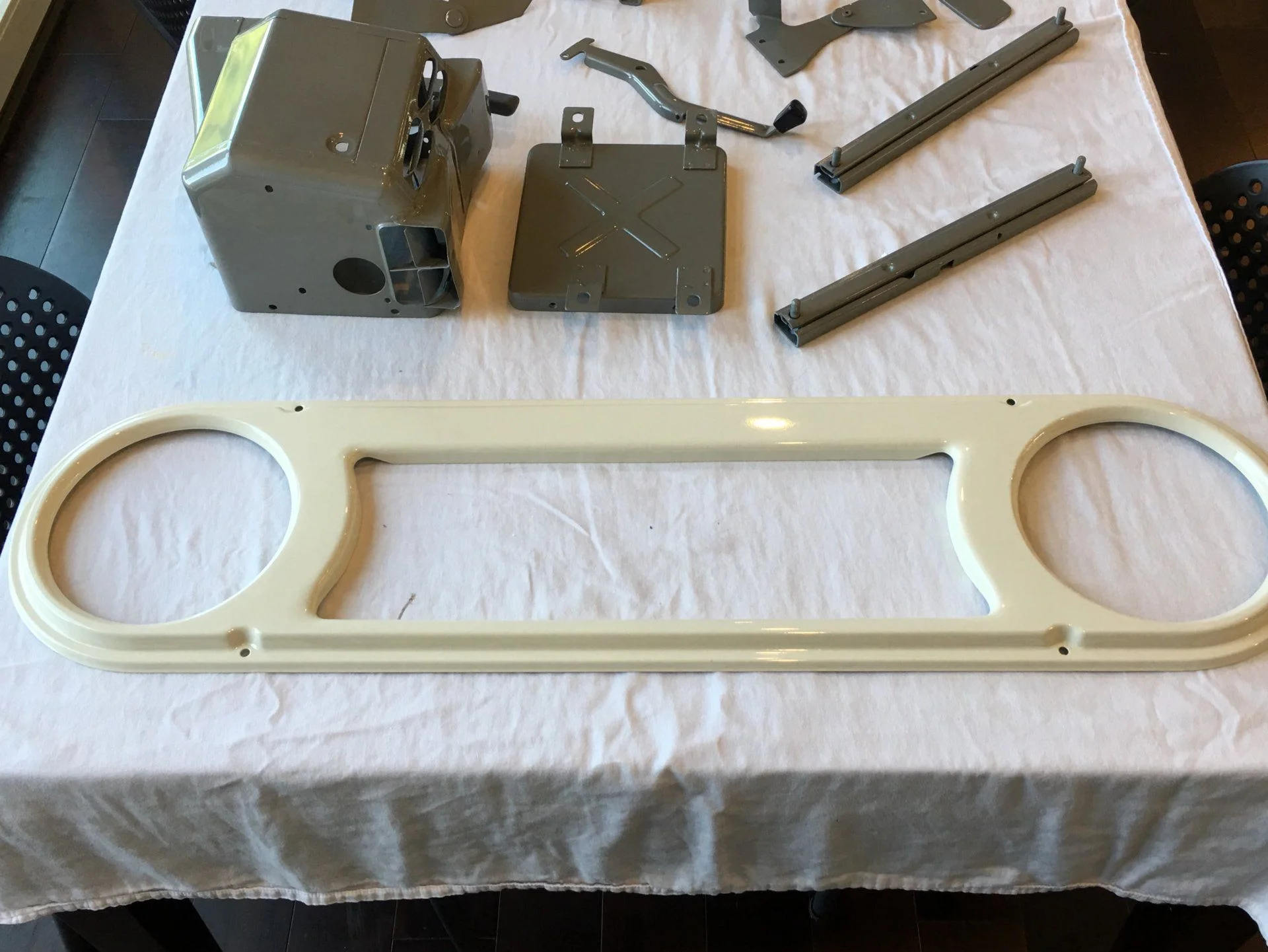

The body wasn’t ready but some of the interior bits were.... I’m stating to get excited :D

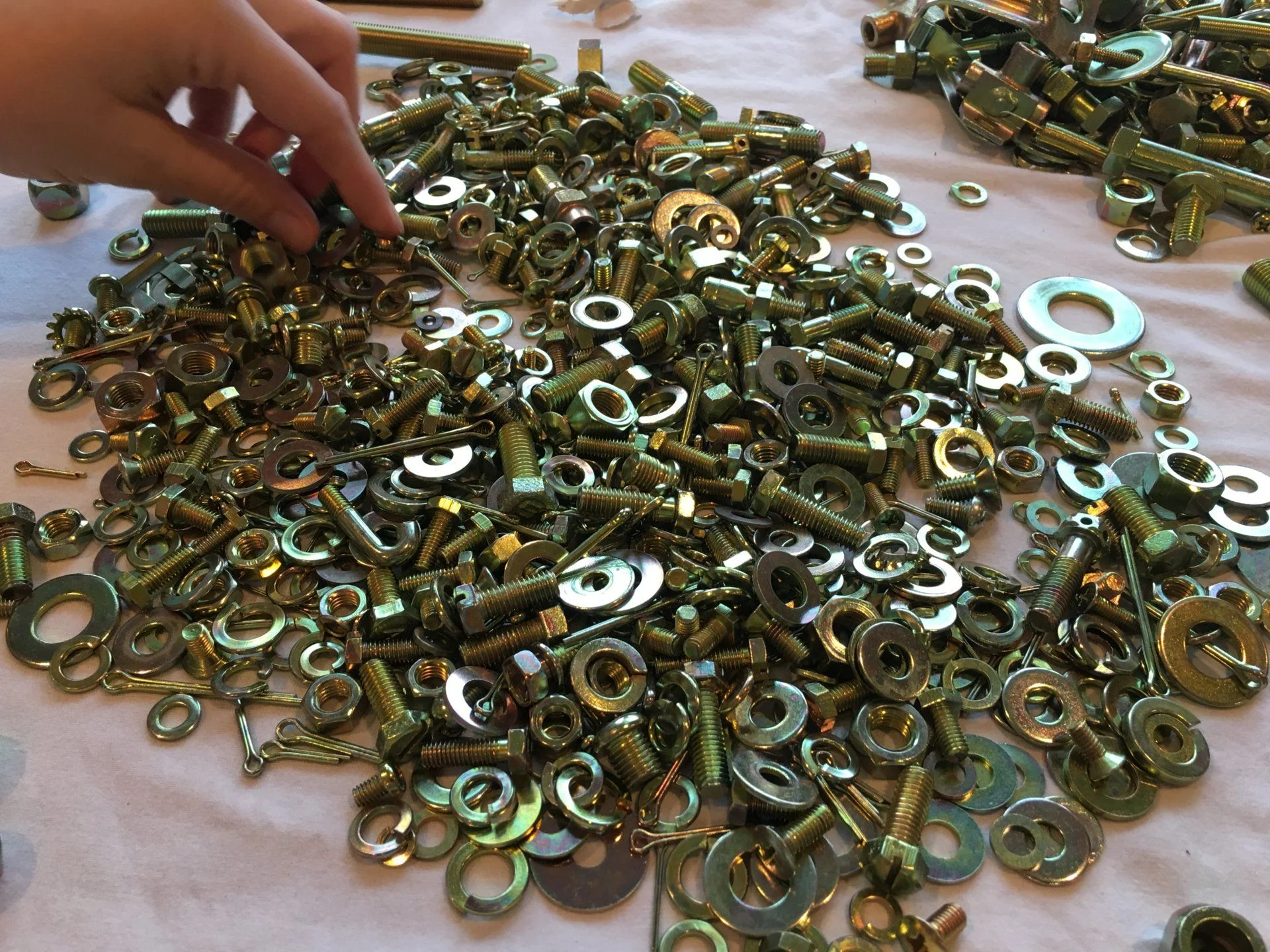

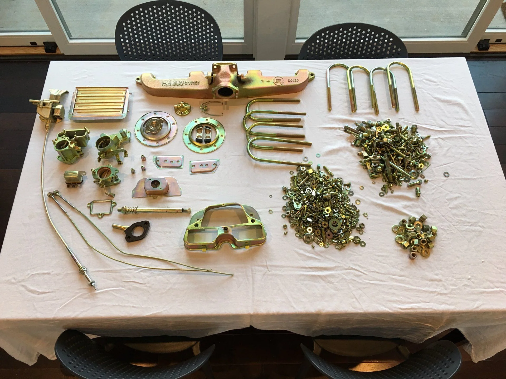

My wife took pity on me with the heat setting in the lovely South and let me sort this golden pile inside tonight, though she says I need a Cruiser intervention :grinpimp:
Put my best OCD mini me on sorting duty :D

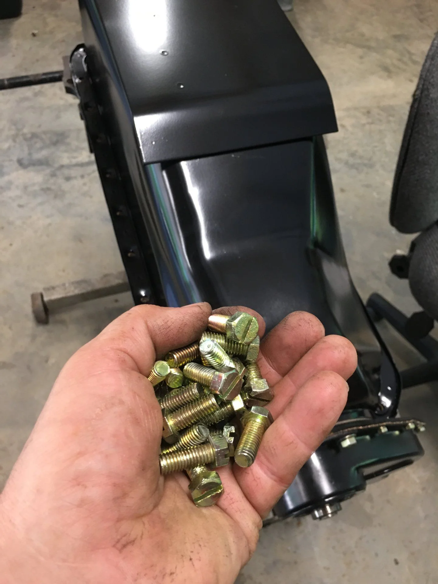

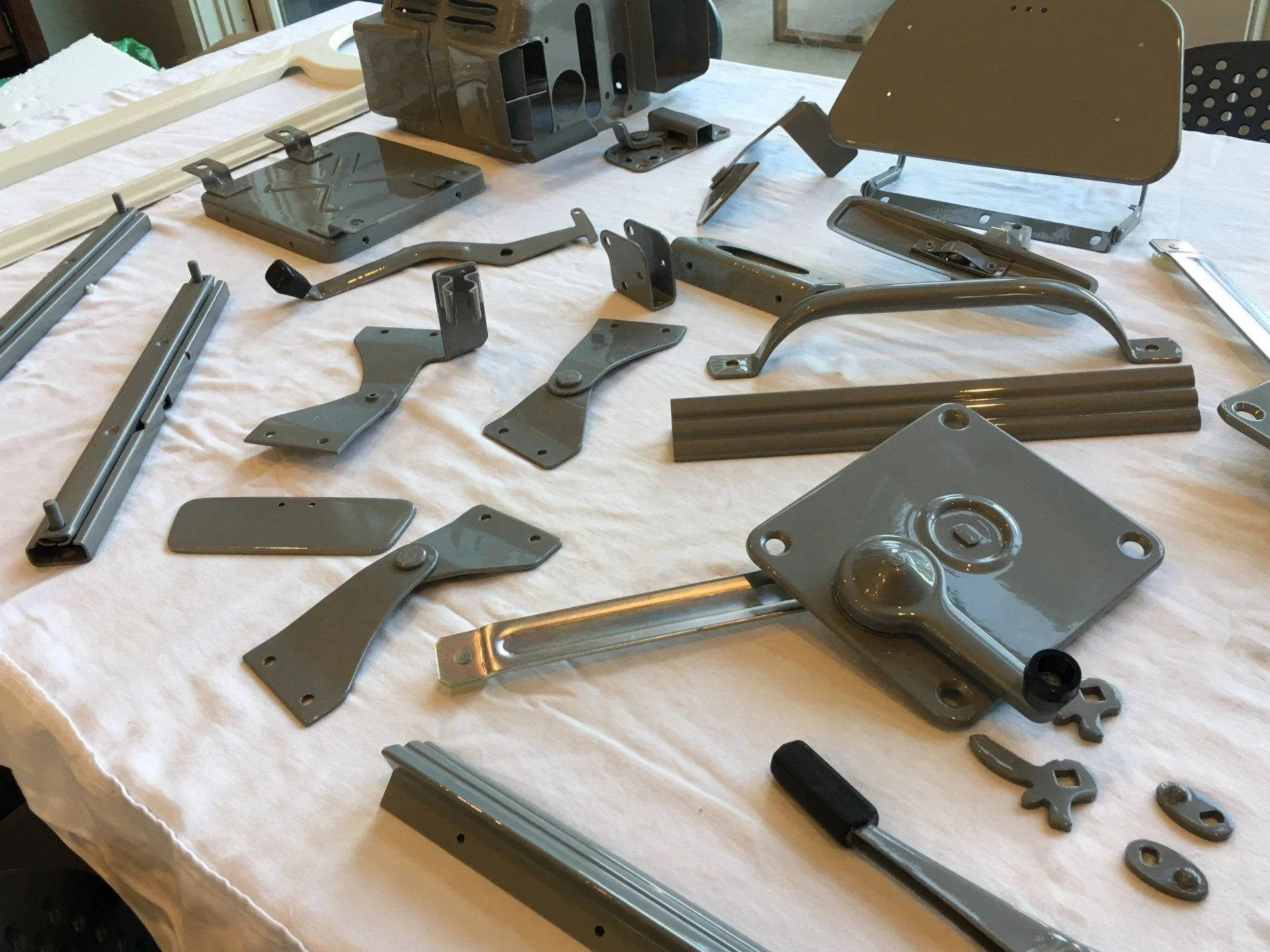

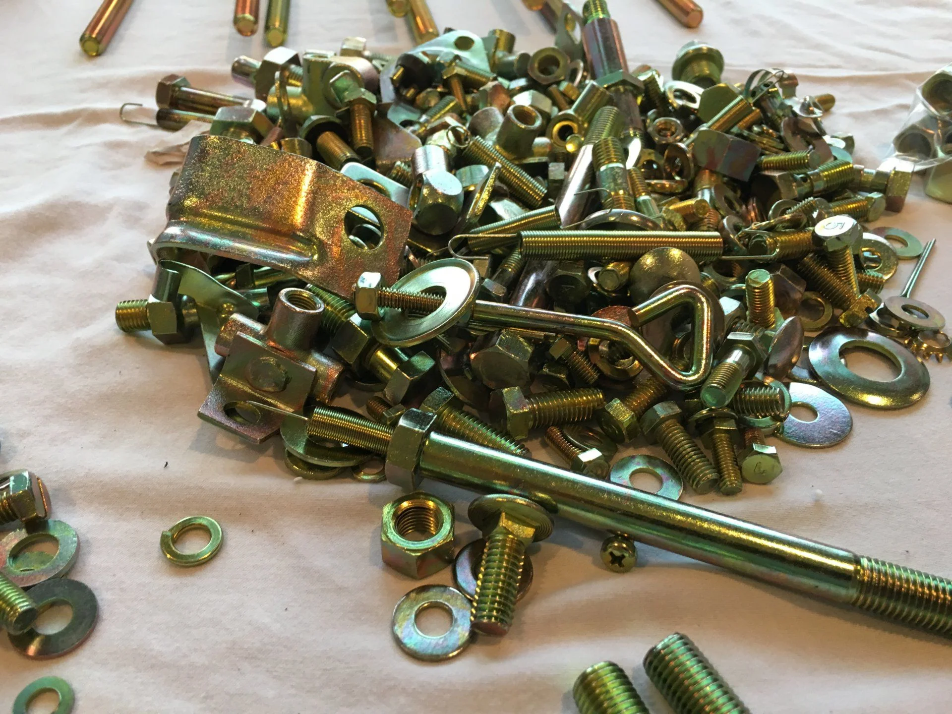

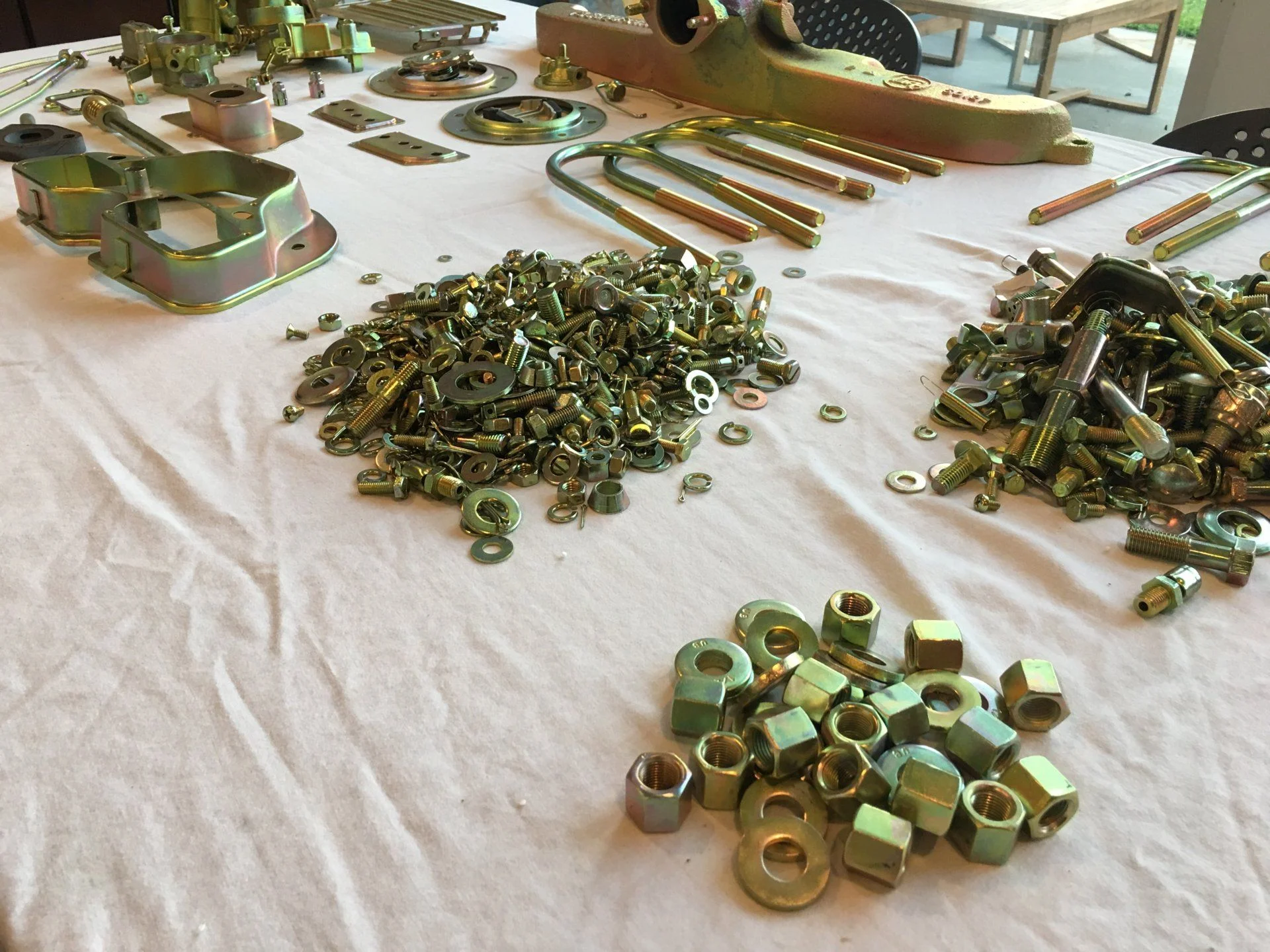

Not sure how I feel about the SD40 after plating. The iridescence this time around from the plater was on the bright side o_O What do you guys think? Originally best I can tell they had a mild zinc/ cadmium coating from the factory.

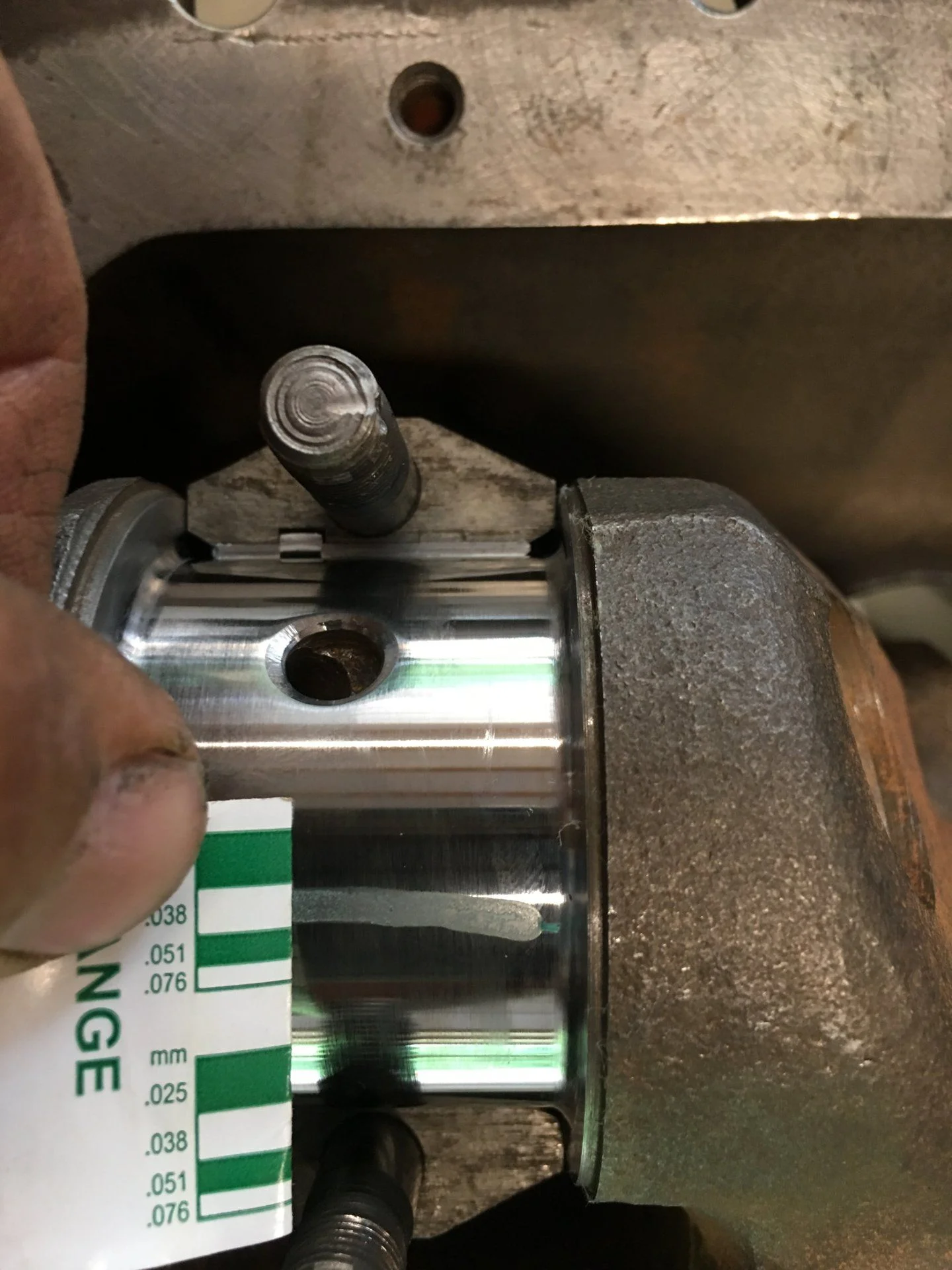

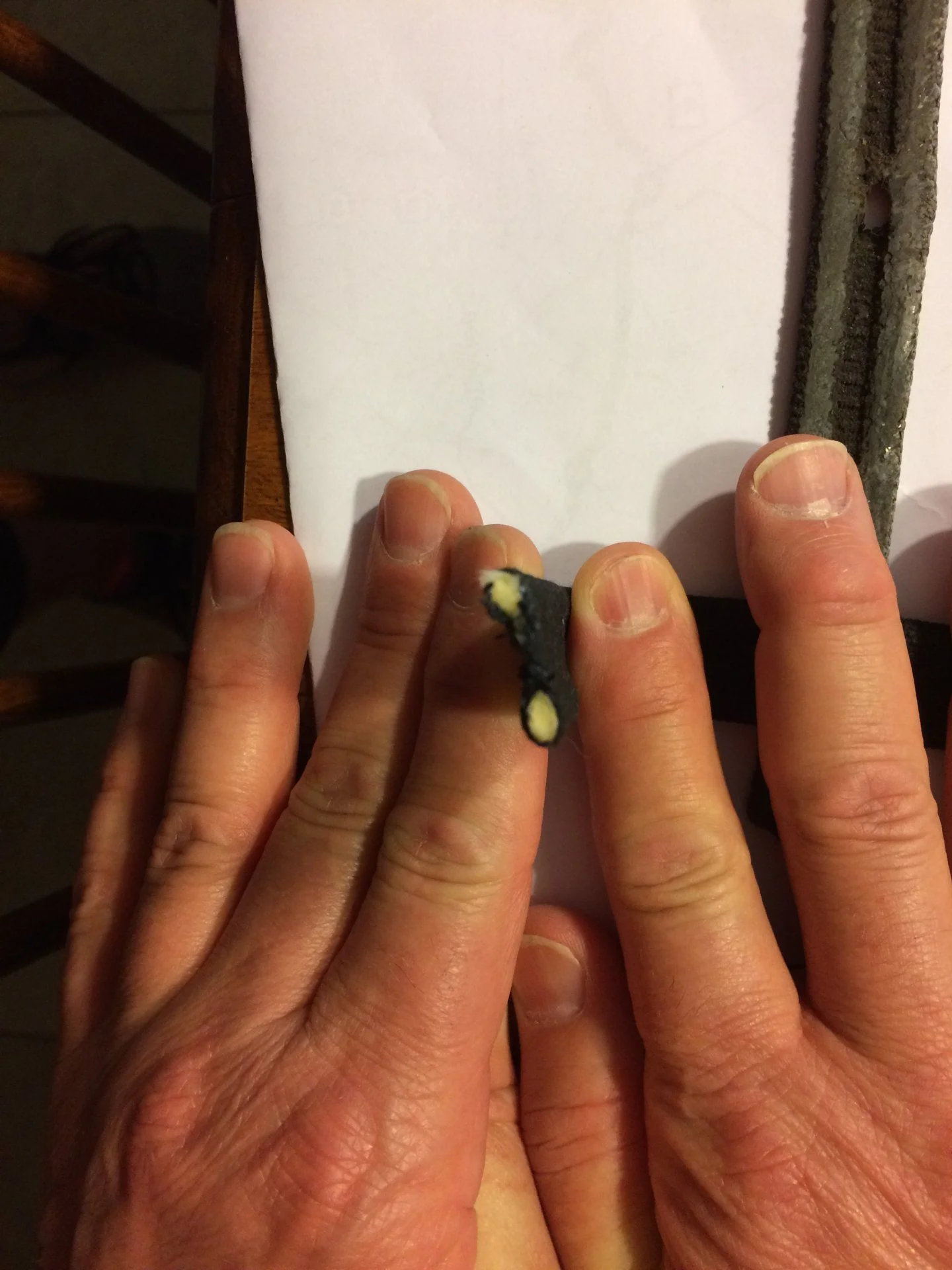

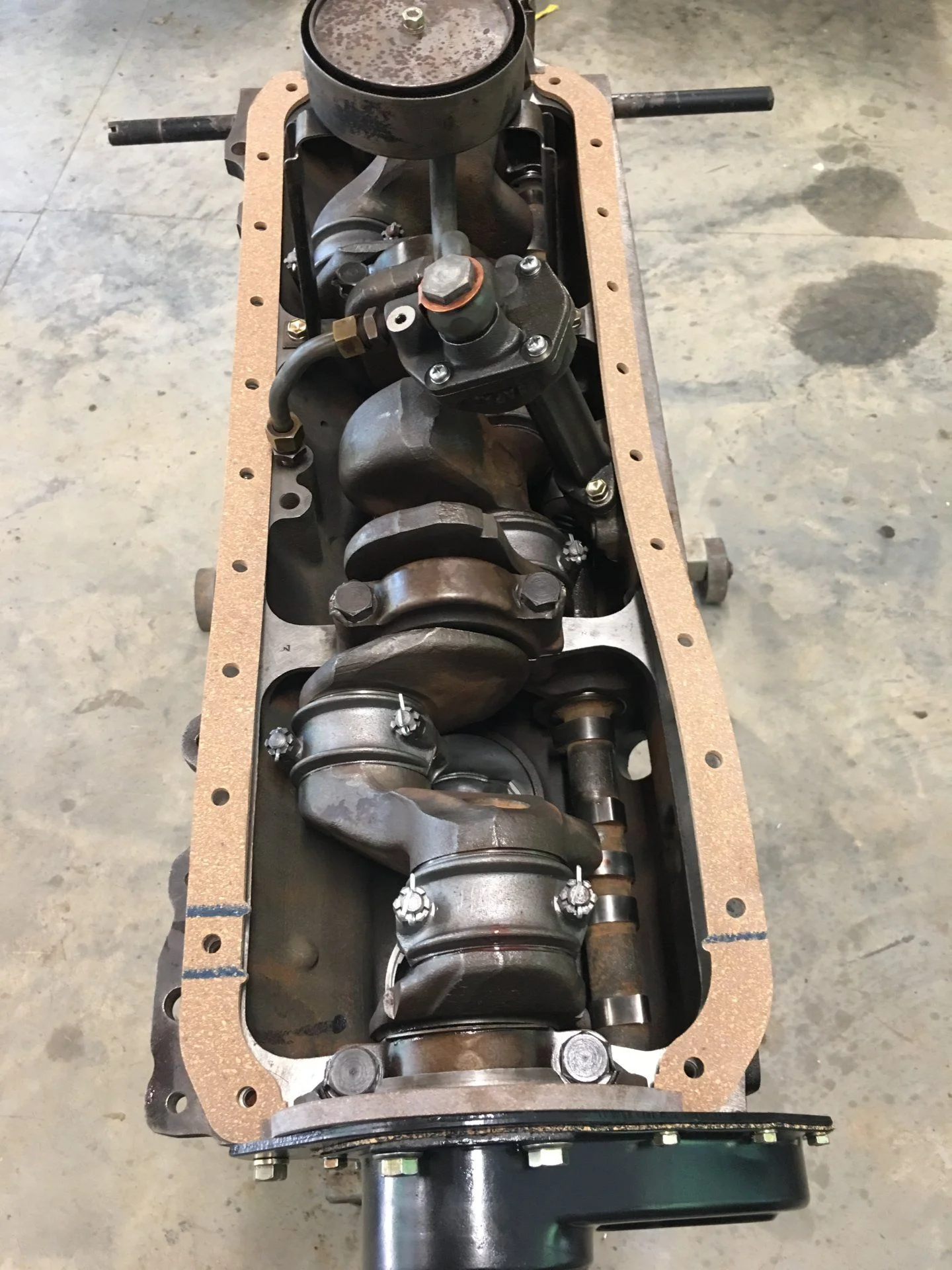

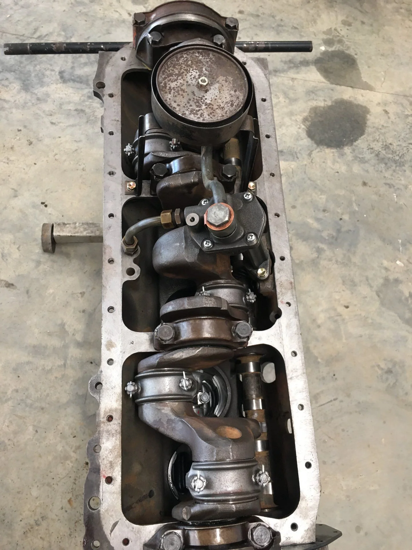

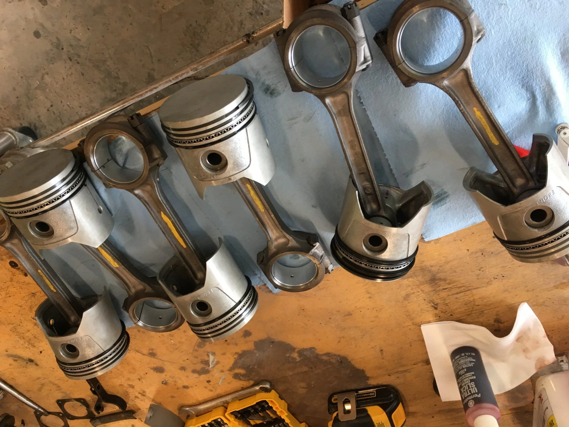

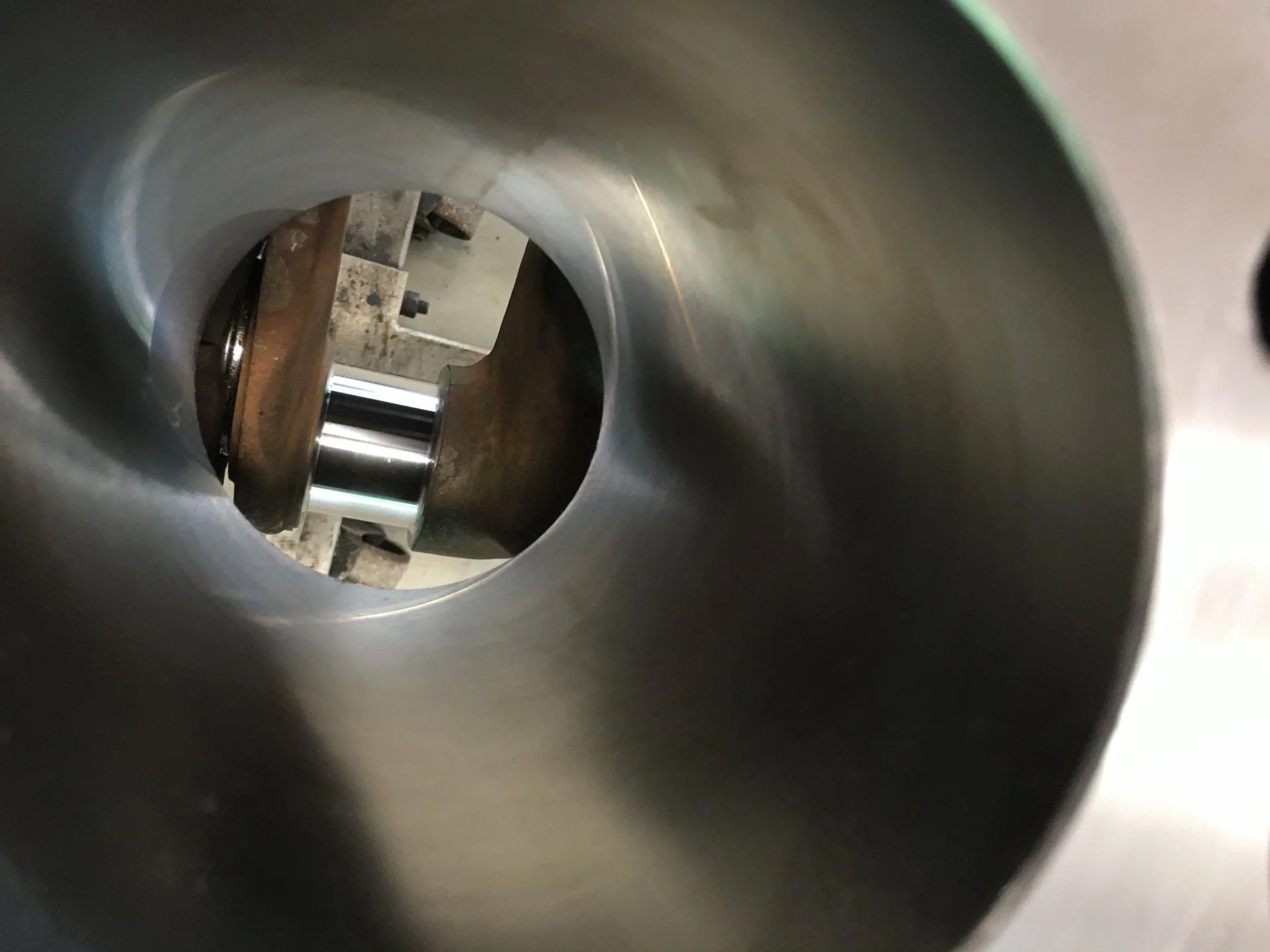

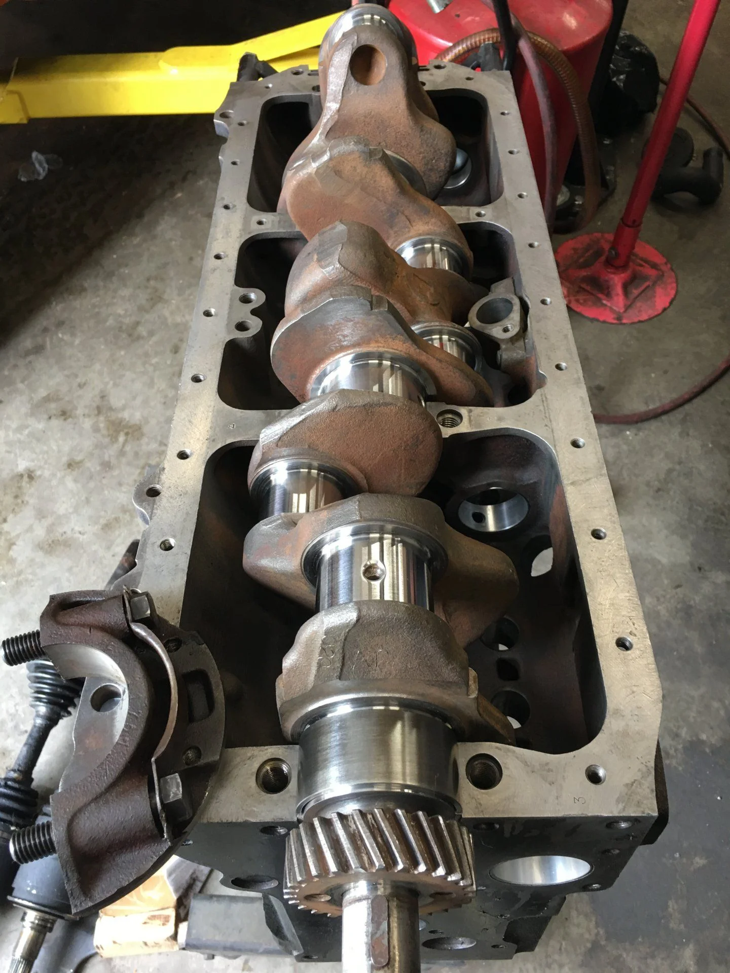

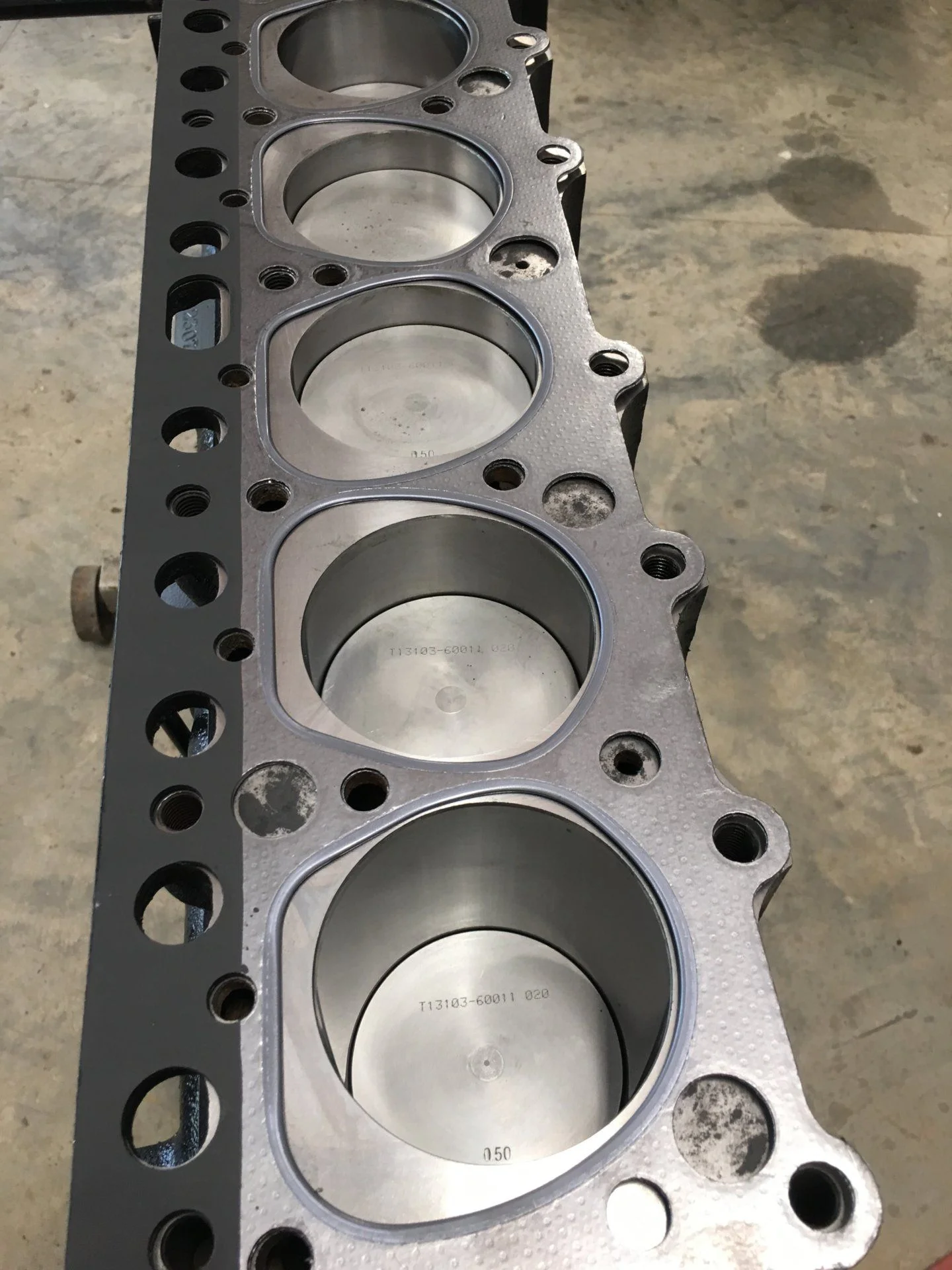

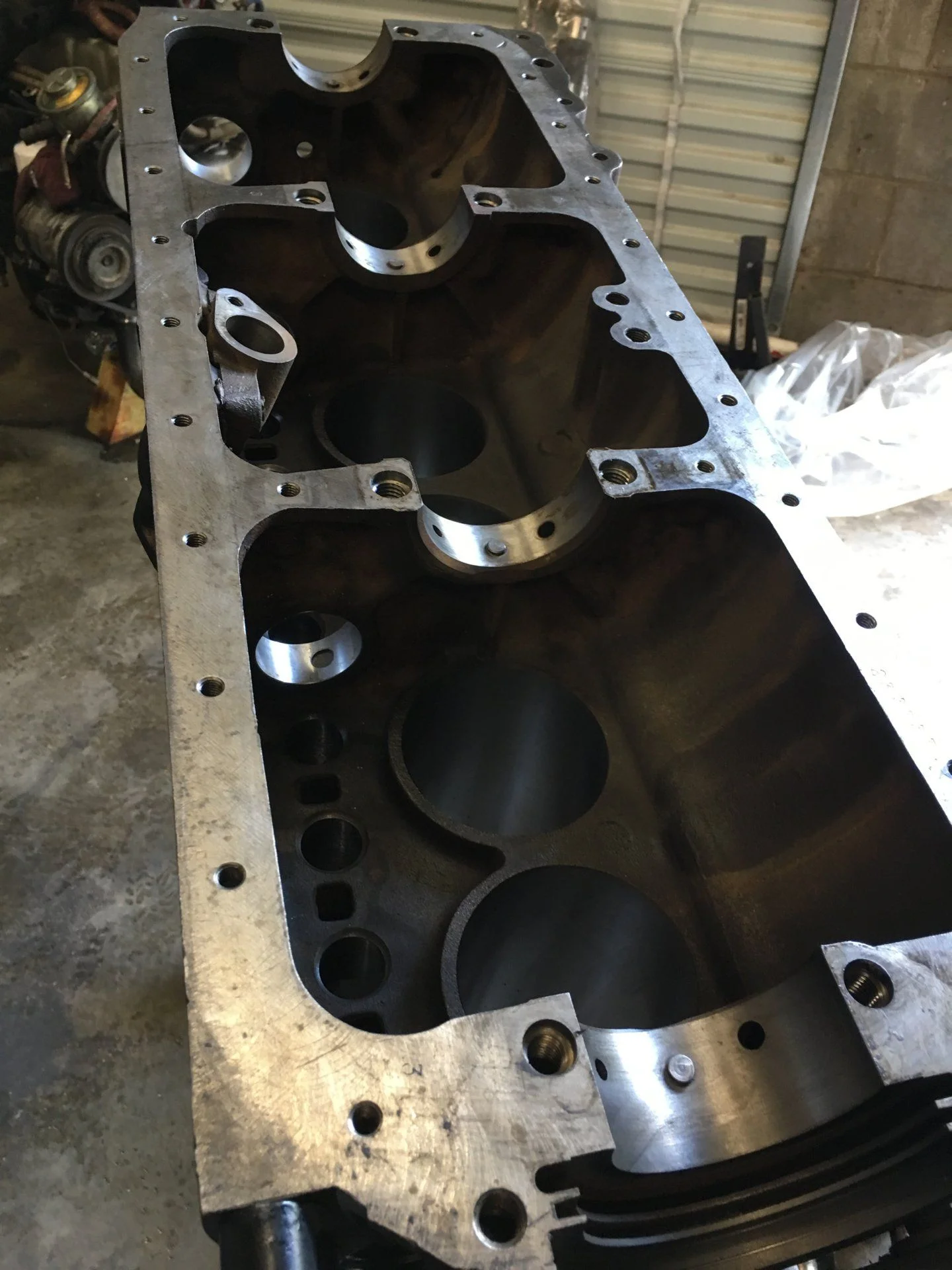

Plastigauge is your friend :D

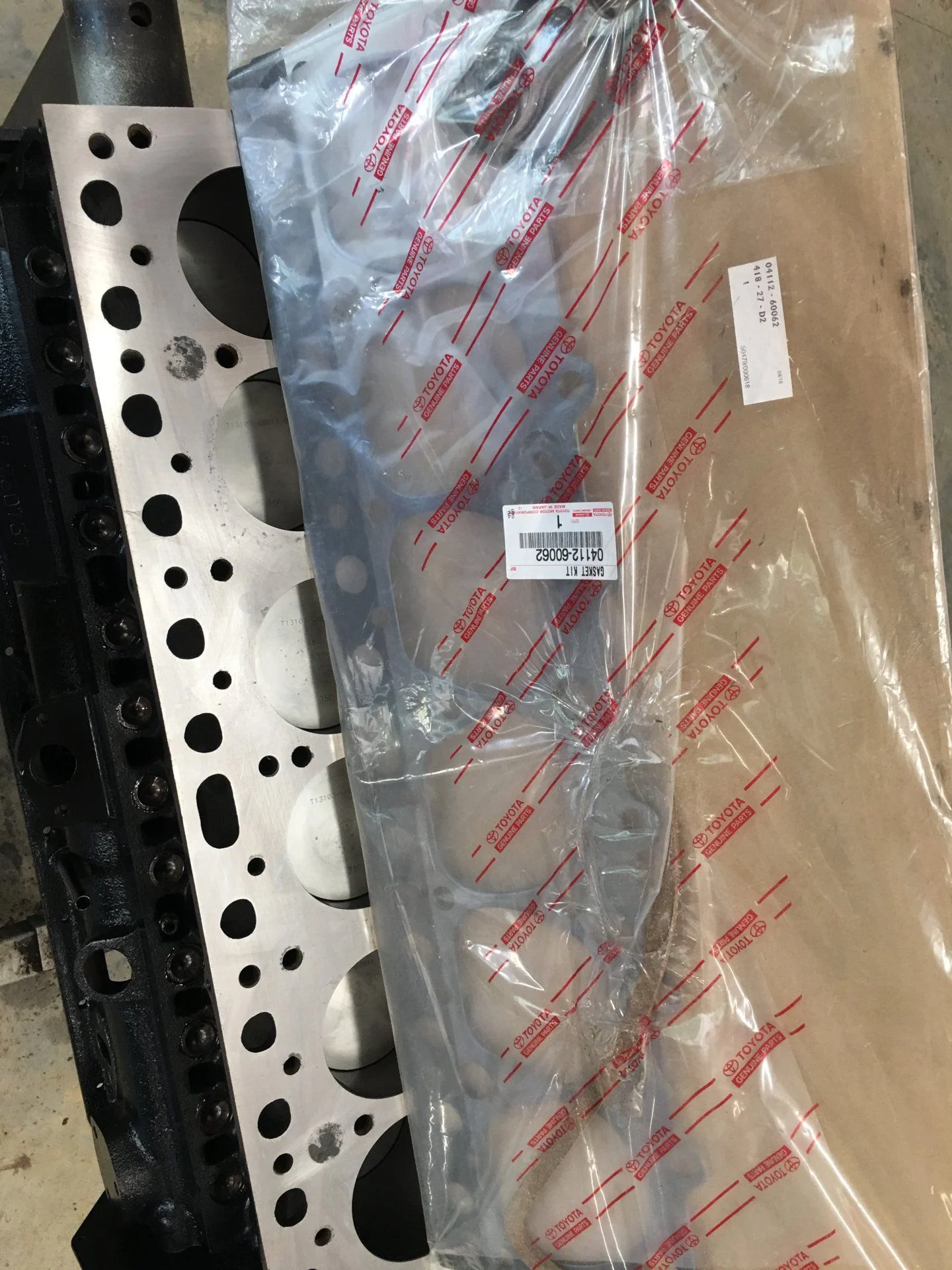

Thanks @onur for the OEM gasket goodness

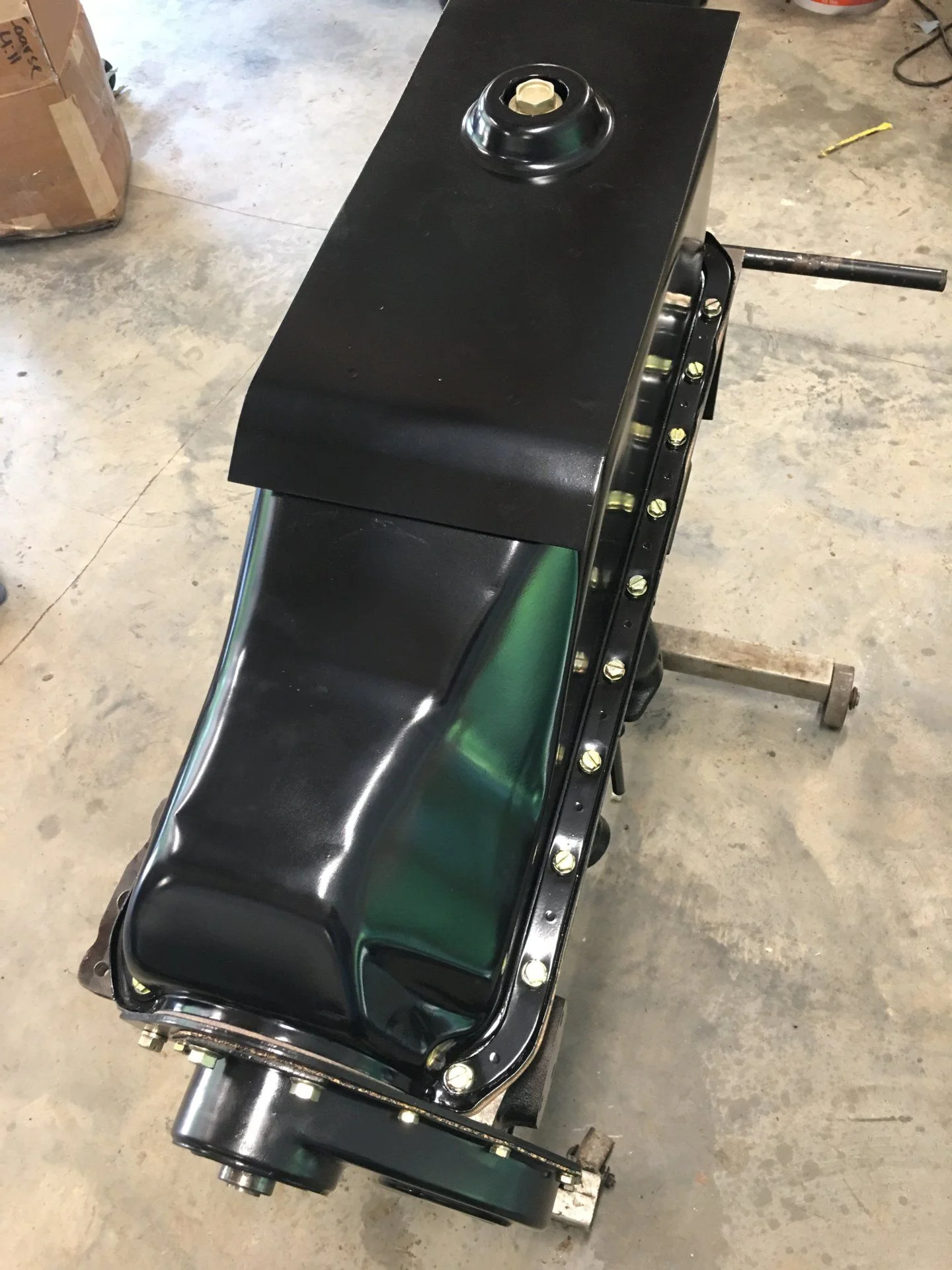

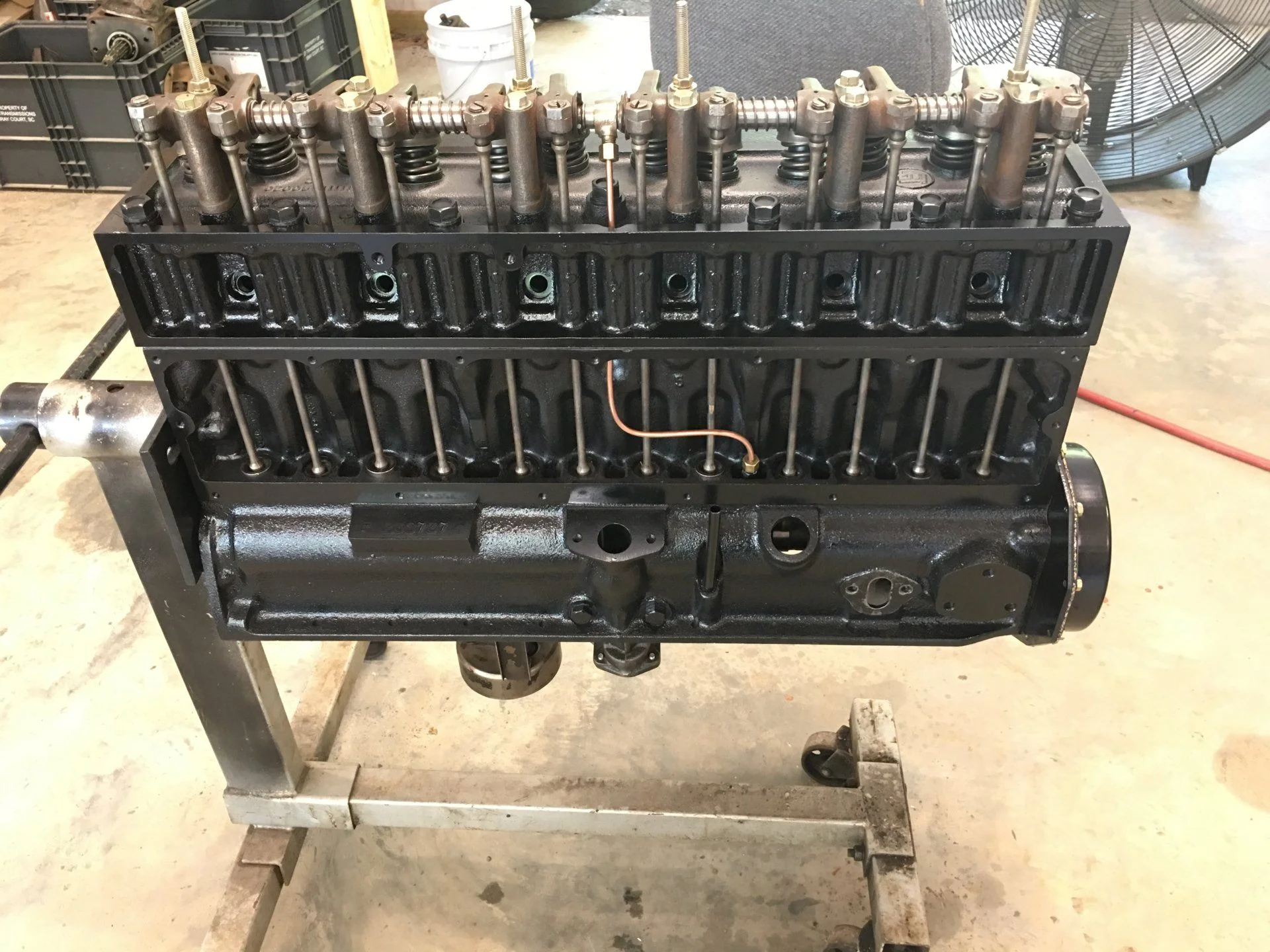

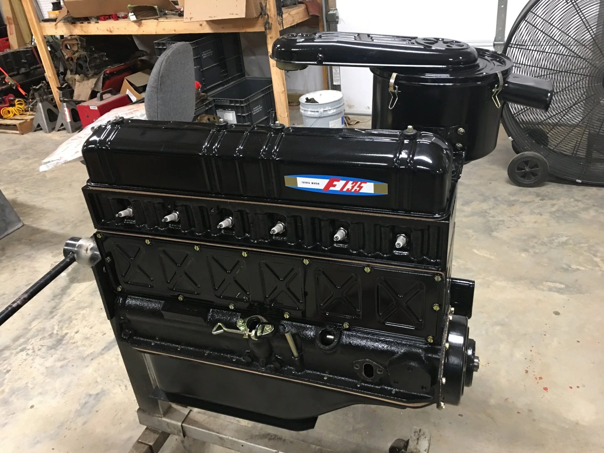

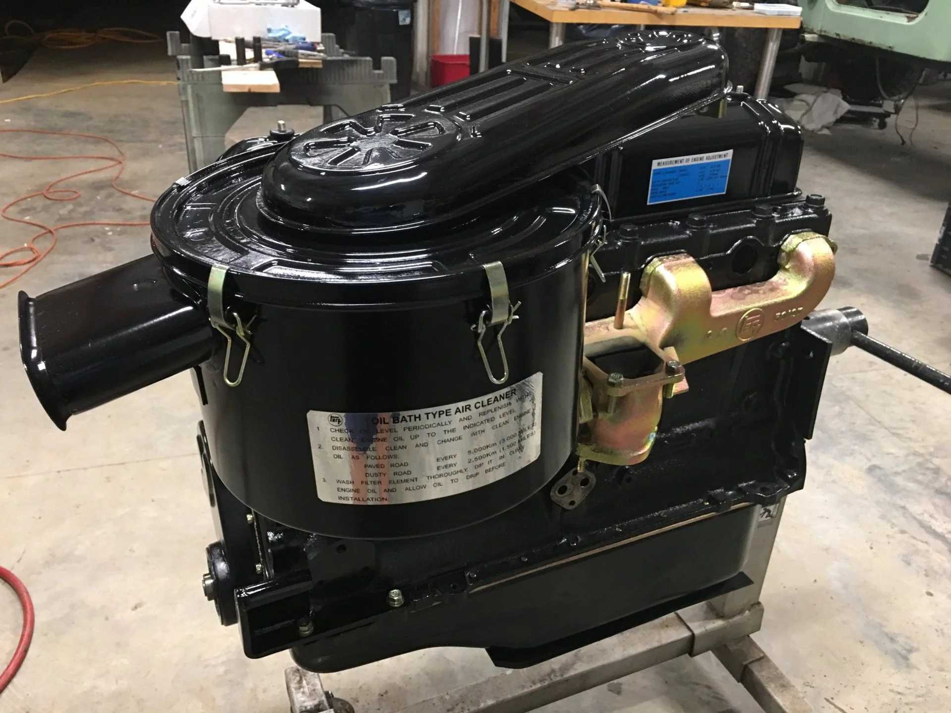

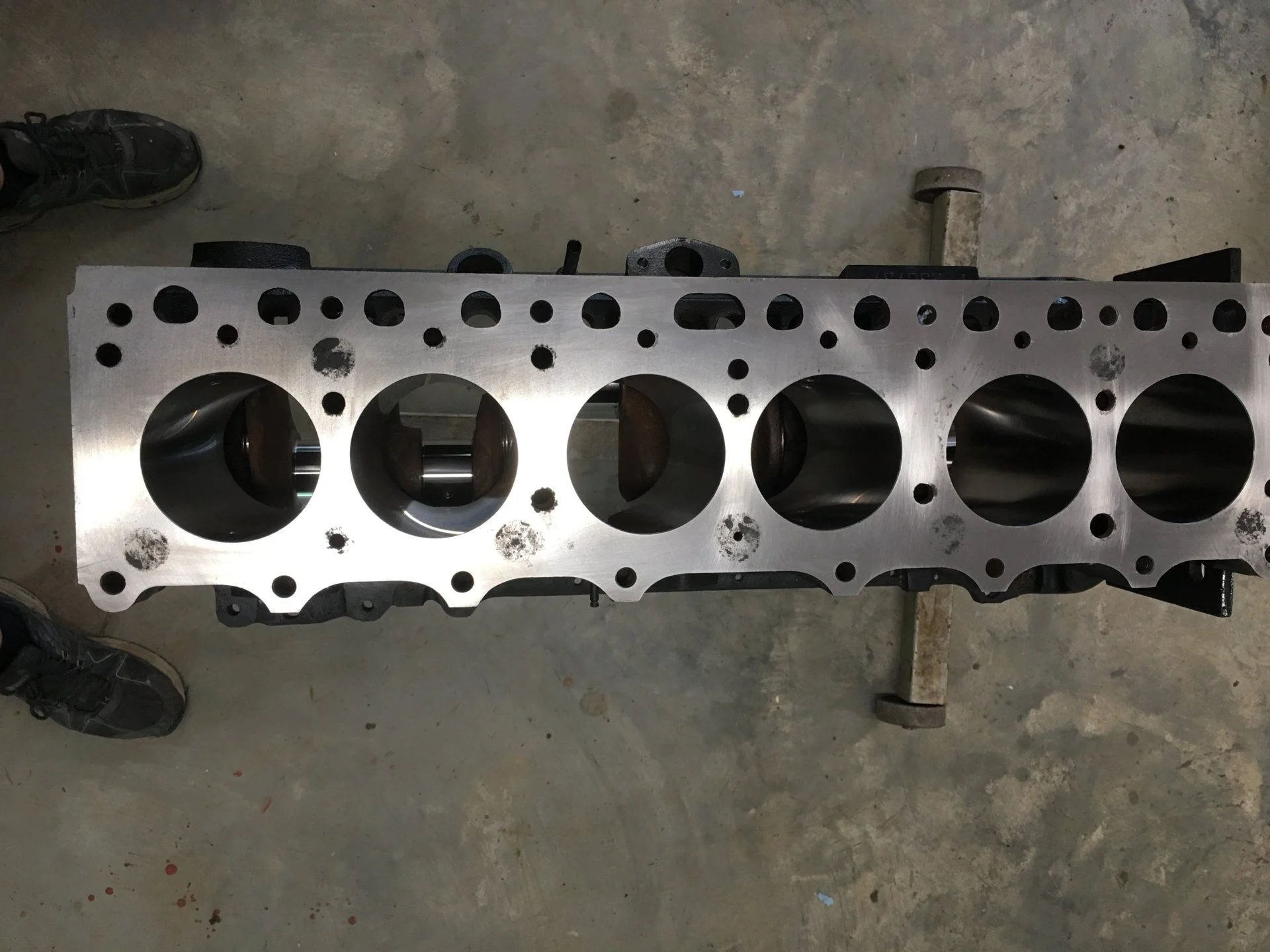

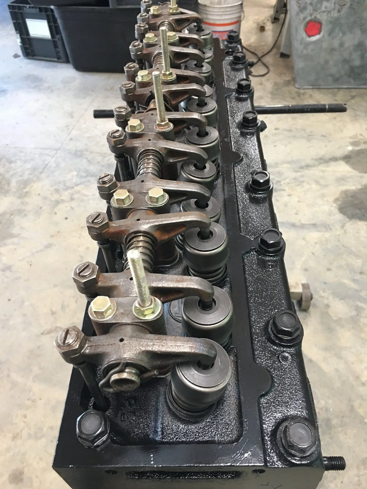

Starting to look like something.
New OEM head bolts thanks to Racer65
Head snugged down to 95ftlbs

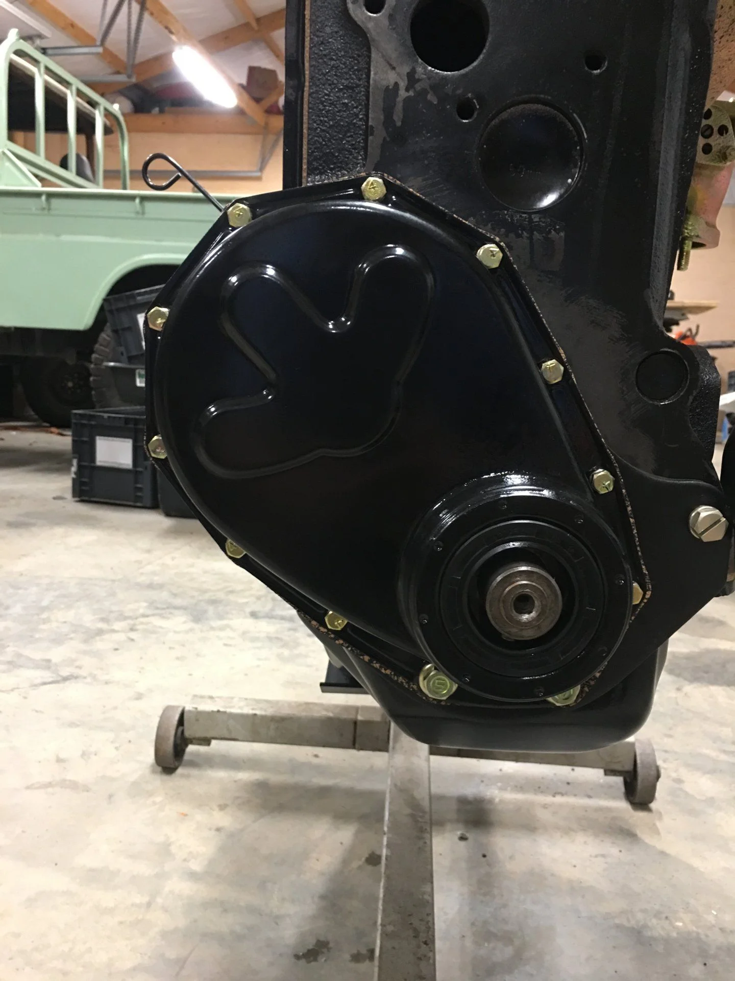

More OEM goodness to keep any drips at bay :D
