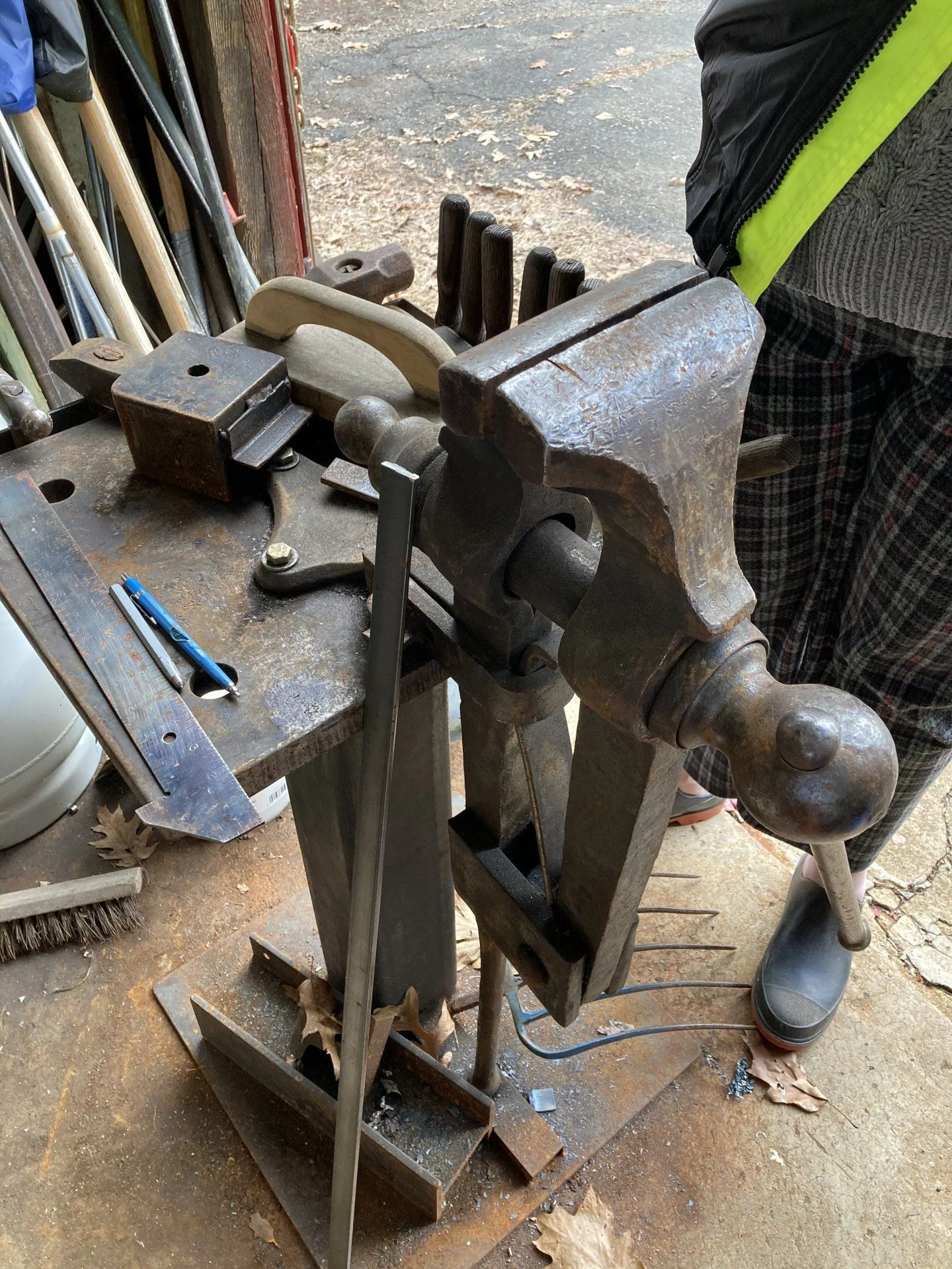

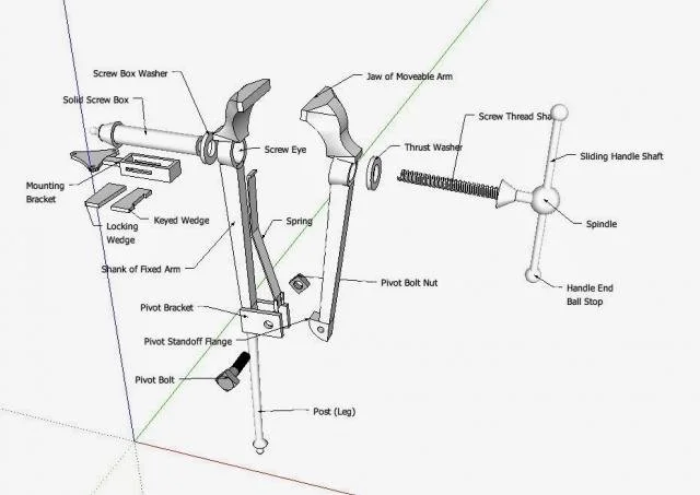

Looks like your first project is making a spring for your leg vise. Good exercise in heat treating.

Spring like what’s between the jaws in Matt’s? I also need to make a bracket too.

I'm sure you saved the old leaf springs from your cruiser? Perfect steel to make the new spring for your vise.
Nope. I gave them away. I have a nice thick rod of steel I could use for part of the mounting bracket. Plenty of other metal... head bolts etc left over too.

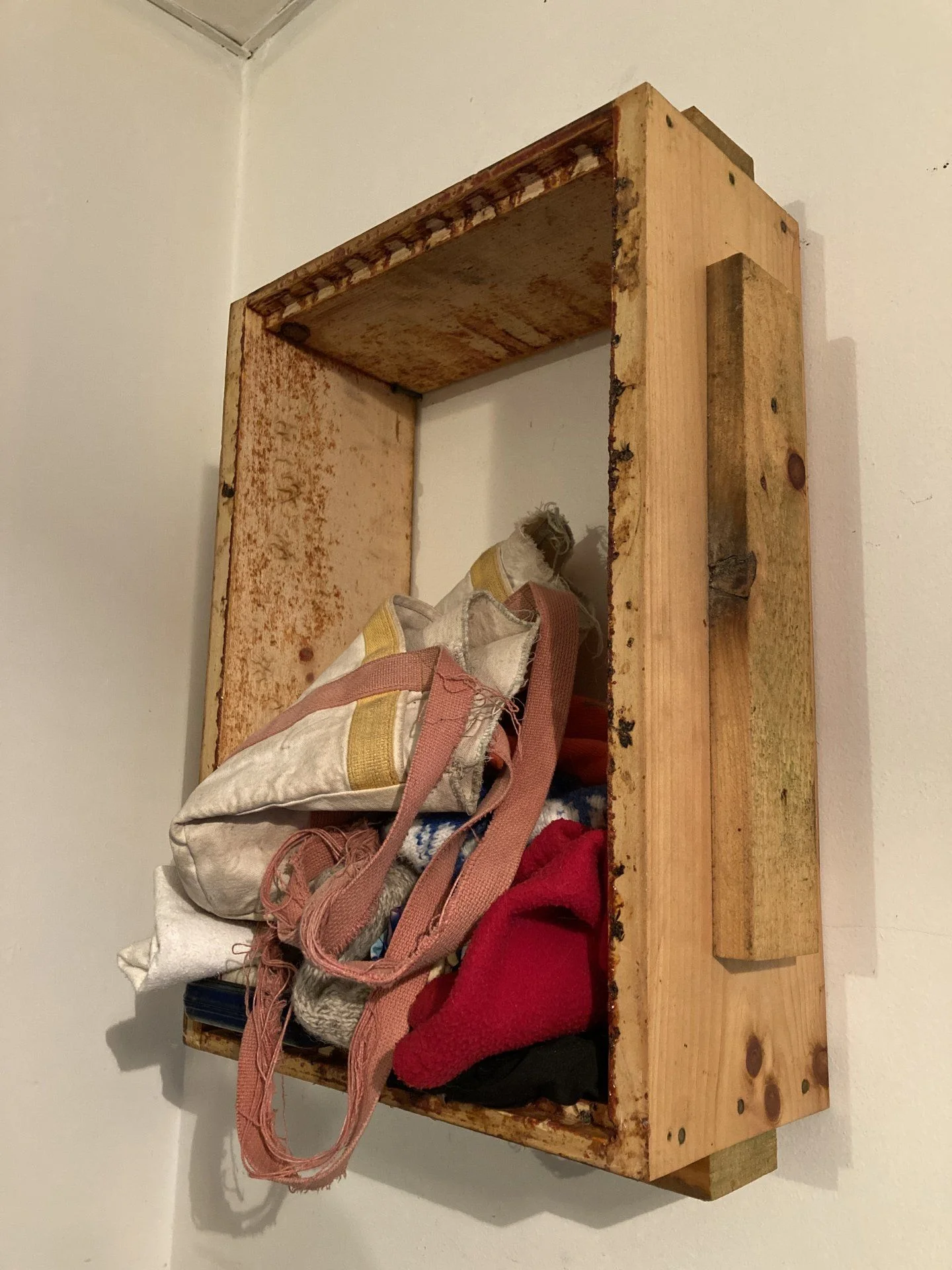

Have you not seen my bee supers? I made most of them. Here’s one of the extras... hung them in the house as cubbies for winter storage. Rough cut pine w/ the rough side inward so the bees can propolis them. I did have help cutting the rabbets but I have a small table saw now and once my bee people move I’ll be doing them all myself.

Ever seen a rabbet plane?
