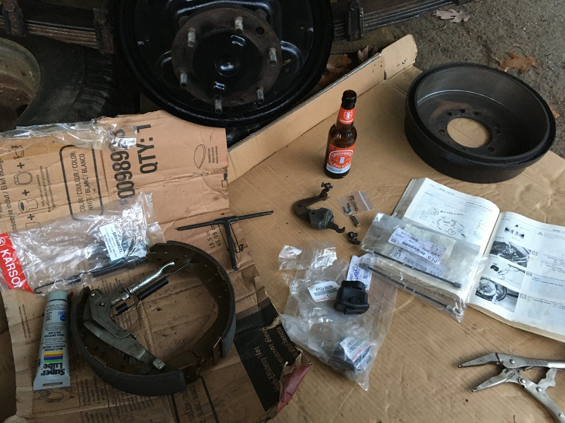

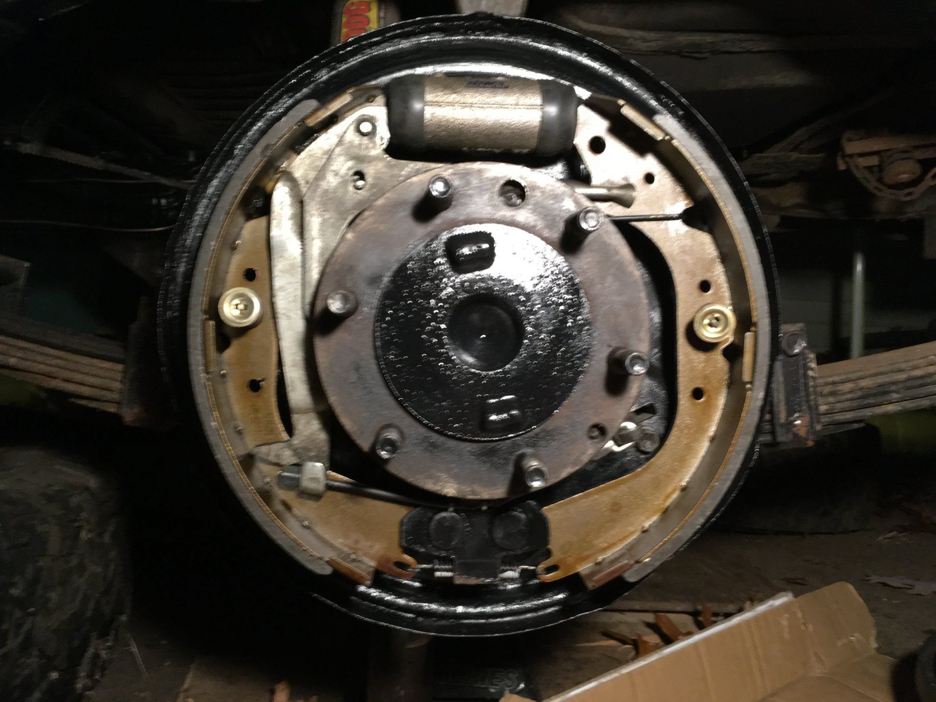

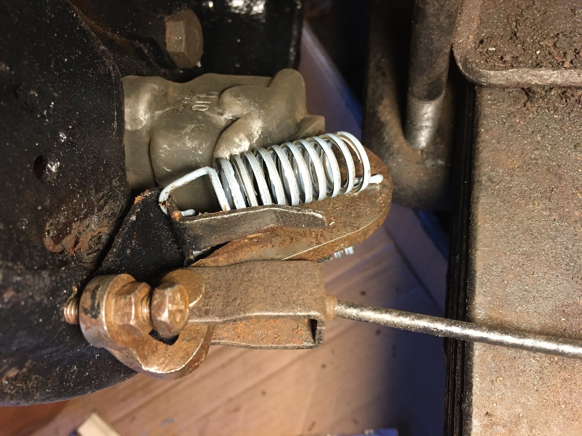

Ok driver bellcrank, shoes, holy mother of god hellacious springs (primarily the bottom one) attached. I was truely saying to myself @cps432, *(Edited for sensitive eyes) “what a complete c***y job!!!”
I have found that it is worth renting the drum brake tool kit. It really makes installing those springs less c**ty and safer for your fingers and eyes. Those things are loaded with a lot of tension and could really screw you up if they hit you just right.
Ah... I forgot all about that. :doh: I had not problem with the springs for the retaining pins nor the larger top one with needle nose vice grips but yeah just that bottom one cuz I don't have the upper body strength, no issues of it flying anywhere, just couldn't spread it easily. Maybe I can grab one at the Advance Auto near my work after my shift to do the passenger side. I a very long time ago... borrowed a SST for the springs but it really only helped with the large spring removal. Weird little doohicky, @FJ60Seth (edited Seths... I had tagged the wrong one when I had posted this previous) I kinda figured it out... That SST will be on its way back. Huge apology for holding it so long.

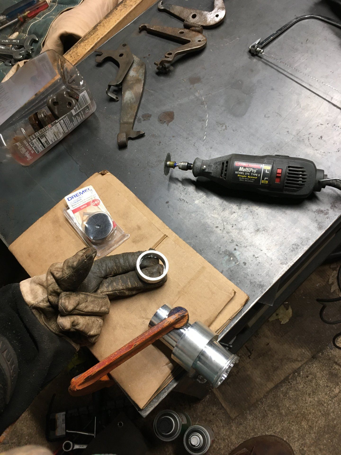

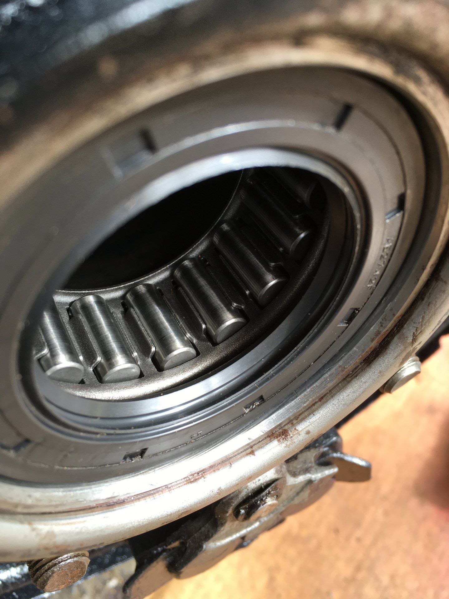

Felicity, Can I ask about the rear axle bearings? I think that you bought new bearings, and I understand those need to be pressed onto the axles? Did you do it that way or use another method?
Knocked them in the old fashioned way... old bearing and a BFH. Actually I used the 54mm hub socket from Georg. Bearing wasn’t quite enough to hang onto w/o wacking my own hand a few times. Here it is in on the driver side w/ the seal just a smidge out. I made sure to tap the seal in a bit more evenly.

Ah... I forgot all about that. :doh: I had not problem with the springs for the retaining pins nor the larger top one with needle nose vice grips but yeah just that bottom one cuz I don't have the upper body strength, no issues of it flying anywhere, just couldn't spread it easily. Maybe I can grab one at the Advance Auto near my work after my shift to do the passenger side. I a very long time ago... borrowed a SST for the springs but it really only helped with the large spring removal. Weird little doohicky, @Seth_O I kinda figured it out... That SST will be on its way back. Huge apology for holding it so long.

I’ve found that assembling all the parts on the hub, putting a ratchet strap around the brake pads and tightening everything up makes pulling the springs into place very easy.
only figured that out the second time doing drums where I almost quit and flat bedded it to a dealership.
@EscapeWagon62 thamks, I’ll try that if it comes down to it. Hoping tmrw. Kid comes back to me Mondays and I always try to schedule my covid tests at a local pharmacy Monday’s too so hate to take more time from him for myself any further. Second one will probably go easier I imagine.
Back on her rear tires. Loath how slow I am. Two hours for the passenger side bellcrank, shoes, drum and tires. Oh well. One tiny step further. Thank god for the flat bite hemostats I snagged from work... those bellcrank boots are worse than an unlubed condom.
