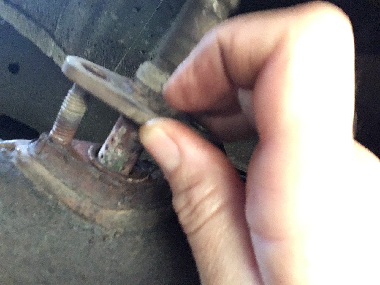

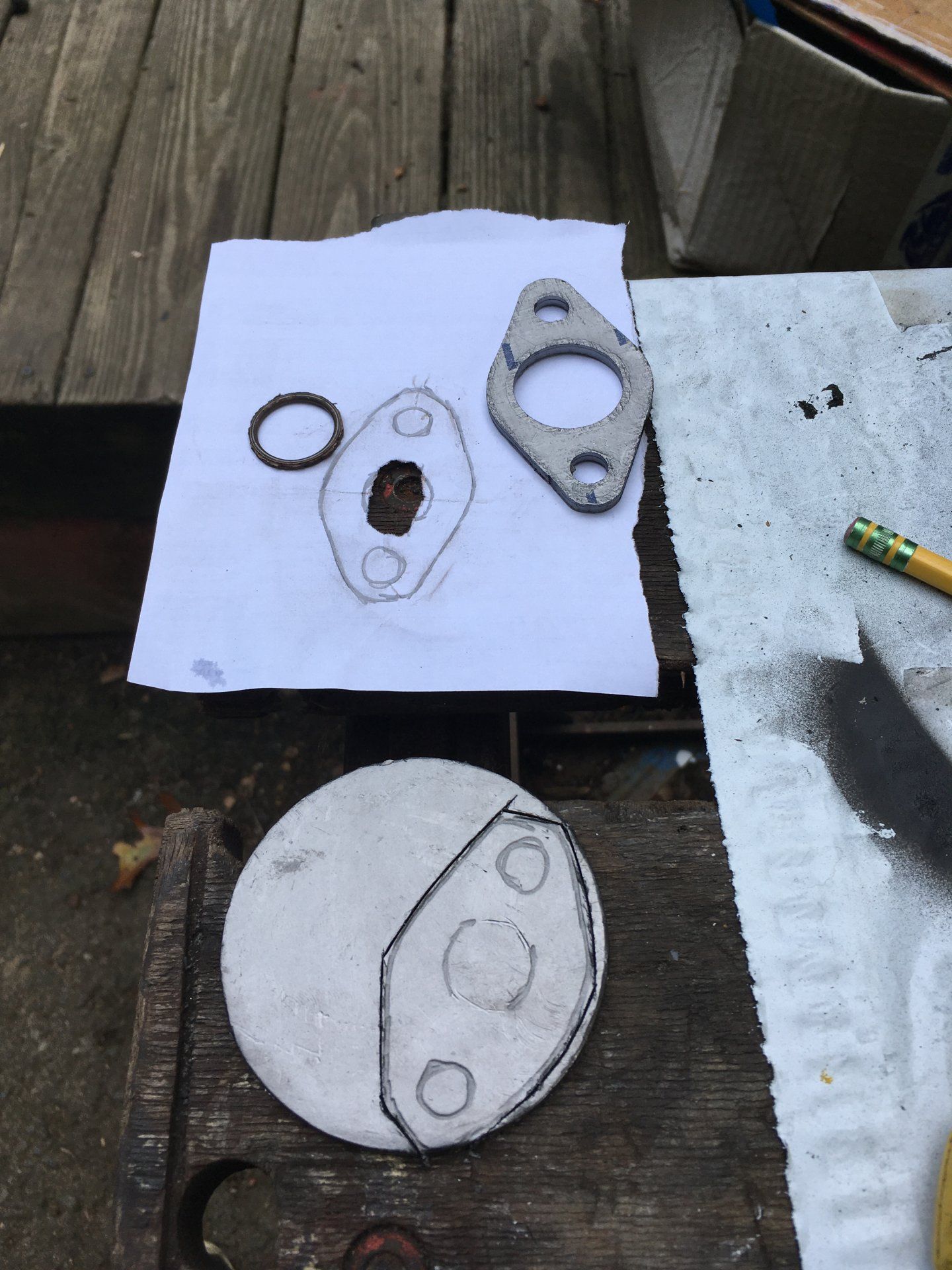

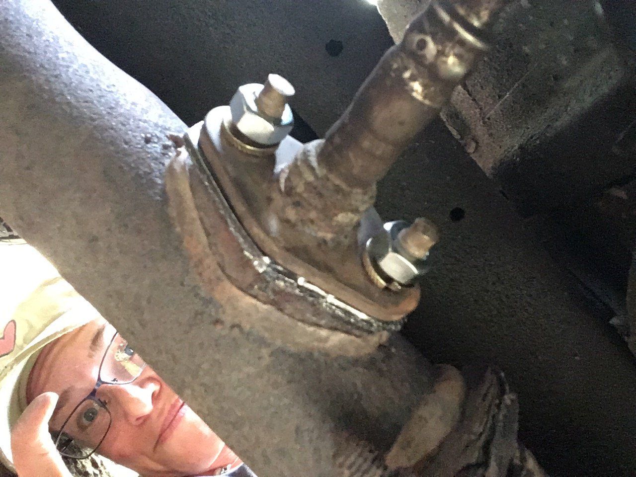

‘98 Tacoma.... Driving to work the last couple days I heard a higher pitched rattle that came and went and sspt noise. Figured it was exhaust. Got under it a bit ago and found a large metal hose clamp loose on the down pipe section. Reached around and found an O2 sensor plate loose, no nuts. Deduced quickly. Only the ring from a gasket remained. Found nuts and lock washers first grab in my extras 60 stuff, exact fit. Grabbed a graphite gasket meant for the egr pipe... smidge too big. Found the sample piece from a remflex manifold gasket, made a pattern, cut and installed.
Bah bam! :banana: job. :)
oh AND it passed emissions all flopping around like that.

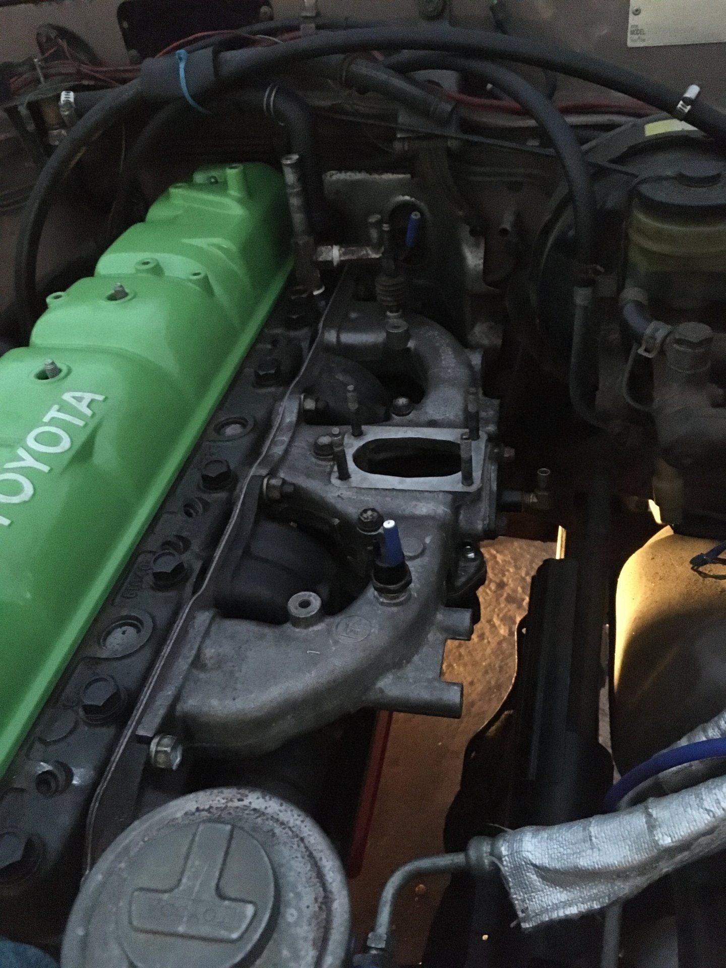

There I am hefting the manifolds back on and I look down and start laughing... no exhaust j pipe to attach it to. And yes, that’s a double gasket job, just shhhhh.

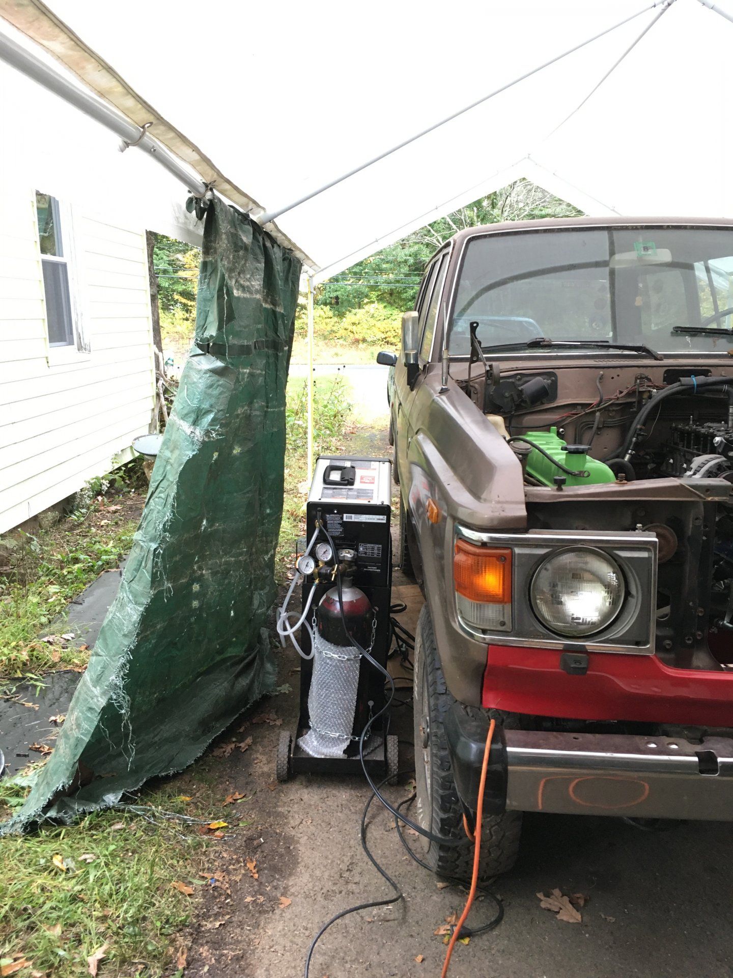

Ground my s***ty welds down and replaced. Still blows. Gotta be the oil I doused the inside of the frame somehow affecting it. Fair amount of smoke. Whatever. I could be at this for longer than I want to say. I’m trying to dress up a pig.
:beer: That stinks... Really.
It’s what it is.
