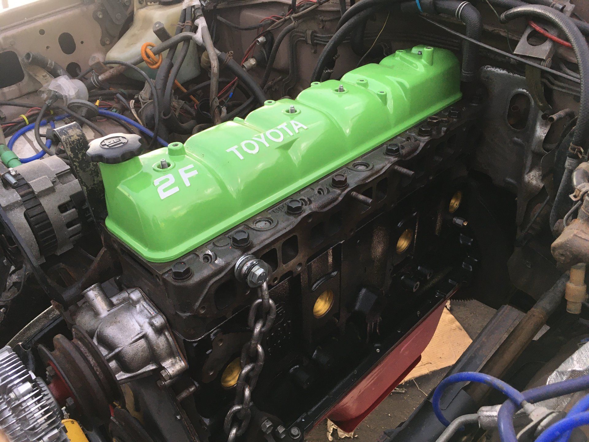

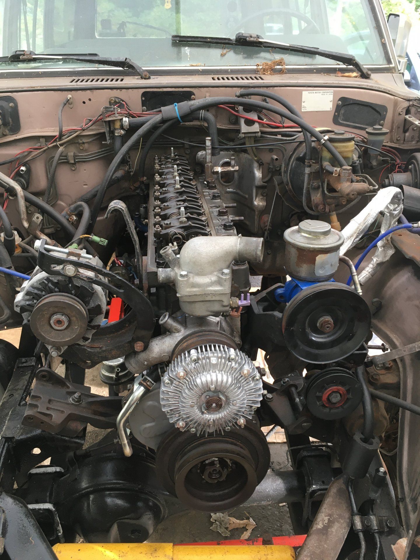

Not running yet buts it’s getting together. Off Sat and will get a nice jump on her.

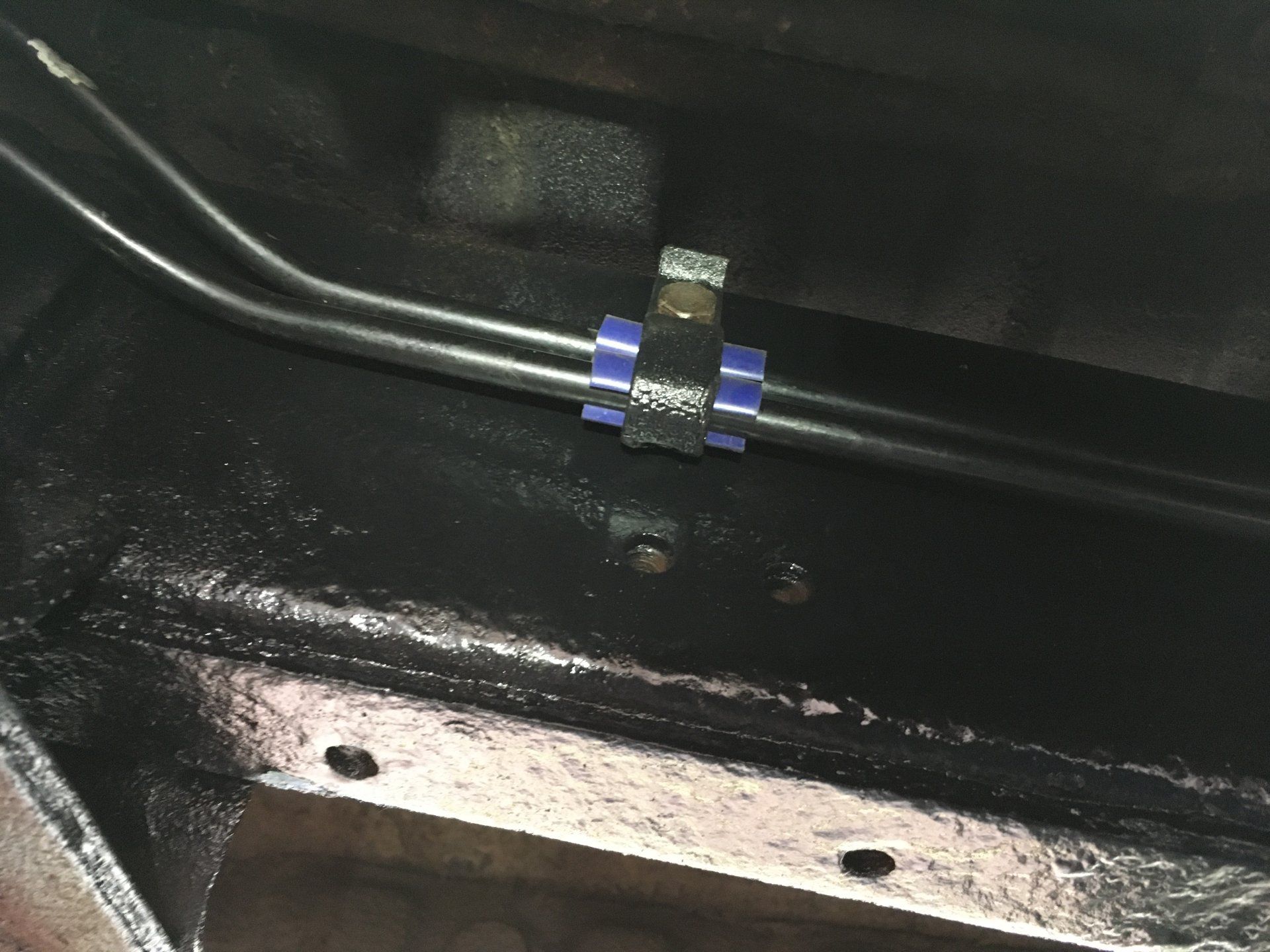

I did clean up the middle sections of the frame rails earlier, ran a tap (M8 1.25) through all the fuel and brake line bolt holes then sprayed it down w/ ospho. Shoulders and arms are wiped.

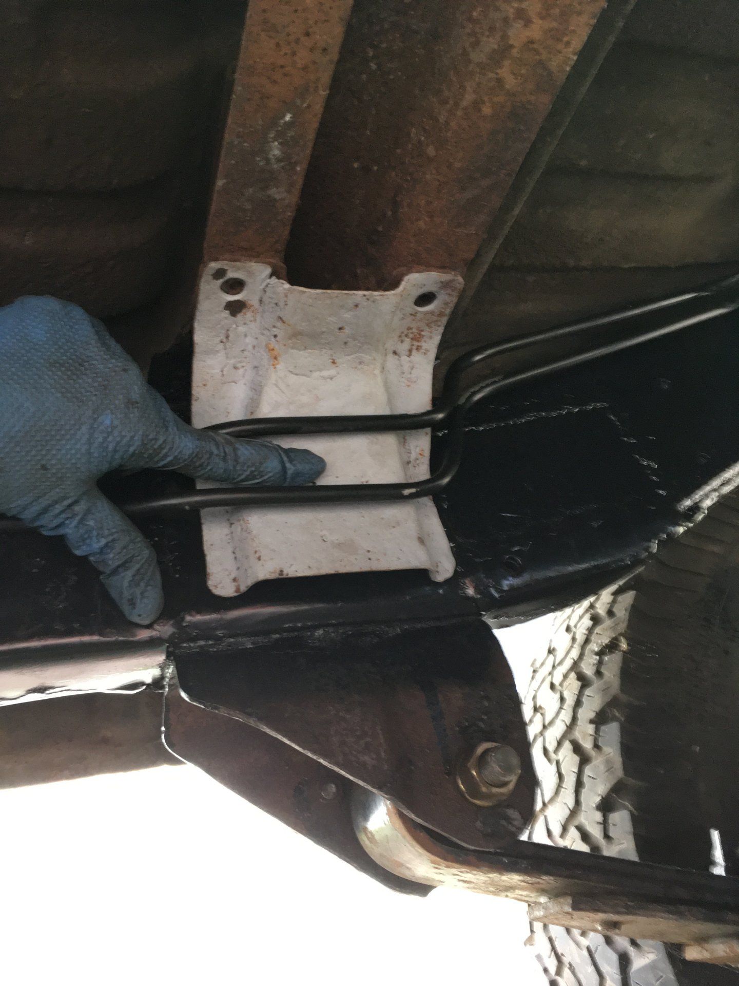

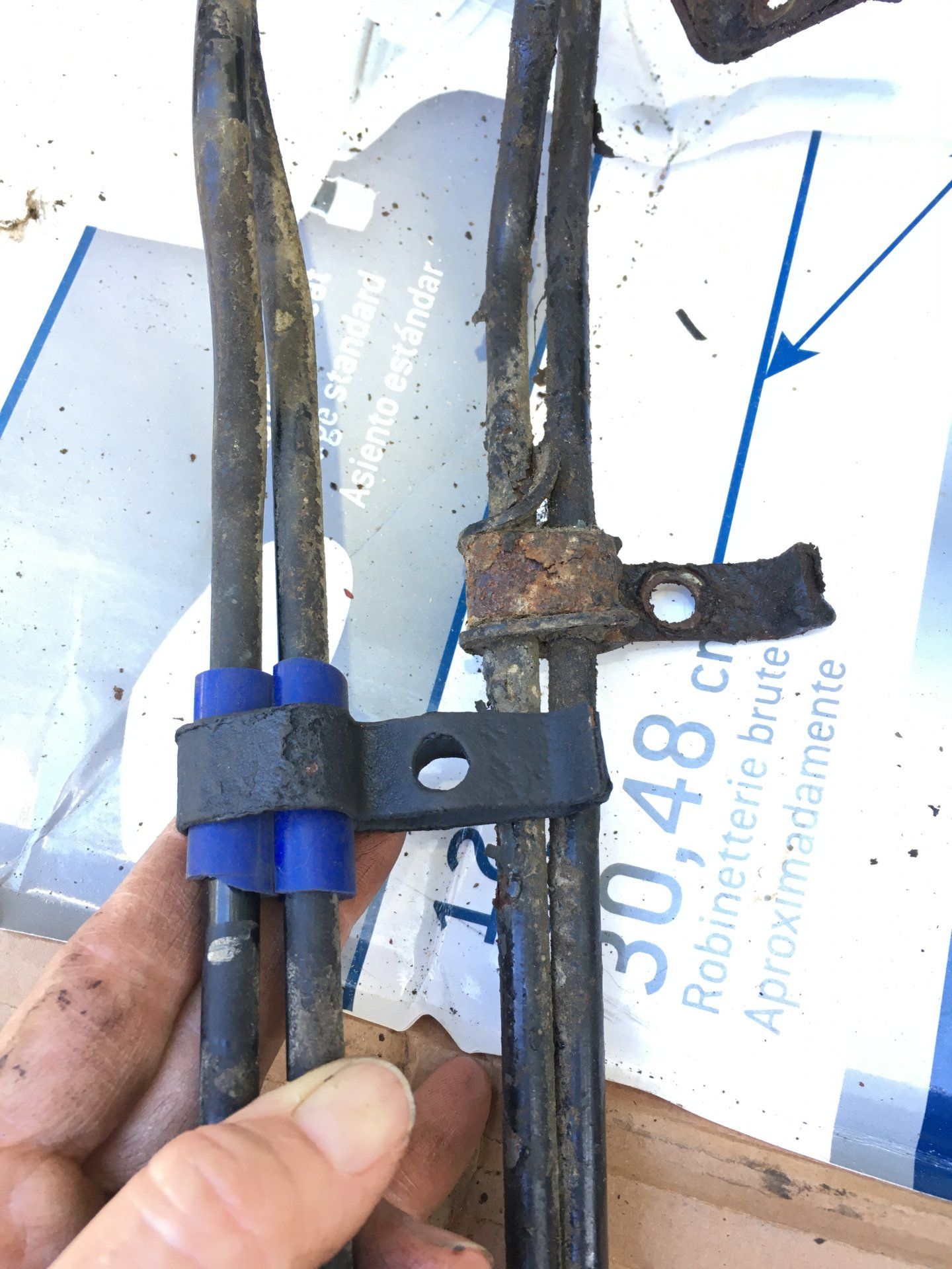

Bits of pieces...
Tommy thanks again for the fuel lines! @tmxmotorsports

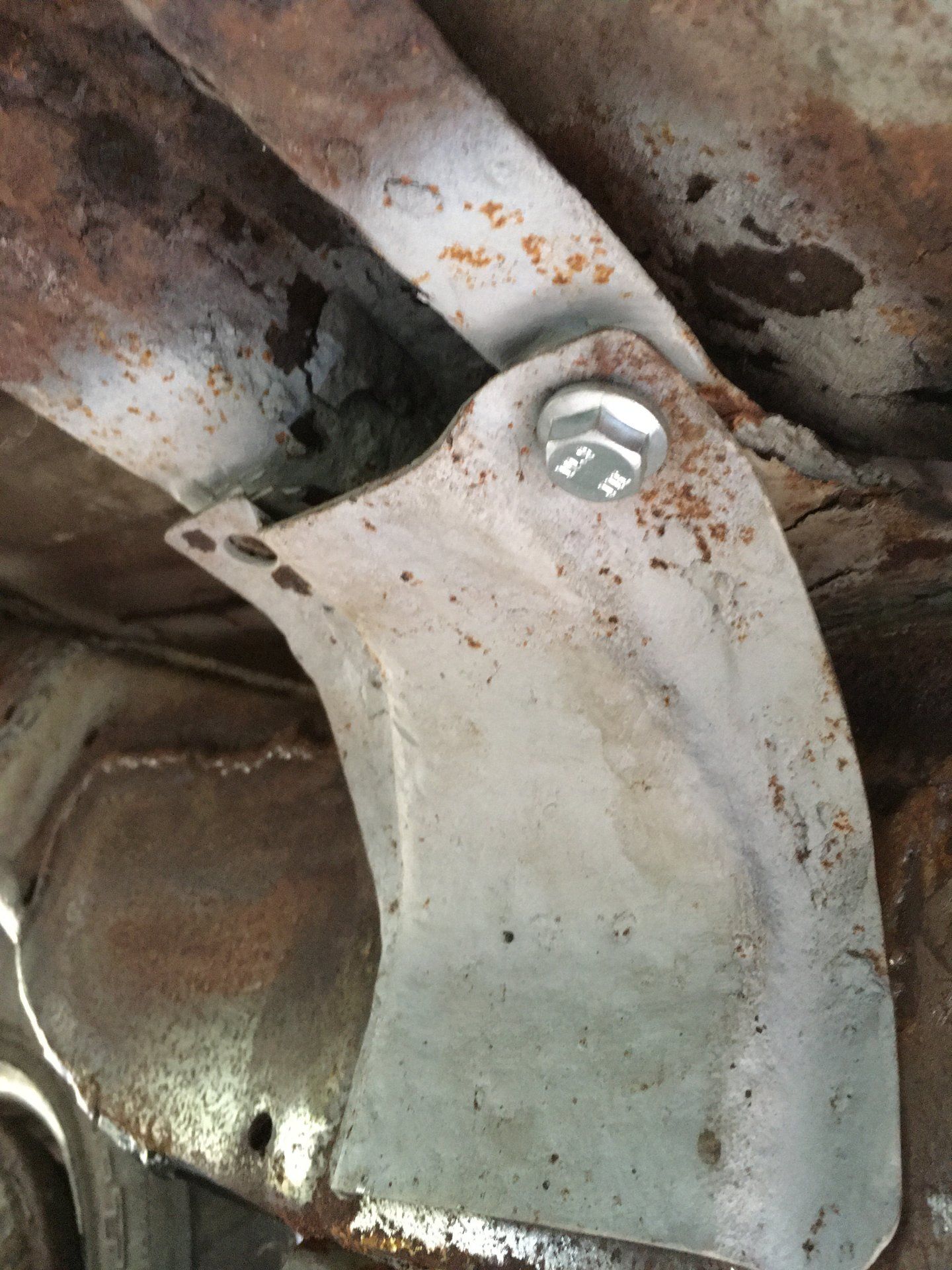

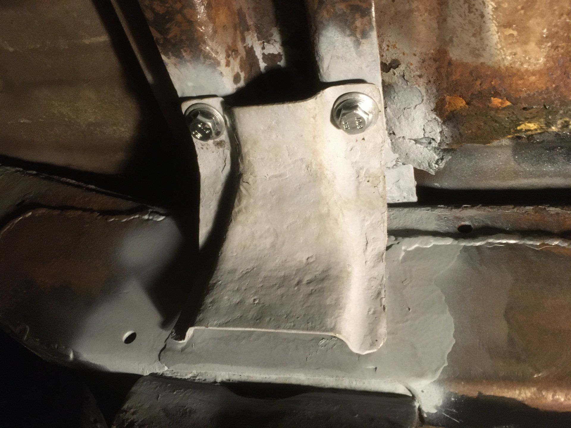

I need to get the frame gussets (I think that’s the name) held on w/ bolts and nuts on top and welded to the rails. I need to remember I can’t get ahead of myself. Too easy to plow forward.
Ok let’s do this!
Welp.... four beads of super ugly bugger welds. I won't even take pics they are so awful. Metal prep on the gussets weren’t as good as it could have been and I swear zinc weld just makes it worse. BUT the gussets are on. I grind down and redo maybe after work tmrw. I blame the combo of two beers and my blond roots...
So you welded over that primer?
It’s that weld through stuff. I need to stop trying to use it. But really the metal prep underneath on the gussets stank. I bullnosed through even after the first went poorly.
I agree. Good job.👍🔧🛠
Which brand of weld through primer did you use? The stuff we used on my son’s bumper project welded sooty, but we got decent beads laid down. I’m skeptical about how well it will prevent rust (and we llive in Colorado, so don’t have the salt issues as badly as you have) but I’m hopeful that it’ll help.
