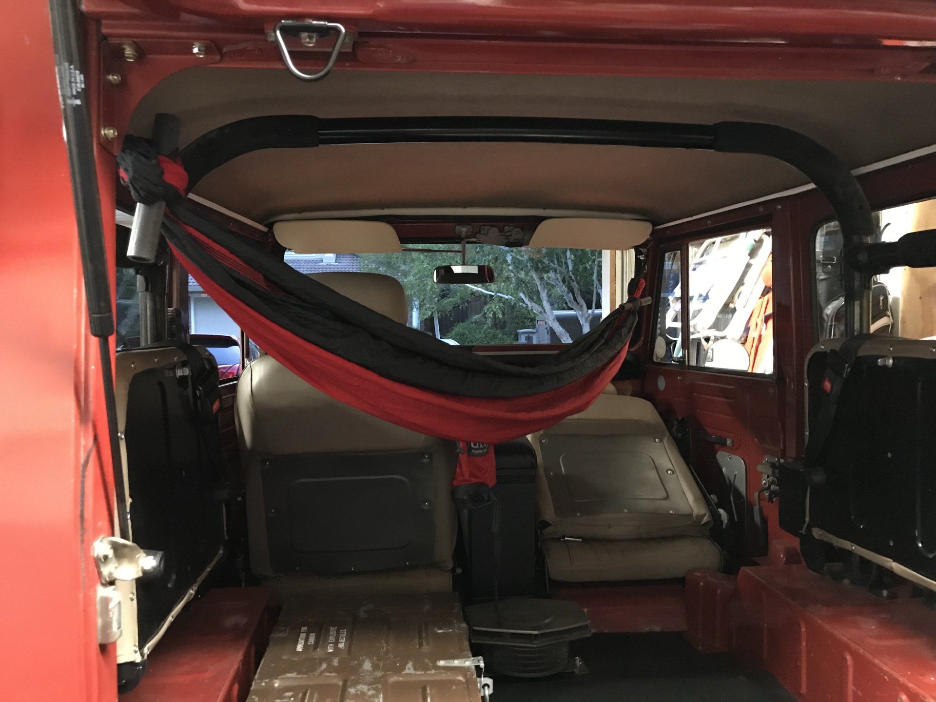

Heading out for a quick road trip with my Land Rover friend and decided I’d setup my hammock in the cruiser since it will only be one night. Had to shorten up the hammock but otherwise works great! We’ll see how my body feels about it lol.

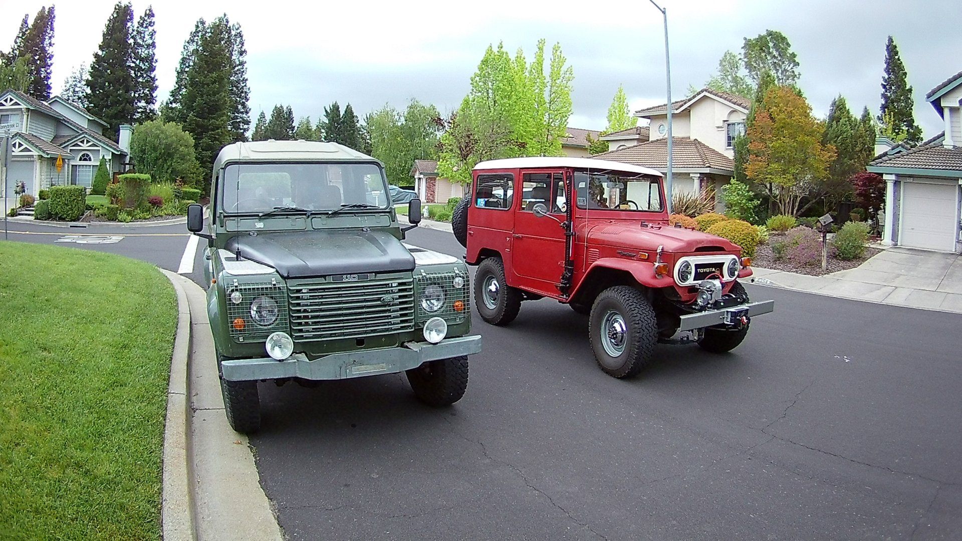

Infiltrated a Land Rover get together... definitely out of place with all the Landies. My hammock setup worked great other than it being a bit awkward to get into the sleeping bag since it was bigger than my shortened hammock. I have some ideas for a sweet setup which will allow the sleeping bag to lay flat and should be easier to get into. And more anchor points to spread the load. More to come on that hopefully.
Little downpour while last night stayed nice and dry.
Well, this was how I was thought of... actually not really everyone was very cool and when they approached me they quietly said they really liked my Land Cruiser don’t tell anyone I said that. This particular Rover was a true military spec model complete with helicopter lifting points. Guy works for Advanced Adapters. Apparently even associates with a Land Cruiser guy we know and love @orangefj45... ;)
Snapped a shot on the way out. Too short a trip, but good times! See it’s not just a pavement queen lol.

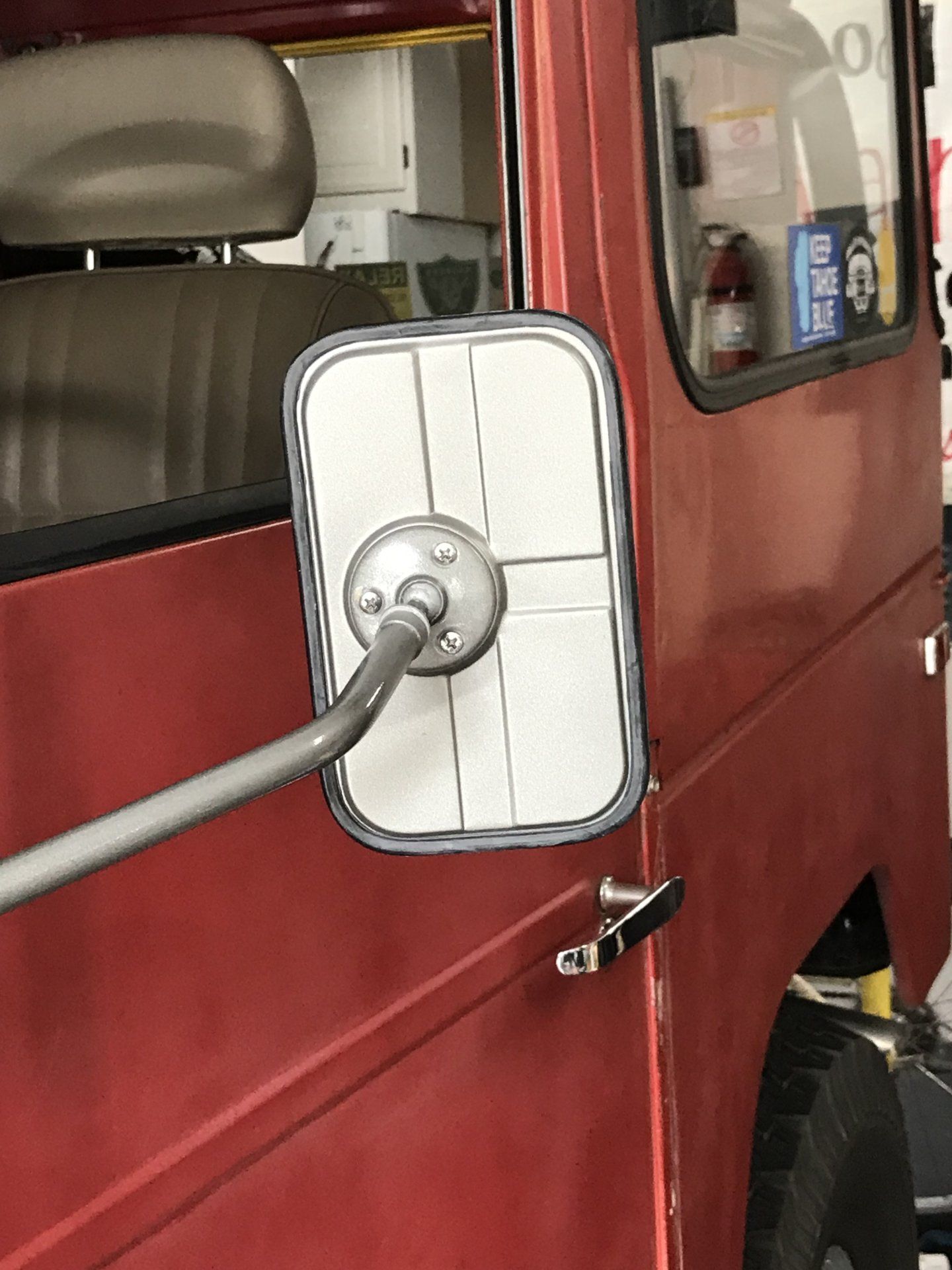

Not a very exciting post - decided I needed more mirror real estate and I had these already so why not? And no the passenger side isn’t convex sorry.

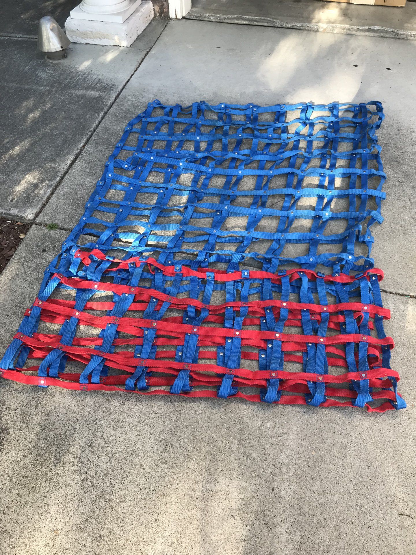

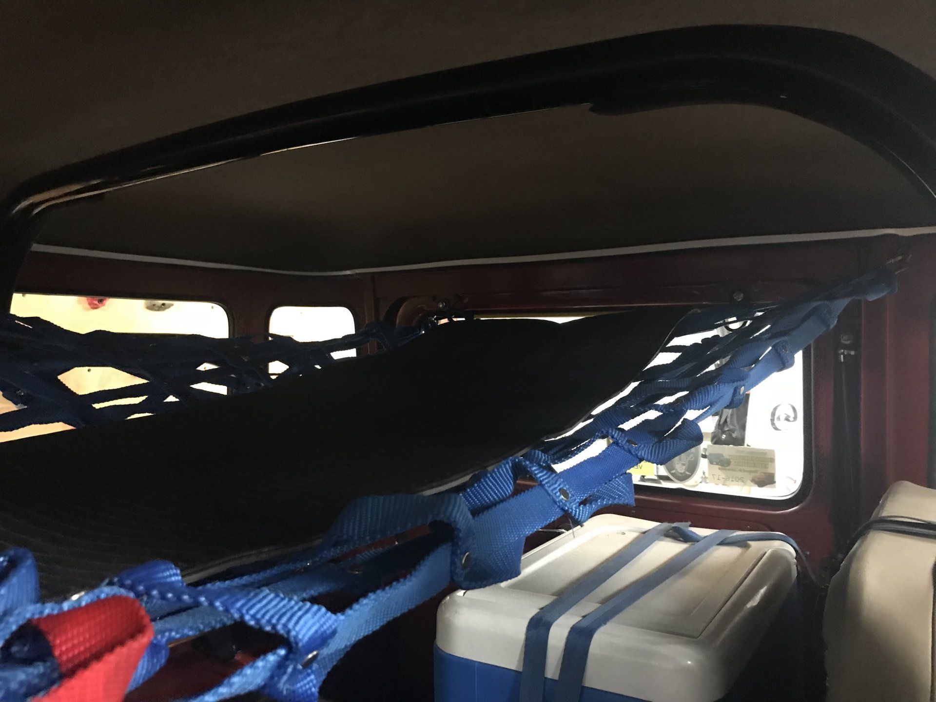

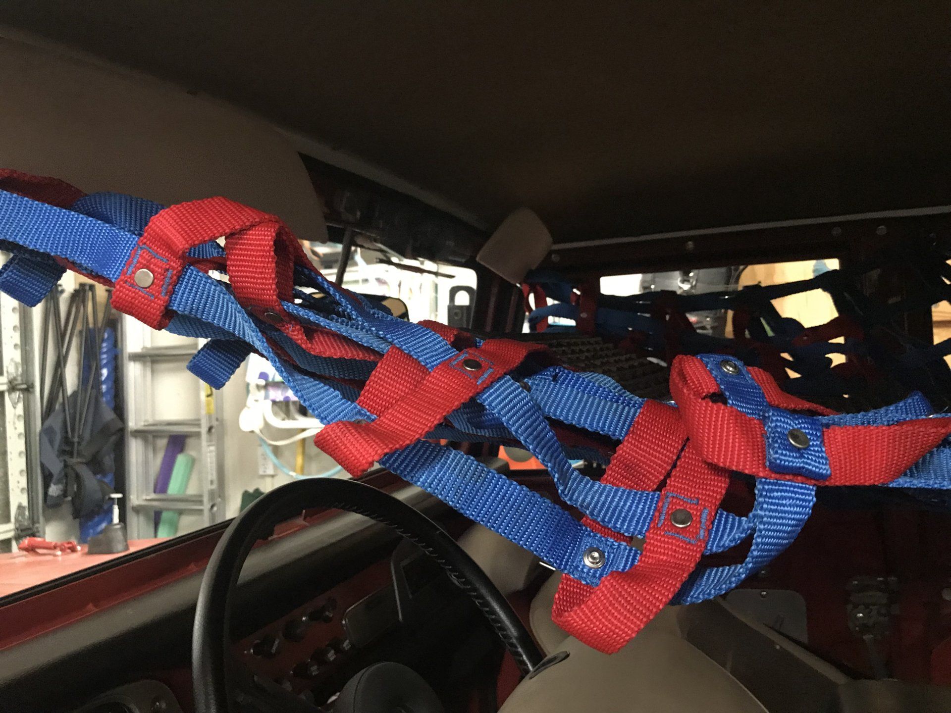

Finally got my suspended bedding material. What a smoking deal on that webbing mat - on sale for $42. Normally $269! I added a box of sharpie markers to bring my total to $49 for free shipping. The mat is 8’x9’ and says can carry 1,100#. I had to fold it in half and then fold about 2’ on the length to get it the right size for the cruiser. It’s about 4.5’ wide by 6’ long when folded.

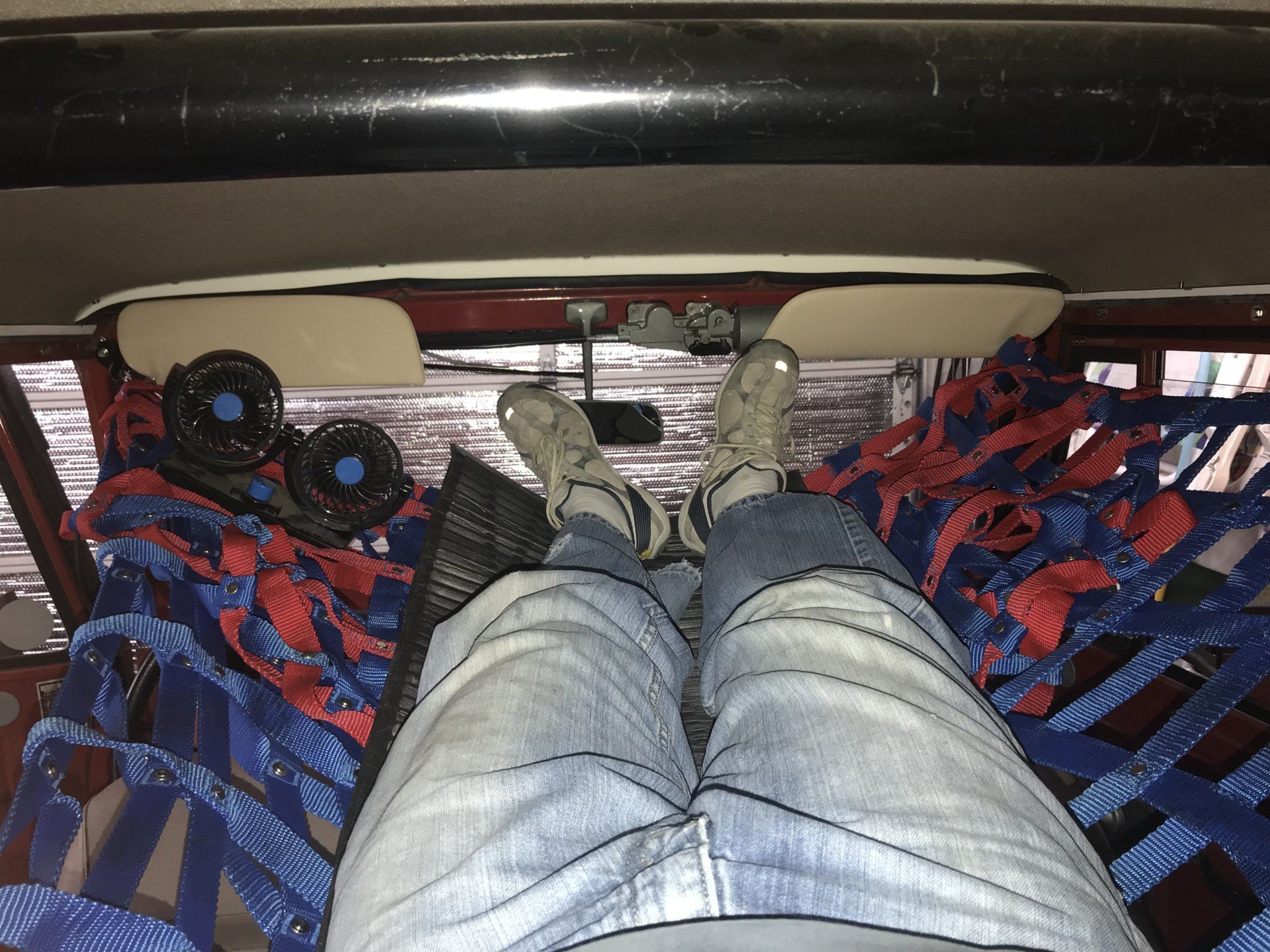

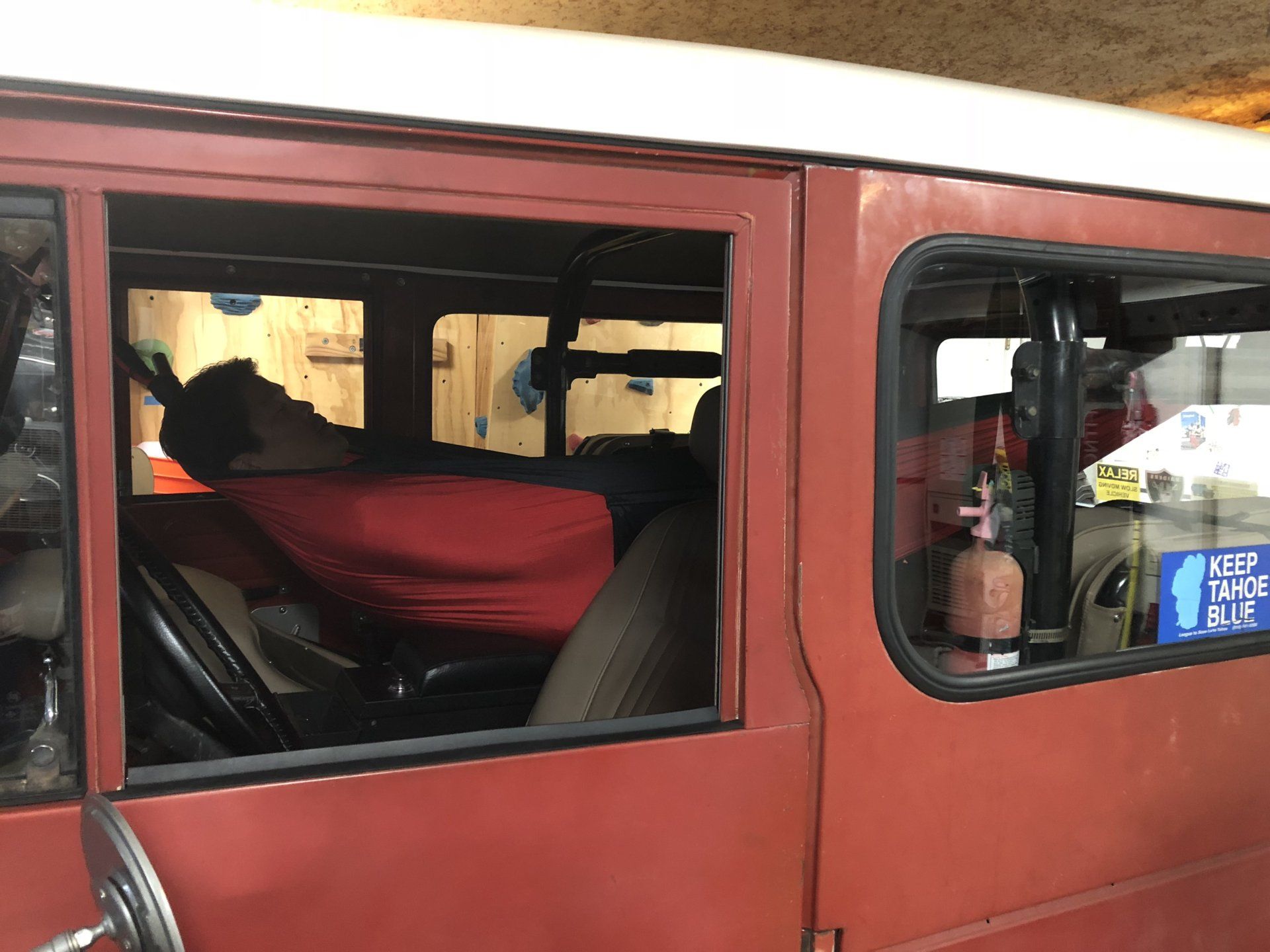

I replaced a few bolts with hangers/anchors. Used grade 11 bolts and load rated hooks. Probably way overkill but who wants to crash down in the middle of the night? Anchor points are at the top of the A pillar (removed one screw and replaced with bolt and washers to secure the anchor): one at the B pillar on the passenger side (could add one on the opposite side if necessary); at the rear I replaced one of the hinge bolts and then have an anchor at the C Pillar? Anyhow it is rock solid! I set down a camping mat so there is some surface area on the webbing. A sleeping bag and pillow are all I need now! I have a battery powered fan near my feet blowing on me since it is a bit hot.
I know a bit crazy but for about $60 I’ve got a nice sleeping area if I don’t want to setup a tent. It is really quite cozy I’ve been laying in it now for about 30 minutes.
