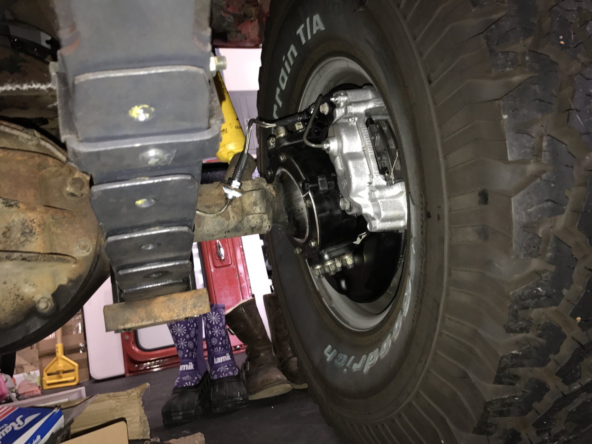

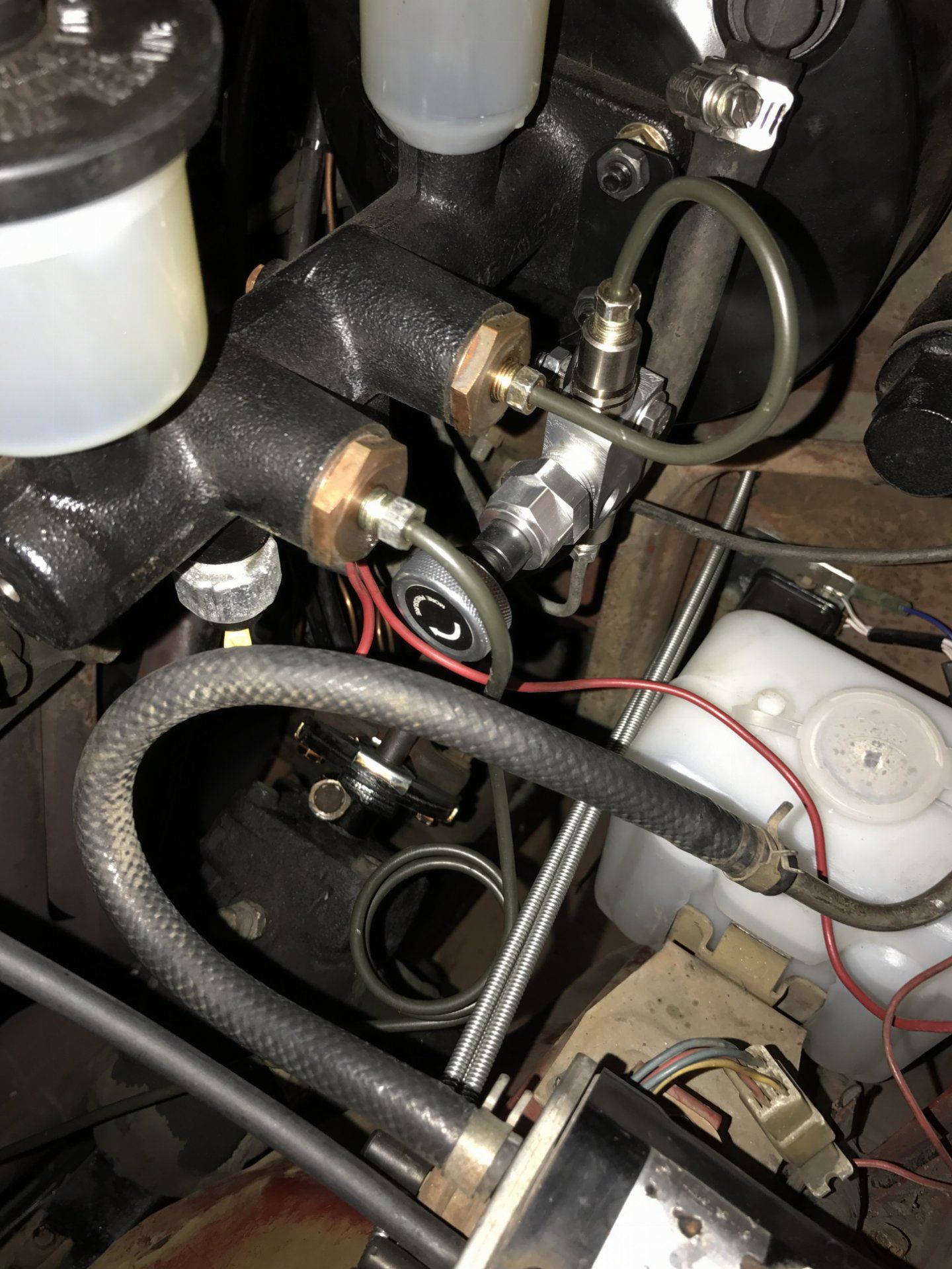

Thanks! I'm going disc brakes on the front - will include disc "outers" with OEM Aisin hubs, new rotors, re-manufactured calipers, new pads, new brake hoses, new brake hard lines, all hardware, spindle lock kits, knuckle rebuild, etc. Will use @Racer65's adjustable proportioning valve (Adjustable Brake Proportioning Valve for Toyota Brake Lines - Fits FJ40) for the setup as well. I've got new aftermarket Japanese brake calipers for the rear so those will get swapped out as well. And hoping to get some pesky leaks fixed too. Wife wasn't too thrilled about it but as my friend says, "safety shouldn't count towards the refurb budget!" ;)

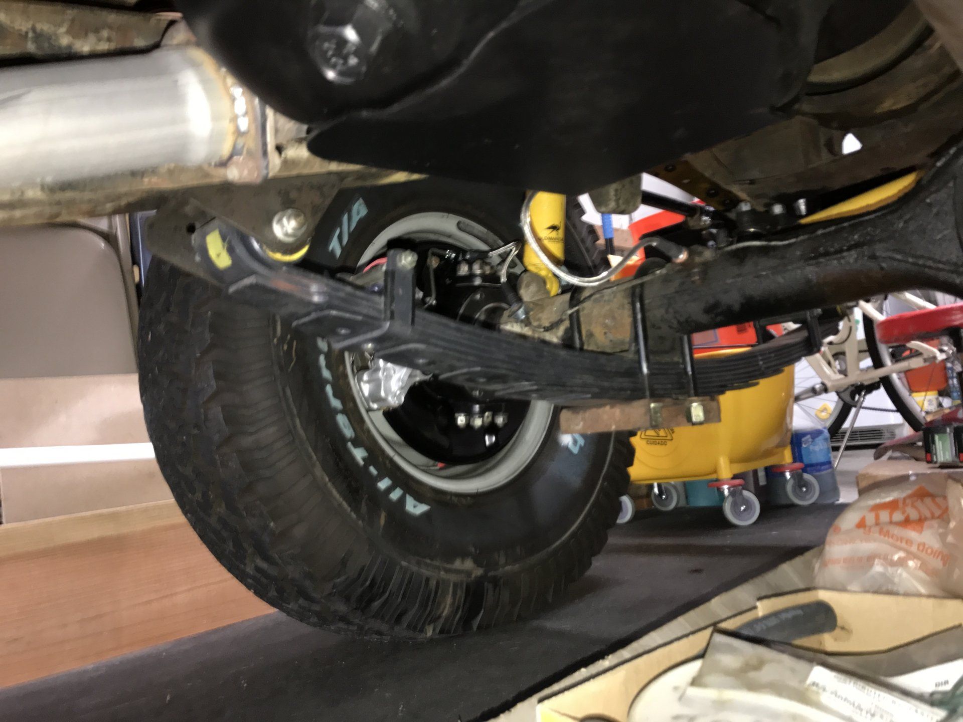

Got the cruiser back from @orangefj45 at the Valley Hybrids land cruiser spa and lounge. Super happy with the work done there! Brakes are great and two leaks were fixed. Hopefully that is the last of them (for now lol). Only one remaining old rubber hose left - the clutch hose. Will replace that soon. Thanks again Georg for fitting me in that crazy busy shop of yours!
Hit 70mph on the pass coming home wow that is a bit sketchy and the heavy winds didn't help. But the brakes got me back under control nicely. :)

More brake shots including SS hoses:
Sweet adjustable proportioning valve from @Racer65 with a custom bracket from Georg and new hard lines:
Looks awesome, how would you describe the difference in drum and disc brake?
Well I drove mostly freeway home but for sure the pedal was firmer and it tracked straight under slightly harder braking. Biggest thing people have said is no constant adjusting of the drum cylinders and better performance when wet. I have new aftermarket Japanese cylinders for the rear which I will eventually install. New pads too. Seems to brake nicely though with the old OEM ones. But I don't know if they've ever been rebuilt. Makes me a bit nervous those seals are almost 40 years old.
