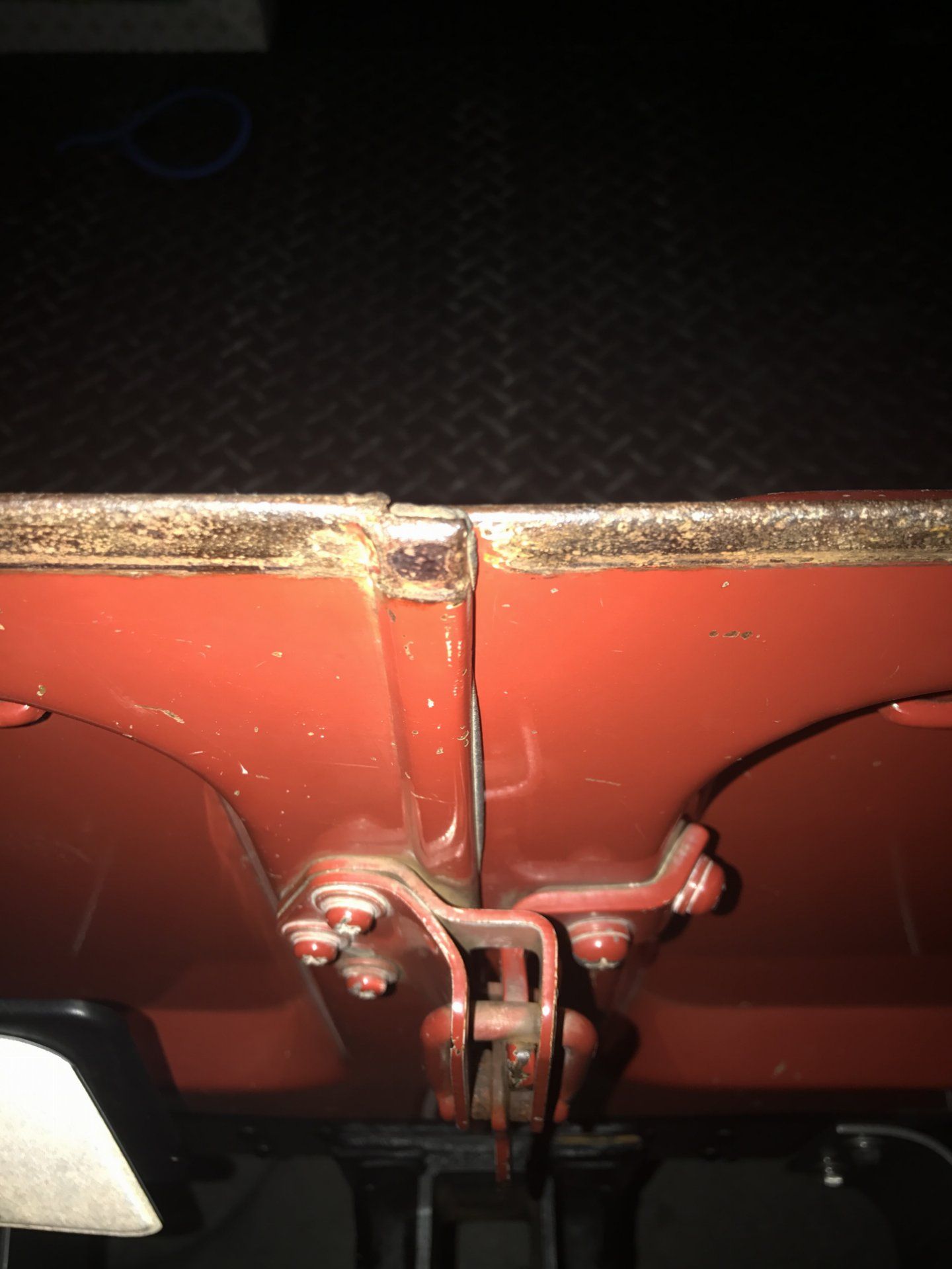

How do you install the weatherstrip at this spot where there is a dip? Just have the weatherstrip follow the contour? Or build up the glue so it is flat there?
