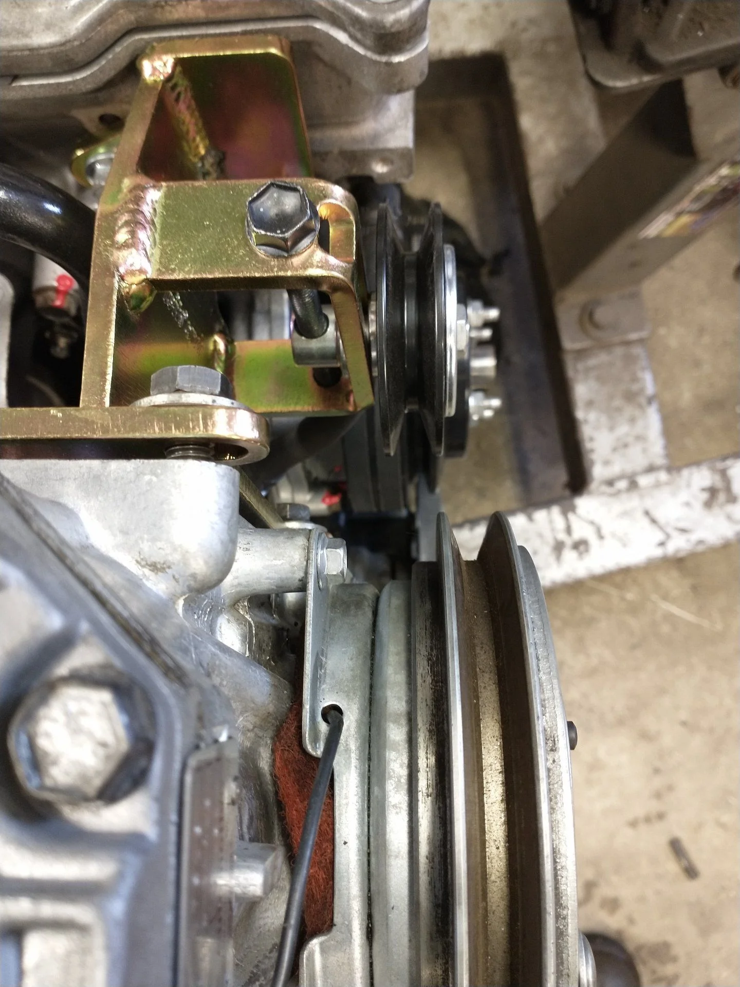

I didn't read all 25 pages, please forgive me if this observation has been reported
Though all standard size Yorks are dimensionally the same, the clutch & pulley are specific to the vehicle manufacturer. There are different diameters, offsets, groove widths, single or double groove, even multi-rib. This to preface my getting hold of a beautiful 210, plugging the oil passage, cleaning schmitz off the outside, changing oil... Only to find the Audi belt groove is way too offset to line up. Doh!
So make sure the compressor has a pulley groove that is close to the compressor, if using the Wits end mount.

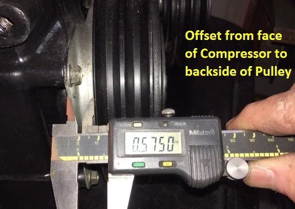

I believe you'll need a clutch with a 1/2" to 9/16" offset (depending where you measure from).
Both of mine measured as below (from face of compressor to backside of pulley).
