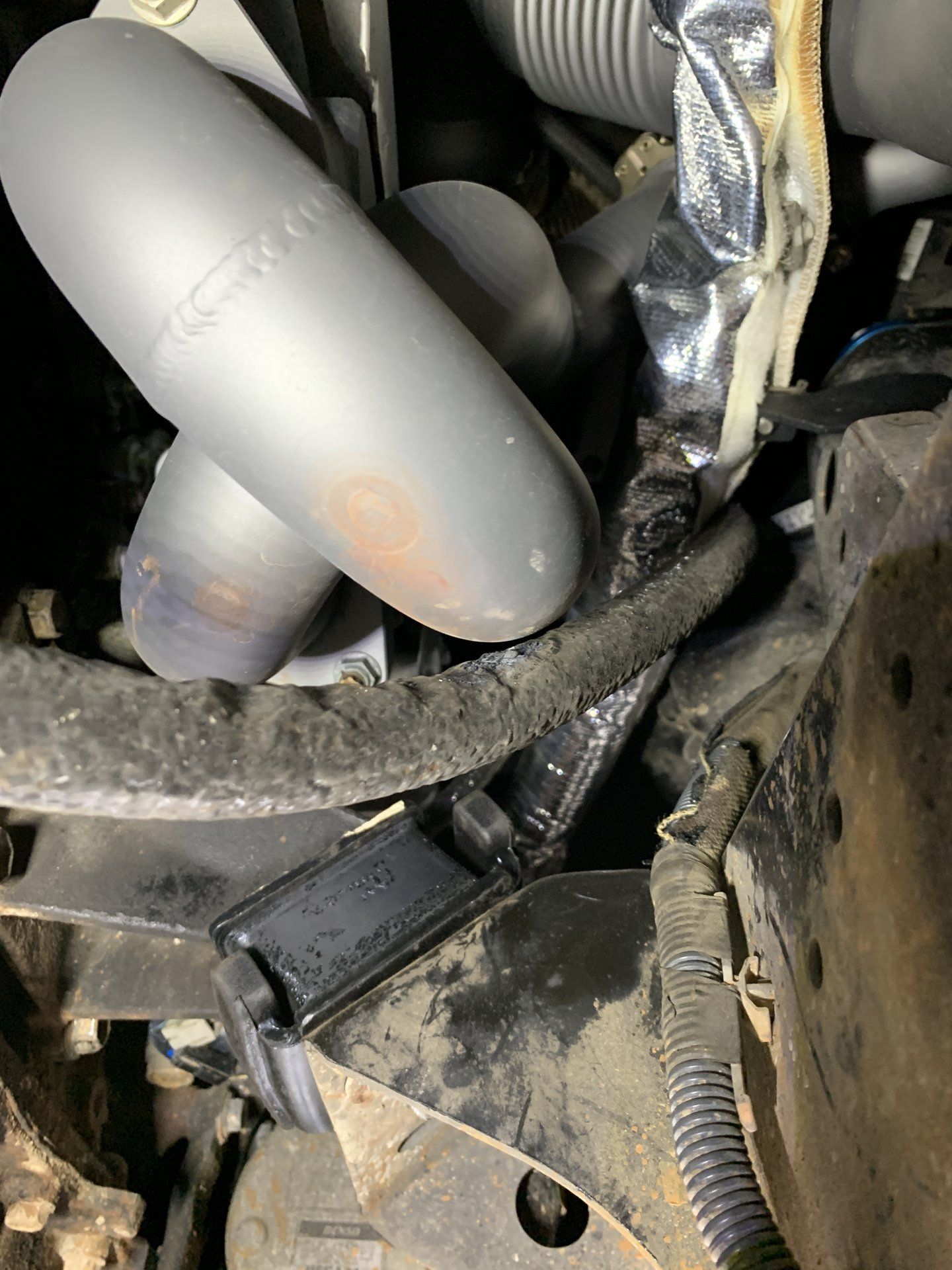

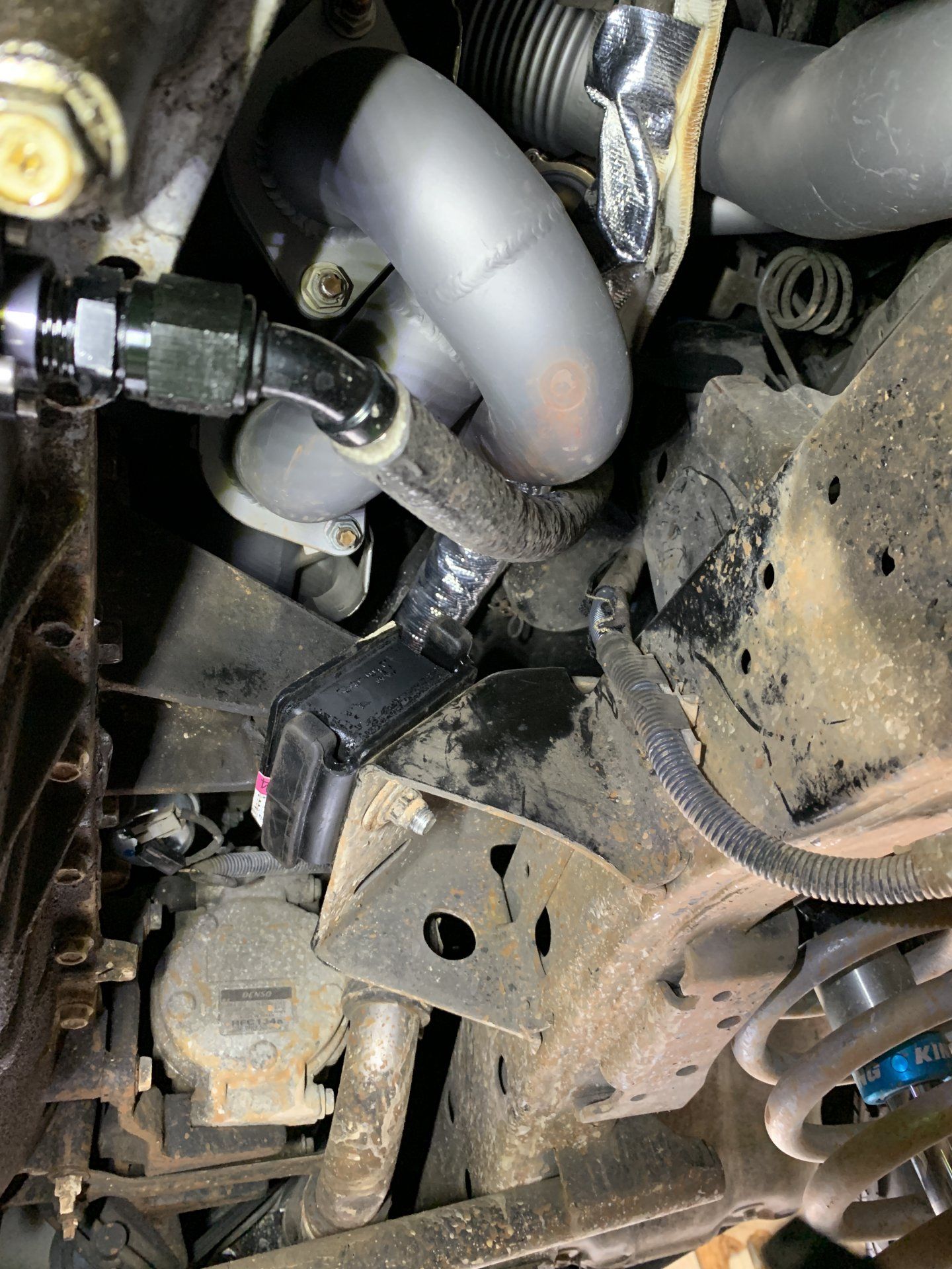

Does anybody have insight on how to route this turbo return oil line? It's pretty close to the J pipe.
Got it. Just loosened the fitting and moved it to the placement you have. Thanks for the picture.
