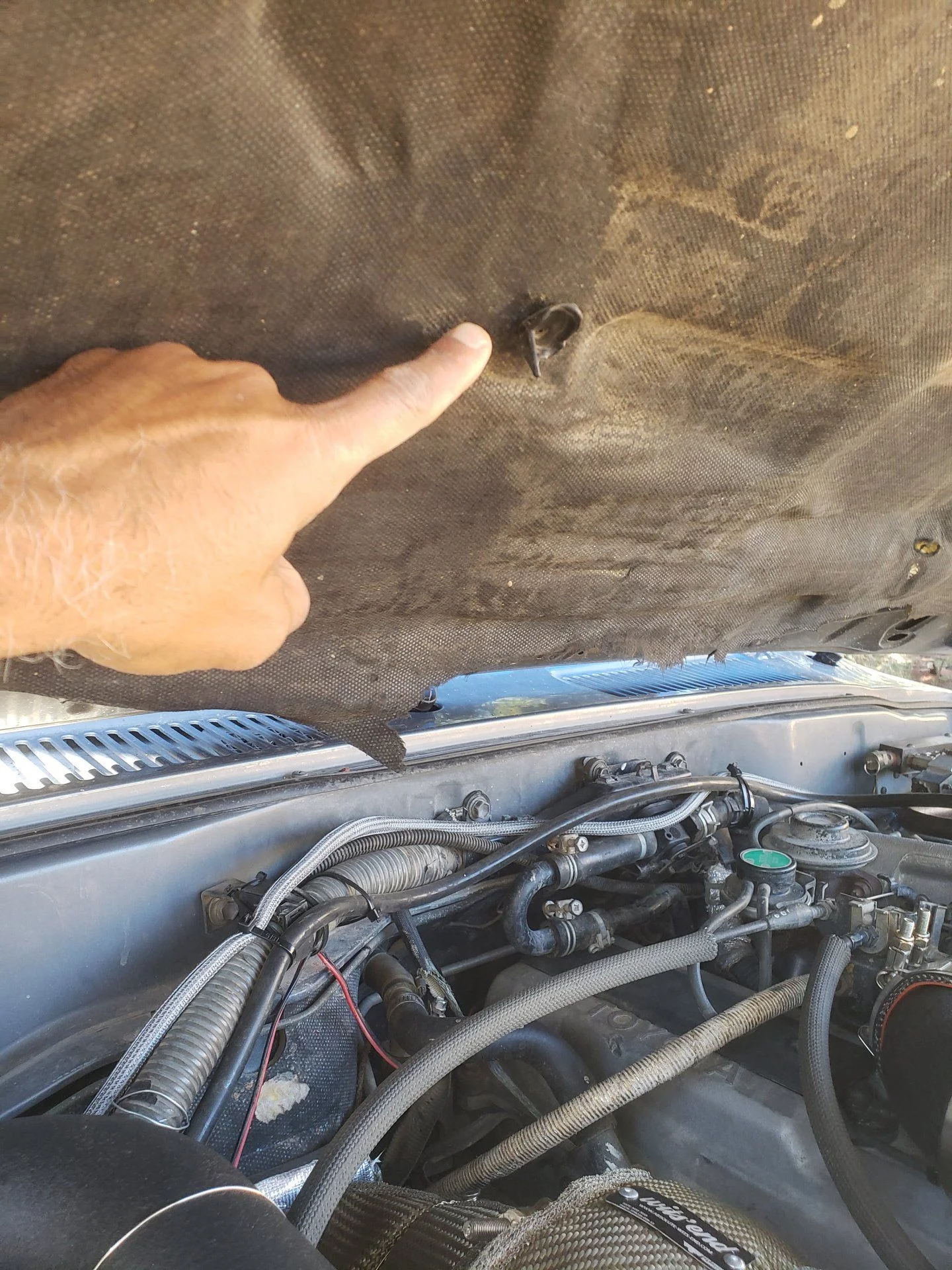

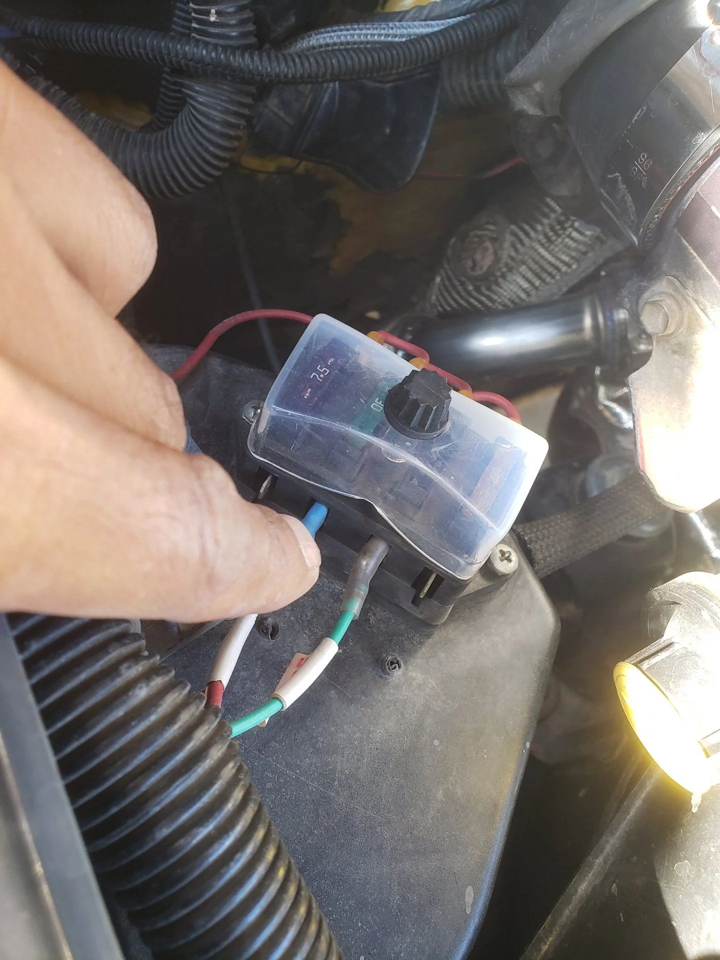

What are you seeing deform? Curious as I haven't noticed anything yet but am a bit paranoid about it.
These things so far
Yeah that’s cheap clear plastic likely not rated to even be under the hood to begin with.
The hood clip yeah, it’s likely a victim of being too close to the downpipe/turbo.
FWIW the blanket took care of all of that. In hindsight I should of ceramic coated my own pipes.
that fuse cover has been underhood for ten+ years w/o deformation but one week of the Turbo took care of that :)

I'm not sure if this is a real issue, but it's my observation.
No it is a real issue for you. I am just curious what other factors might play into it. Do you have anything else under hood blocking air flow?

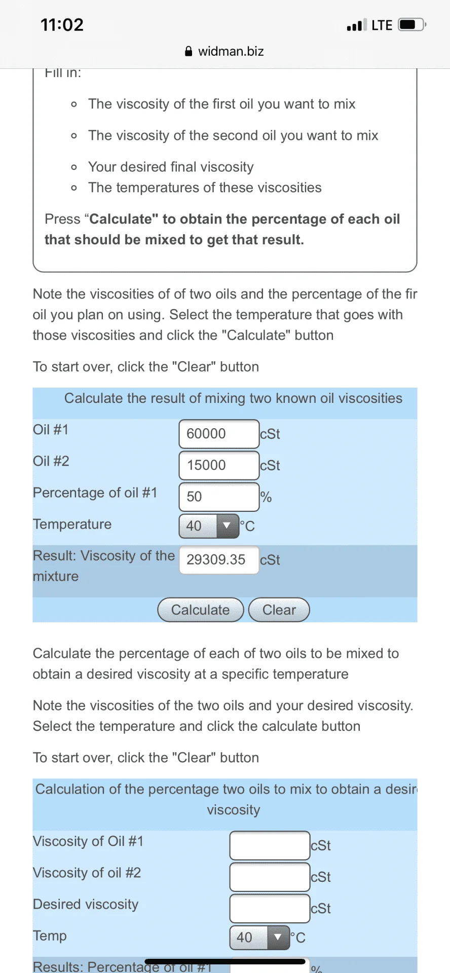

I just picked up a few bottle of CST from a local hobby shop. I got a bottle of 15k, 20k and 60k. I am going to mix equal parts 15k and 60k to make 30k.
I will likely end up do hood vents, but going to start with getting this hub modified.
