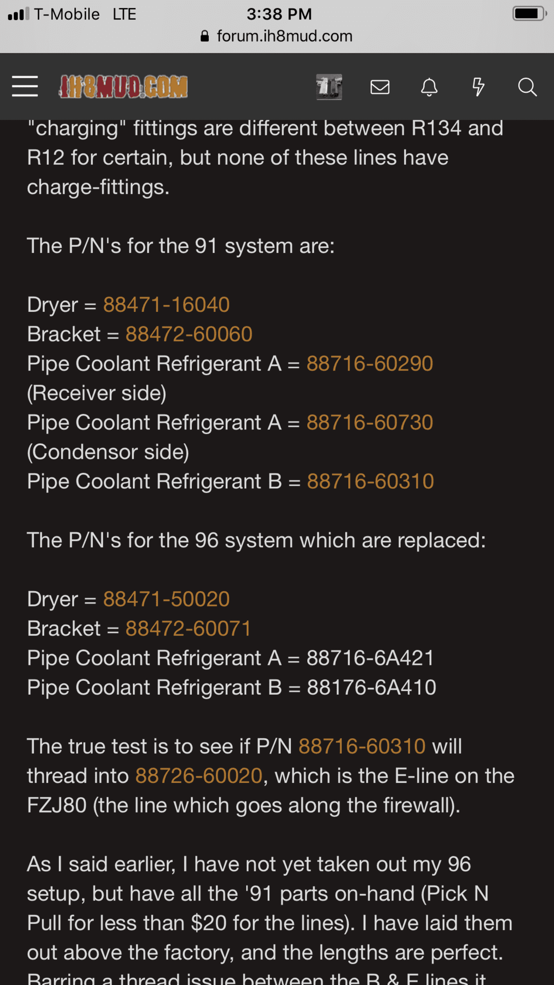

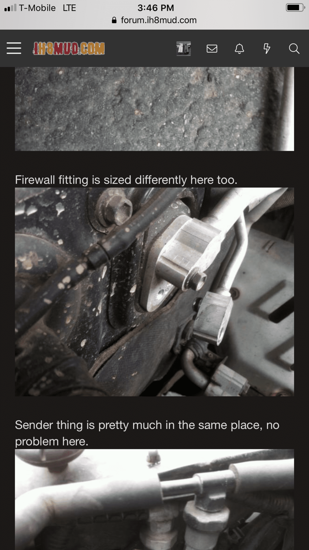

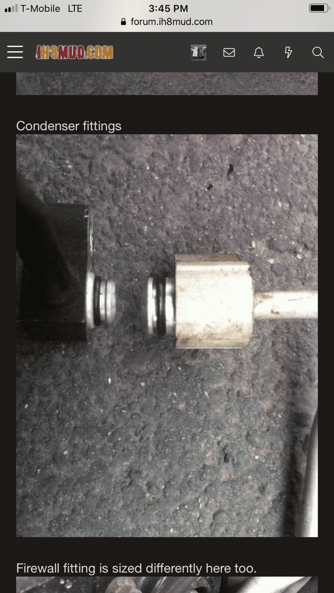

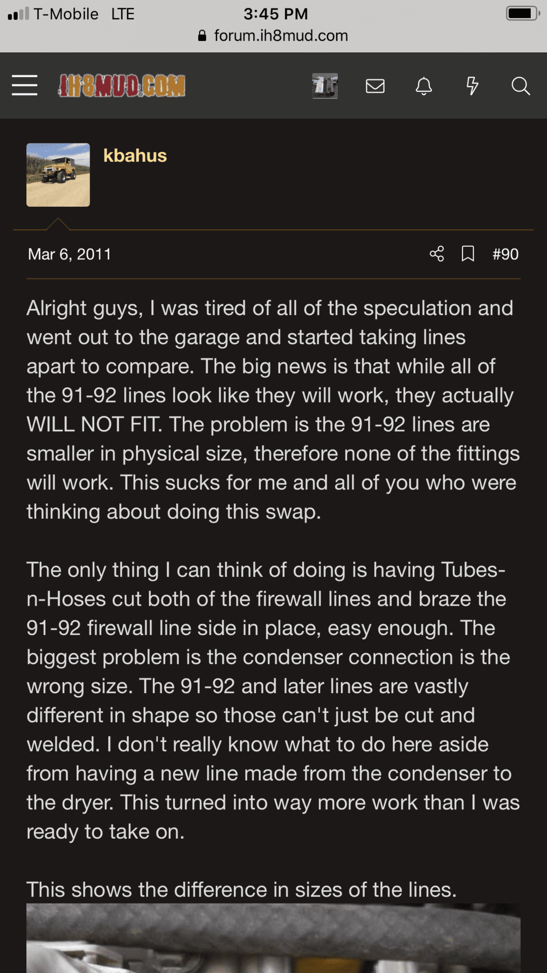

Do you know if the pad fittings on the A/C condenser are the same for input vs. output? If they are the same, the #8 O-ring adapter fitting Joey is making should work. The A/C drier is a different story.
However, can’t you just source the high-mount drier lines used from an early 80?
They are not compatible. Early=R12, late=R134. They are different by design, so you can’t put in wrong, or mix, refrigerant.
What is not compatible? The “Early” style A/C drier is not compatible with R134?
The refrigerant line couplings.
I can’t take the lines & just interchange them, per CDan.
Which refrigerant line couplings was CDan referring to? All of them? Or just the ones on the A/C compressor? Did he say why?
The reason I ask is, R134 and R12 charge port couplings are different (the couplings on the A/C compressor).
But I’m not sure all of the fittings are exclusively different between R12 and R134. They’re just pad mounts with an O-ring seal. I’m not saying they’re not different, I would just get clarification on which fittings exactly are not compatible between R12 and R134.
