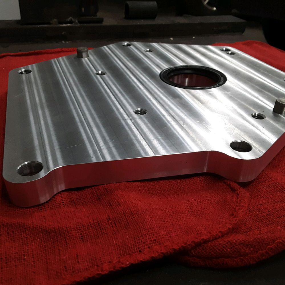

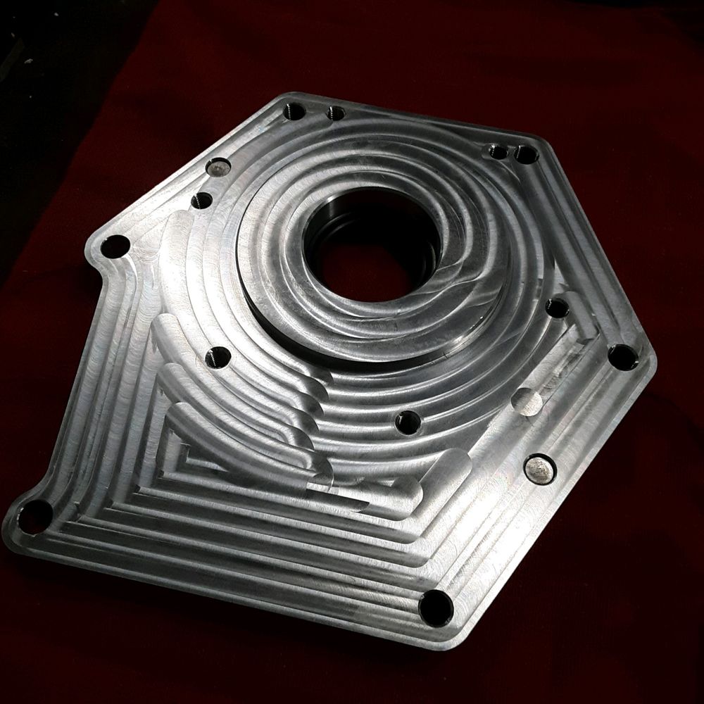

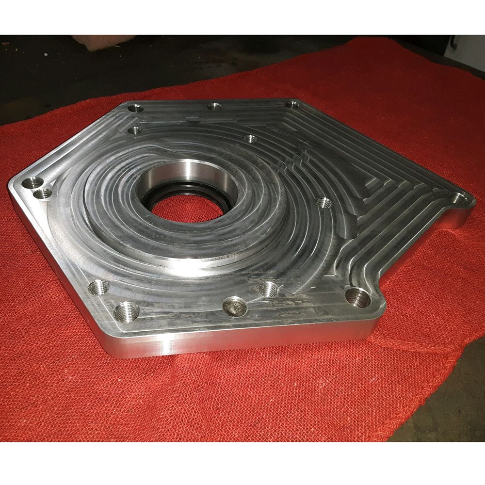

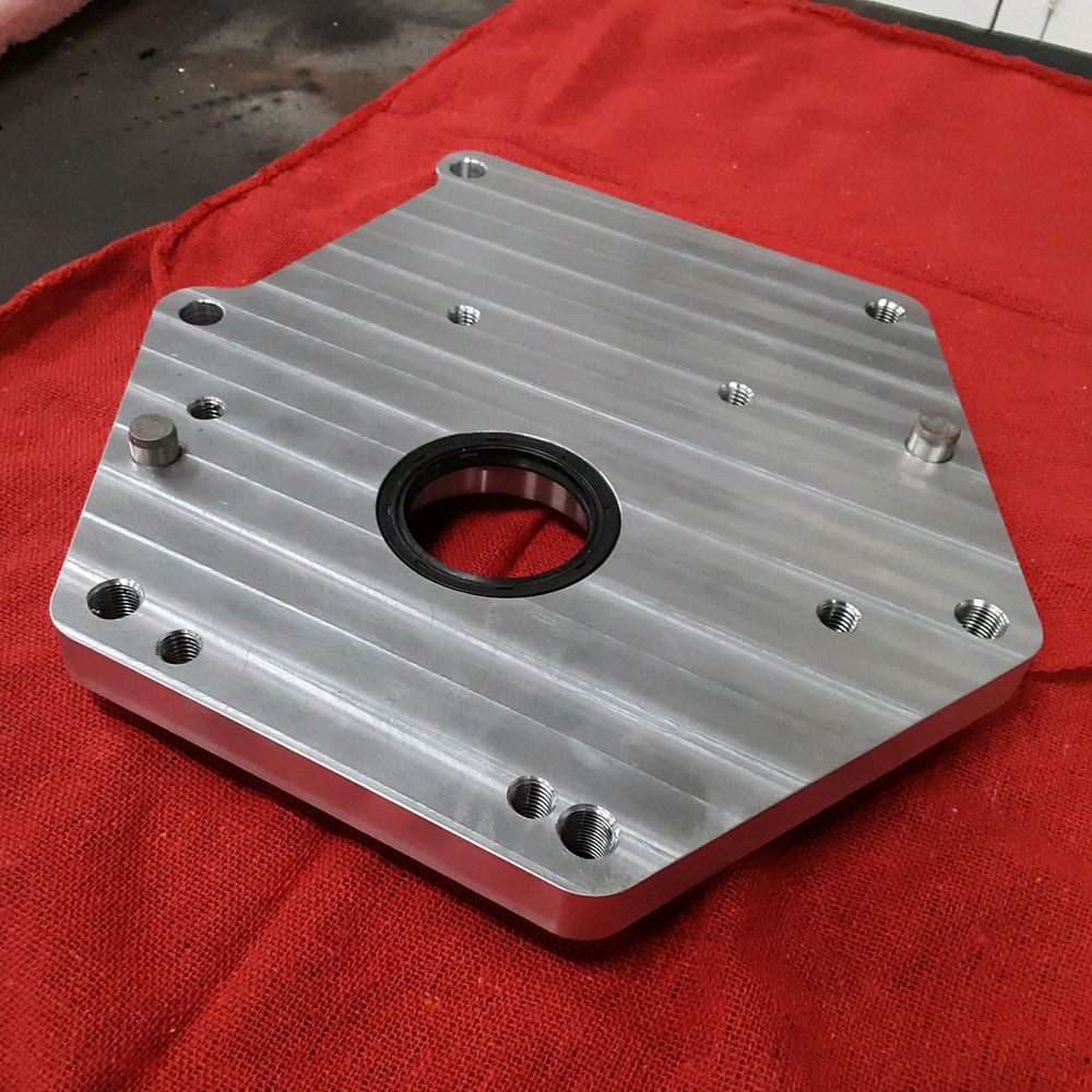

I was contacted by a buddy who was one of the guys that was burned by "that diesel guy" and asked if I could make some stuff to make his dream a reality. As it turned out I actually had a free machine and I was still waiting on the very last pieces of the turbo build to come in, so why not?
I will be supplying the basics to start. This would include the adapter plate, modified input shaft and oil seal. This is for those that are mating the NV4500 transmission to the 80 Series' HF2A transfer case. The plates are machined and heading to anodize (I still need to decide on the color). There are other components that I will be working on as well such as an airbox that could pull double duty for the turbo folks as well if so inclined. Time will tell.
No pricing, link or release date just yet since I don't have all the info yet to detail those but it will be coming soon.
View attachment 1922616View attachment 1922617View attachment 1922618View attachment 1922619
Will this kit keep the 80 series full time 4 wheel drive?
Yes, the full time 4 wheel drive function will remain.
The kit mates the OEM Toyota transfer case to the NV4500 transmission. The "full time 4 wheel drive" function of your truck is located in the transfer case. So unless you have opened your t-case and installed a 2WD spool, the truck will function the same as far as the 4WD system is concerned.
Awesome, thank you!
