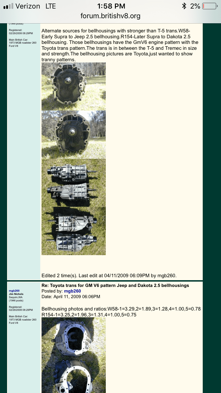

Could someone with better access to transmissions in a 80 series have a look at this. I have done a bunch of research and it appears that a Jeep Cherokee bell housing should bolt to a land cruiser trans thus giving us access to cheap engine adapters.
1923876
Could someone with better access to transmissions in a 80 series have a look at this. I have done a bunch of research and it appears that a Jeep Cherokee bell housing should bolt to a land cruiser trans thus giving us access to cheap engine adapters. View attachment 1923876
Five speed manual in the older pickups and 4Runners can be hybridized with the AX15. Not really useful for LC’s.
