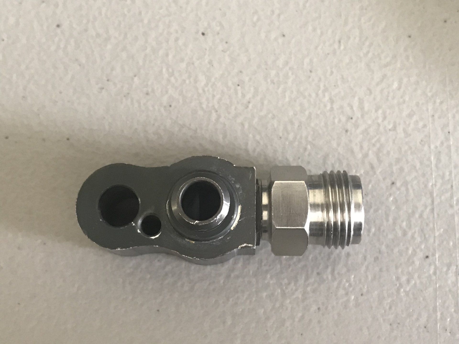

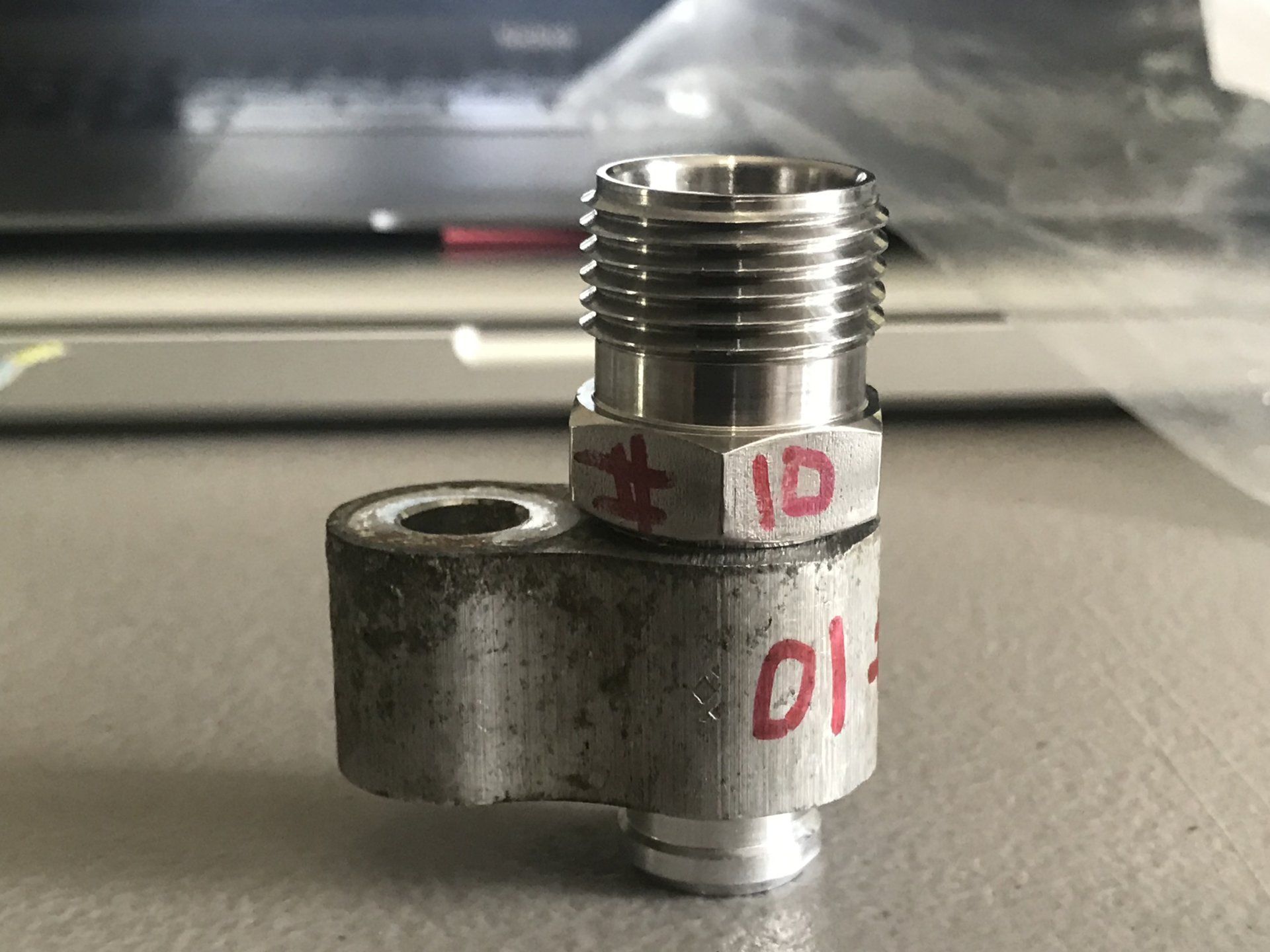

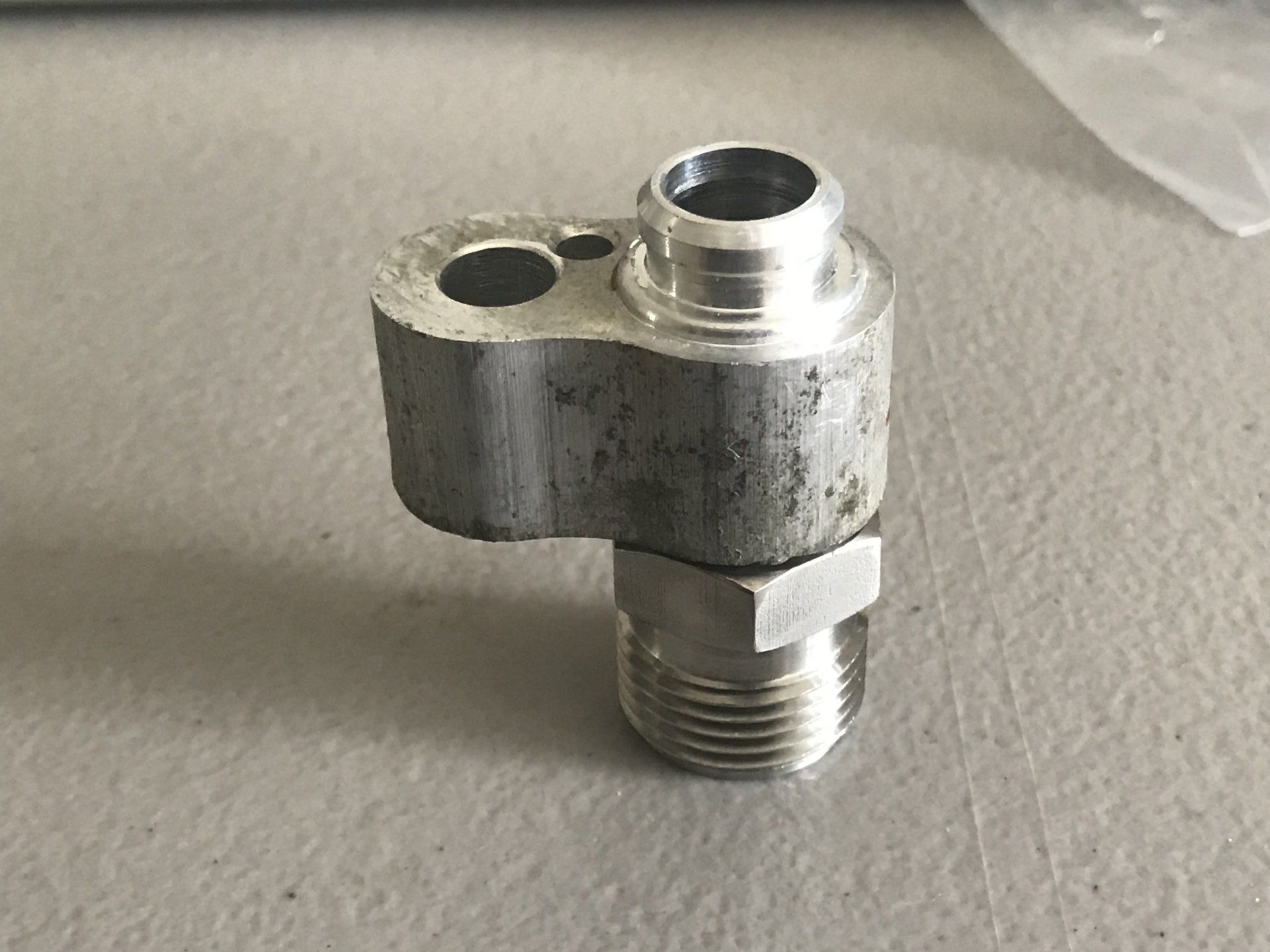

Figured I would post up something I wasn’t planning to work on but @Will Van sent me a PM and it seemed like something that could be useful and a little challenging.
For those that need to figure out the AC lines of converting the Dodge o-ring style #8 and #10 threaded ends to Toyota’s Denso ends, a solution is being worked on now. These two photos show what the ends result of the fittings will ultimately be.

Just for clarification, a lot of of domestic A/C compressors use #8 and #10 o-ring fittings. But if you’re keeping the stock Dodge A/C compressor, you’ll need a pad adapter to go from the Dodge A/C compressor pad to o-ring fittings. These are readily available and fairly common. They also work on some GM (LS swap) compressors.
The main advantage of the adapters Joey is fabricating, is it gets you from Toyota style pad fittings to o-ring fittings. Once you can plumb from o-ring fittings, the possibilities are endless with aftermarket A/C options.

Adapter kit looks great by the way, nice job @NLXTACY.
