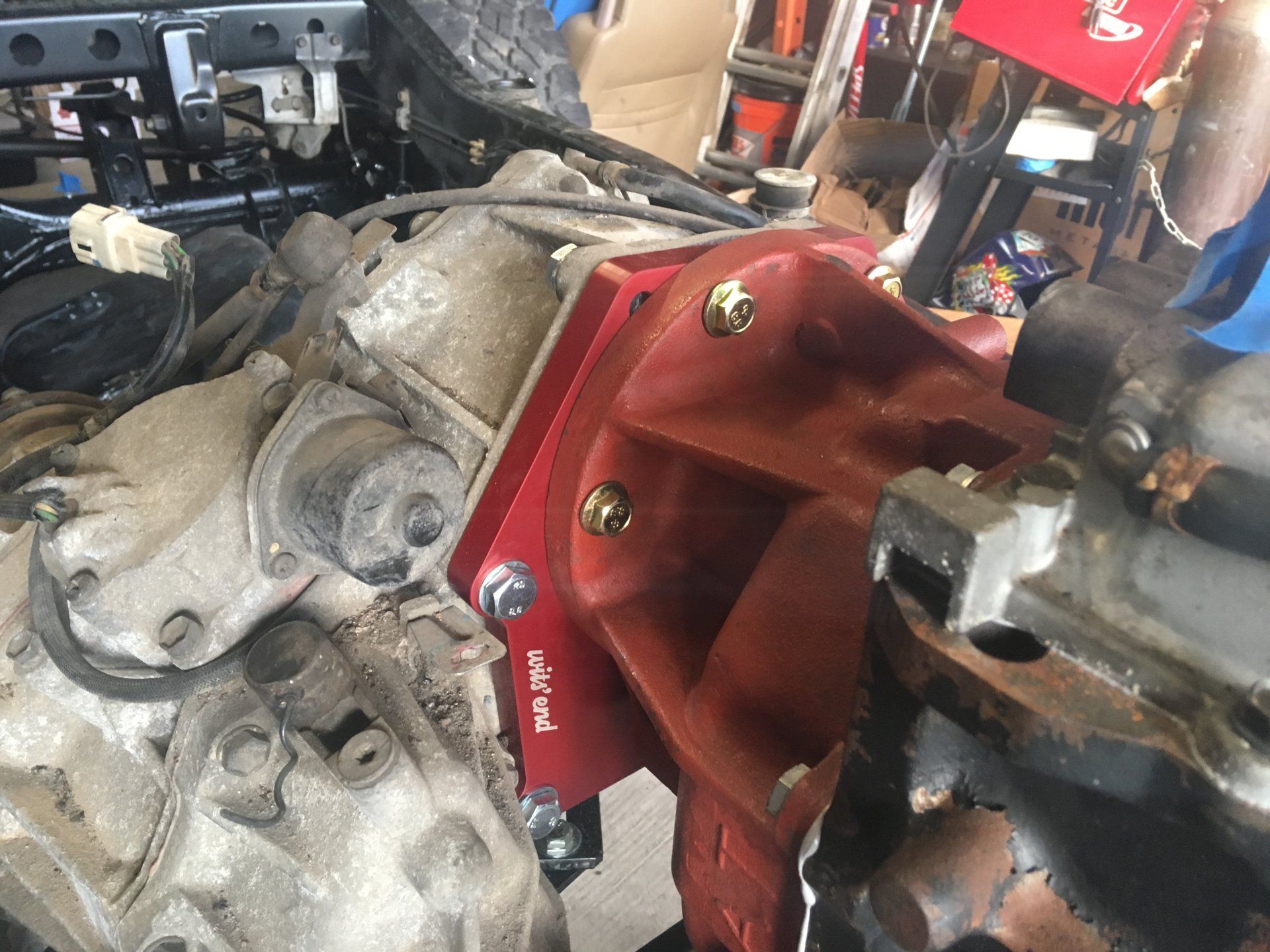

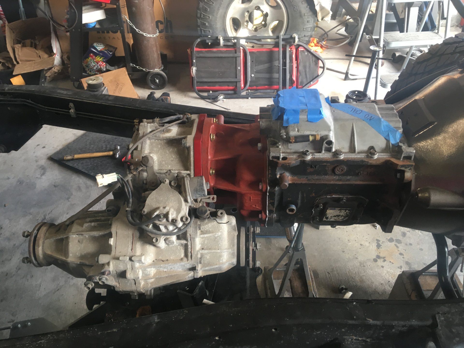

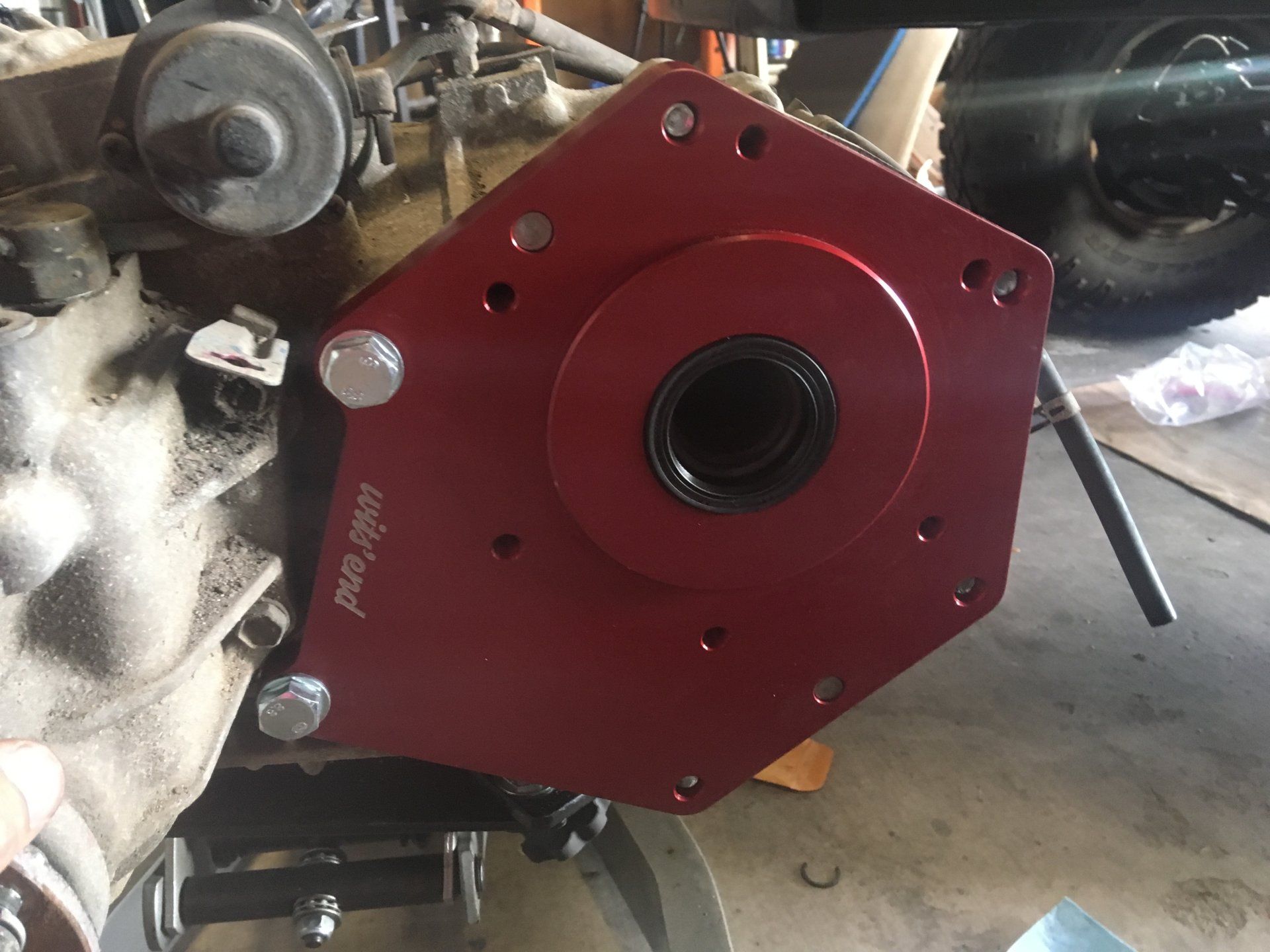

Everything went on like it should. Only thing I would change on the next batch would be adding the Wits End logo on the side for people who crawl under to check out the sweet drivetrain.

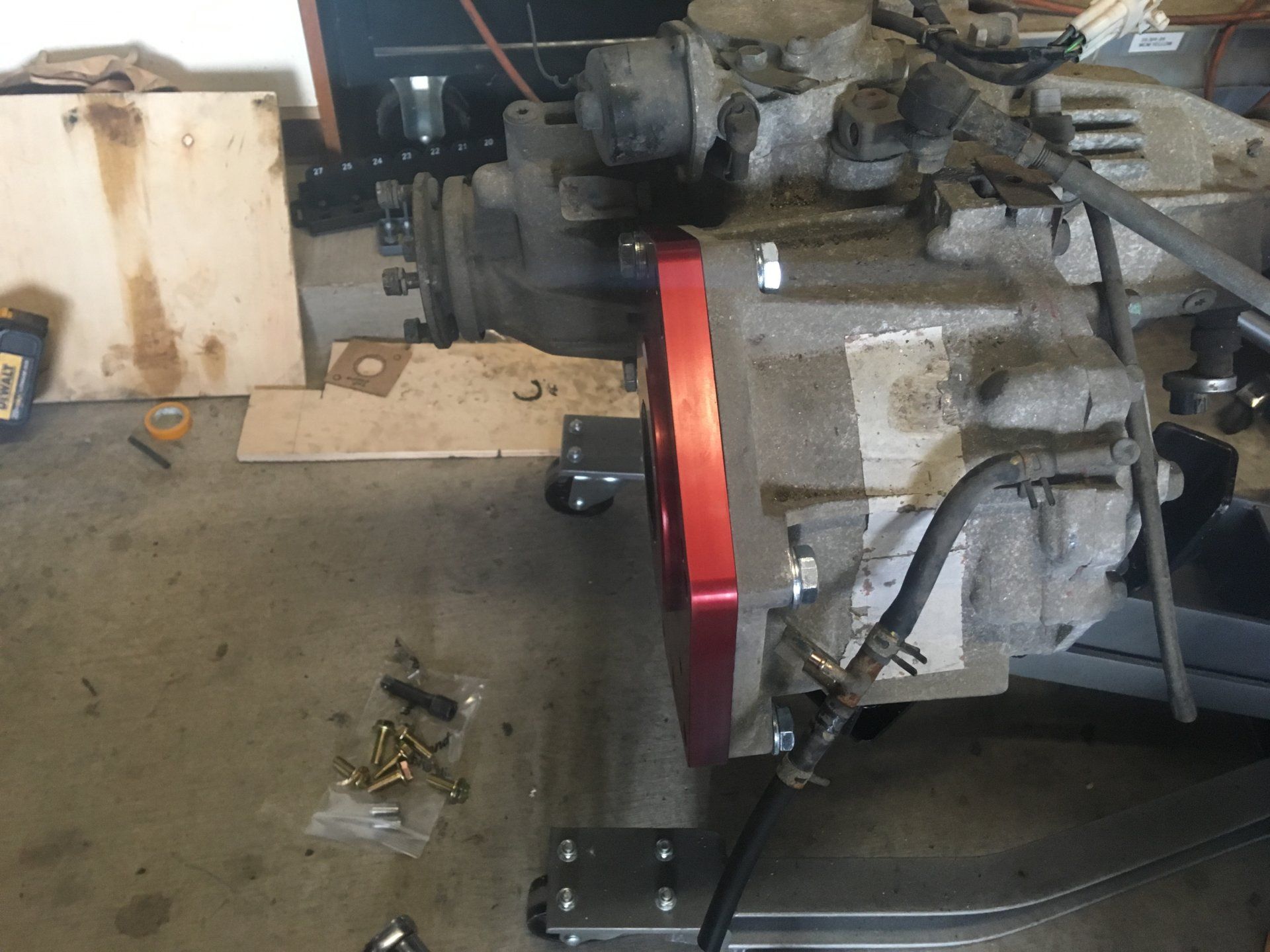

The trans jack helped a lot lining up the holes. Once the shaft was in I slowly lowered the jack and the TC spun on its own which helped line up the holes. It also helped that I had no body over it.
No issue with alignment or hardware? Anything missing from the kit that you can think of?
The alignment was perfect. I hand tighten them all the way in.

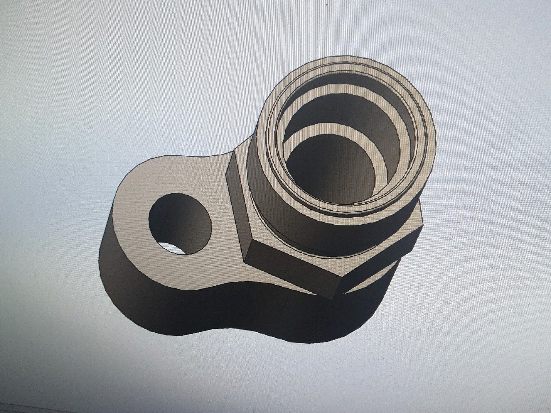

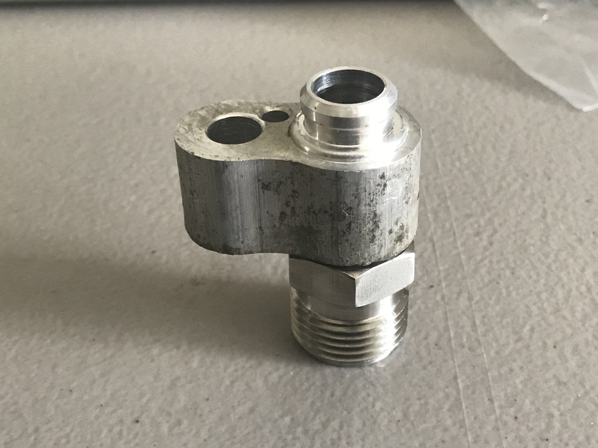

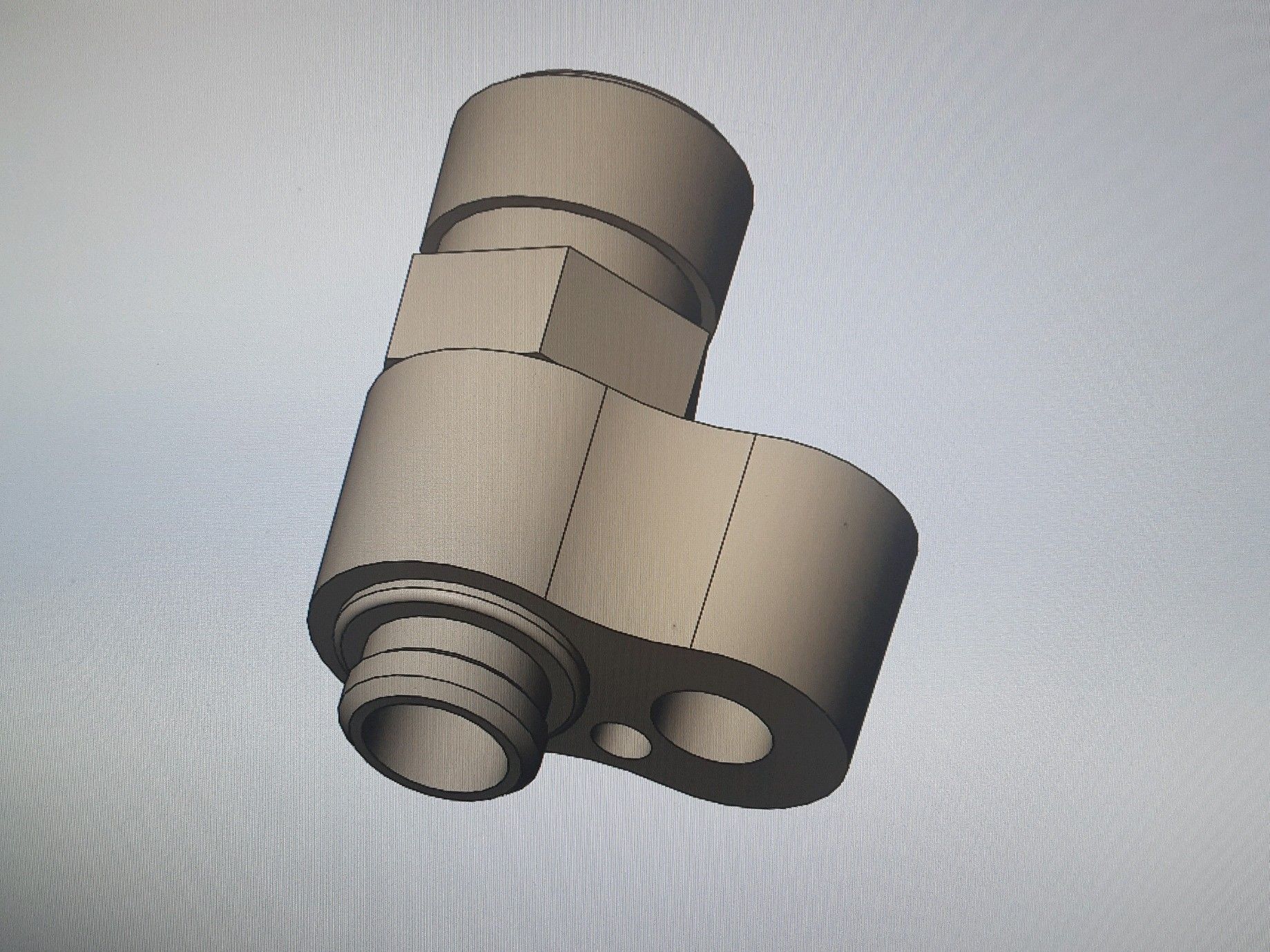

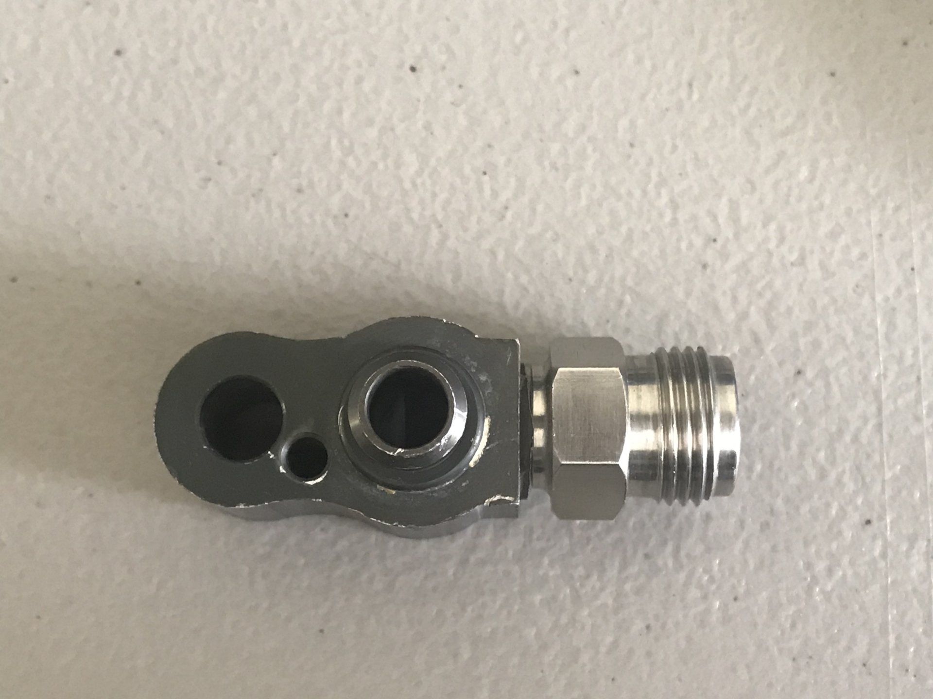

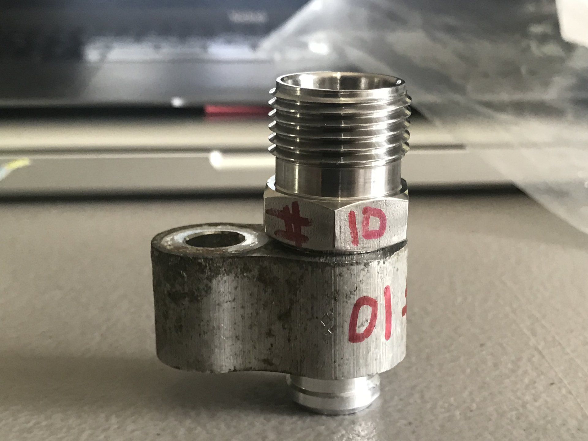

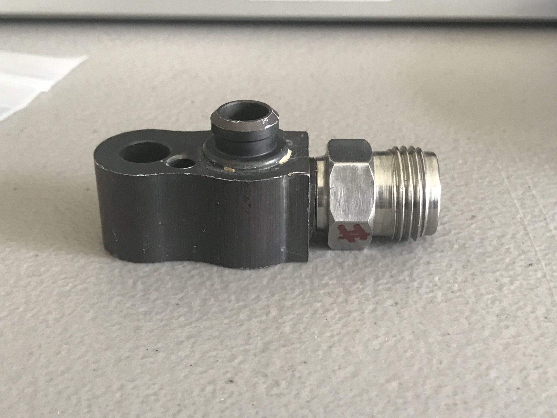

Figured I would post up something I wasn’t planning to work on but @Will Van sent me a PM and it seemed like something that could be useful and a little challenging.
For those that need to figure out the AC lines of converting the Dodge o-ring style #8 and #10 threaded ends to Toyota’s Denso ends, a solution is being worked on now. These two photos show what the ends result of the fittings will ultimately be.
