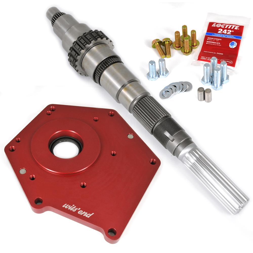

Question: is the GM/SBC NV4500 the same thing as the cummins NV4500? So could this adapter assist with a 5-speed V-8 swap as well? I'm pretty sure I knew the answer to this question back in my 60 days... 🤔
It is basically the same transmission. The GM and Dodge have different bell-housings and tail housings, and differently sized input and output shafts. But in theory, yes, you could use this adapter plate for a GM swap. You would need a GM bellhousing and input shaft, with a Dodge 4WD tailhousing, and the Wits' End machined 2WD output shaft to work with the Toyota transfer case. That shouldn't be that big of a deal since you have to rebuild the NV4500 anyway to install the Wits' End output shaft.
Hope this helps.
Wasnt the Dodge the one that had synchros on first gear, at least for a few of the earlier years?
All forward drive gears were fully synchronized on both Dodge and GM. The early Dodge NV4500s offered synchronized reverse.
Early GM models also had a lower 6.34 first gear. The GM input shaft from a 6.34:1 early transmission will not fit the Dodge transmissions.

Here you go folks. I have a couple things to still gather but otherwise everything will be ready to go by next week. Just threw it up on the site and I am now INCLUDING all of the necessary hardware and some Loctite ;)

The 6BT/NV4500 in the video also has an Advance Adapters output housing on the NV4500, not a Dodge 4WD extension housing (which is the housing you would use for the Wits' End kit). But the dimensions of the transmissions are similar as well.
