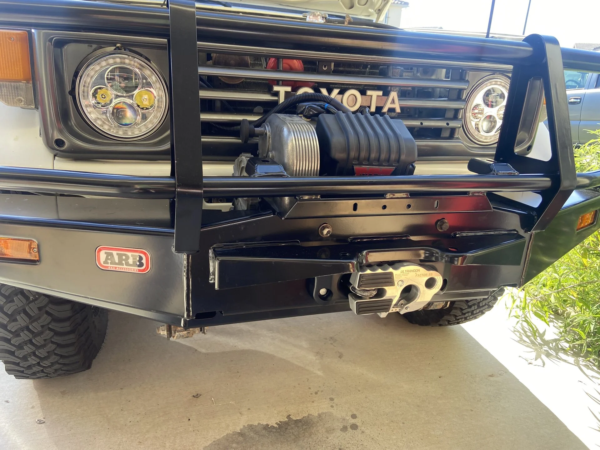

Warn 8274 - there is no substitution.
vividracing stated on their website:
  • Warn Winch M12000, xD9000, M8274, M8000
Does anyone know if these are the only Warn winch models that are compatible?
Does it fit on the deluxe? It used to be the 8274 wouldn’t fit on the deluxe and only the commercial, but it’s possible that’s not the case anymore
Certainly fits on mine. You'll need an offset fairlead though if you run synthetic.
I agree, 8274 for the win.👍🎯👍
Can anyone knowledge me what makes 8274 so good,, aside from its old-school design?
Super fast, pulls well beyond it's advertised limit (especially with the upgraded motor), carries a TON of cable/rope, and makes that sweet sweet clicking sound when spooling
