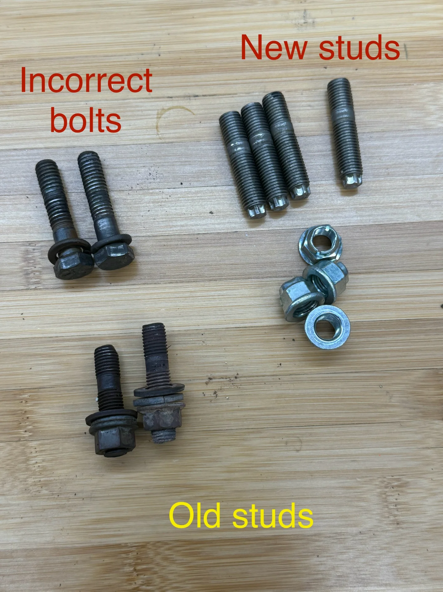

But I have a problem. The connection from Y pipe to exhaust manifold is supposed to be with double threaded studs into the exhaust manifold flanges, and then nuts holding the Y pipe on.
On my truck someone used incorrectly sized bolts into the front two flange holes instead of the studs, and stripped the holes. They used nuts on the top side to hold them in.
So I can thread in the new studs for the back flange, but on the front flange I need another solution. The old (incorrect bolts) were not even the right thread pitch, so they stripped the inside threads of the exhaust flange completely. The new studs won’t thread in.
I’m afraid there isn’t enough metal there now to even retap them to the correct size. They seem to have been widened. So I might have to go up a size.

Absolutely worst case you run a bolt and nut combo
Or buy new manifolds.

What about drilling it out and stabbing in a rib nut
Hadn't thought of that. Would it hold up to the heat? That's a great idea... I've never used them before. I assume I need a special tool to set them.
I did a little research on the rivnuts. They won't hold up to the expansion and contraction heat of the exhaust manifold. I would need something more secure like a helicoil.
I think I'll just pick up a replacement manifold from my local yard. It's only $50 and then I'll have peace of mind about it and HOPEFULLY it will solve the smell issue I've been having in the cab too.

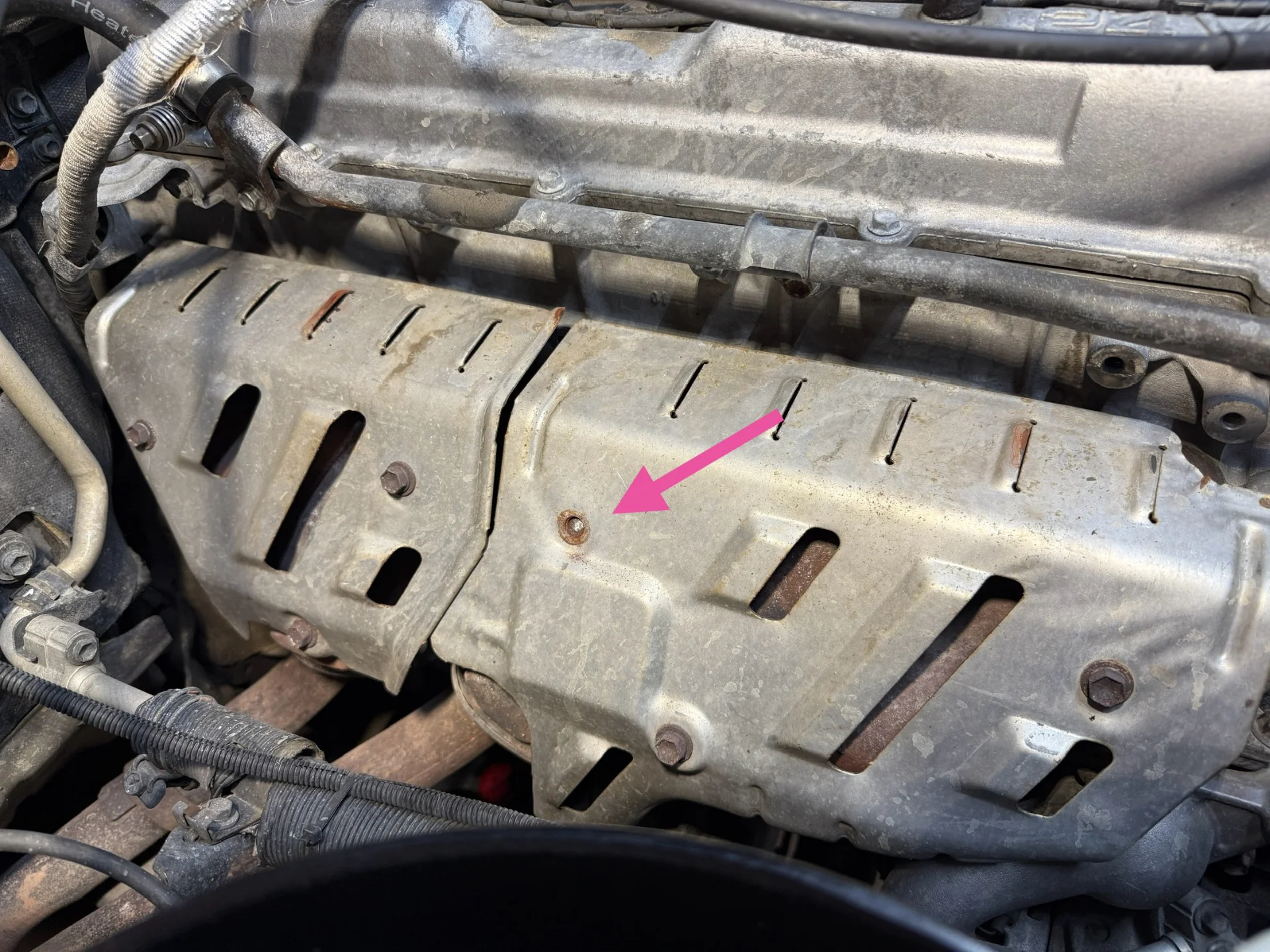

I decided to pull these exhaust heat shields off so I could more easily remove the exhaust Y pipe and the very first bolt broke right off.
Does this mean they’re all going to break off?
What’s the solution here? Any tips? I don’t want to have to drill and tap all six of these…
OK 1. you don’t need to take the heat shields off to remove the stock exhaust Y pipe. You can get it out easily enough from below. I was able to squirt some PB blaster on the Y pipe studs from above (through the heat shield holes) and also from below and let it soak overnight and the studs came right off.
2. as for the heat shields, same thing. After breaking the first bolt like a dumbass, I soaked the other five with PB blaster multiple times over a 24 hour period. Basically, every time I walked past the land cruiser, I gave them another squirt. And just now I tried them and they all came right out no problem, almost no resistance. A little PB blaster, a little patience.

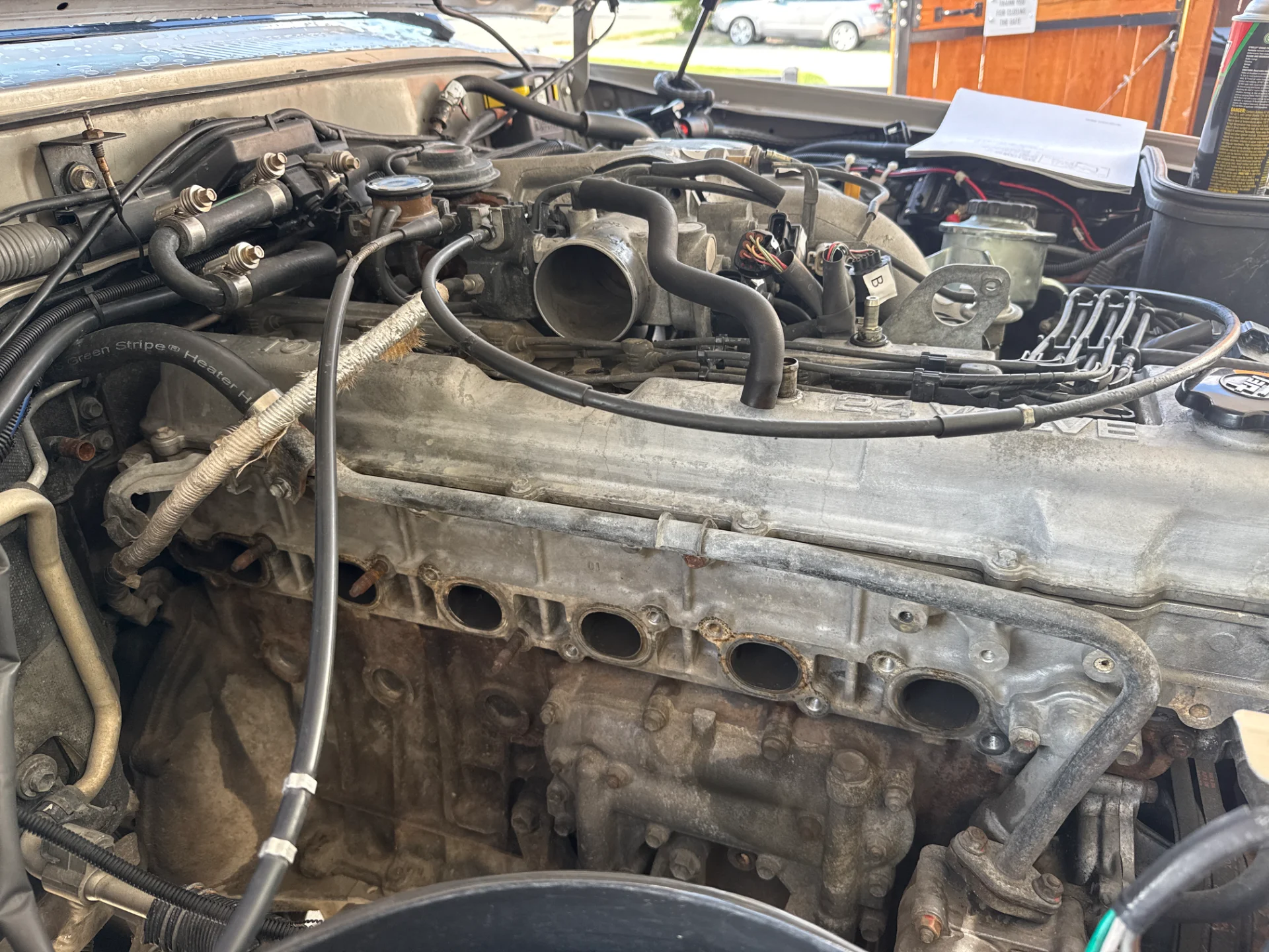

Coolant is drained.

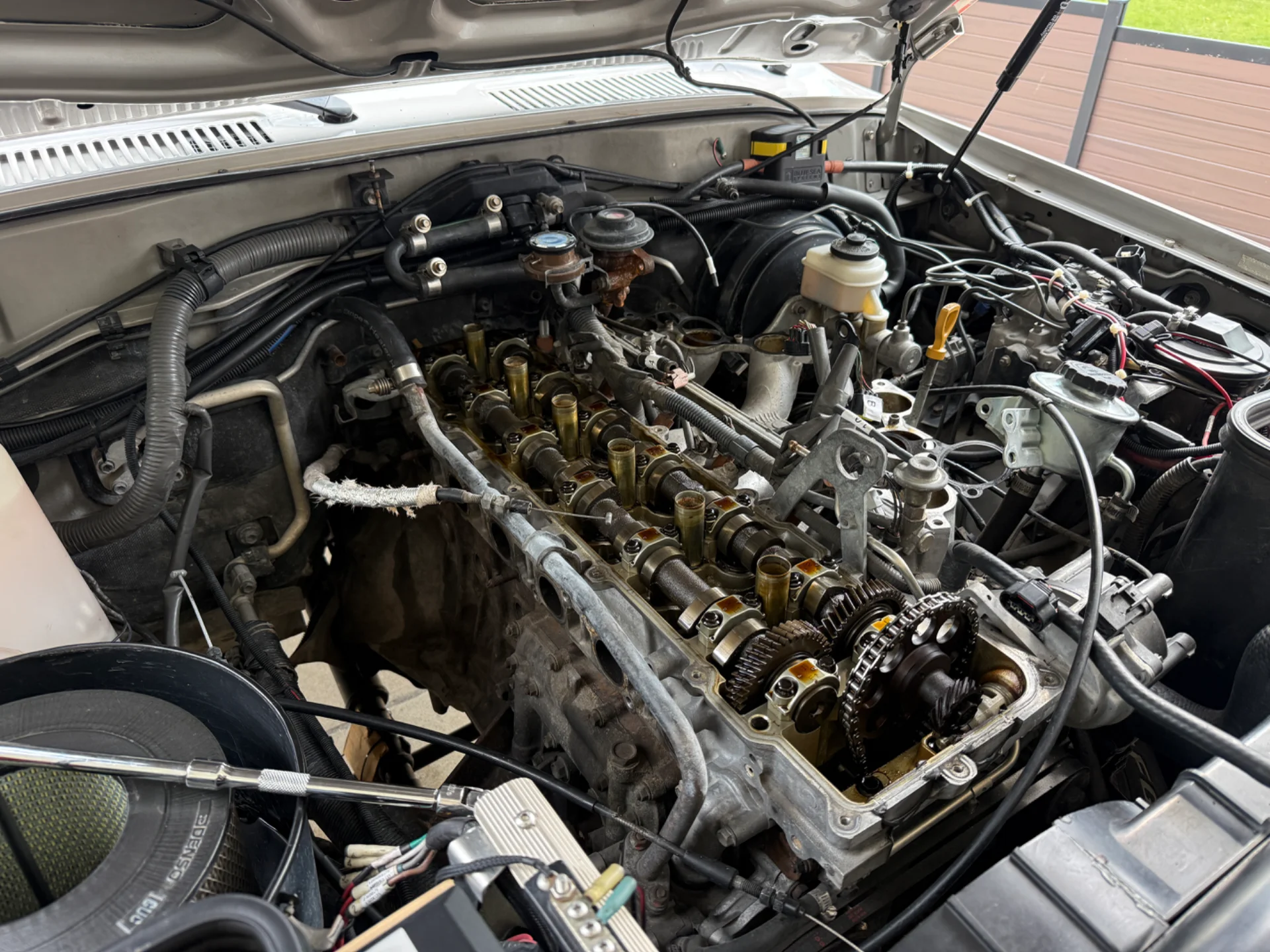

Intake manifold is off. Throttle body is off. Valve cover is off.

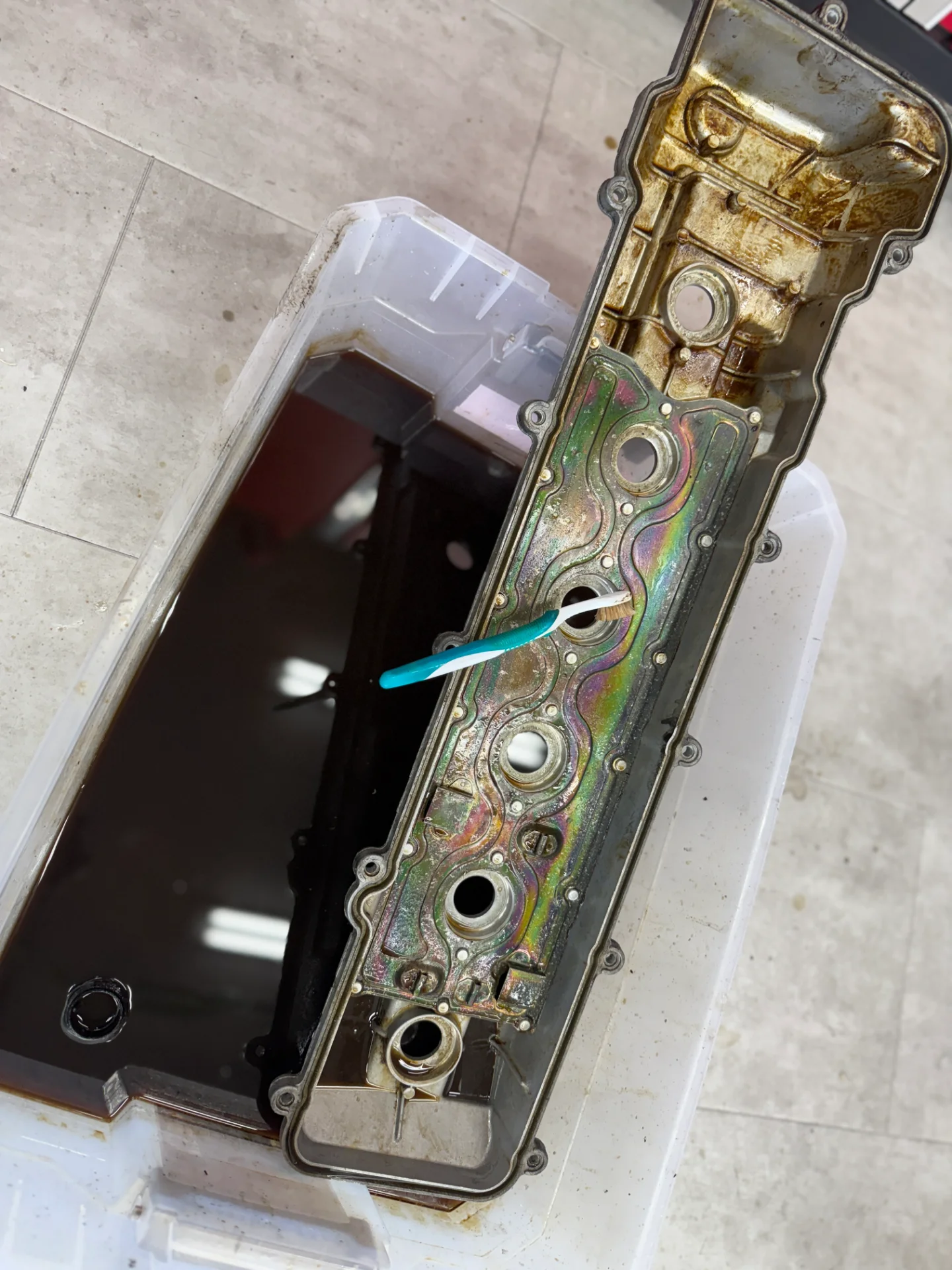

Did a little pre-cleaning and removed the gaskets. A short soak in the Super High-Tech Parts Cleaner got most of it.

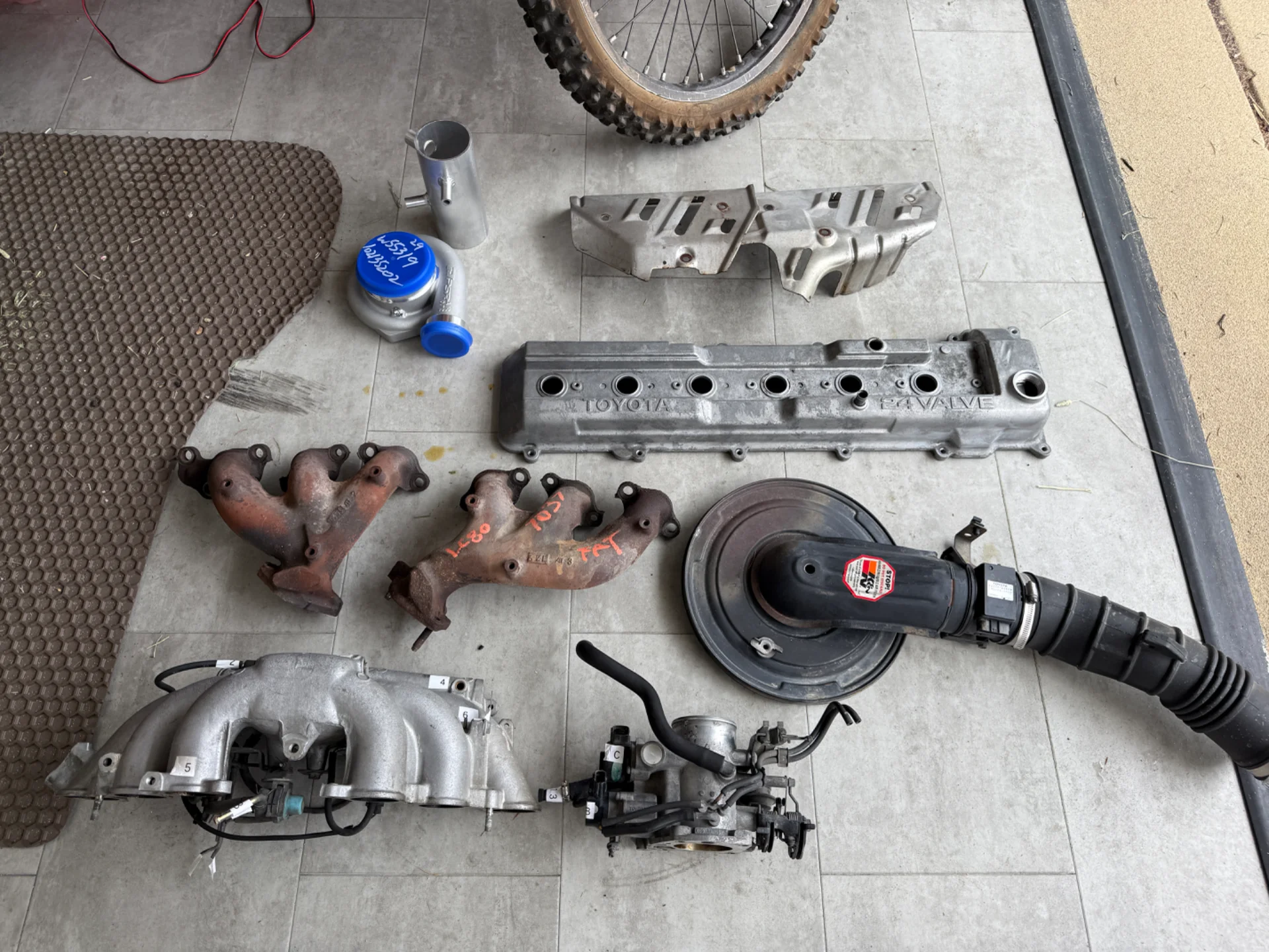

All the giblets are off and will go for coating Monday morning. Still have a little prep to do with the intake and throttle body.

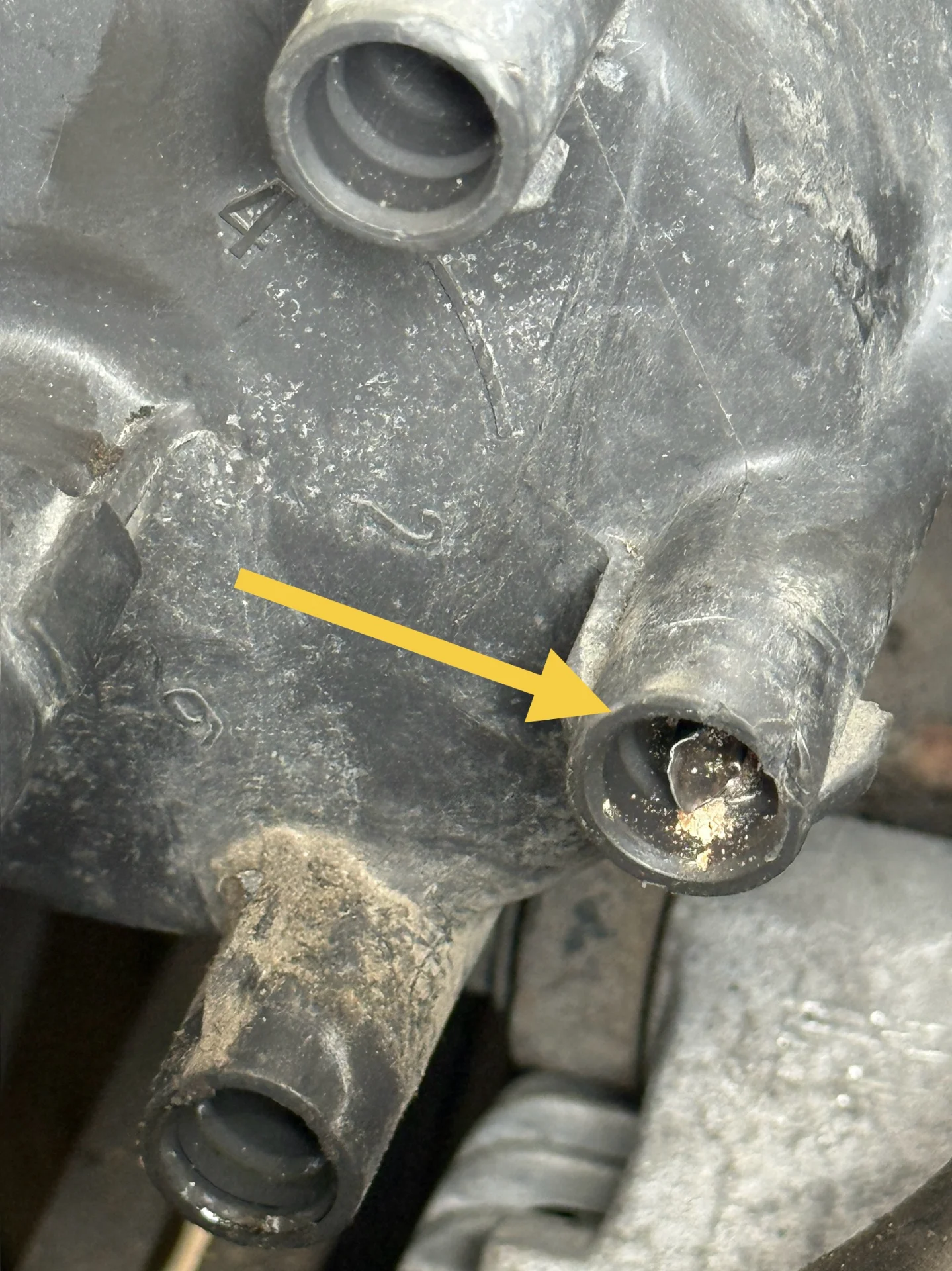

I need a new distributor. When removing the spark plug wires I noticed one of them had literally welded to the distributor socket. When I pulled it came apart.
Is there anything I should look at / inspect while I have the valve cover off?
Did a little pre-cleaning and removed the gaskets. Purple degreaser and elbow grease got most of it.
Prime time to change fuel filter and the pesky heater hose if you haven’t already. Could also check valve lash and see if everything is still in spec
Also distributor cap is all you’ll need which is chillin in a box waiting to go out the door
