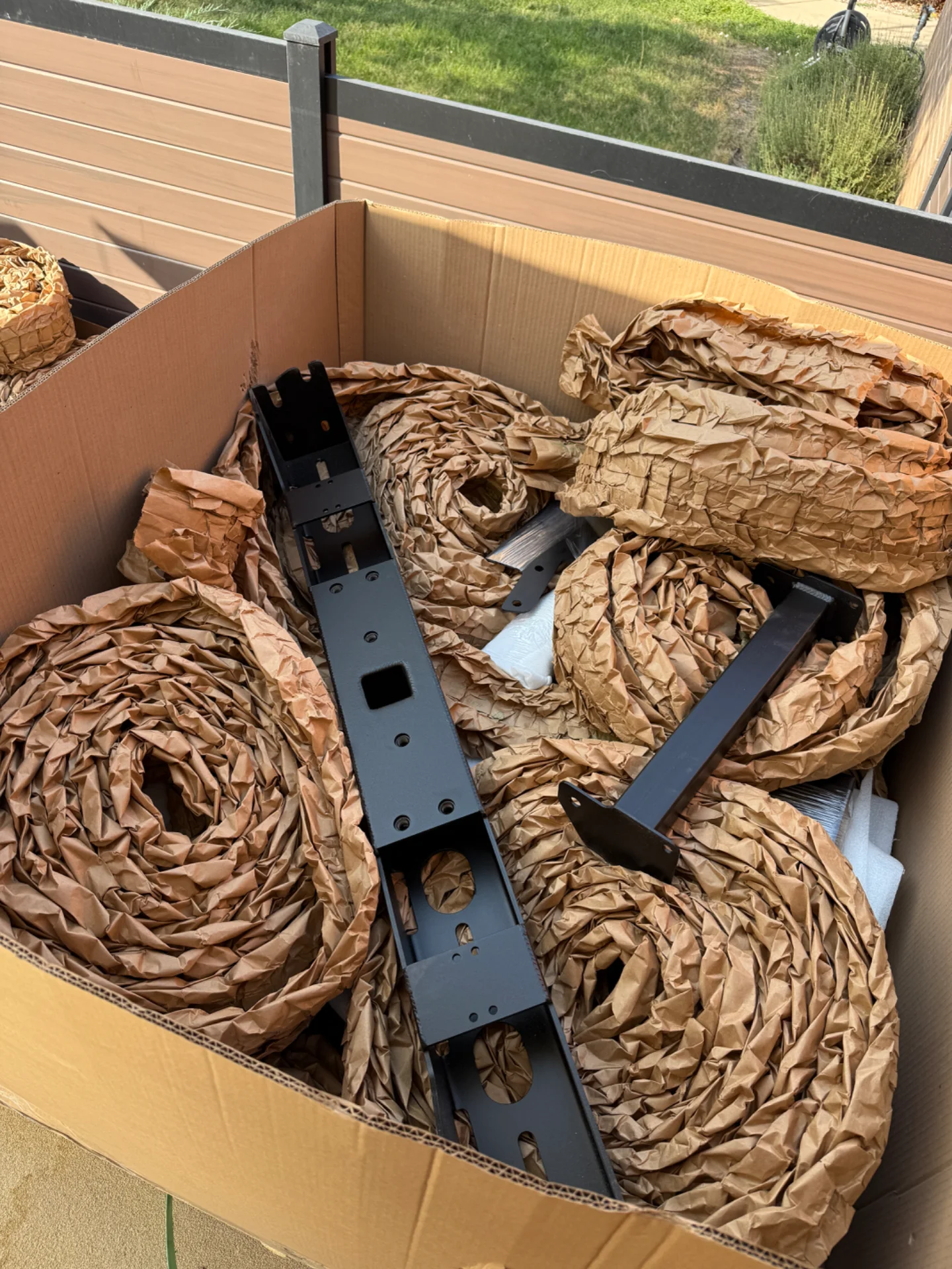

Anyway this new one is a Dissent Off Road bumper. It was about 8 weeks from order to delivery.
Great packaging by Dissent.
I got everything all setup and started grinding on my frame rails, touched up some bare metal with primer and paint…
Then while bolting on the very first piece I realized these frame rails have had about 3.5” cut off of them.
I don’t want to trust this bumper to hang by only 4 of the 8 bolts on the frame rails…
So I’m going to have to weld extensions on to these to get them to the right length.
