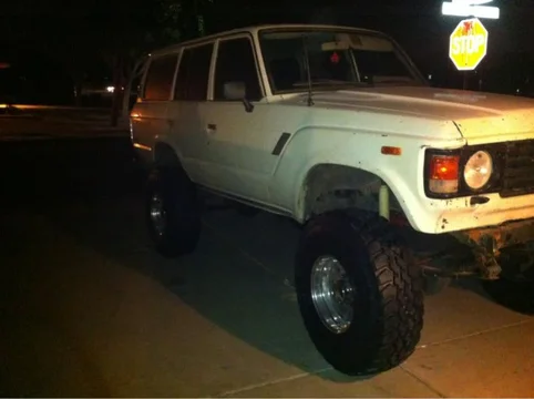

I just got new tires. Should I start another thread and call it, "Why every 60 should have 37's."
