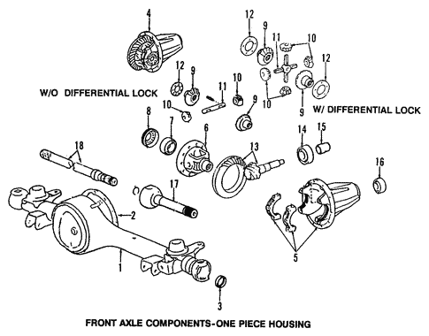

I’ve seen diagrams that show the non locker diffs are 2 pinion and the locked diffs have 4 pinions. But no one ever talks about that
Very interesting, one more reason to go with OEM lockers.
