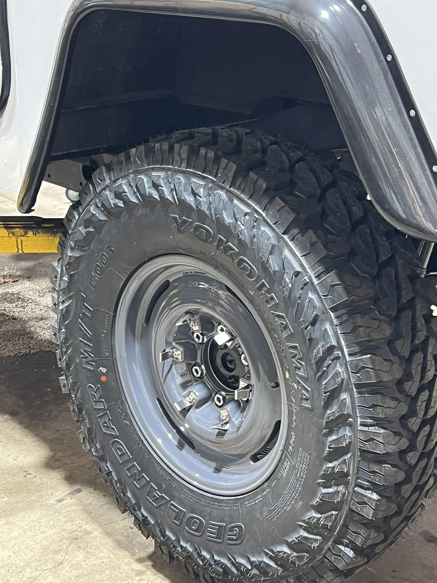

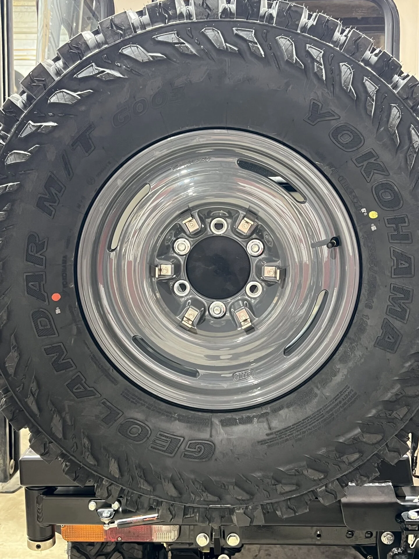

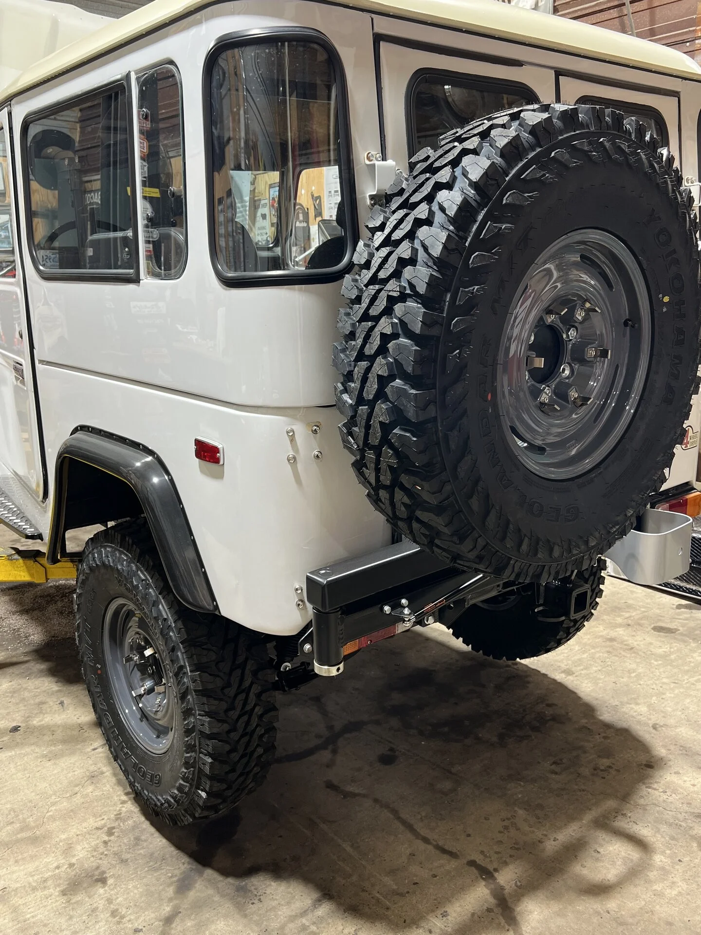

I picked up some bling today from 49Tire
255/85r-16 Yokos and FJCompany wheels.
Pimp city

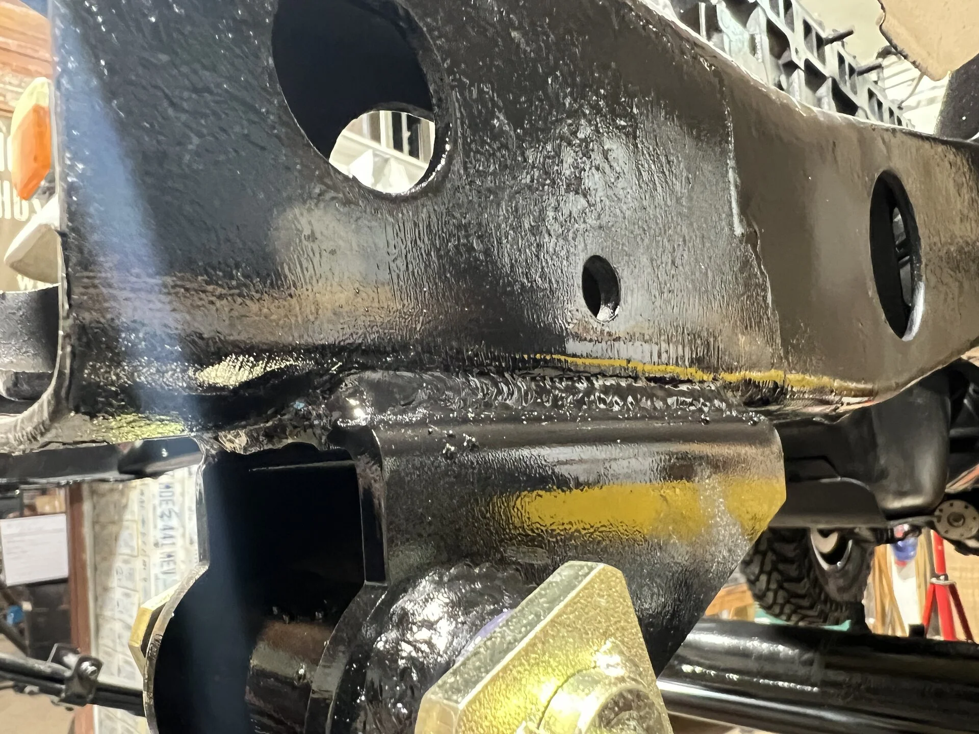

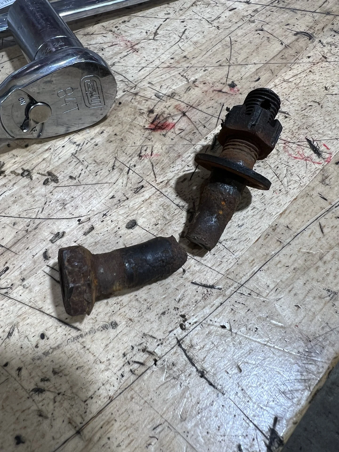

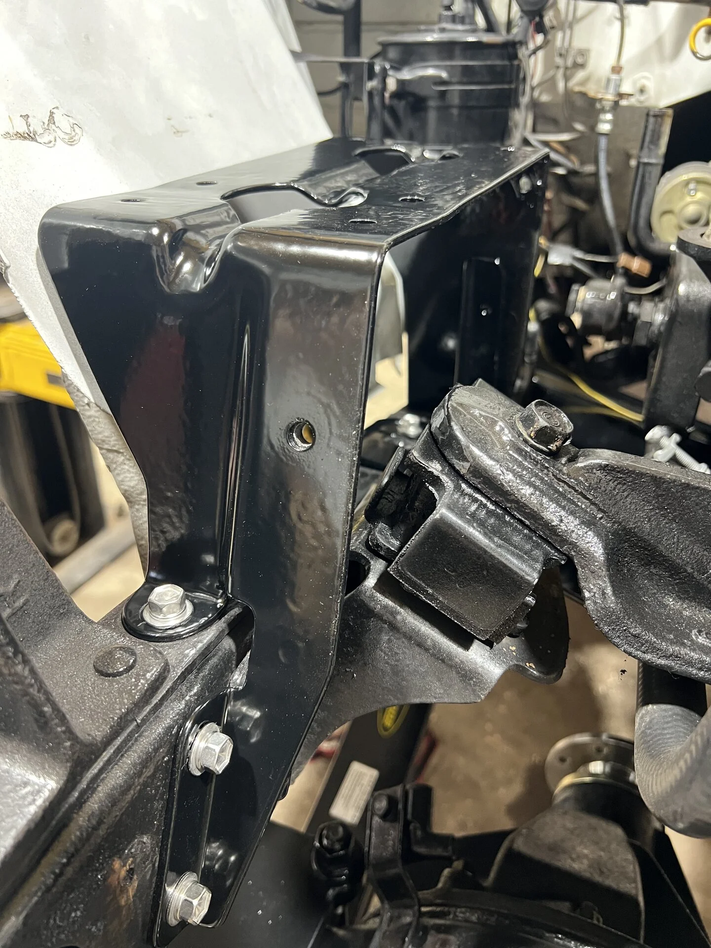

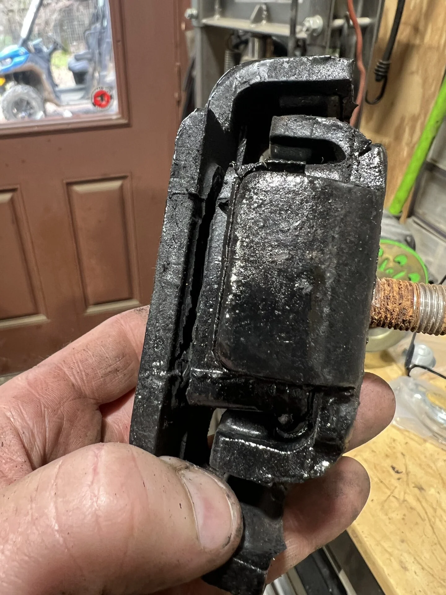

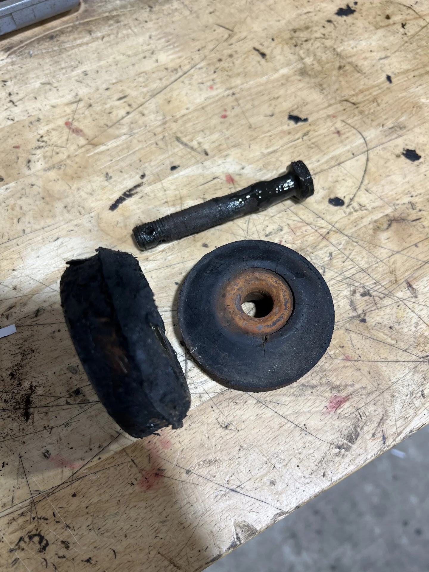

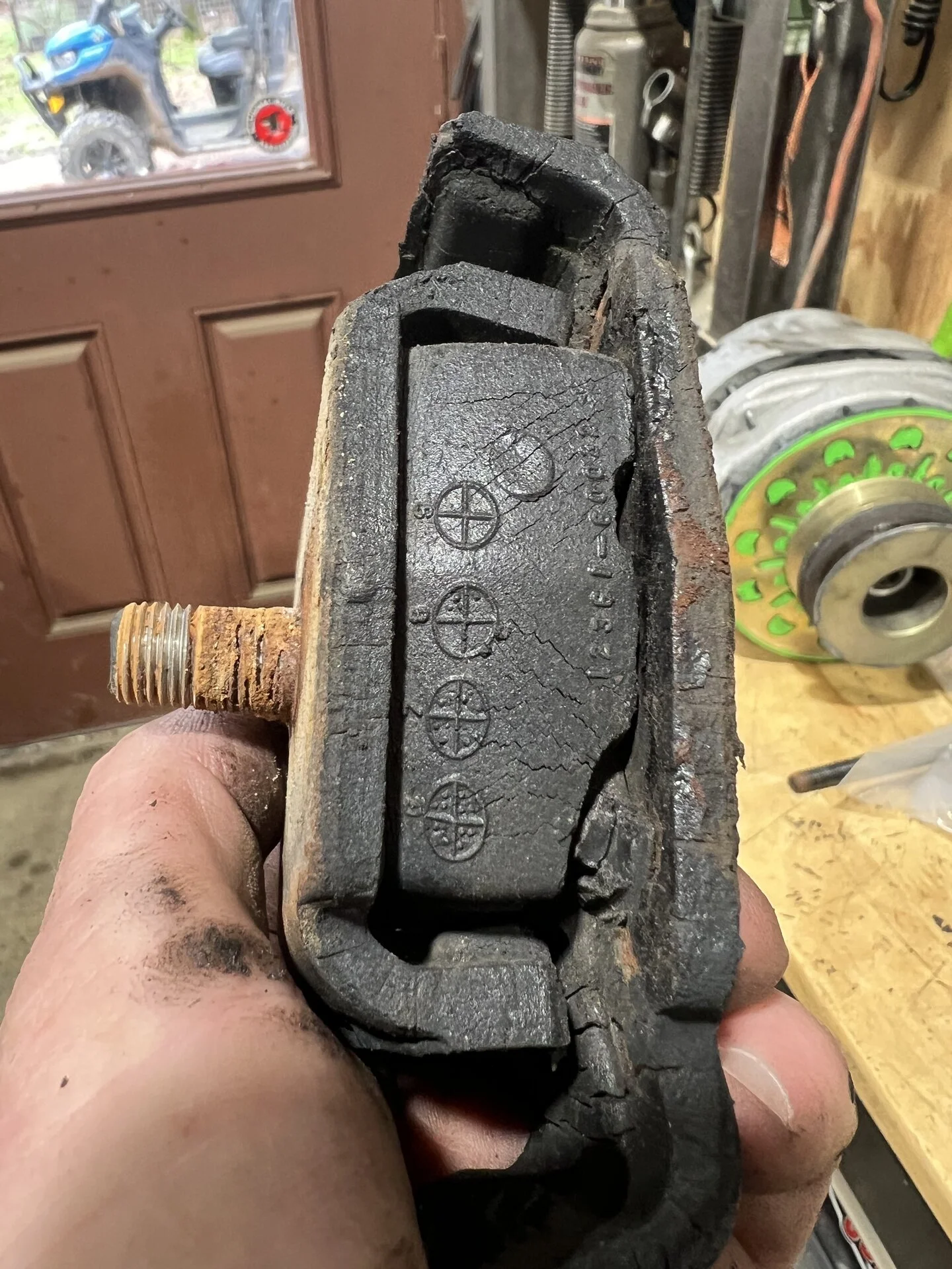

Motor mounts were split in the front which I’m sure led to the rear bolts being bent and nearly broken.
They are all replaced now.

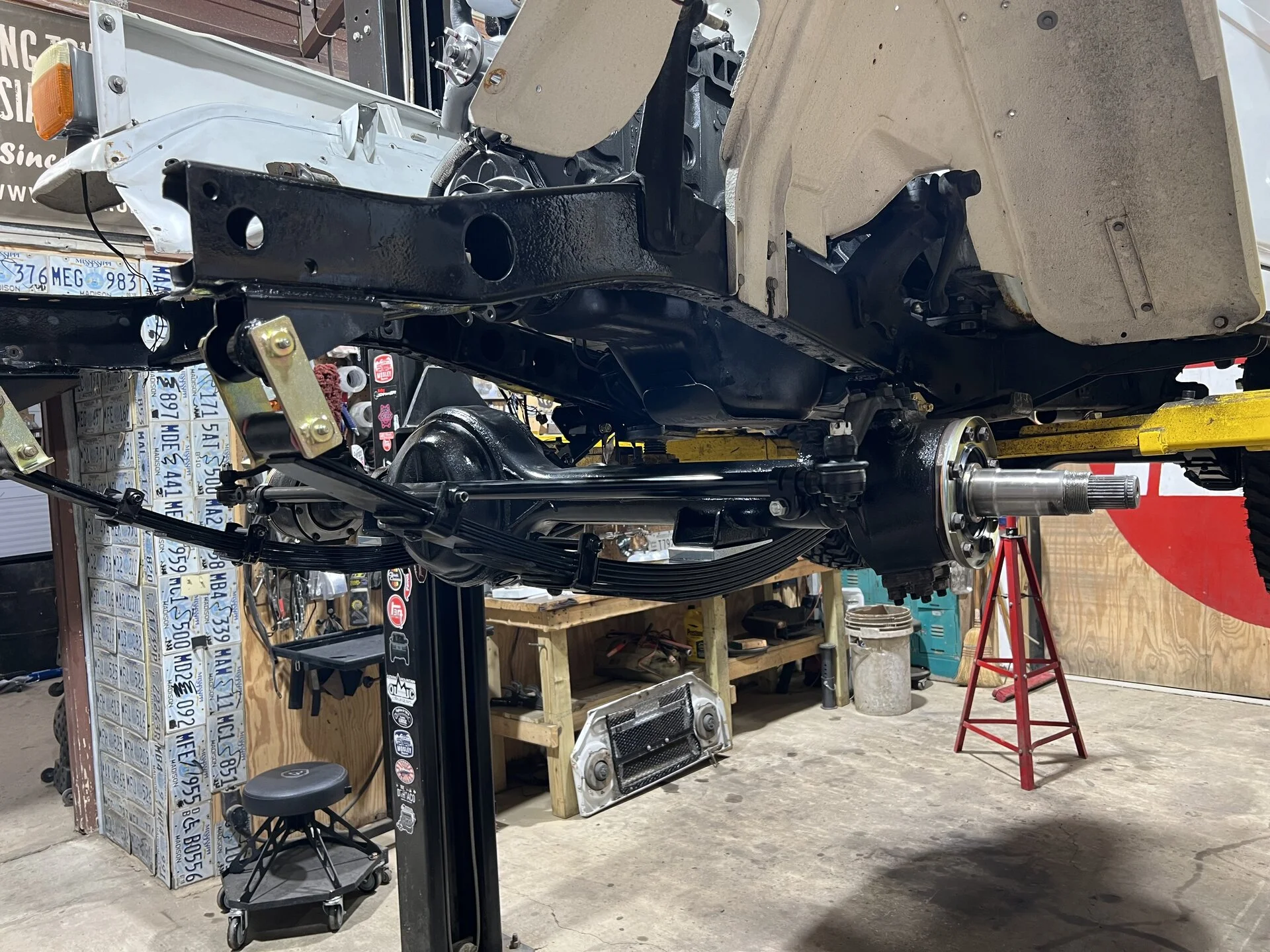

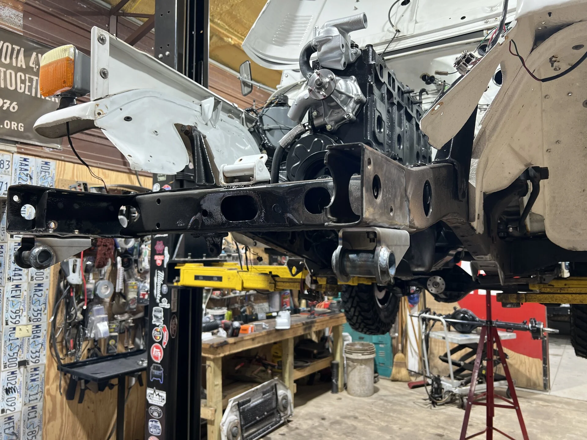

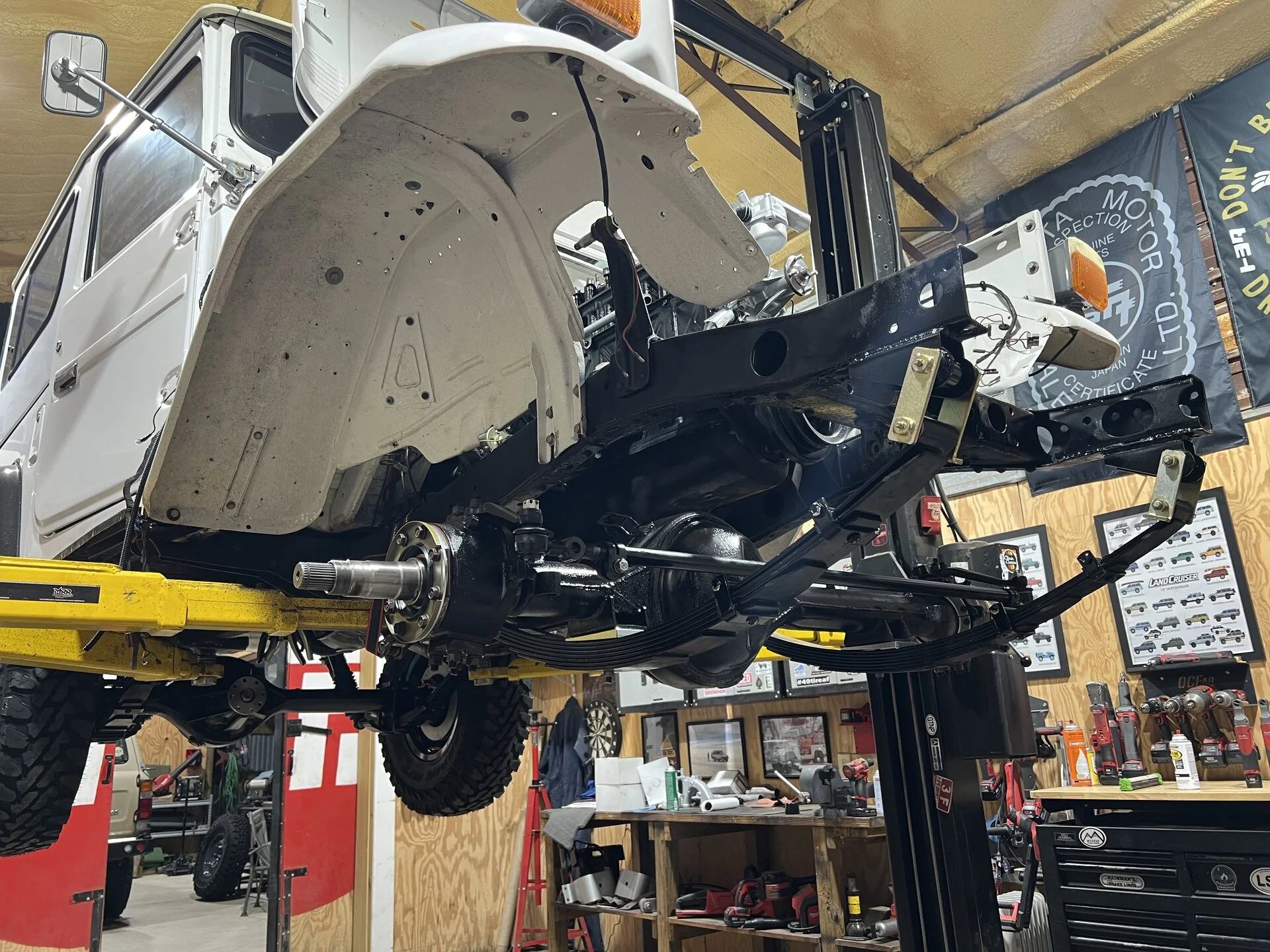

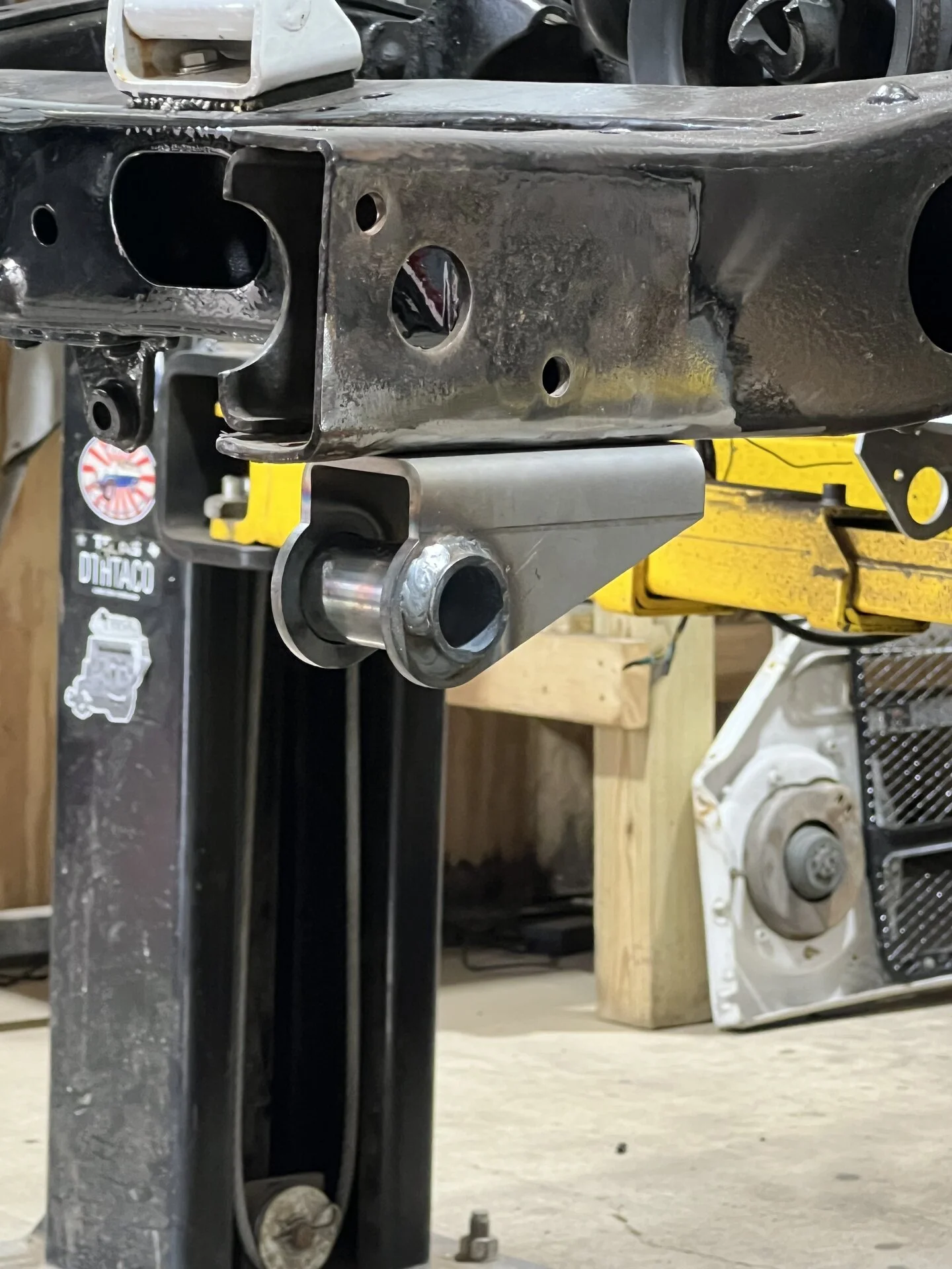

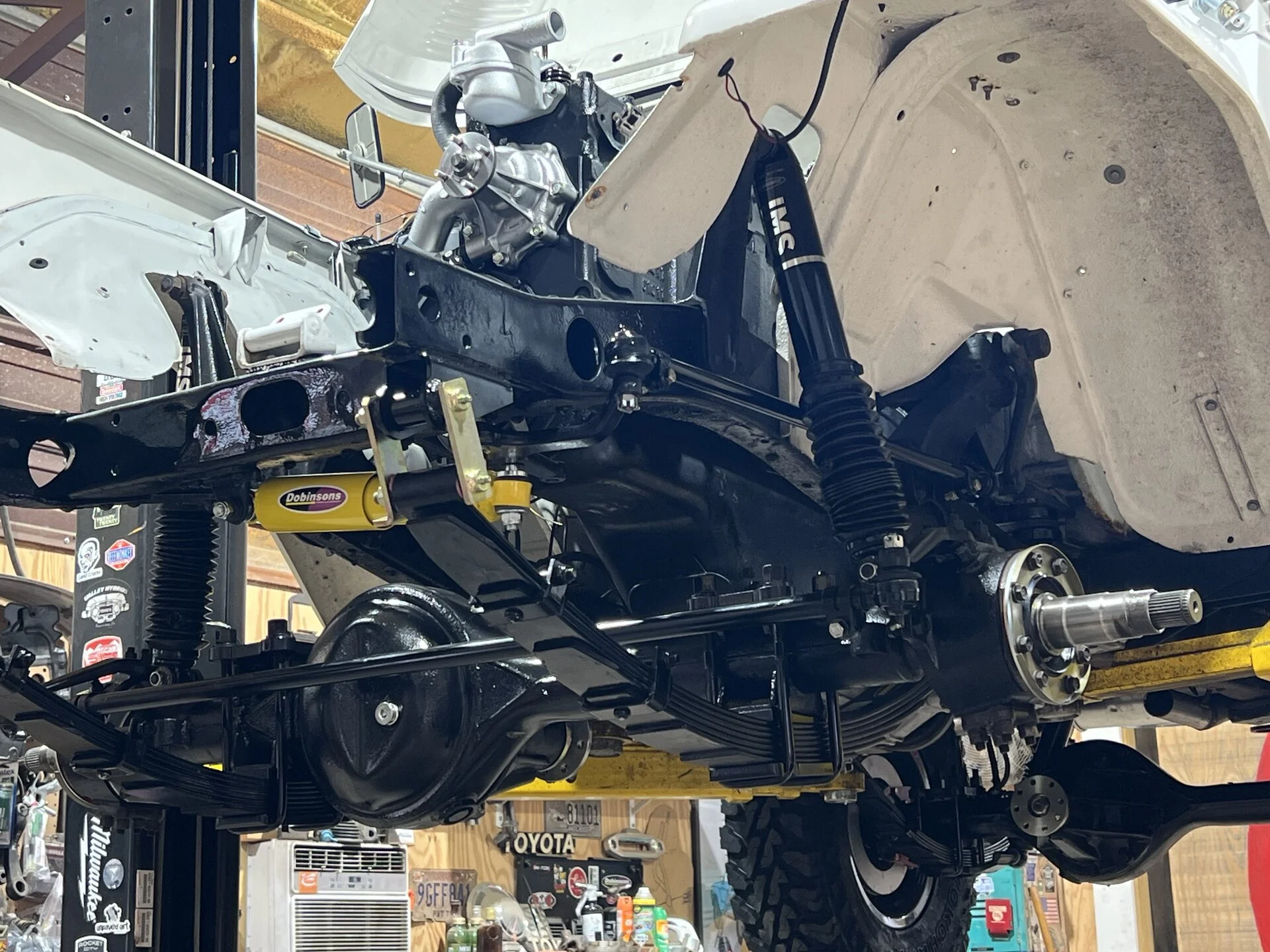

Man a Fre sells these terrible shackle reversal kits but ironically they also sell the kits to undo them. The Wizard is inbound to burn these in for me

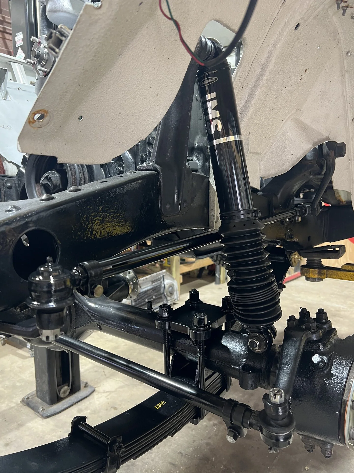

Got the flip kit and IMS shocks installed.
Rebuilt the center arm. Seems someone had rebuilt it at some point but they missed the part about loosening the spring nut a turn. It was super stiff.
Added the relay rod and the new Dobinsons stabilizer as well.

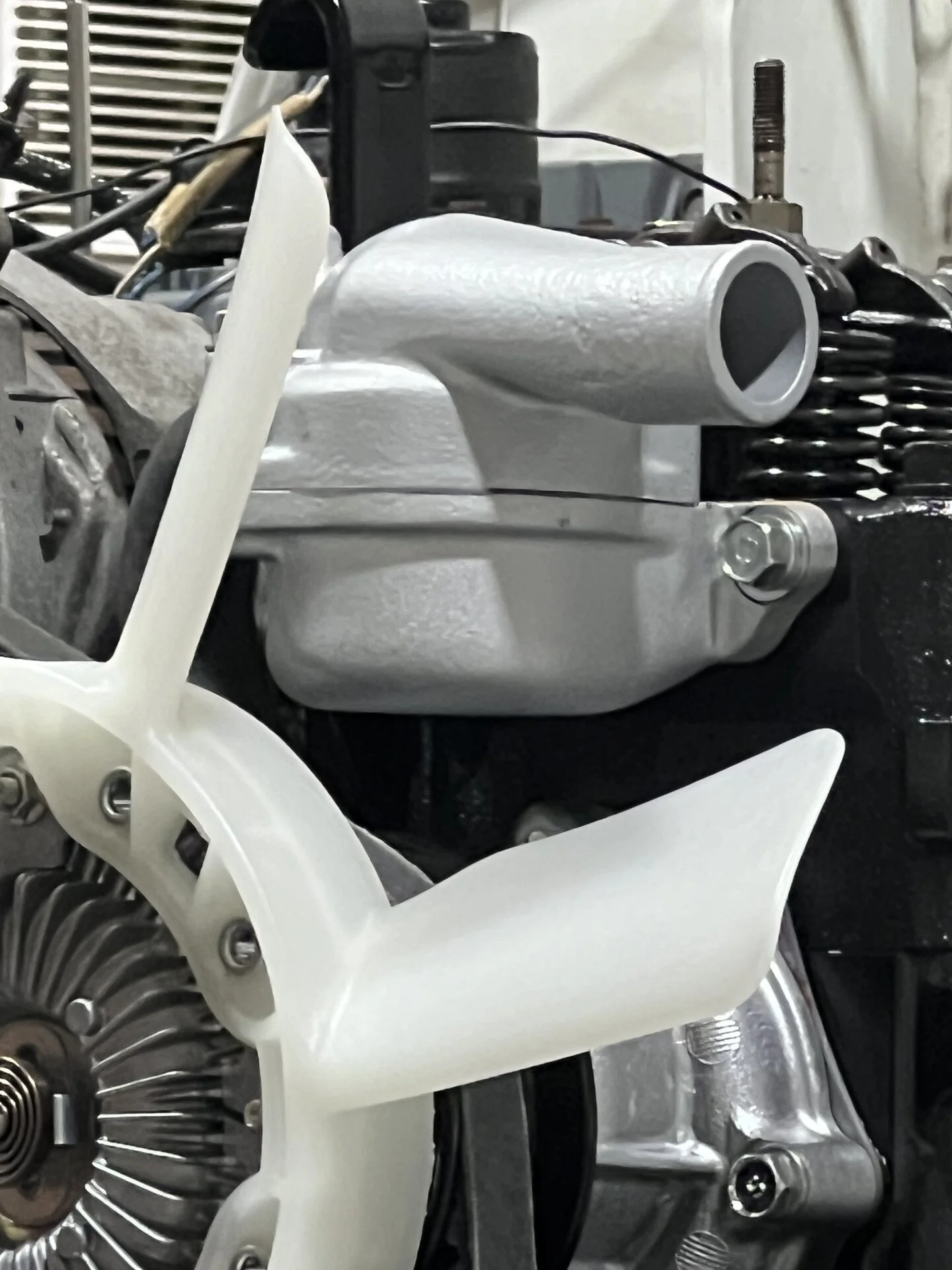

Upper and lower non-smog housings are still available from Toyota also.
I had to replace that one with the plugs with a new one because it was cracked and did not notice

Edit..plates were upside down. Can’t have those pics floating around out there. Will fix when I get back in the shop. Thanks Mark.

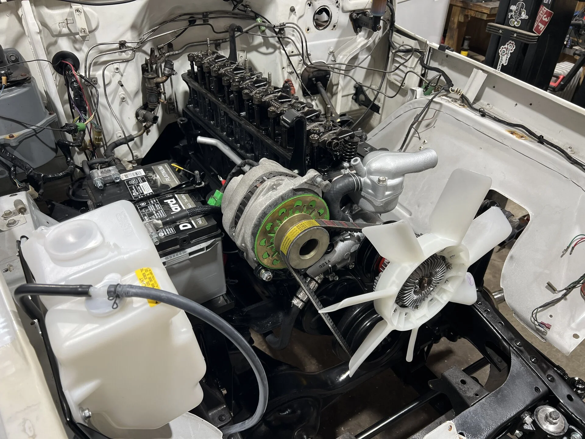

I got most all of my stuff back from PowderKeg and I started bolting things back on the mighty 2F with a pile of Overland Metric bolts

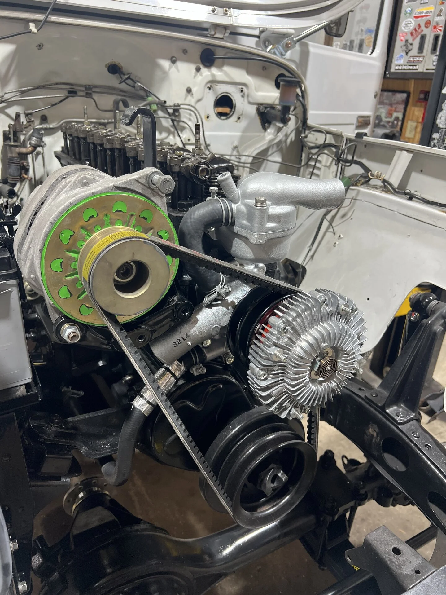

I like your taste in alternators Nolen; I have had one on mine for 13 years and it has been flawless and reliable. Powers everything no matter what the load, headlights do not dim at idle, etc.
I’ve never used one. The owner had this installed. I’m a big fan of a one wire setup but I usually use a 60 series alternator.
The plates are on upside down.
