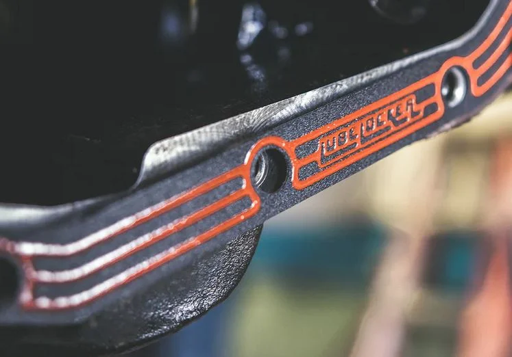

FWIW there's a newish type of gasket made by LubeLocker which has a thin aluminum core covered by a type of rubber gasket material which is itself then coated with lines of sealant; seems like a good design. Unfortunately the company does not offer a gasket to fit our differentials (maybe if more people called the company and requested they add one for the 80 series??).
