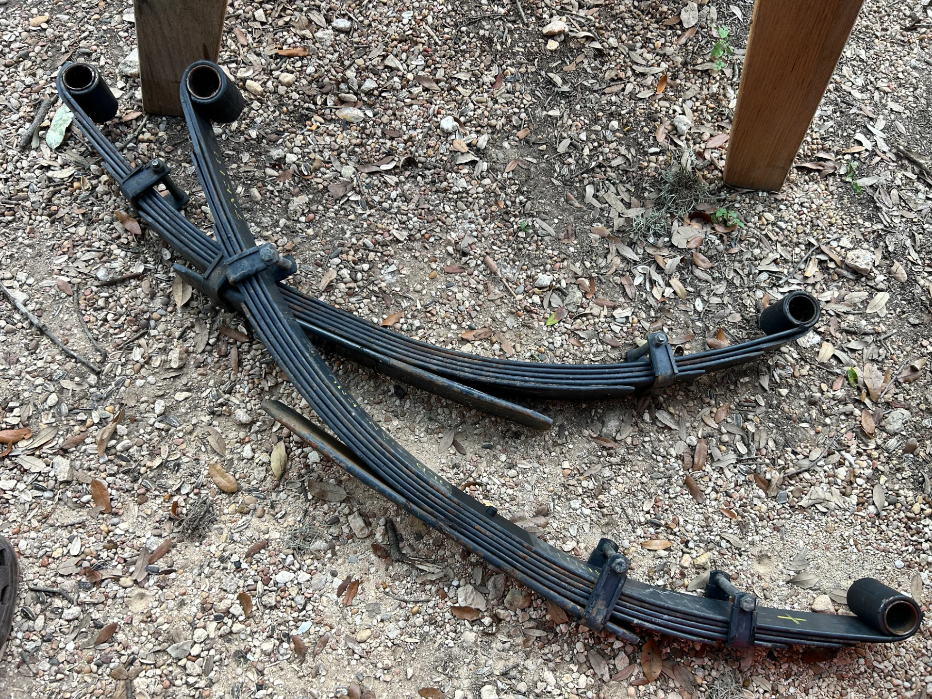

I am replacing a set of absolute garbage Dobinsons Light duty springs.
Here I have a pair of medium OME rears and heavy OME fronts. I believe a light version of this set will be worlds ahead of the trash on there now.
I am going to remove the leaves indicated in the photos:
The single one here from the rears
And the two squared off ones from the front here:
Keep in mind I am running a soft top, no winch, oe bumper, stock spare tire carrier and an added older passenger side tire carrier for my Jerry can.
Thoughts?
Also, special thanks to @77mustard40 and @OlYellr for contributions to the cause.

I am done with the fronts. It looks like I have 1 leaf more than you and I took one out. These fronts were rated as HD and I took out one of the matching long ones.

I would remove a leaf maybe 2. A long one and the shortest one.
I did on my front pack and wish I had pulled one more medium length one.
What pack did you have? The front is/was a Heavy load and I removed one of the pair of identical, squared off ones. I’d probably remove the other one of those if still too stiff.
The rears are my question now. They are the CS001R. The guy I got them from said they rode horribly and he doesn’t have the hard top on either.
The rears are my question now. They are the CS001R. The guy o got them from said they road horribly and he doesn’t have the hard top on either.
I have the HFS springs. Little different and mines much heavier in the rear with hard top, 35” spare, carrier and 3 Jerry’s.
I think I left my rears alone. But also they don’t have that big overload at the bottom. I would pull it and the top leaf.

Finished last night and went for a spin and it is miles better than before.
I ended up removing the overload leaf from the rear CS001R packs and one of the squared end leaves from the CS002F packs. The results are fantastic.
I disassembled each pack completely, wire brushed both sides of each leaf, packed the friction pads with Moly Lithium grease and ran a thin coat of the same anywhere there looked to be metal on metal contact. I also overfilled the greaseable shackles.

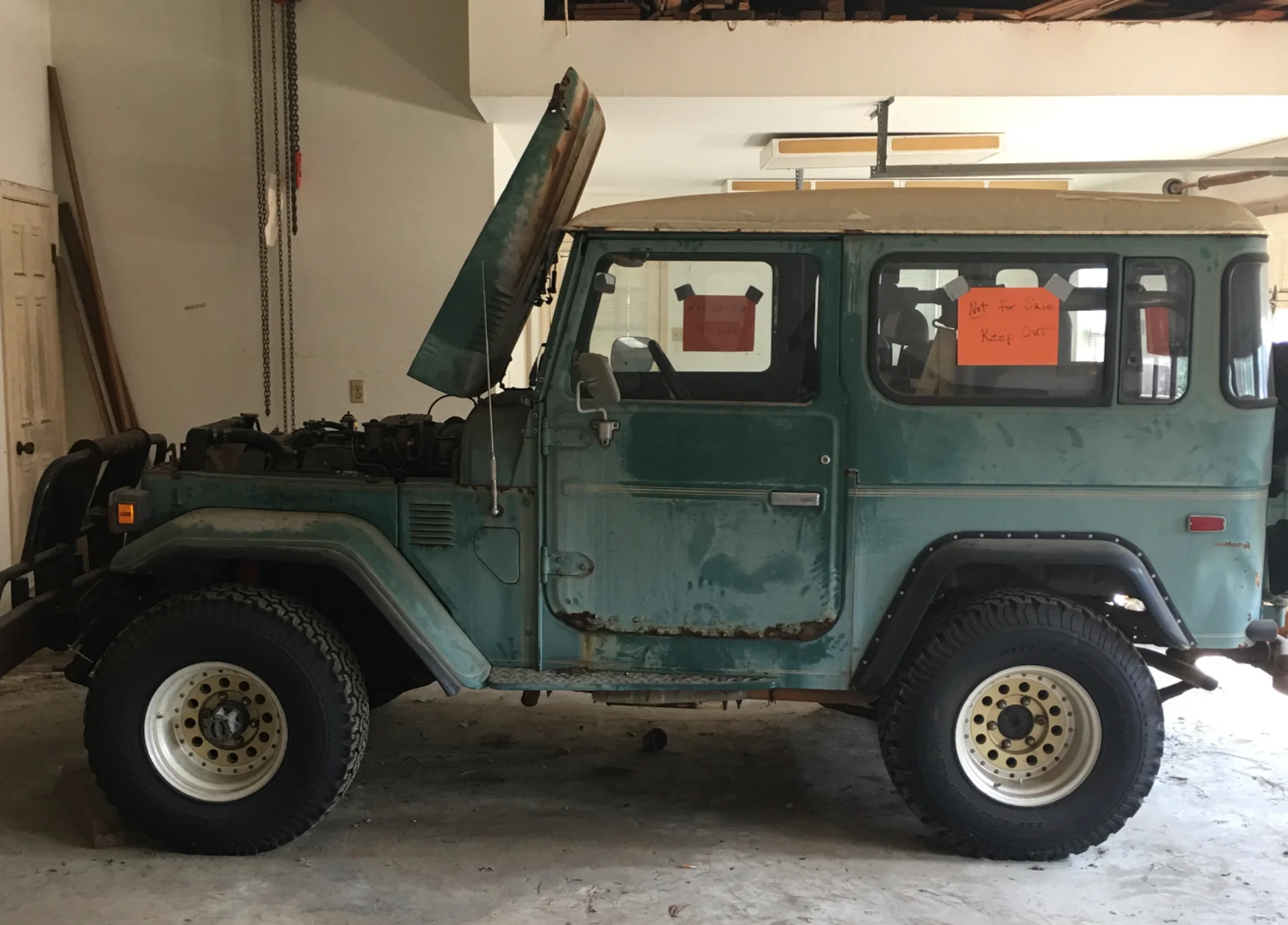

The rear axle looks way forward?
That is true but standard as far as I can tell. It has looked the same with all 3 spring set ups I’ve had on this truck. May consider drilling a hole an inch back in the U-bolt plate.
This pic is before I had her:
Better angle now:
