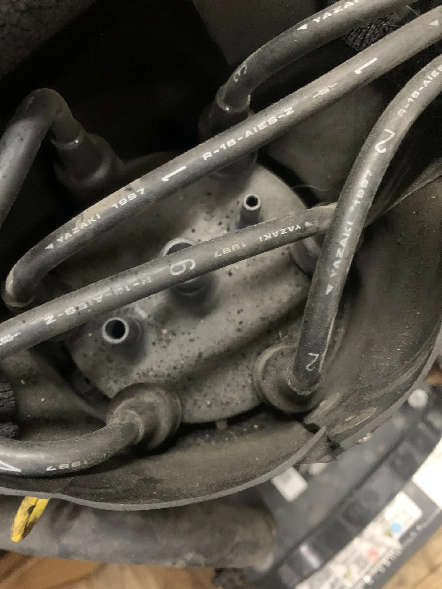

Where does this hose go?
RevISK
SILVER Star
May 26, 2020
66
6,485
The _______ part of Texas.
1988 FJ62 3FE smogged.
Doesn’t show this hose in the FSM.
It’s the 5.5mm one coming off the air filter housing.
Going through and replacing all my vac hose. This was disconnected.
Thank you in advance,
Ian
If I remember there is one that goes into the distributor… it’s very strange.
I think this is correct. I don't have a 3F-E to gander at currently.
That hose isn't a part of the vacuum diagram system because it shows in the air filter housing schematic which would make sense with this picture above.

There was indeed an open port on the distributor.

E) that slightly bigger hose coming from the air filter goes to the distributor and has nothing to do with vacuum but as I saw in another post, can contribute to your distributor self destructing if it’s not hooked up.
