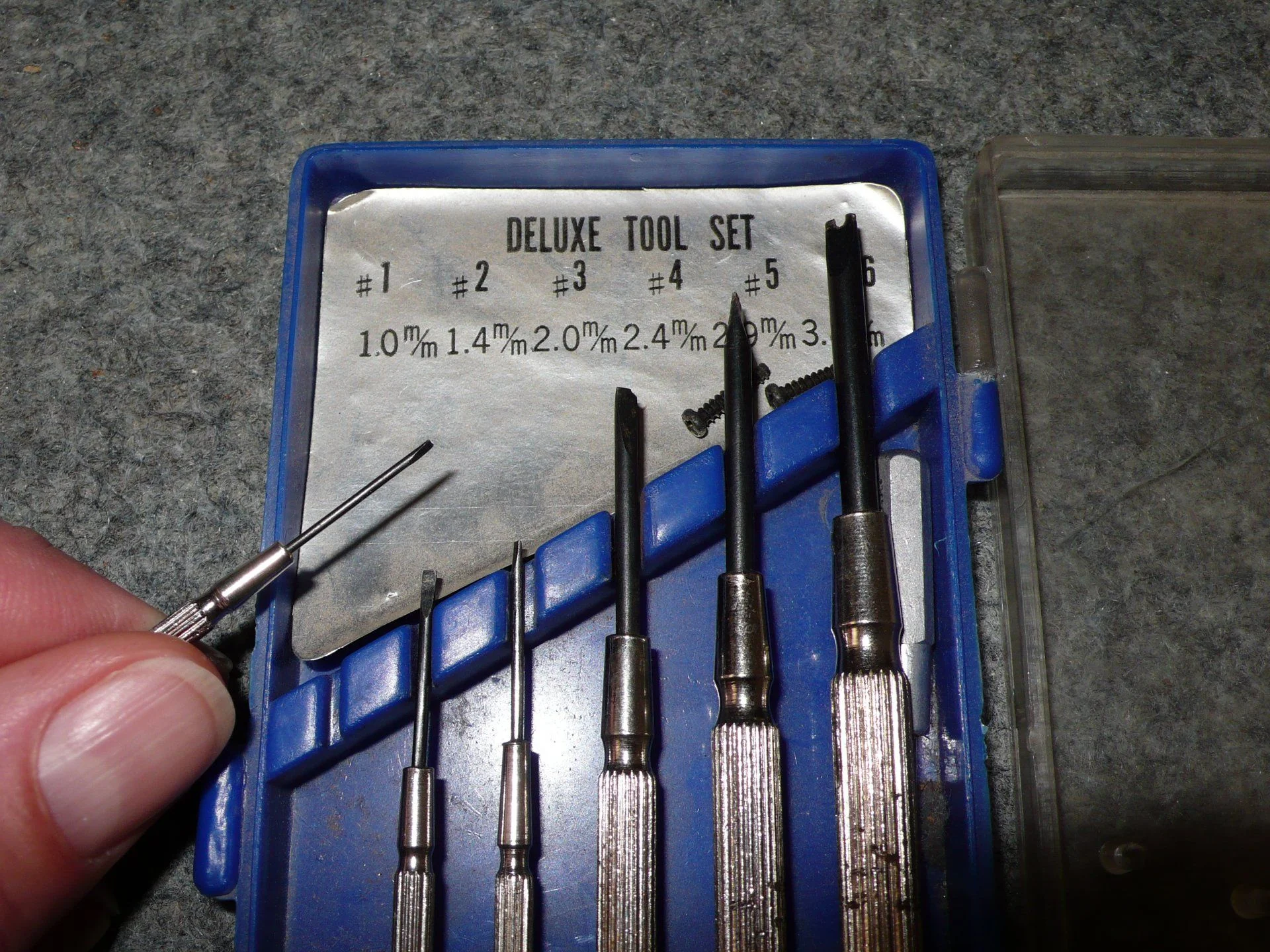

1mm jeweler's screwdriver. You probably already have one.

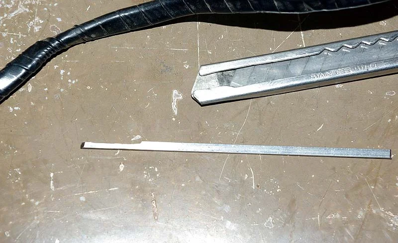

My favorite stuff to make them out of is the strips that hold windshield wiper refills in they are perfect, just the right size, amount of spring, a couple of minutes on the sander, done.
I finally broke my first one in 10 years of messing with wiring harnesses last week.

The mini screw driver on my Leatherman worked great. Thanks!

This is exactly what I use! I have a stack of these stainless steel wiper stiffeners removed from old wipers. They can be made into many useful tools.
Here are just a few of the things I have made with these things:
The longer ones make great sink drain un-cloggers
Cut into smaller lengths, they make great terminal removal/insertion tools. I have a couple I inserted into wooden handles (dowl rods)
Heat and bend a sharp hook into them for "harness picks" ie digging one wire out of a larger wire bundle
Bend them into S hook shapes for hanging parts on to powder coat or paint. or hanging a harness to soda blast it
Bend them into whatever shape needed to support the brake caliper when doing brake jobs
Here's one more use to add to your list, these work great for cleaning the bugs, and other crap out of the fins on your AC condenser, and radiator core.
