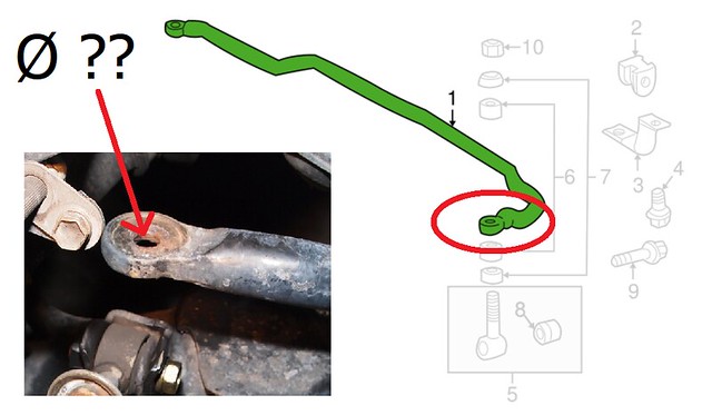

Hi all, I am new here. Can anyone here tell me how many mm is the stabilizer bar inner hole diameter ? Thanks alot.

Welcome-
Revert back to page 1 post#8 for your answer. Post#10 has additional detail on the link measurement.
