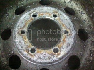

I am so confused with the backspacing issues, I have what I think are 3.5 inch backspaced rims...they barely clear the tie rod...and don't clear the caliper...the old calipers were what cut the grooves...the backspacing for the stock wheels was 3.625....any links for 15x10 rims with the 3.625 backspacing? Here's a pic of the back of my rims now..

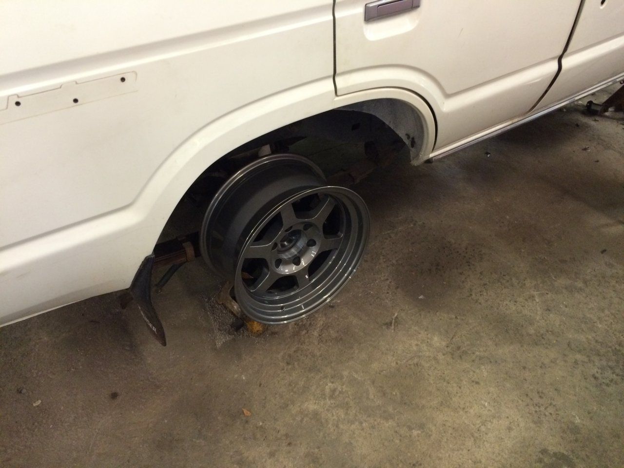

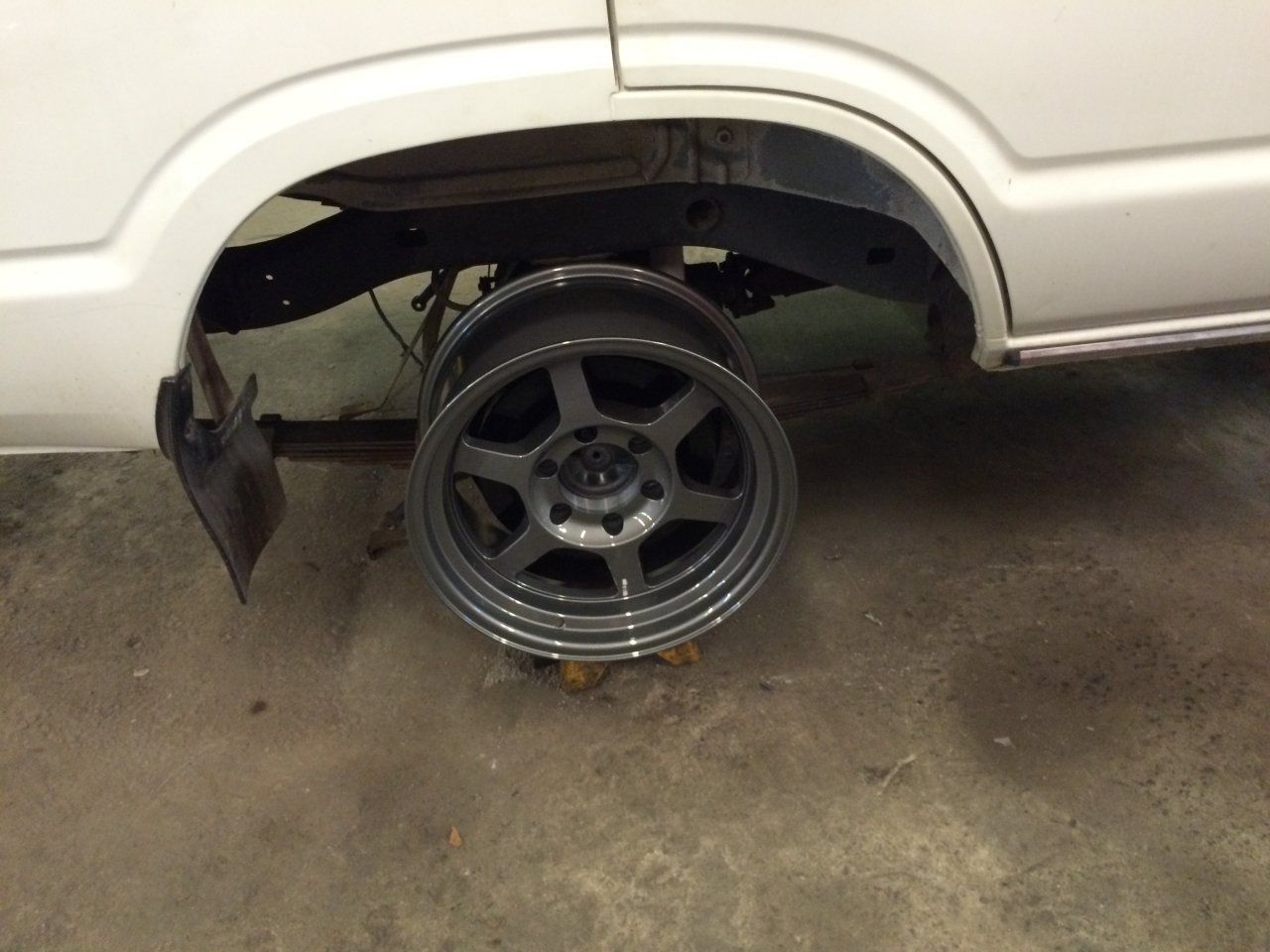

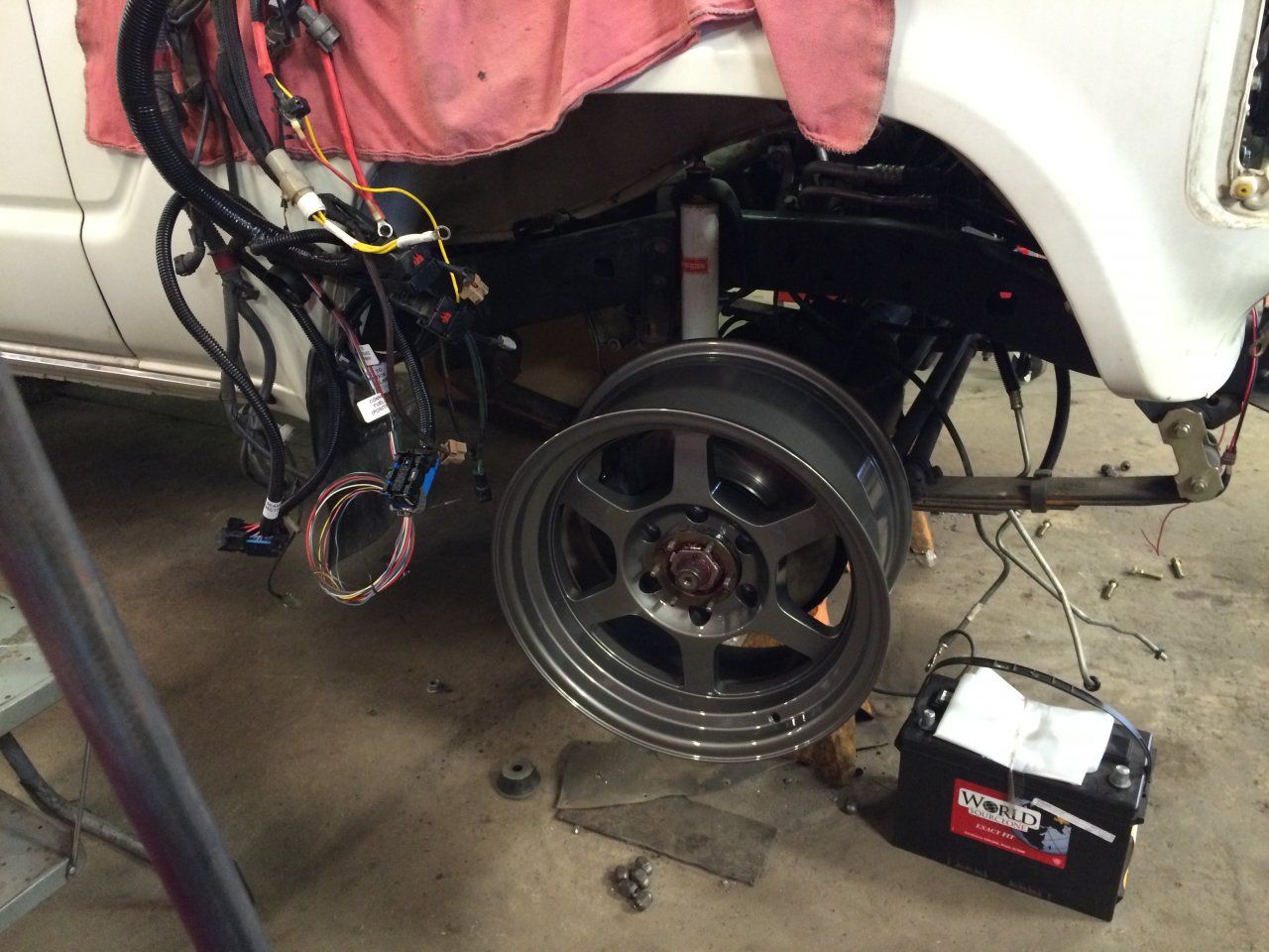

I poored over this post for months trying to digest all the details about what 'will actually' fit. Giving up many times due to the confusion around backspacing, offset, hub centric vs lug centric etc.
I finally decided on a set of alloys from FN Wheels called the Konig Countersteer Type X. Check them out here [ http://www.fnwheels.com/new-products/konig-countersteer-type-x/ ]
These ARE SPECIFICALLY DESIGNED for Toyota trucks and fit perfect. They are hub centric and are 17x8 so they clear all the known fitment issues- including the TRE clearance headaches. Plus they look awesome in the available Anthracite (gun metal gray high gloss).
View attachment 1031752 View attachment 1031753 View attachment 1031754
@SoCalJB do you have pictures with rubber on them. I really like these wheels
